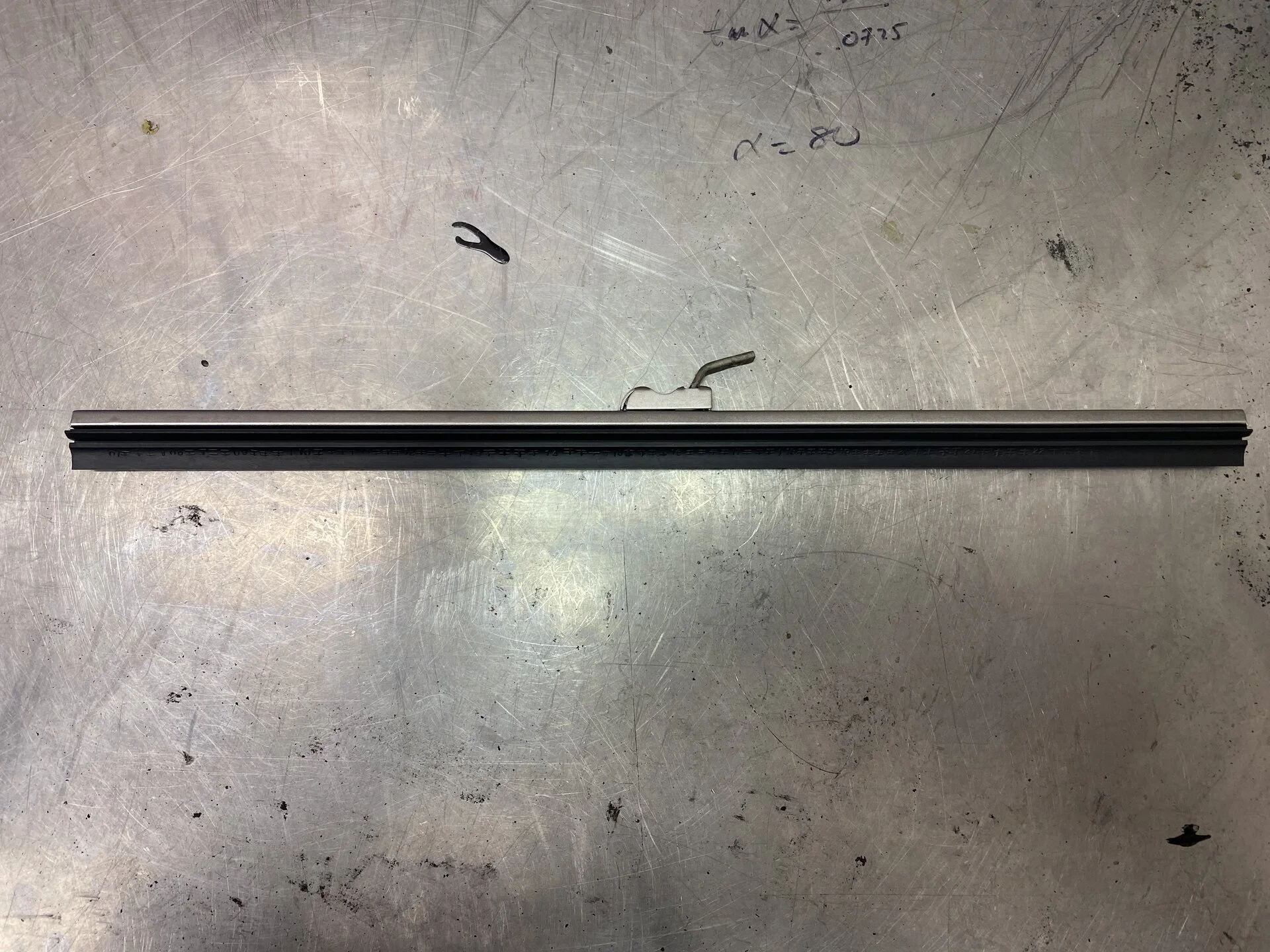

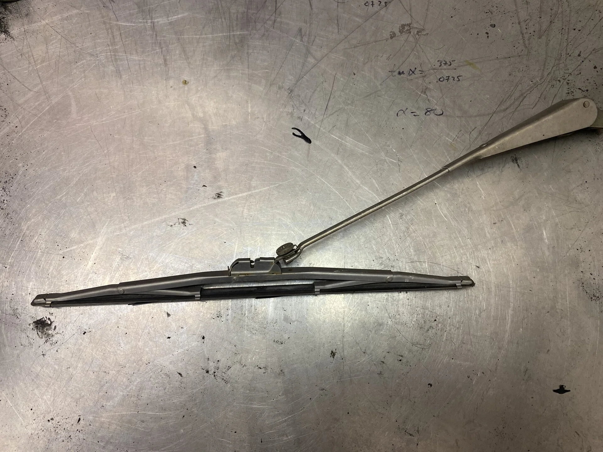

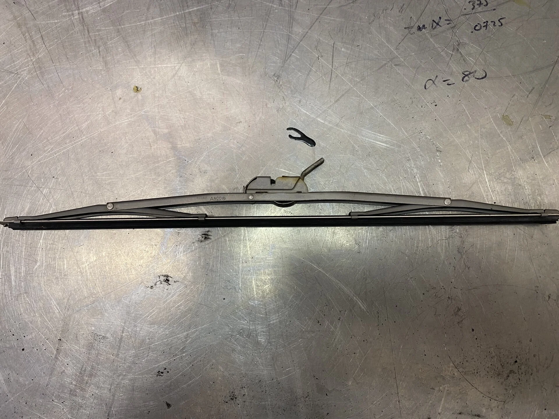

Anyone know what wiper blade this is? I ordered a Toyota replacement but doesn’t have the same fit, so maybe my arm is from a different year? Says Anco on it, other than that I don’t know the model.

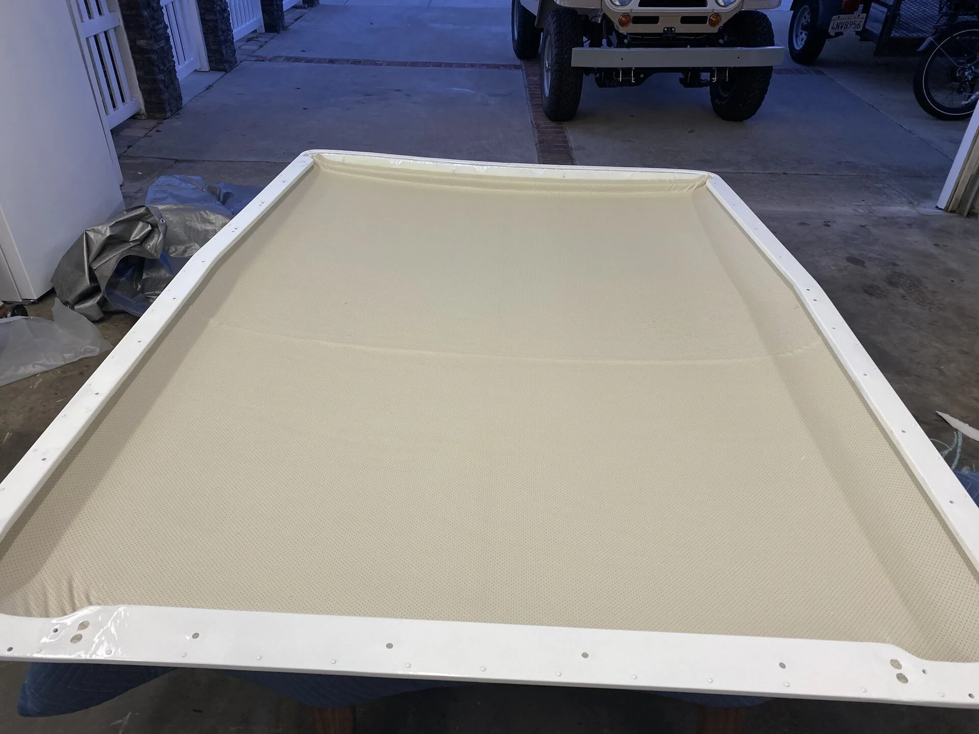

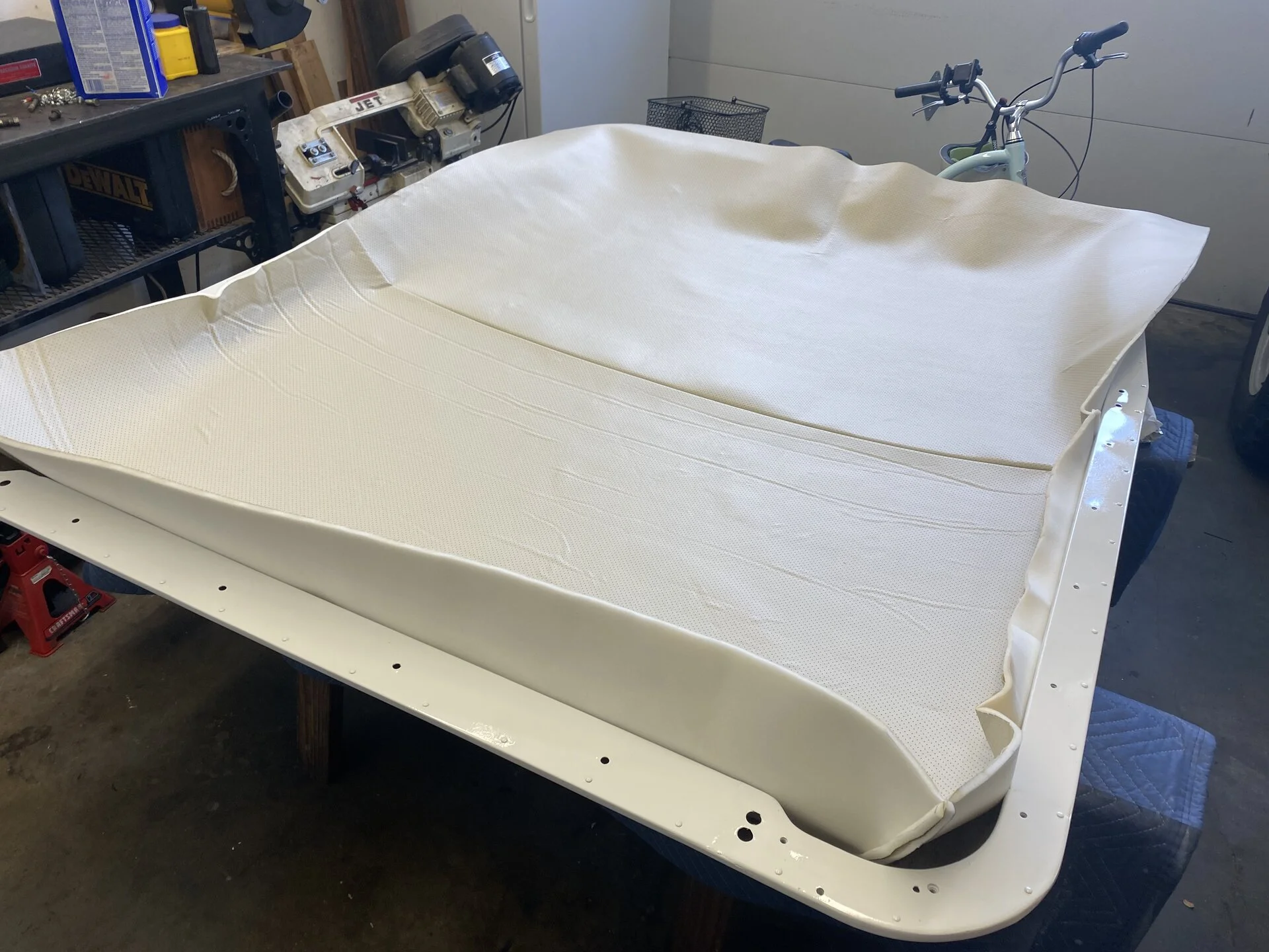

Quick project this morning while I sweat about the headliner install.

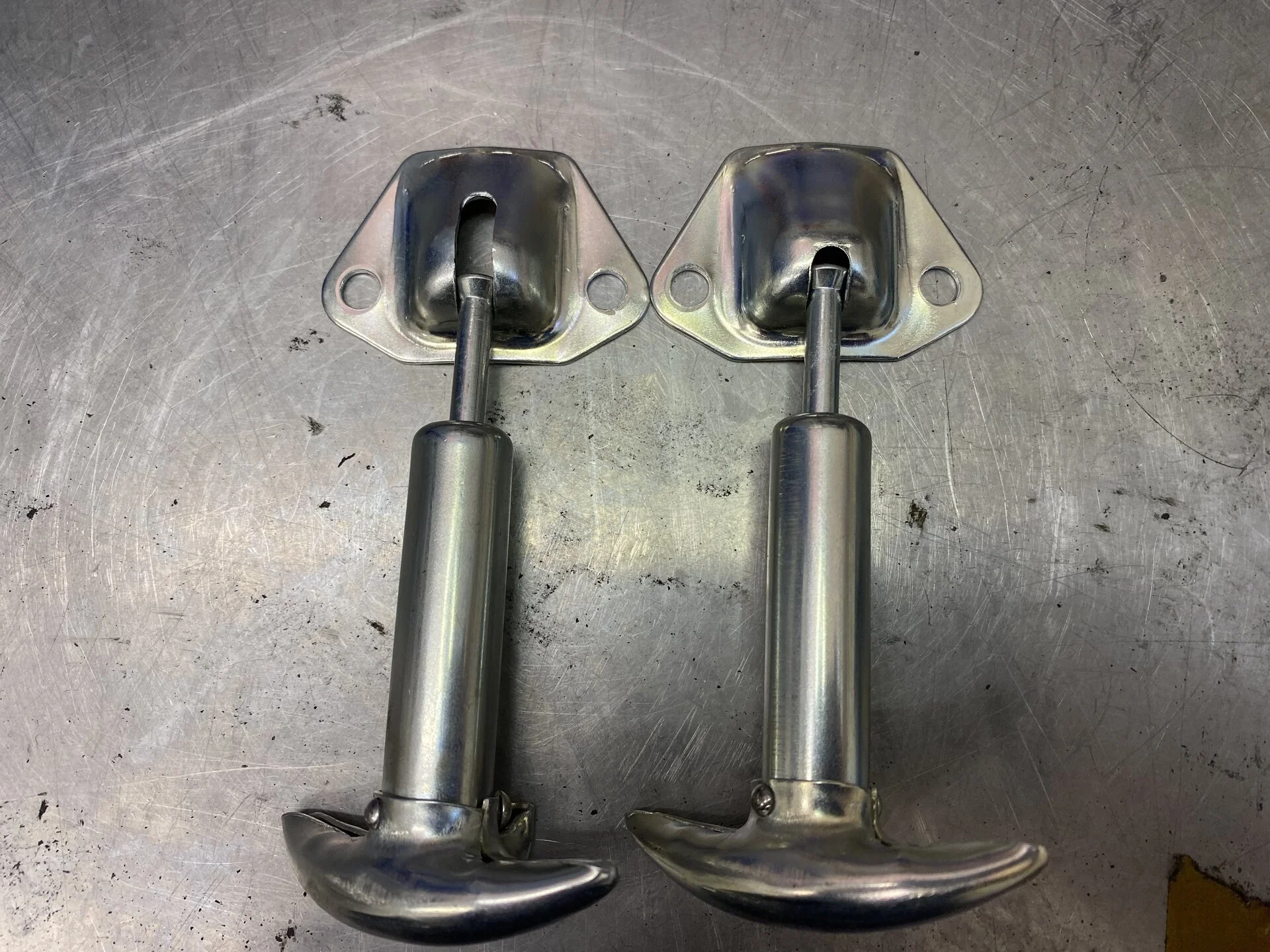

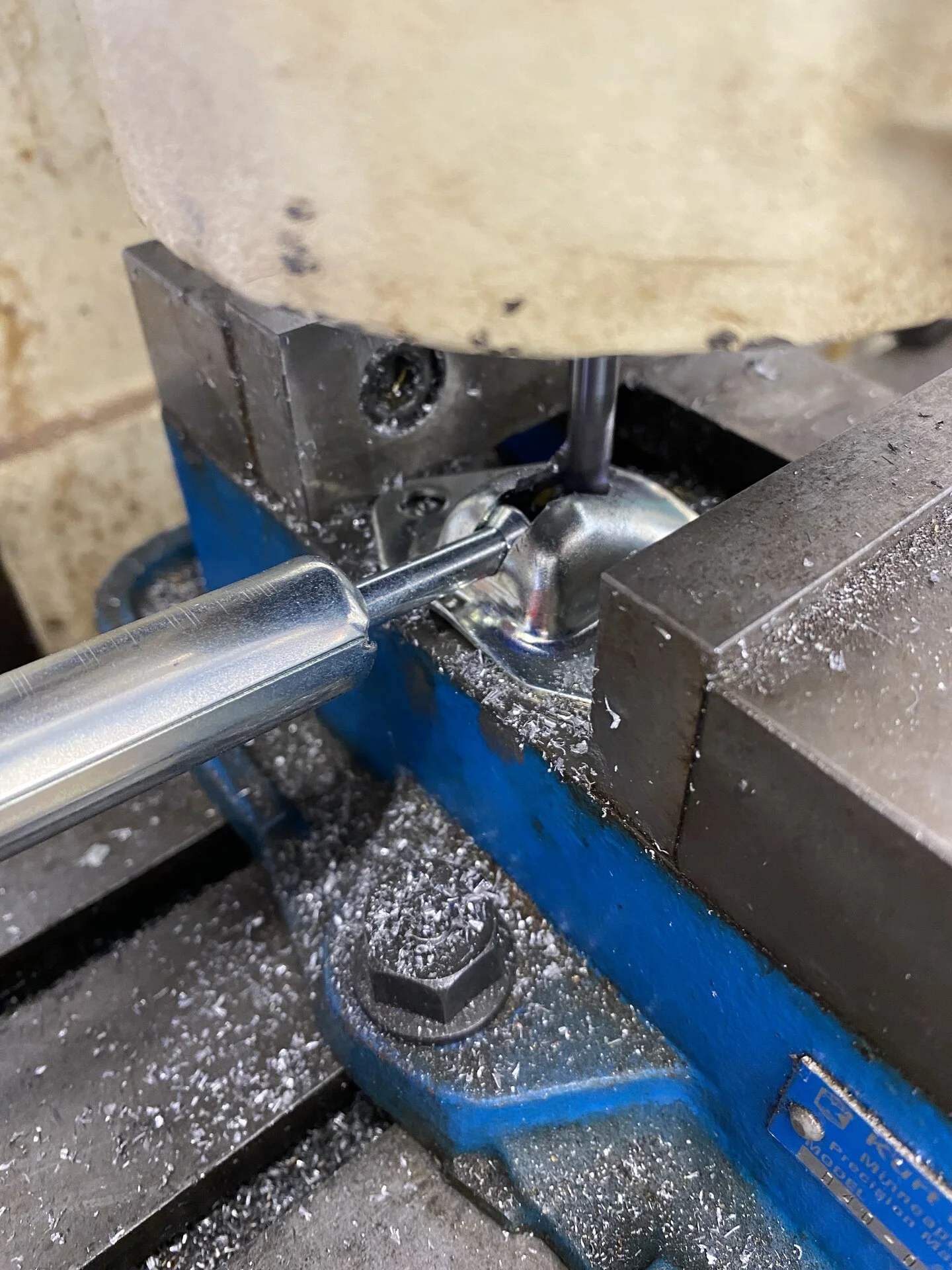

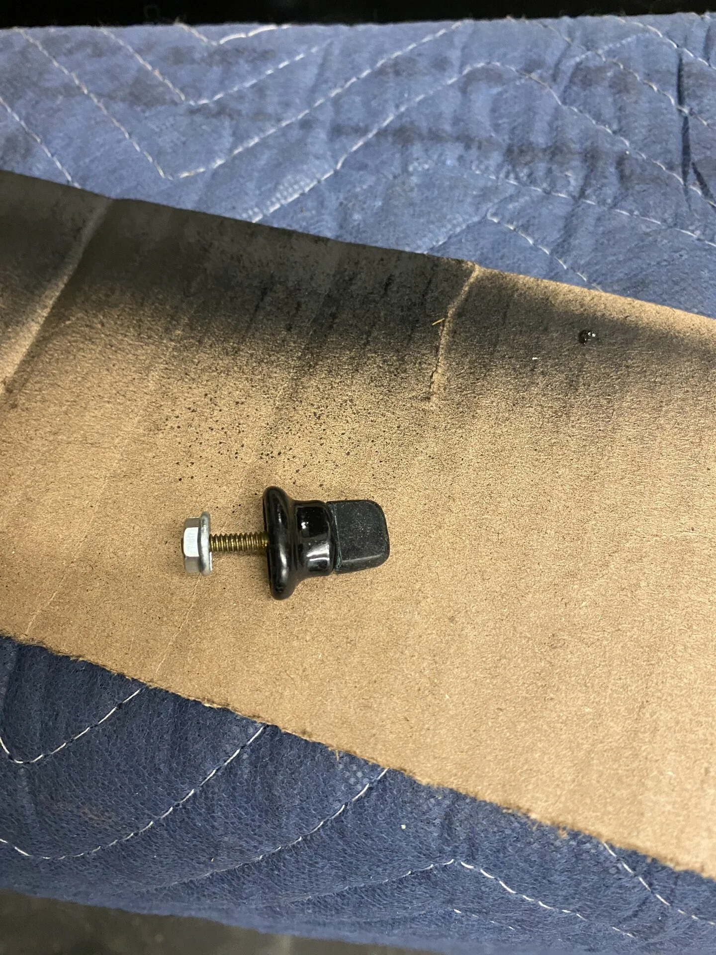

I had these windshield latches but I believe they are a later style. I do still have the originals but they’re in bad shape and didn’t want to set out to work those just yet, although I did start pulling them apart.
The issue with the newer ones was not having the travel to hook to the hood and windshield as well, so I machined out the slot to let it swing to both sides. I never plan on having that windshield down but I couldn’t leave them there non-functional.

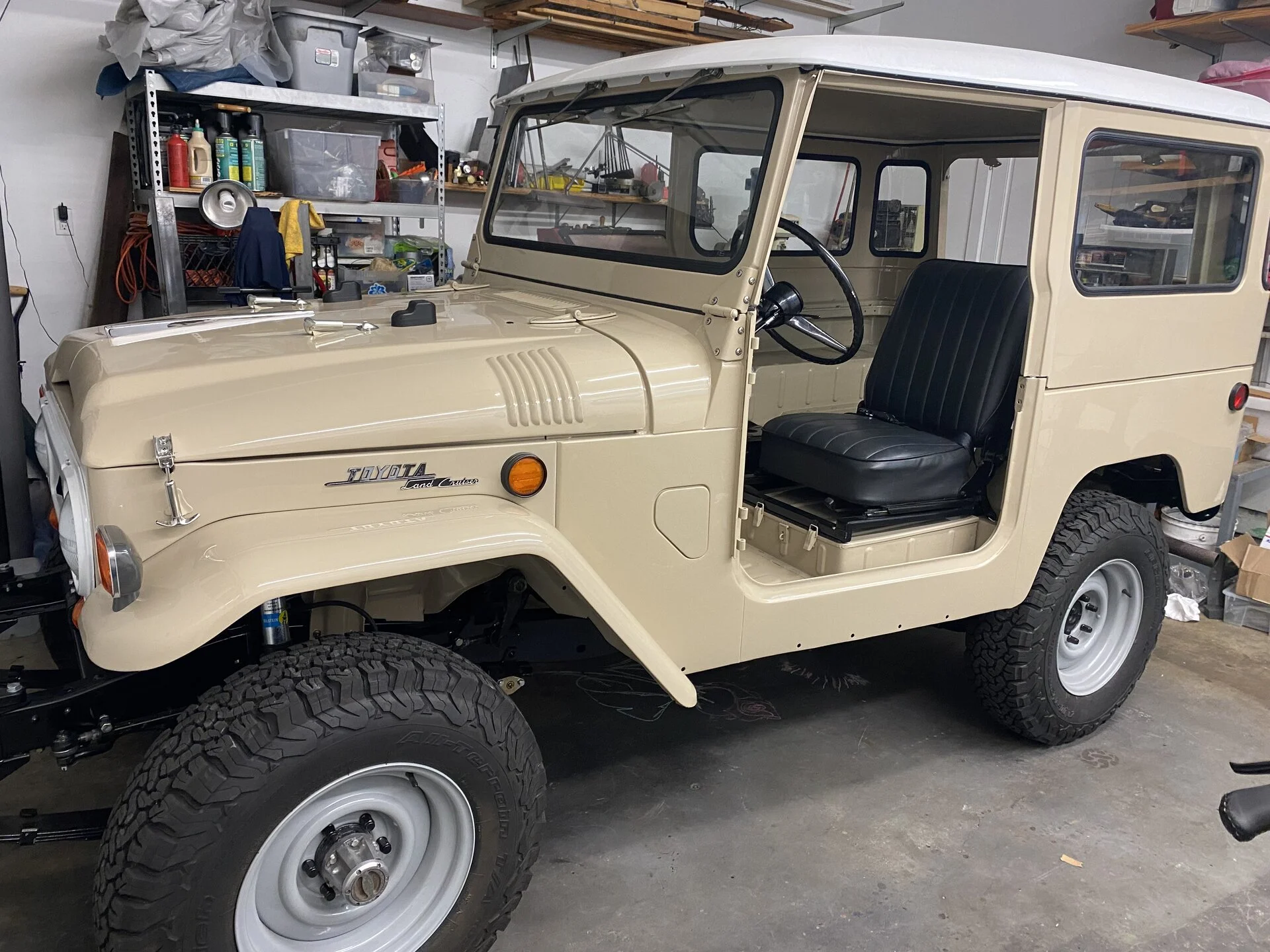

Top is on! I don’t want to talk about how hard that was to line everything up. The pry bar was definitely my friend. There are a couple areas that I’m not happy with but I’m leaving it for now, seems sealed up, all bolts are in.
Drove it around the neighborhood today and people probably wondered why I was smiling so much.

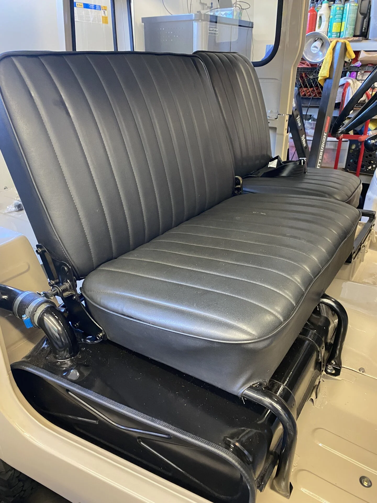

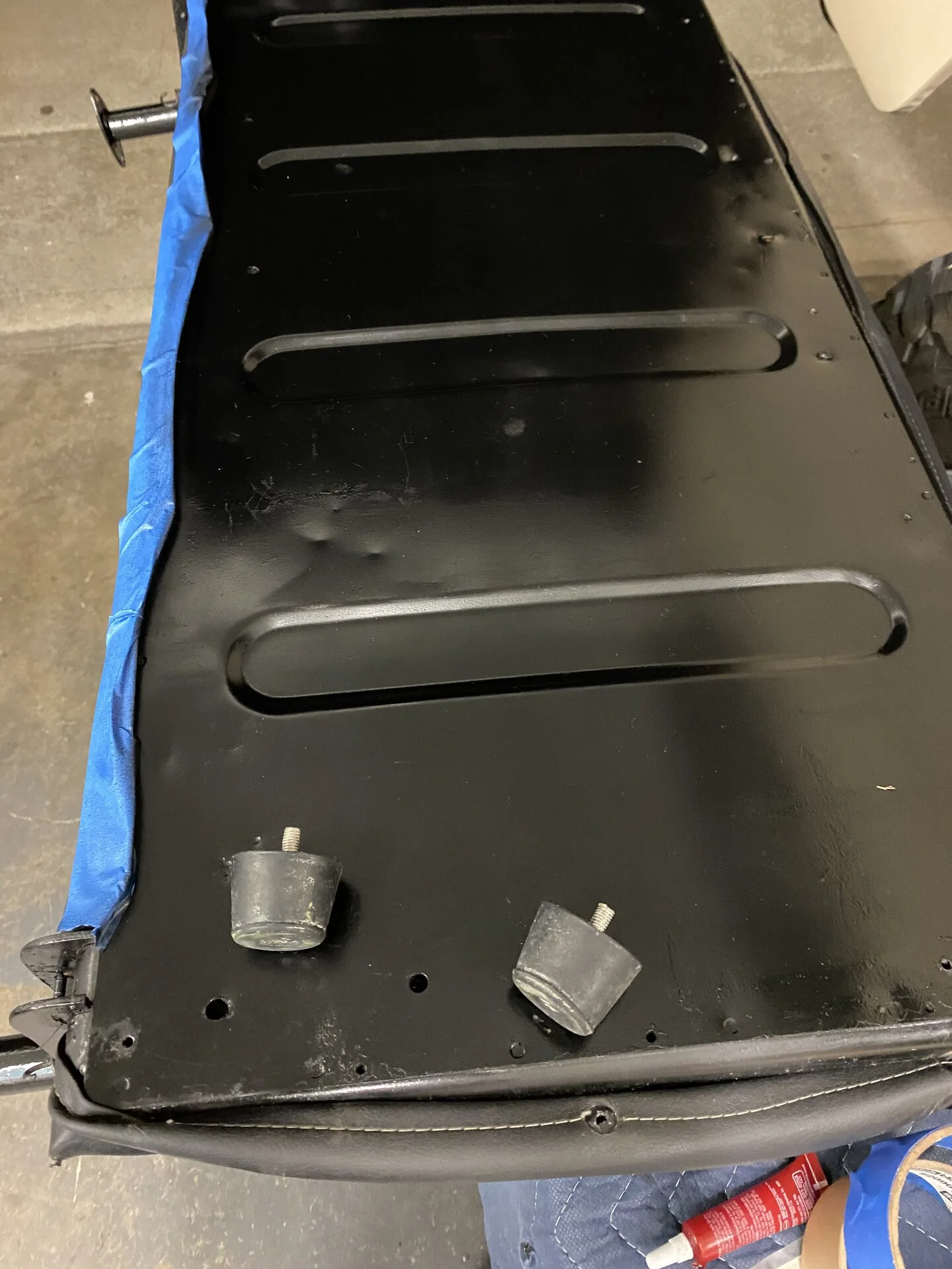

I got the passenger seat it and working on the rear now. It was kind of crazy cause when I was cleaning up the rear seats I installed new bumpers and the tie strap hardware that keeps them stowed- which were one of the first new parts I bought for this years ago. So kind of came full circle.

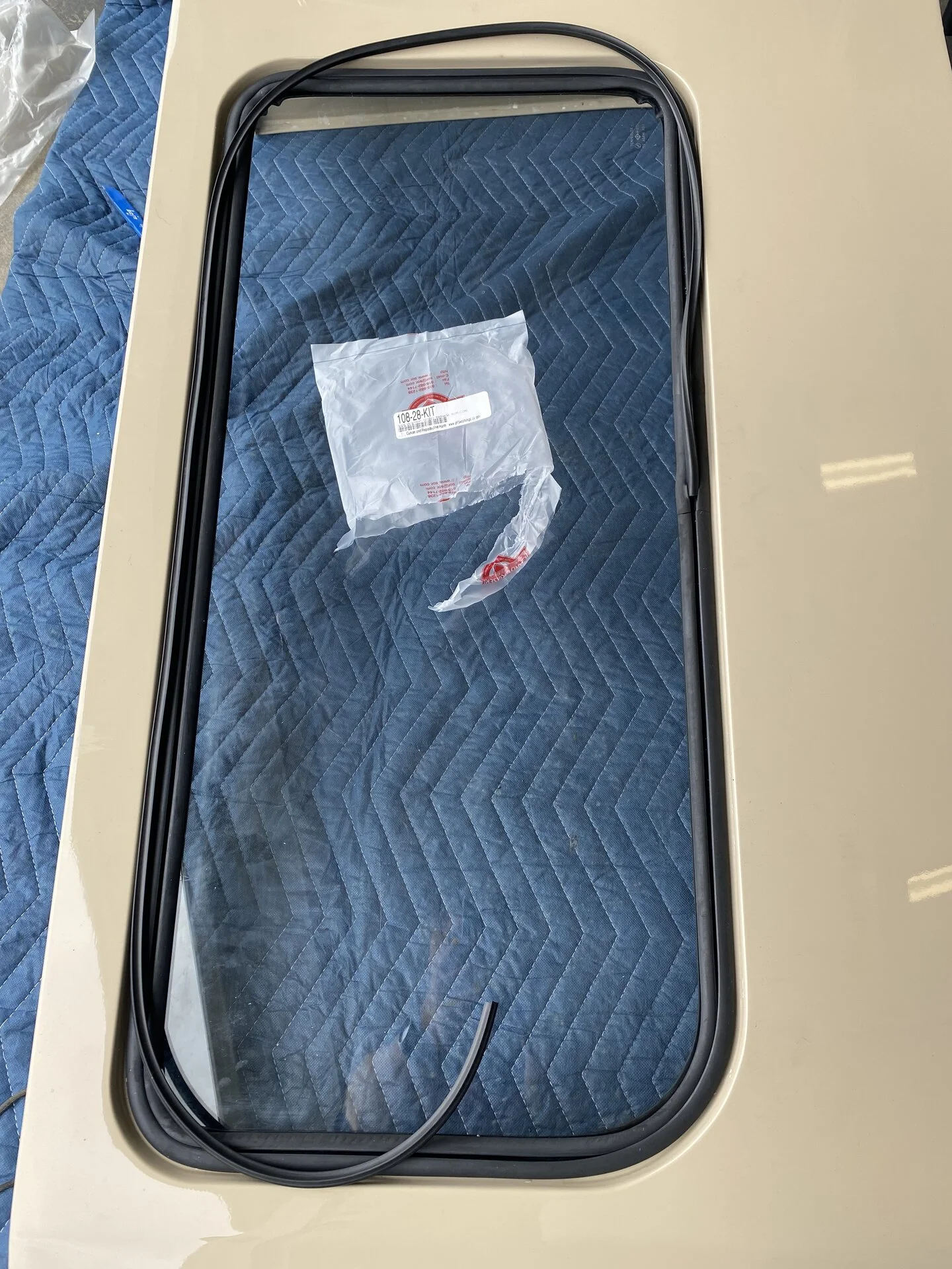

All the seats are in; waiting on seatbelts for the rear now. Also got the hatch and swing out doors installed with weatherstripping. I was so-so successful with adhering the weatherstripping on the swing out doors. Mostly sticks solid but the ends not so much.

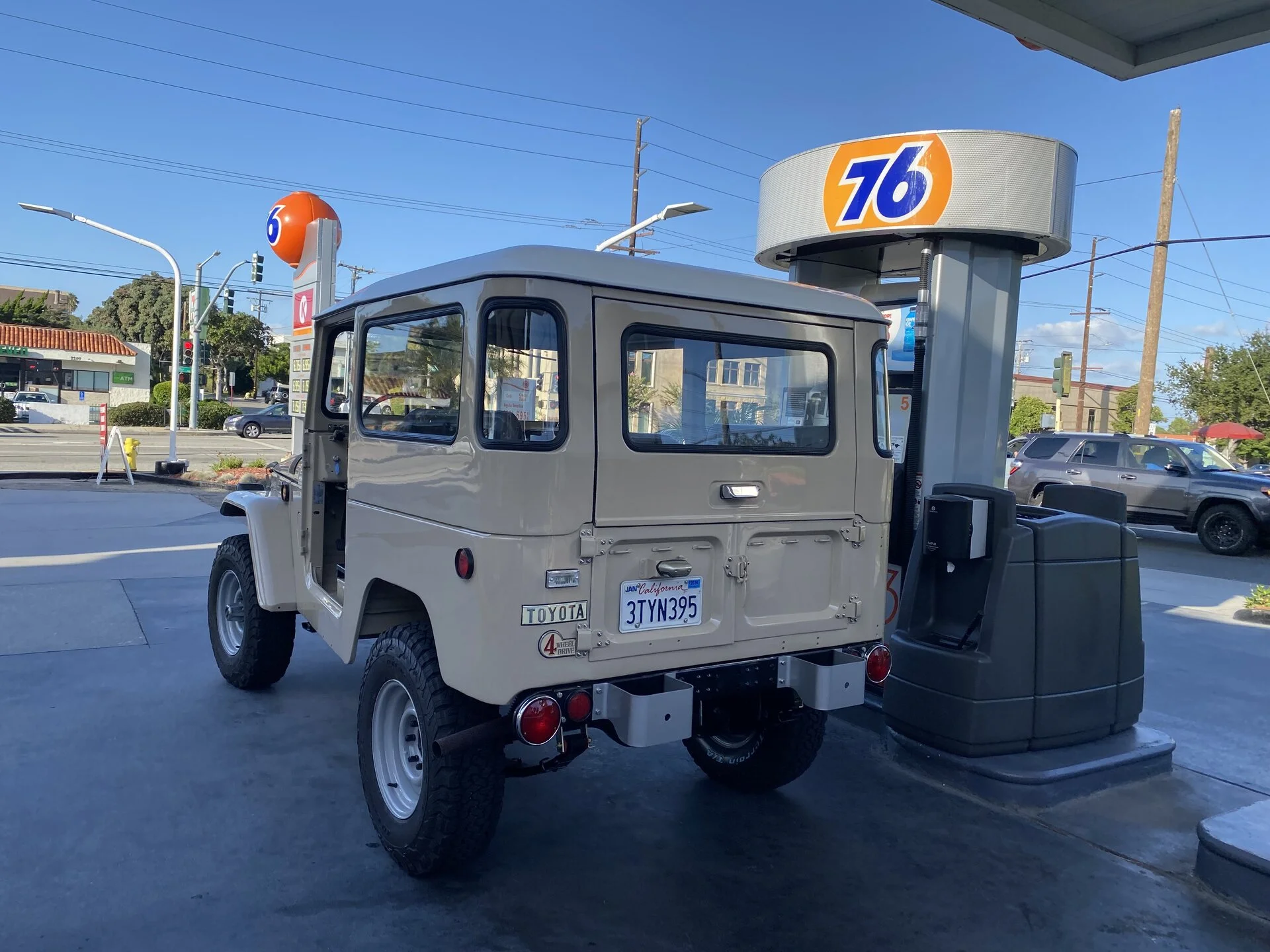

I realized at the gas station I may not be able to afford to drive this 😆
