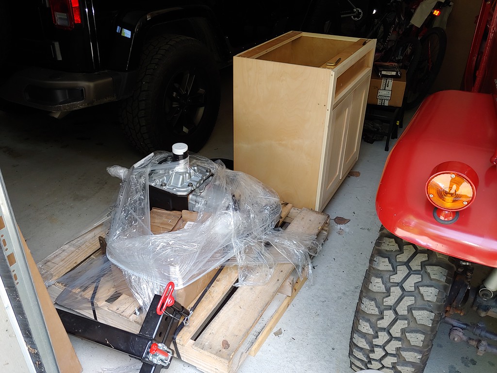

To complicate matters, or maybe simplify depending on how you look at it, I have this sitting here in my garage
That's a "short" H42 with a split case, rebuilt by @orangefj45 last winter and sent out for my now unlikely 67 FJ40 patina project. 3:1 low range and the OEM drum brake. 60 shifter, 60 crossmember and a twin stick set-up. I even have the 4 speed bellhousing, clutch fork and flywheel, though I'm not sure it's economical to send them out.
H55? I built the one above as it was as short as possible to squeeze it into the early 40. Plenty of room in the Pig, but as this is already a big sunk cost I can't see going with the 5 speed when this is available. @wngrog, do over 55 or 42 with 3.7? I think I've seen you say the latter.
I don't HAVE to use this H42 now, as it could wait for another project. The inevitable FJ45 is what comes to mind.
