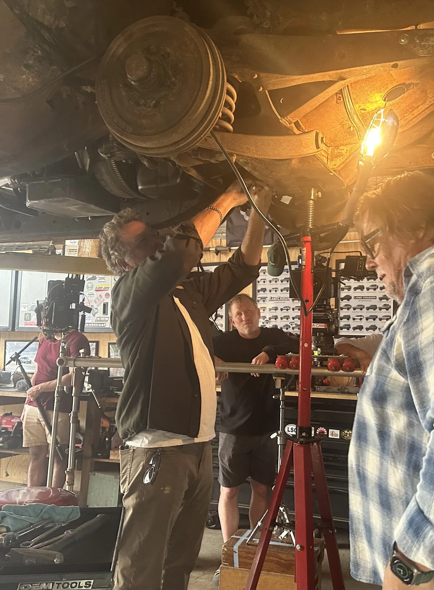

Camera man must have had a h### of a time finding the right angle to make it look like a Chevy owners garage. They should have just put the 45 on the lift - would be a much cooler movie!
The story is around a father and son restoring a car. They needed a pile and a painted finished product.

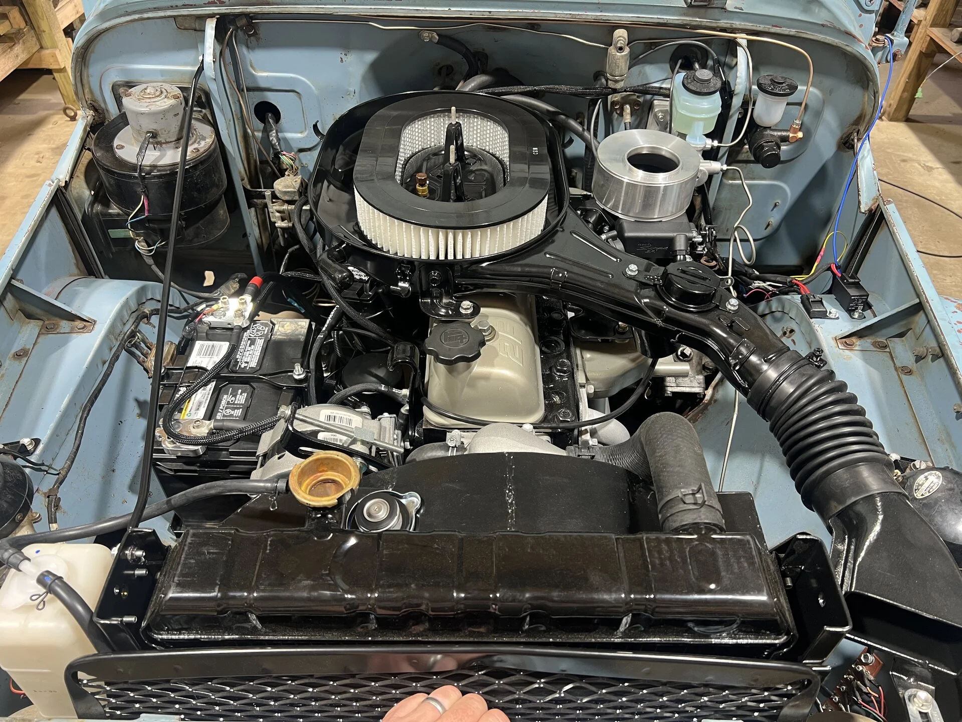

Today has been a good day of wiring.
I got the Sniper all wired up. Added a @Coolerman fusable link. Crazy how the early trucks did not have them. Power on the large white went through the starter.
Wired up the 1 Wire mod internal regulator alternator.
Moved the oil pressure sensor wire from driver to passenger.
Fixed some PO wires on the heater fan. Confirmed it worked with the PowerProbe but it’s not working at the switch.
Wipers work.
Lights work. High beams work.
Grill lights work. Blinkers work.
All good news so far.
