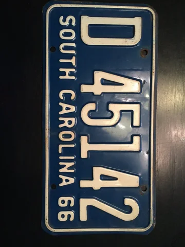

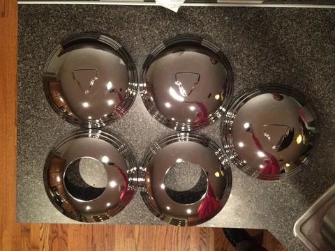

I like the look of @JackA 's LV so much, I bought a YOM license plate that seemed fitting, 5 new steelies from Toyota, 5 repro hubcaps from a vendor @majojo4 sold some of his stash to and 5 BFG M/T KM2 33x10.50x15s from an ONSC club sponsor. (FYI - Rumor has it BFG is discontinuing this size in the M/T KM2.) I'm just waiting on warmer temps to get some grey paint on the steelies so I can have them installed. (Come on spring!)
