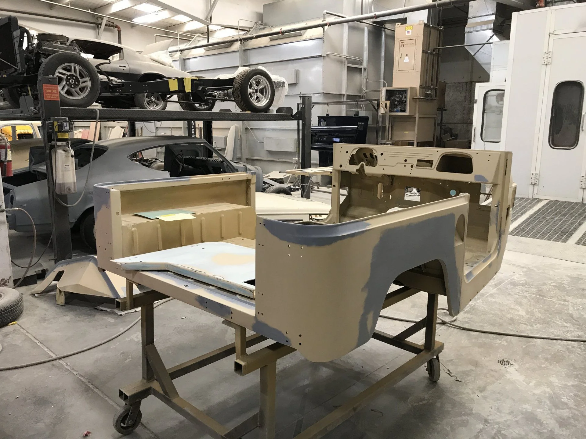

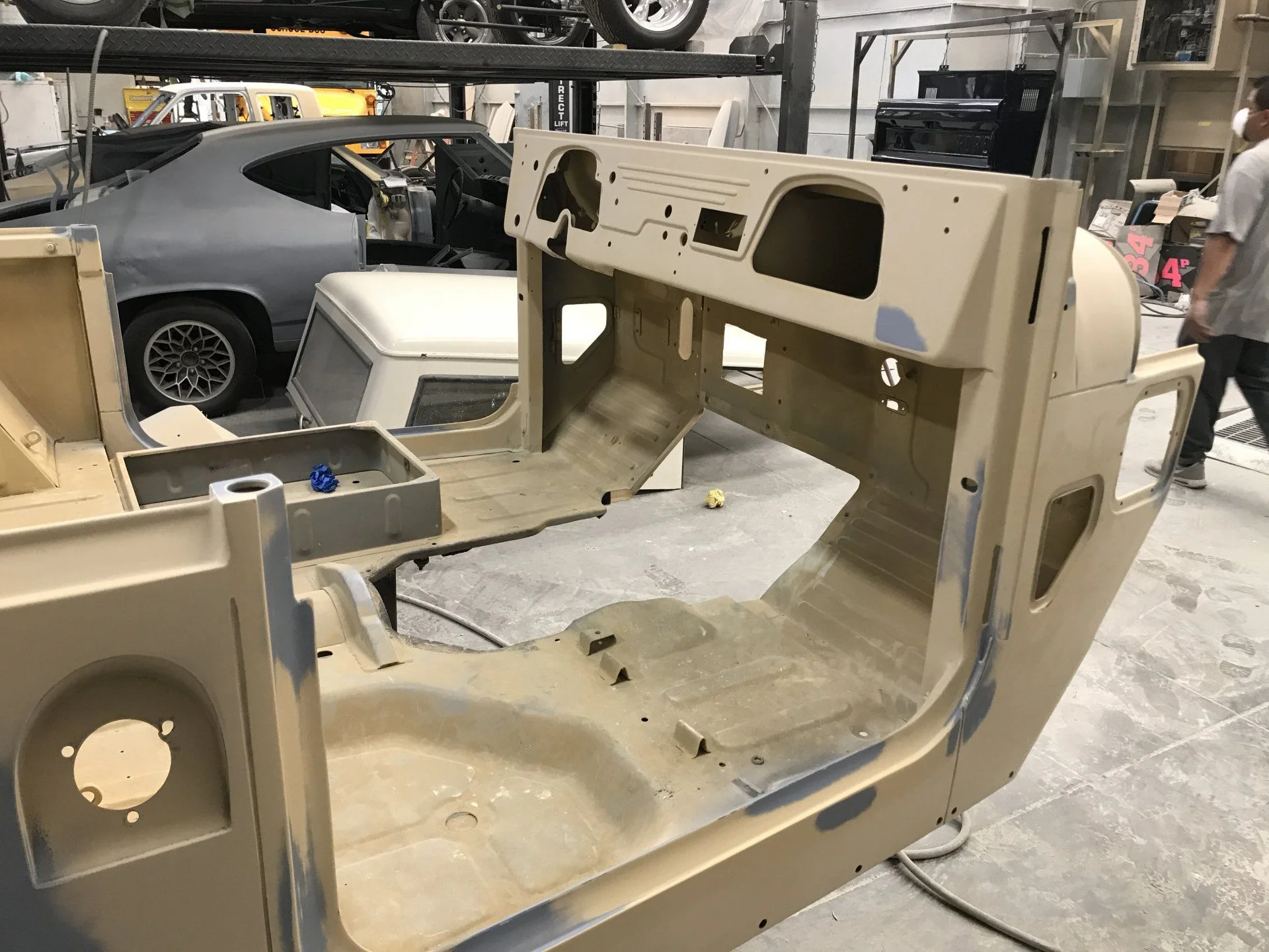

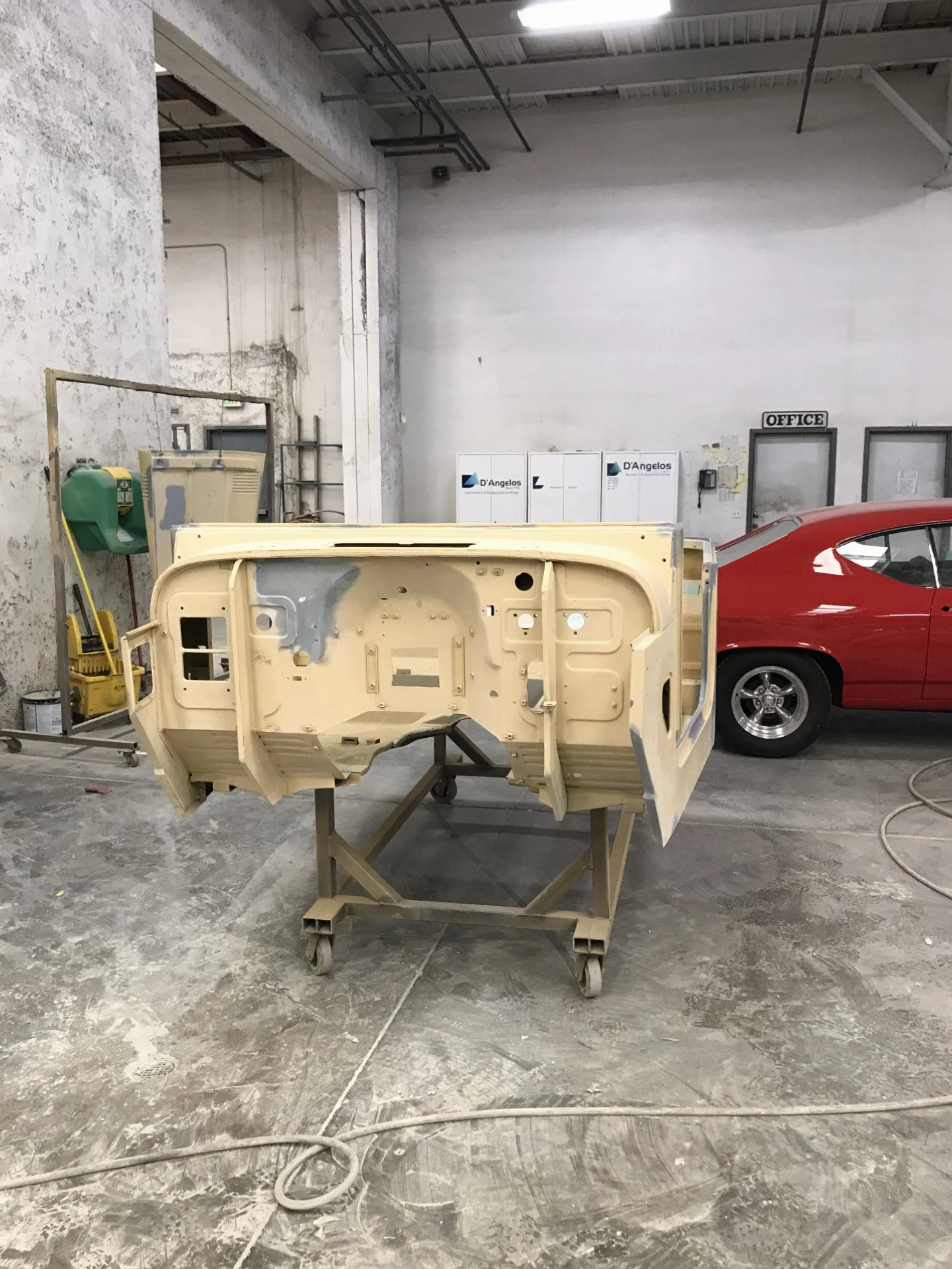

Got word today, the body is all welded up, and went to primer. Ready to be blocked. Getting there !!!

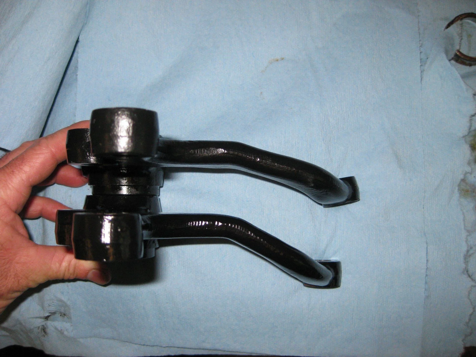

Making some slow but steady progress, still waiting on the engine at this point. After receiving the replacement center arm assembly it was disassembled, washed, blasted, primed and painted. Here's a comparison shot, the bent to hell 66' version is on top:
They aren't even close and my guess is somebody tried to "fix" this at some point

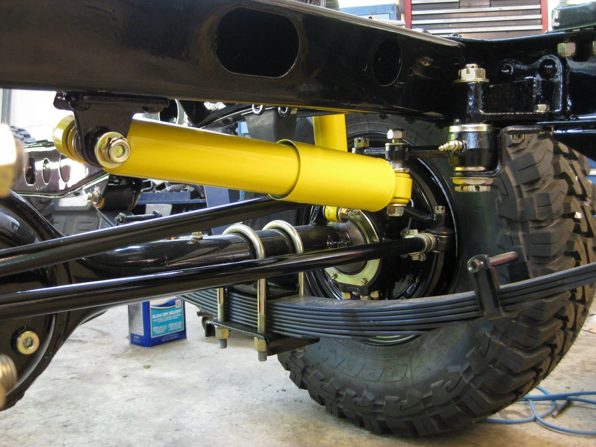

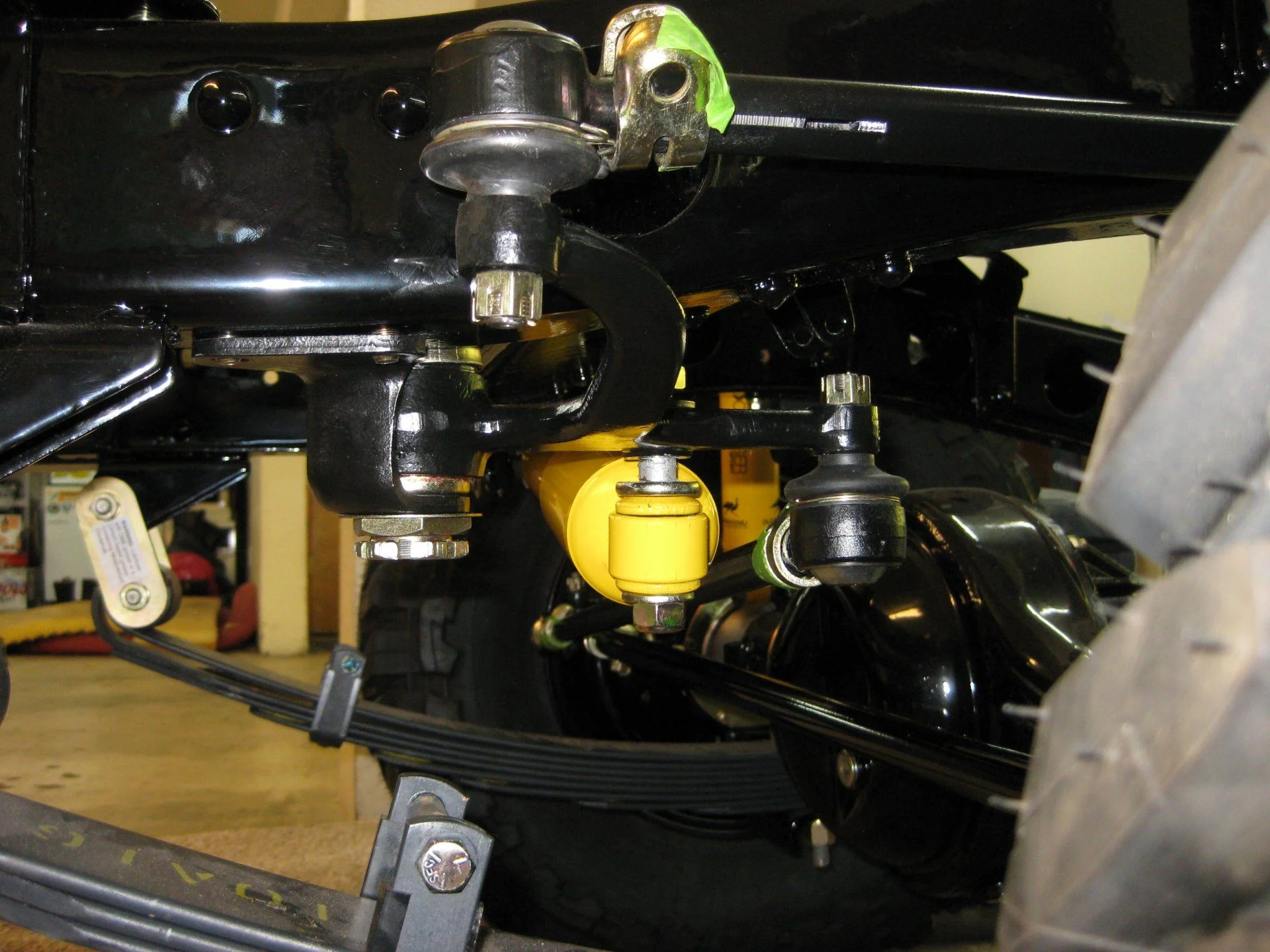

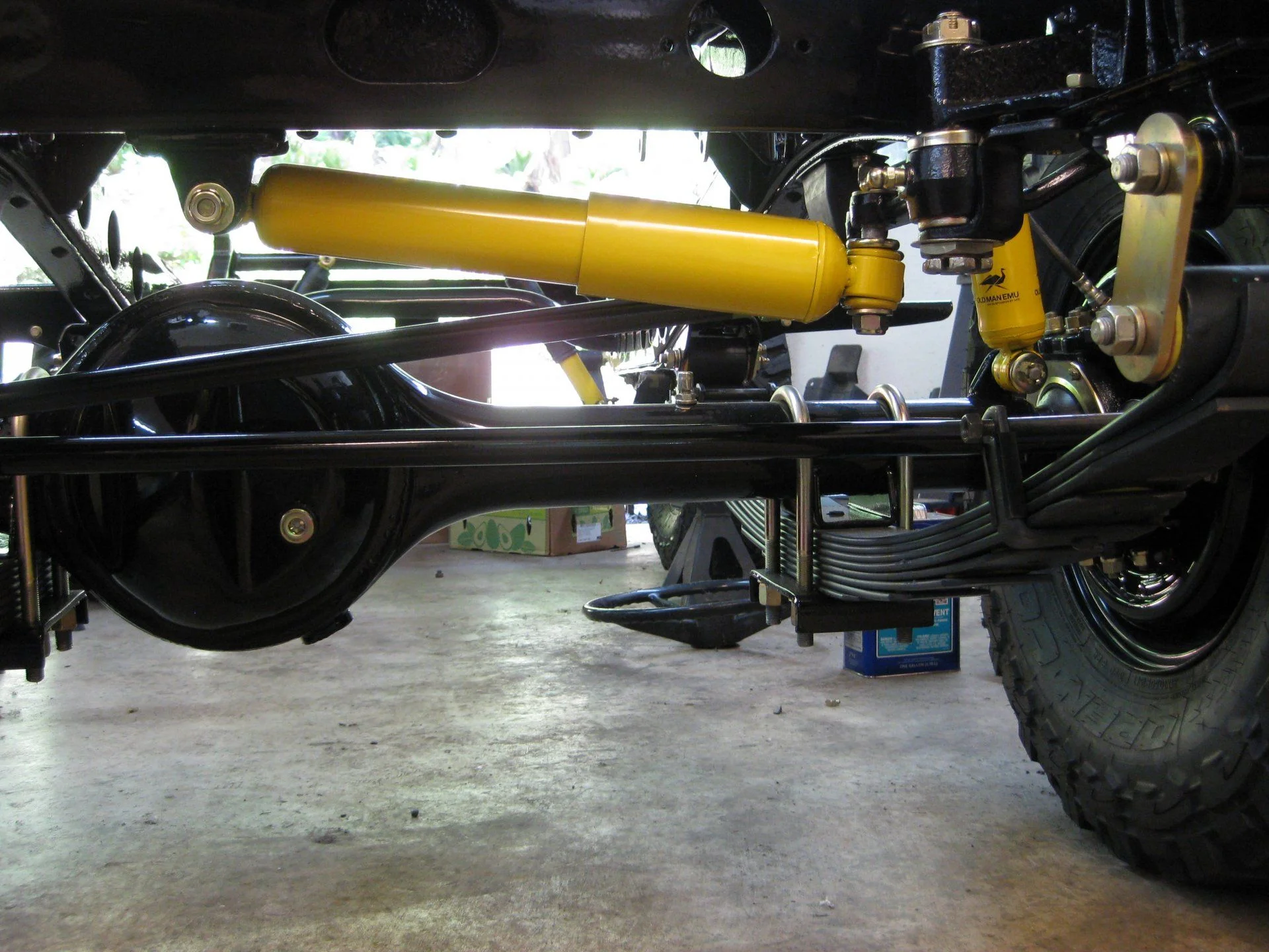

The new arm is installed now. There are ZERO issues with relay rod to shock clearance using the OME 2.5" suspension. At the closest point during the arc of travel, there is about 1/4" between the relay rod and shock body. At least we can lay this to rest now once and for all.
I added the drag link and steering dampener also. Nothing is torqued currently, just mock up.

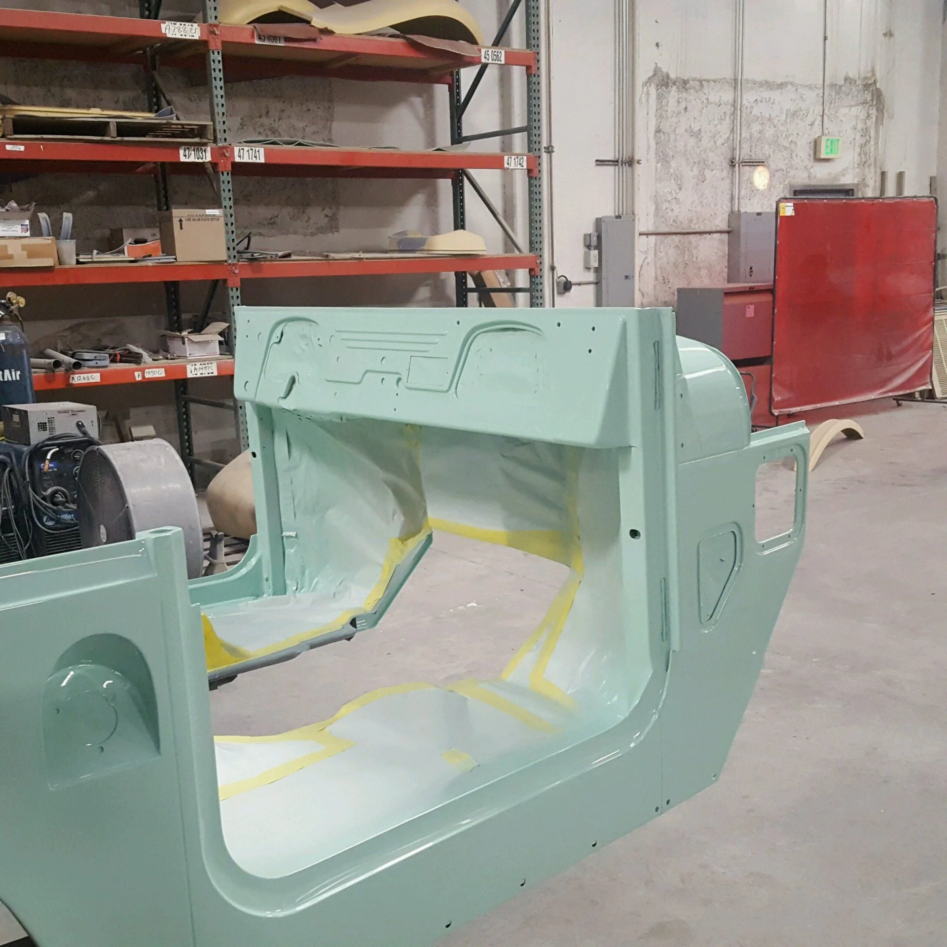

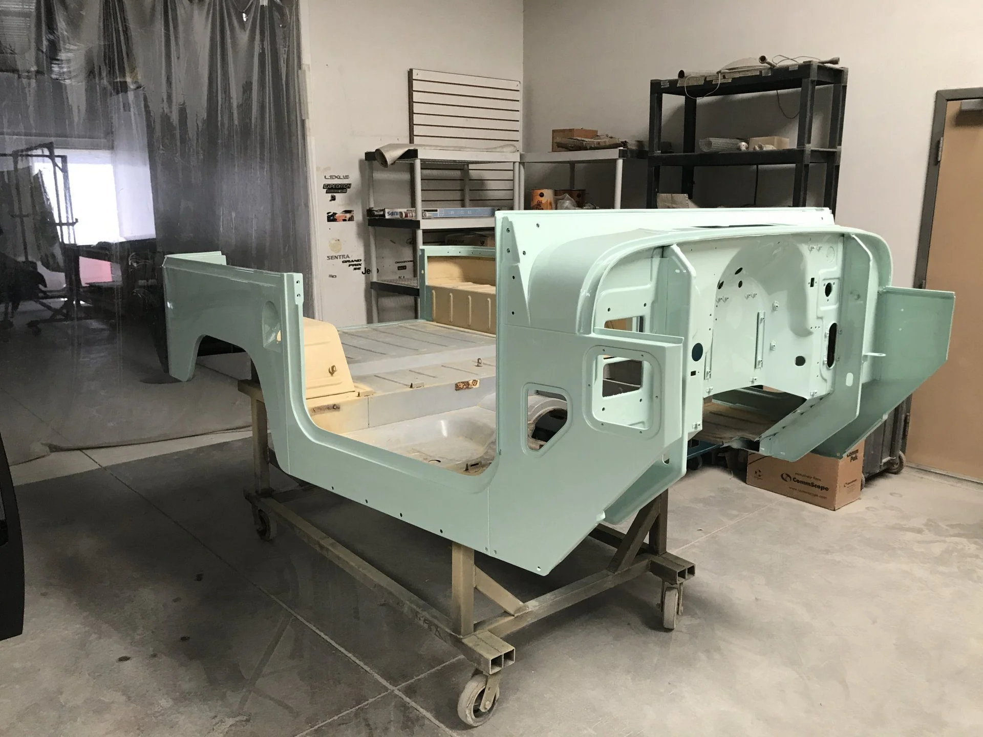

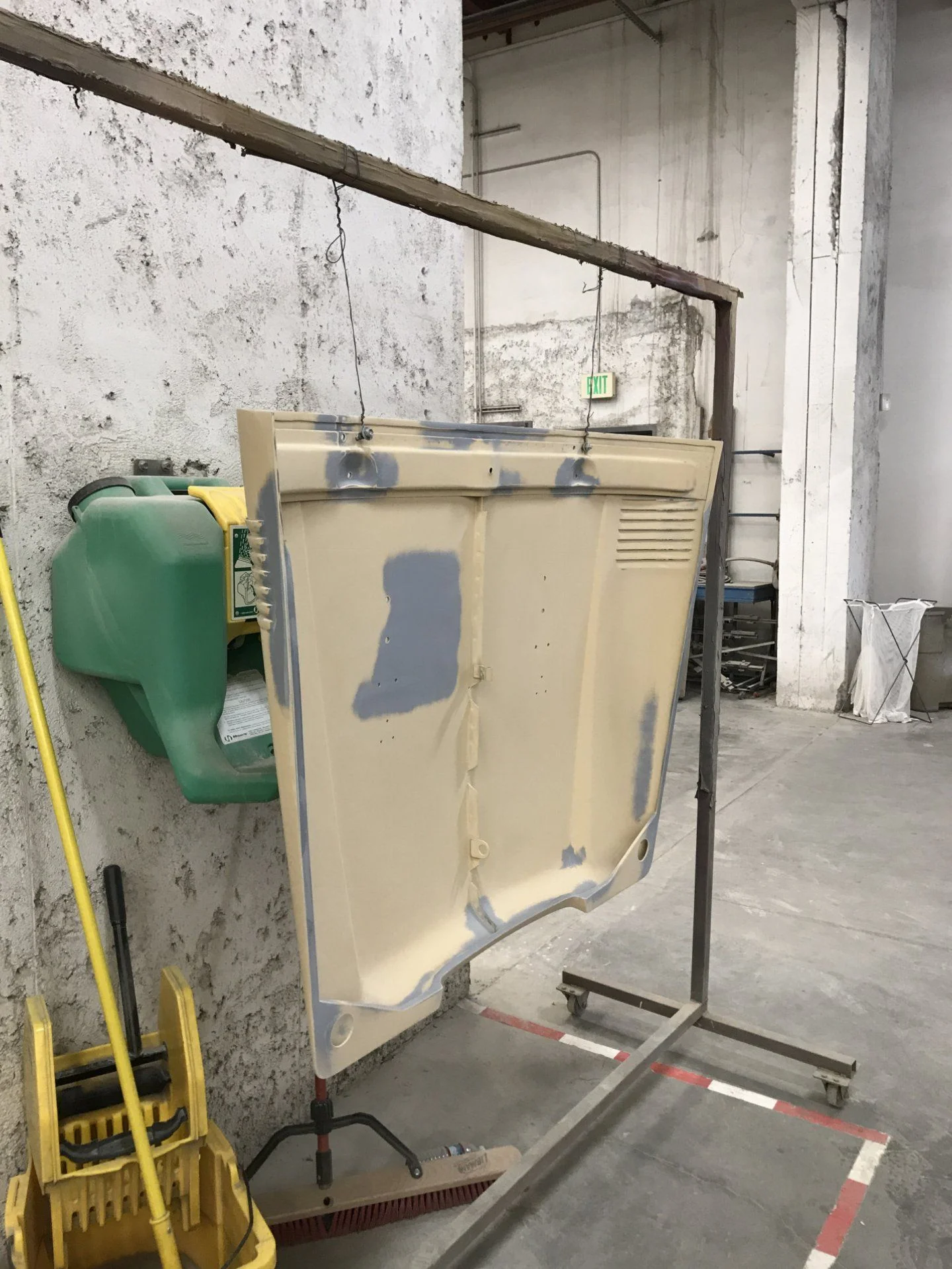

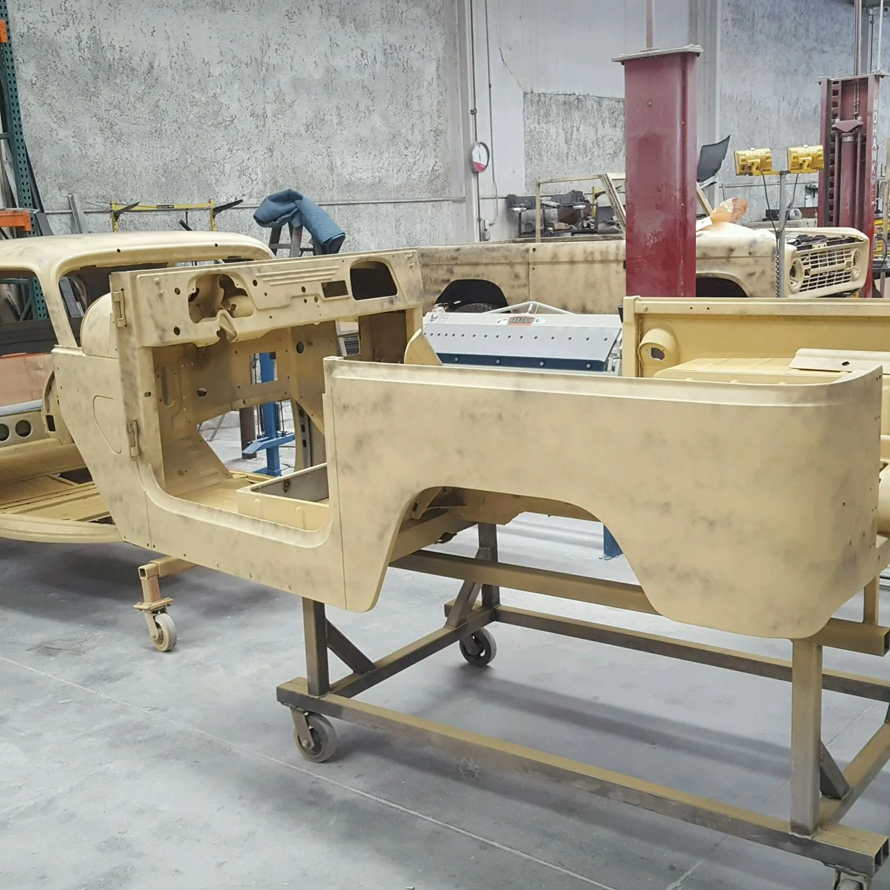

Stopped by H&S Bodyworks in Bakersfield, Ca this morning. Body & Parts are ready. All blocked and going to paint early next week. The color match sample on the Toyota Spring Green (#T-1028) came out nice as well.
Im in the process of sanding and repairing bondo patches on my '67. I'm strongly leaning toward spring green as the final color, but if the patch you posted above is spring green... that looks blue on my screen!
It's missing the clear coat is my guess and base colors tend to change a lot once the clear is applied.
Yes, I just went and looked at the sample here on the computer and WOW, yeah that isn't even close to what it is in person. Major color difference. I better pull that pic, so noone thinks thats the color. :)
Here is the Spring Green true color...
