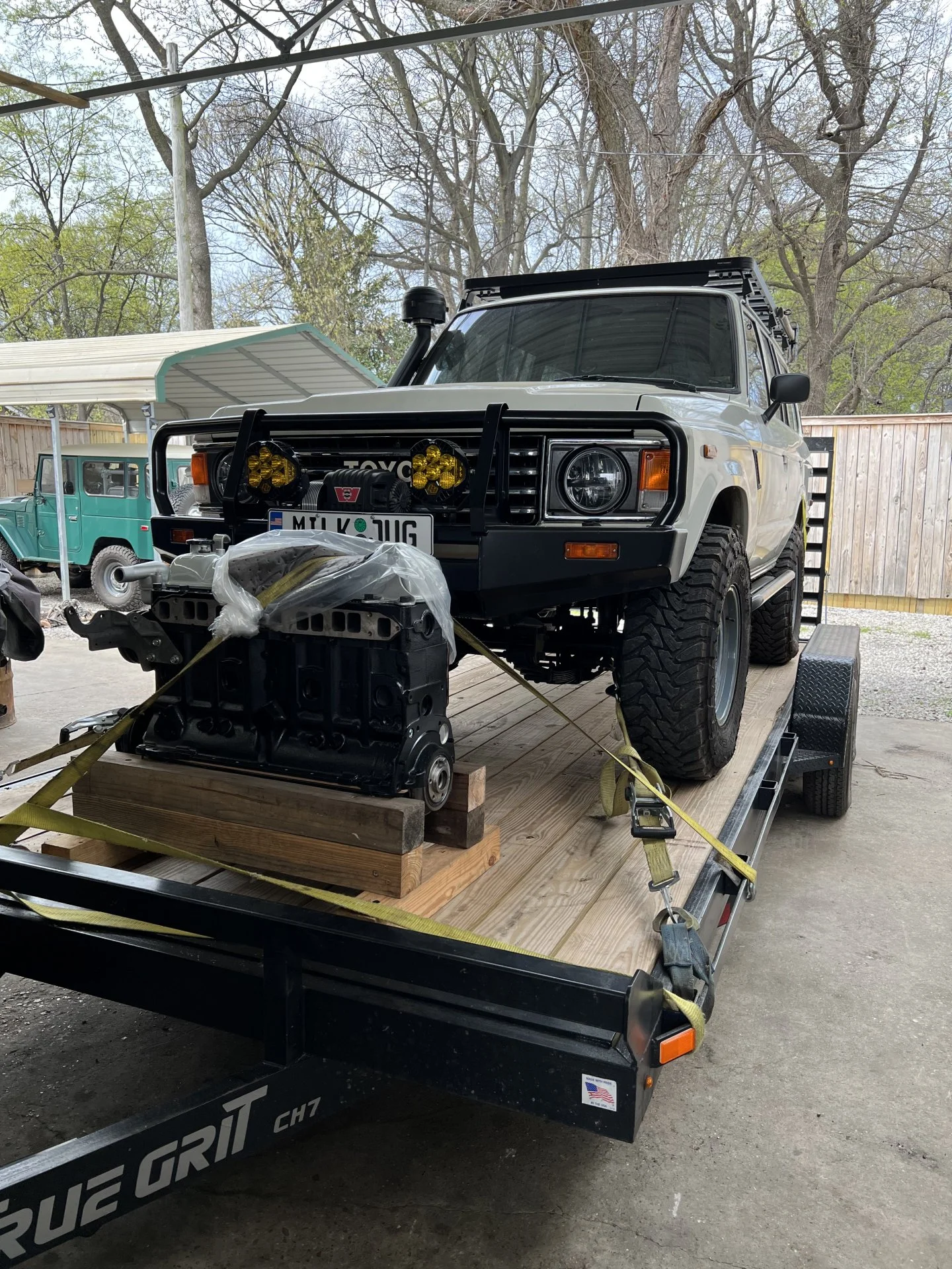

You should just send the engine to Nolan with the stickers left on it. He loves removing them.
I was mid fit until I read the rest of the sentence
Cowboy is ready for this to be in the main shop
Wonder what it'd take for that to make a wrong turn and end up in Idaho? :p

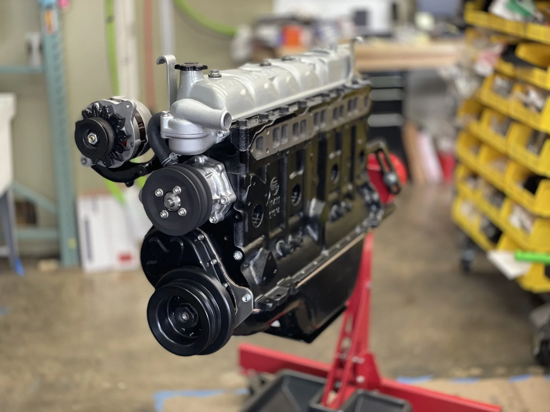

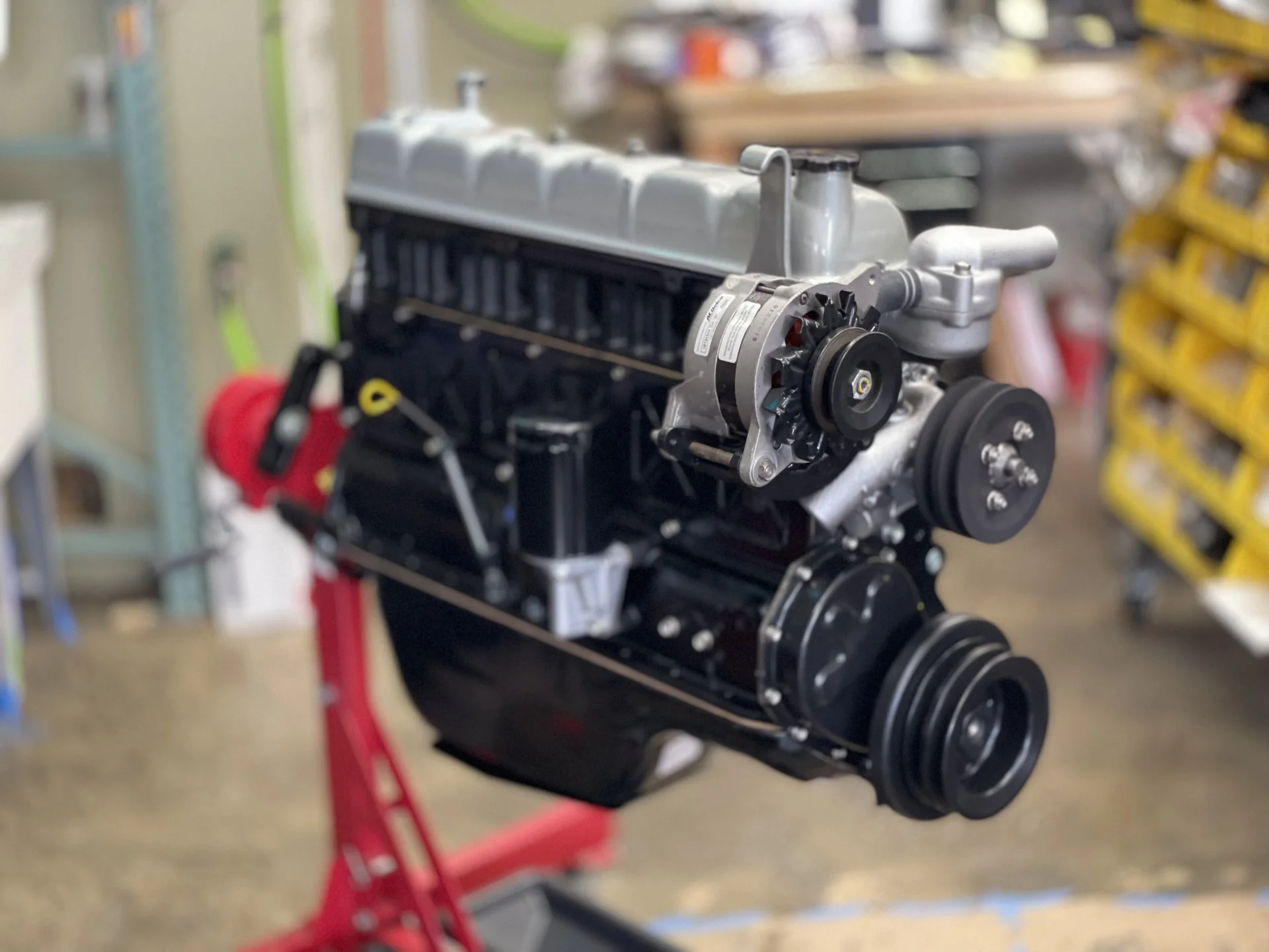

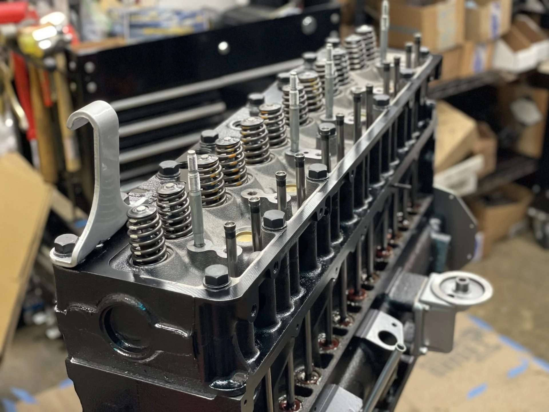

Few more pics…

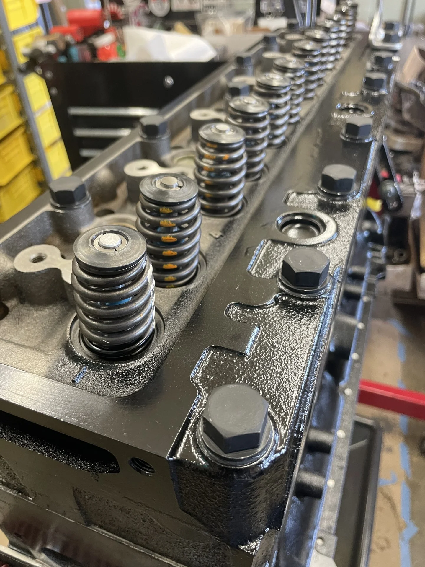

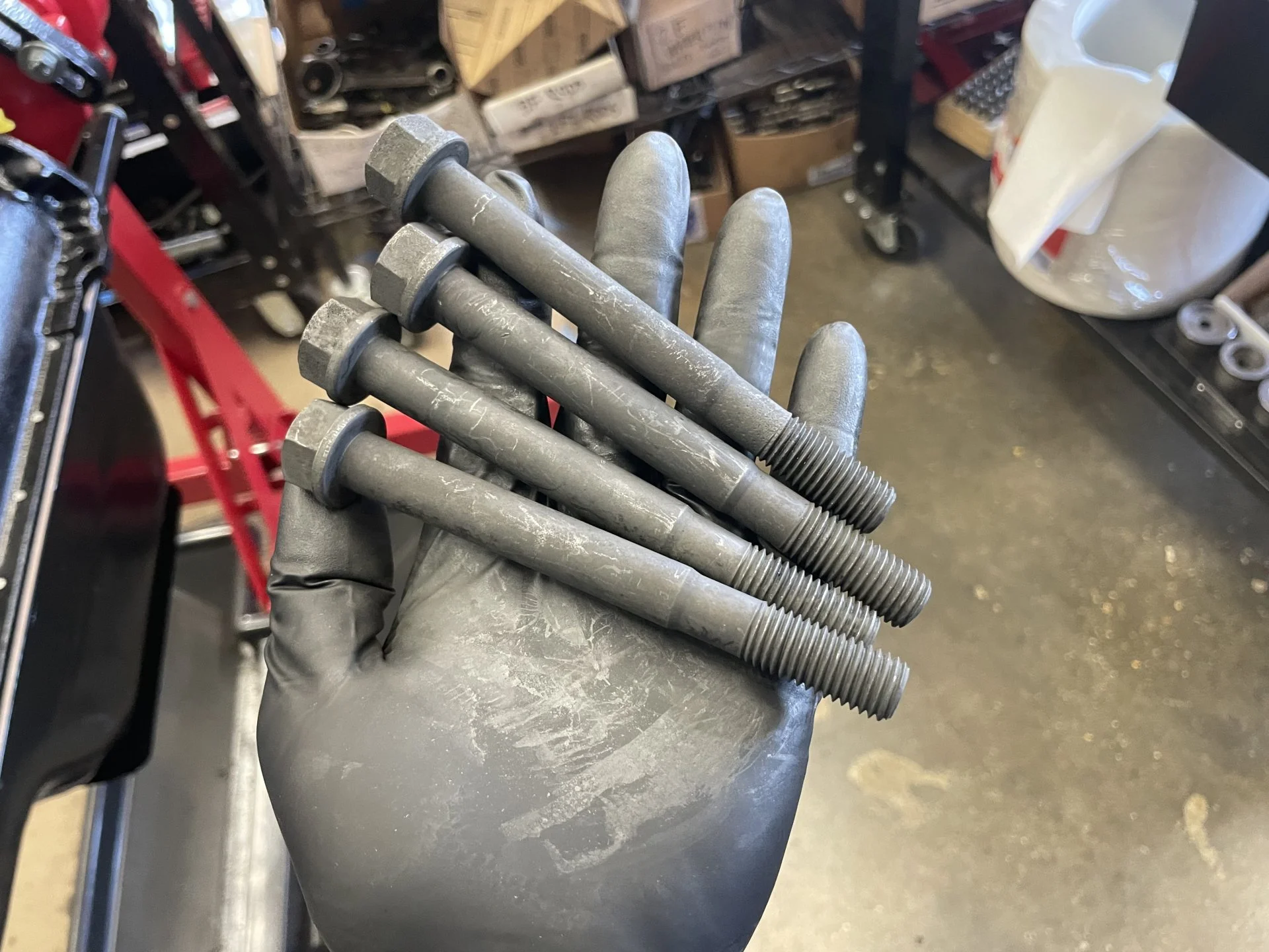

I soaked the head bolts in Evaporust, which has them looking new:
The heads of the external headbolts get rust protection/paint and, since this is a racing motor, all of the fasteners get assembly grease on the threads and under the heads:

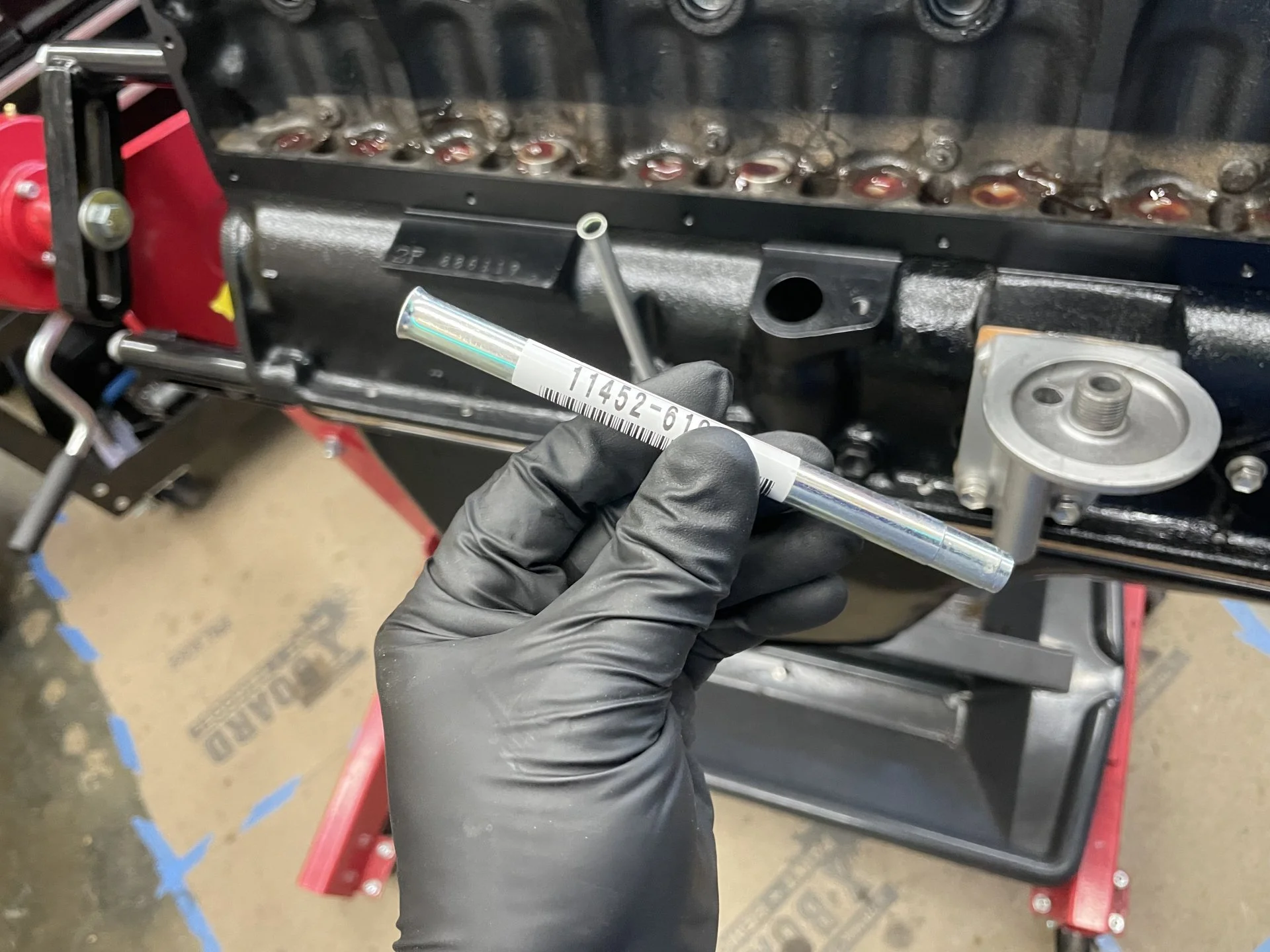

New dipstick tube. This has to be the worst Toyota sticker to get off 🤬

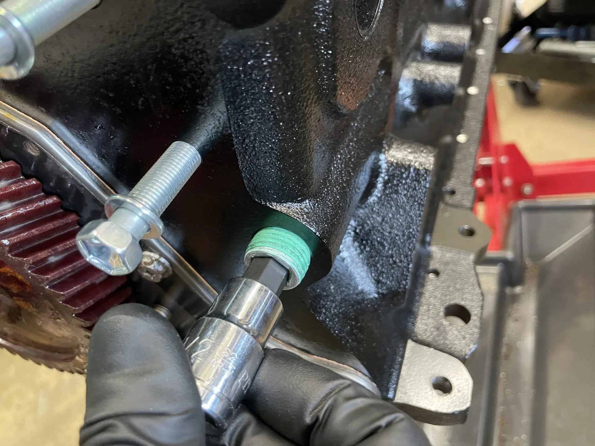

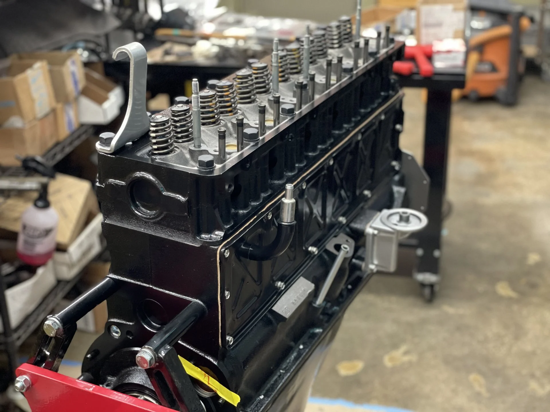

New main oil galley plug. Since this is a later block (85-ish +), this is a factory feature. The earlier blocks had a pressed in plug. We tap those for an NPT plug now after having a blowout on Nolen’s motor.
New OEM lifters and pushrods:
Then glued on the side cover:
