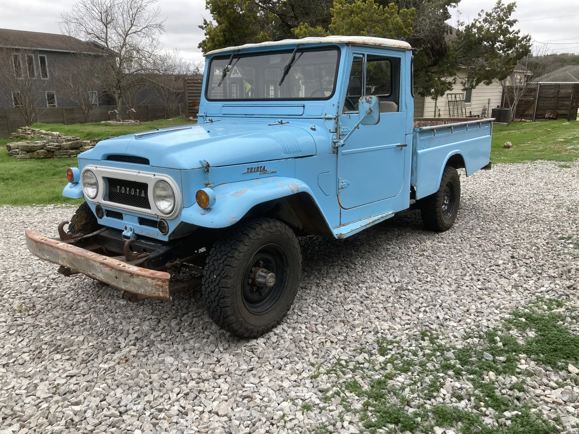

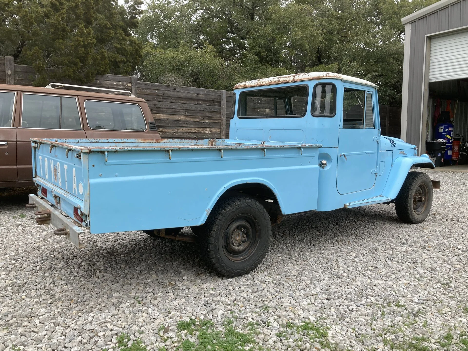

Ever since I joined MUD in 2008, I’ve always wanted a 45. I set a goal of owning a 45 by the time I turned 45. Missed my goal by 3 months but I’ll still count it! I kind of wrote off ever owning one but this popped up a few weeks ago and it matches my 72 FJ40. Sometimes you have to throw caution to the wind and go for it…and that is what I did! I took delivery on Saturday of this old girl. VIN: FJ45520410

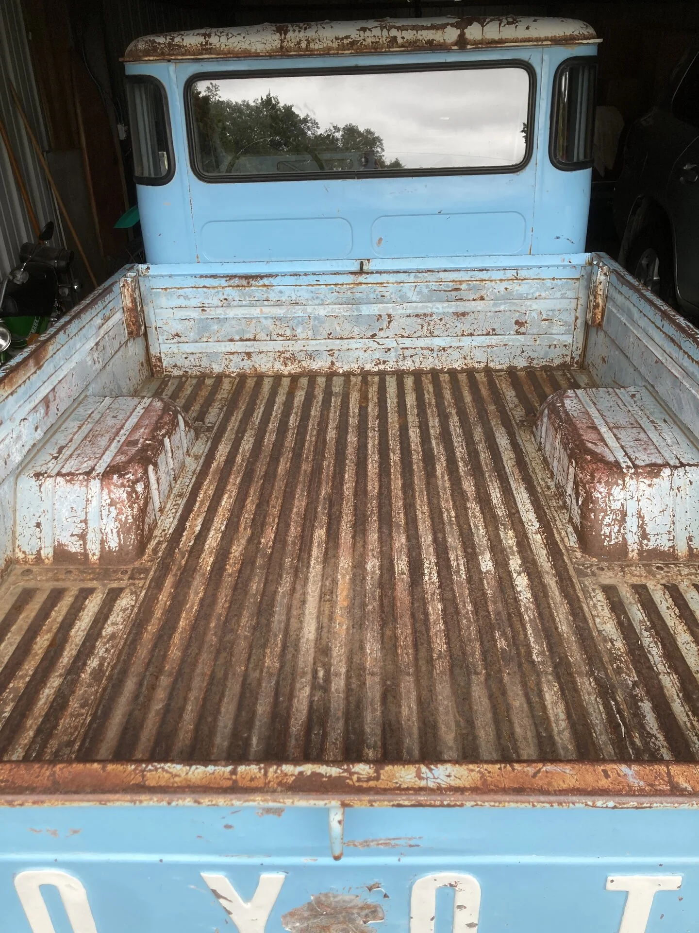

Very solid rig that has lived its life in the Southwest. Body is very straight and I’m shocked how great of condition the bed is in. Floors, rockers, corners, chassis…everything is solid.
The F runs great. Has a Weber carb but the OG SD40 came with it. All electrics work except the wipers and horn. It’s been repainted at some point but at least they kept the color original.

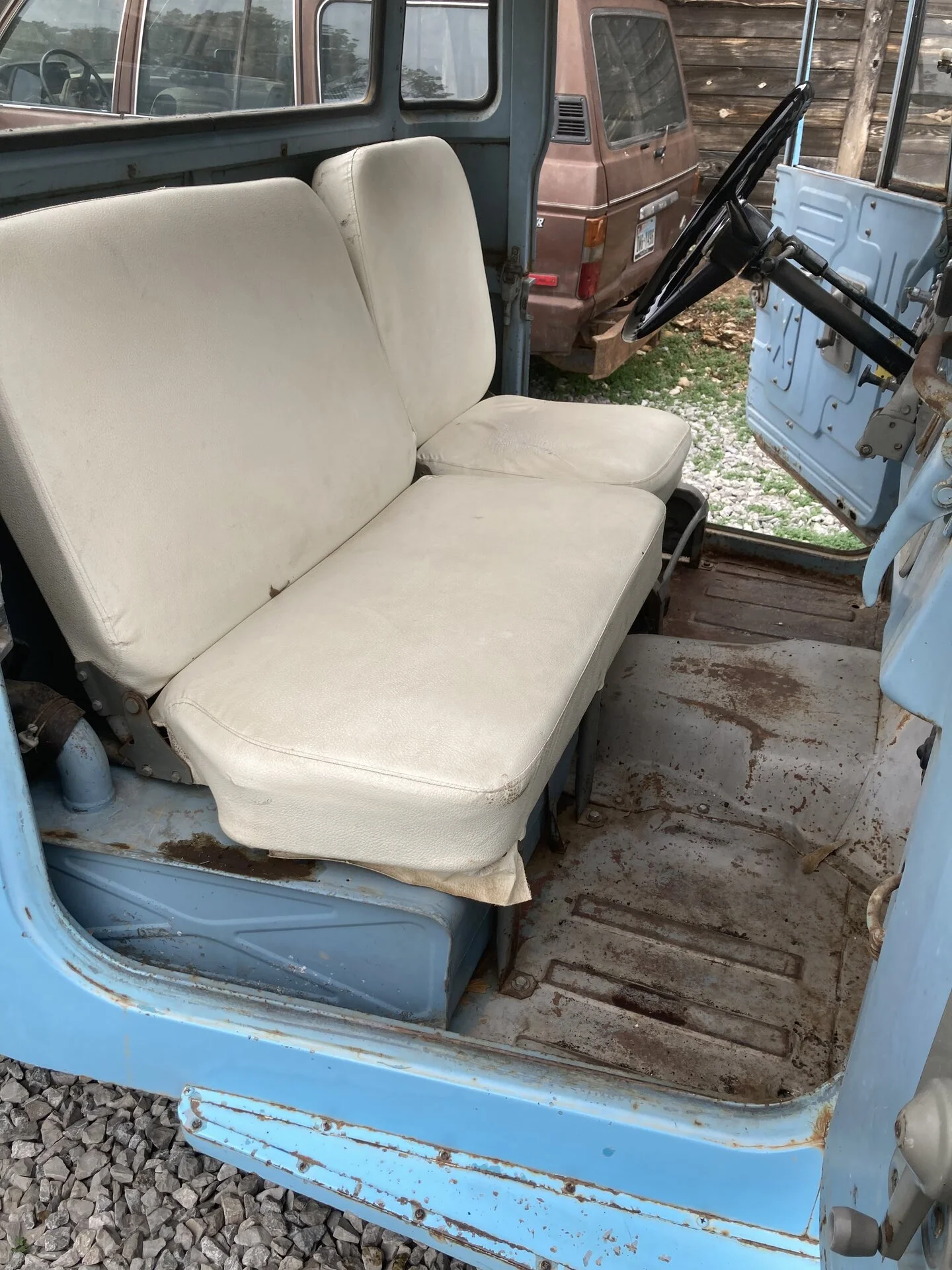

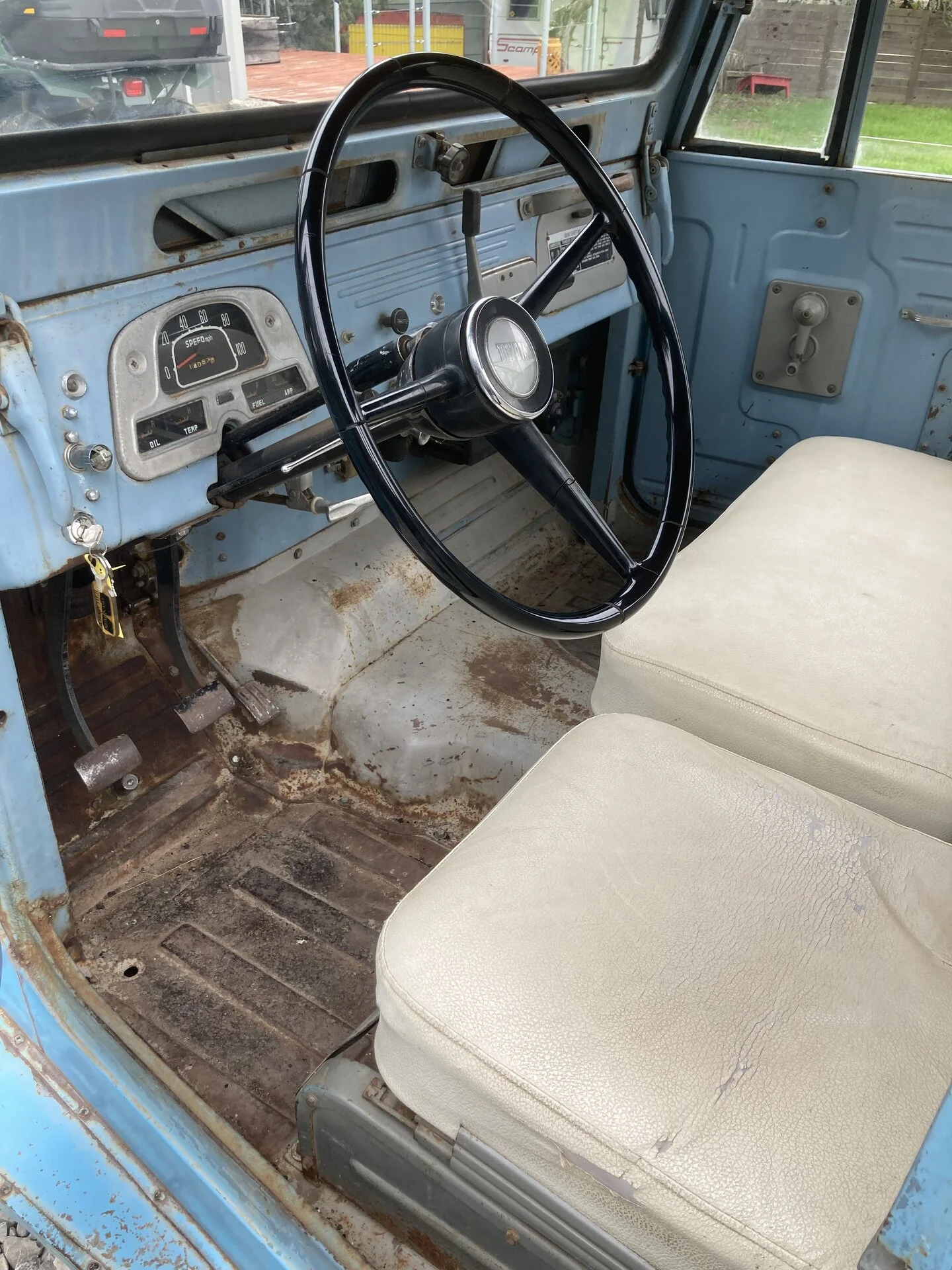

As with any old rig, it’s needs “things.” The column shift has got to go. It grinds between 1st and 2nd and is in general, just clunky. My floor shift 3 speed in my 40 is much smoother. Front brakes need adjusting as the front left wheel will lock up. I see a disc brake conversion in the future. Would really love to drop in a 2F and 4 speed or H55(I have one sitting in the shop with split case). Question is, do I cut the hole and find a 3 speed floor shift conversion or go ahead and do the 4 or 5 speed route. I don’t want to cut a bunch or holes.
Suspension is in dire need of an upgrade. The front leafs are riding on the bumpstops.
It needs seatbelts. Not sure it ever came with any. I know the eyebolts can be hard to come by but do y’all know of any suitable alternatives?

A lot of folks seem to really like the columns shift. Not sure if that is nostalgia talking or a true appreciation for it versus floor shift. Mine grinds between 1st and 2nd. I know 1st gear is not syncho meshed but it shouldn't grind when upshifting. I'm sure it needs some adjustment or perhaps its just operator error. I haven't had time to take a good hard look at it yet. I adjusted the slave pushrod but now I need to take a closer look at the fingers on the pressure plate.

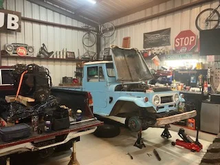

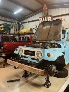

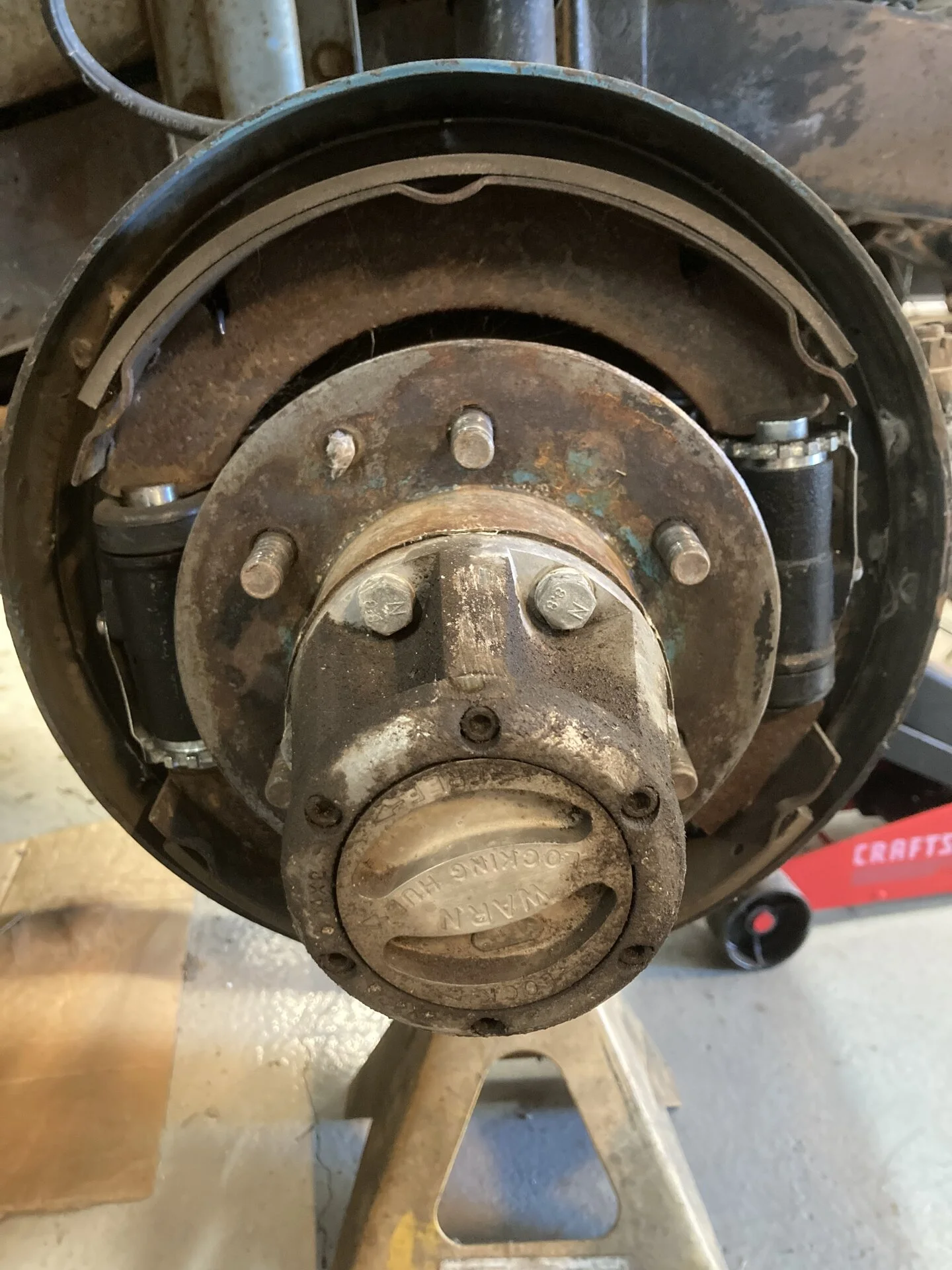

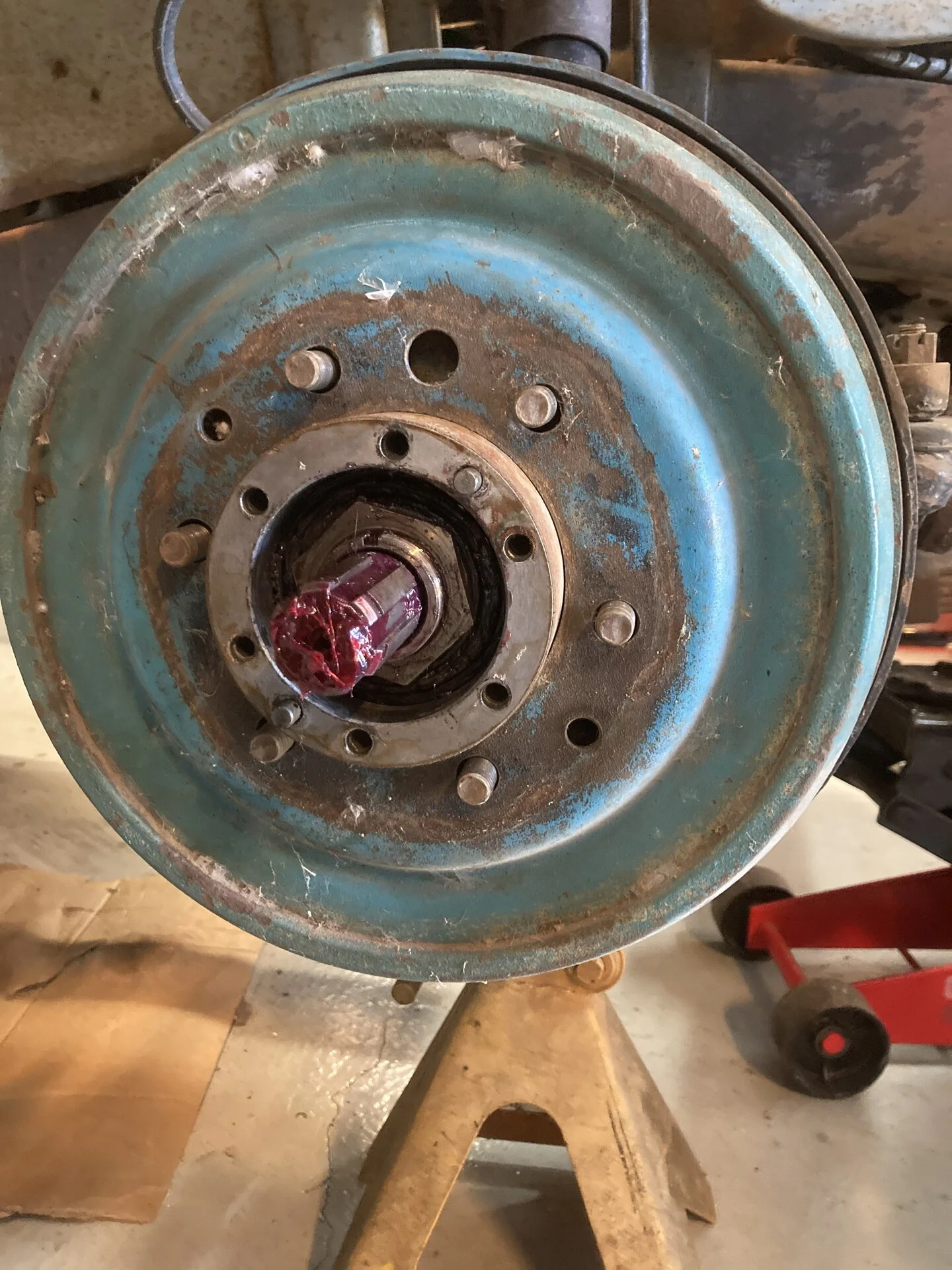

Made some incremental progress on the 45 yesterday. I had an issue with the front left wheel, locking up when turned just right and while taking off from a start. I thought brake wheel cylinder, but it turns out the wheel bearings were so loose it was binding up. Tightened both sides up, adjusted brakes and was happy to see the wheel cylinders look fresh. A former PO painted the drums …added 2hp 😮‍💨 Disc brake is eventually being swapped in.

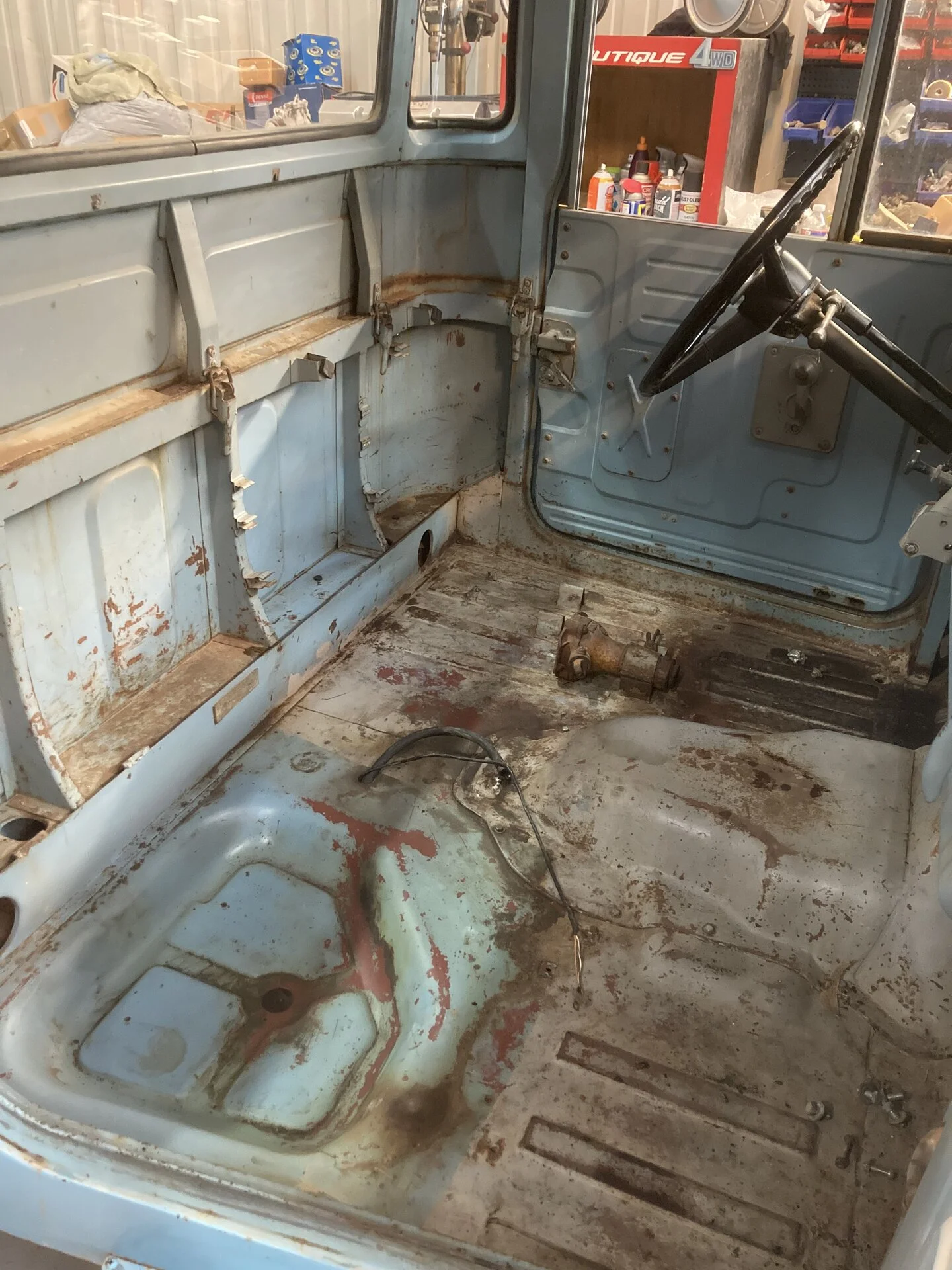

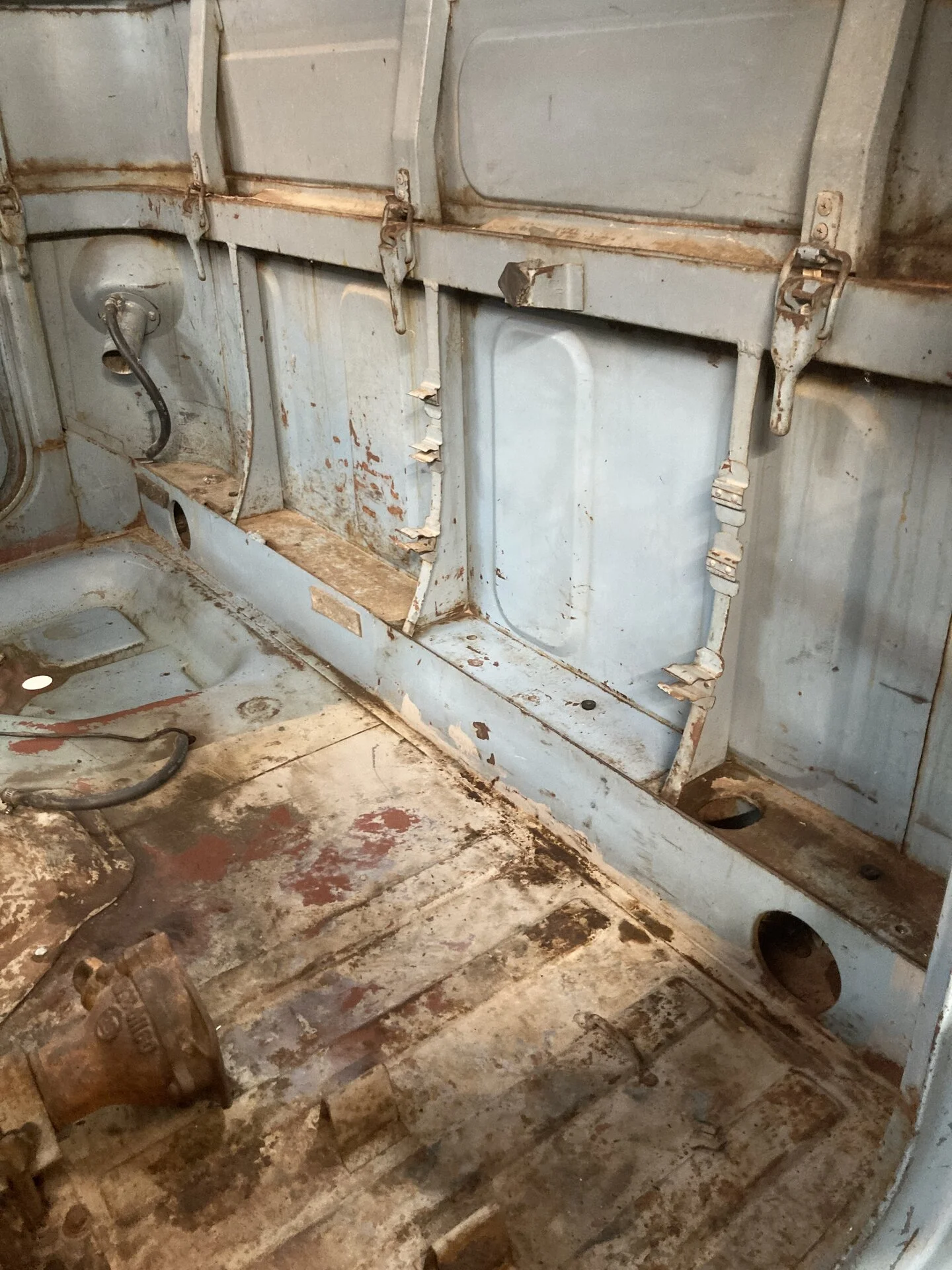

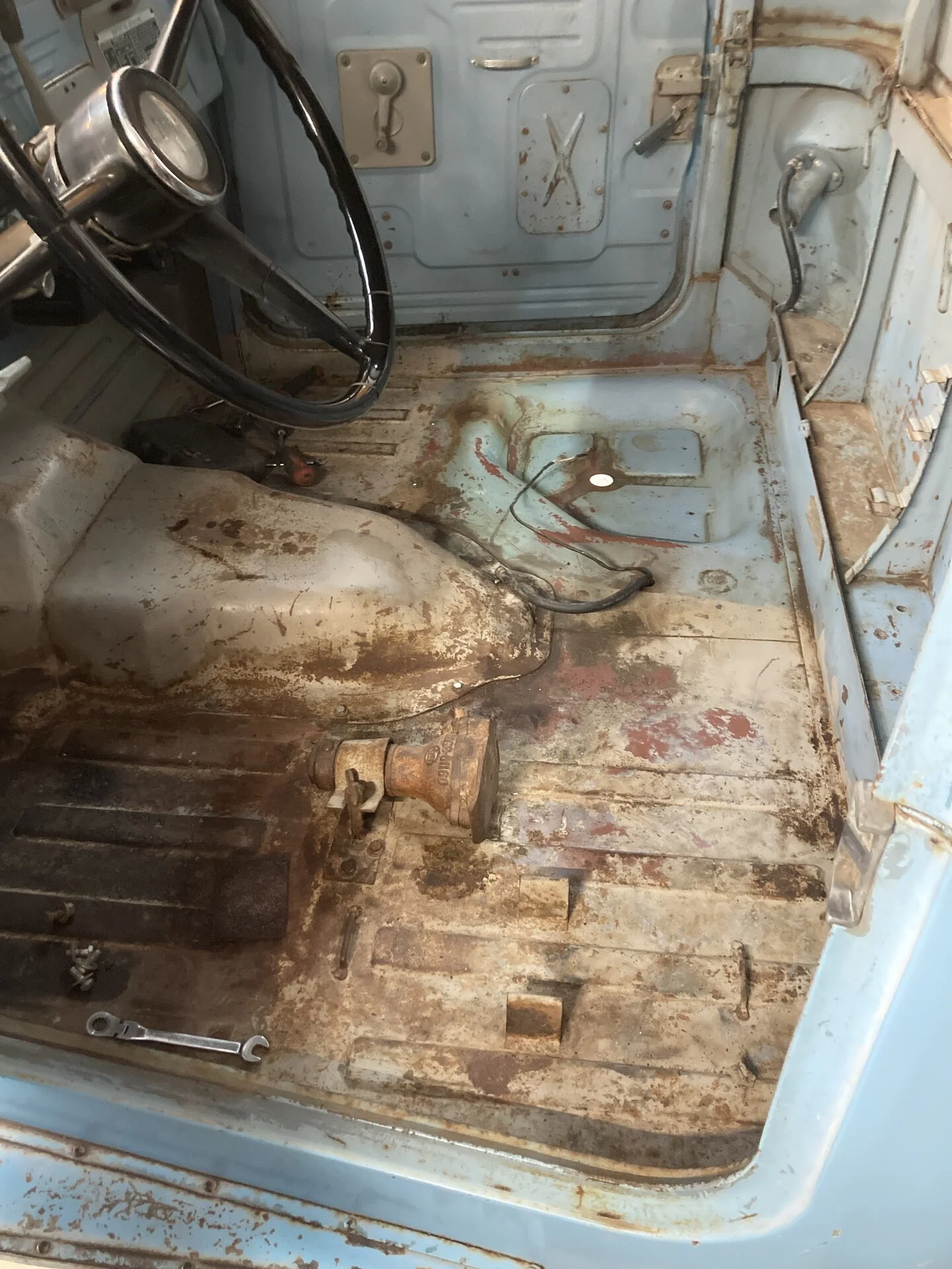

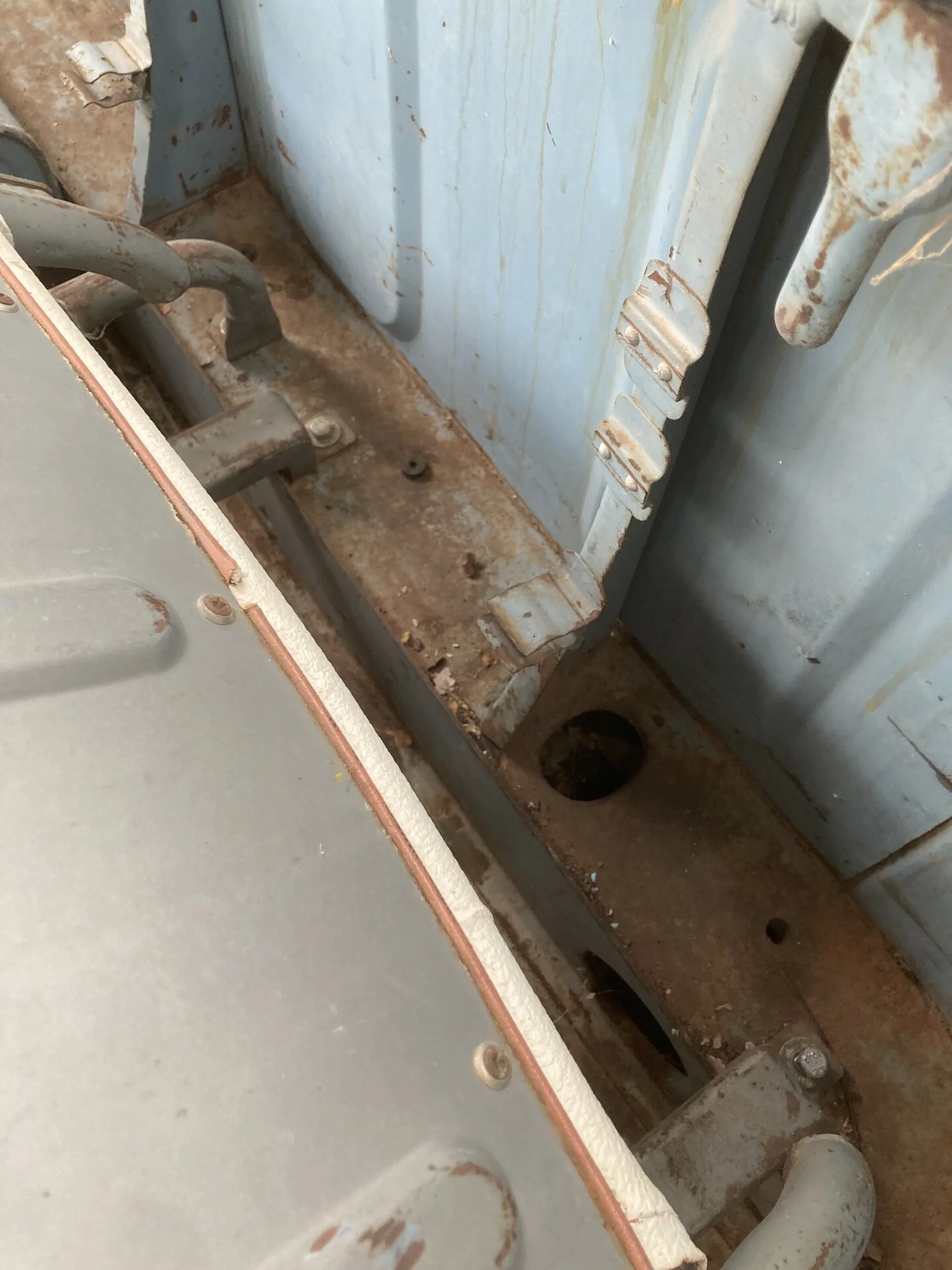

Next up was pulling the fuel tank for minor repairs. It weeps along one of the seams. Otherwise I was very pleased to see how solid the tank and tub are. Spent 10 min cleaning one section on the rear wall. This should all clean up very nice. A PO painted the floor with some sort of heavy, rolled on paint. A little scrubbing and I was able to get down to the OG blue.
This is my first adventure into an early series 45, so please excuse me if some of my questions sound elementary. What are folks doing for clutch master and brake master?? My clutch master looks original an it’s time for an upgrade! Once the disc brake axle is in, I’ll be going dual MC.

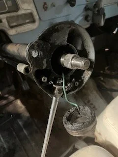

Finally found some time (and mobility after reconstructive ACL knee surgery) to start working on the 45 again. Just ordered a ton of parts which are starting to trickle in. New lift springs, shocks, tires, TRE, body/bed mounts, motor mounts, visors and several other random things. During my floor shift conversion and subsequent removal of the column shifter, I learned the rubber isolator for the horn contact has succumbed to the dry AZ heat during its life.
Have any of you early 40 guys run into this issue and what was your solution?
on my 71 I replaced it with a flanged ball bearing - I did loose the horn wire functionality though. Seems like it would be a good part to machine from some sort of high strength/wear plastic.
Sounds like a new product idea. :hmm:
I'm sure a 3D printed something would do the trick. Or maybe a urethane bushing...perhaps a trimmed down spring eye bushing? Or maybe some sort of epoxy? I feel this broken piece will stay in place like it is due to the compression but also fear could spin around.
