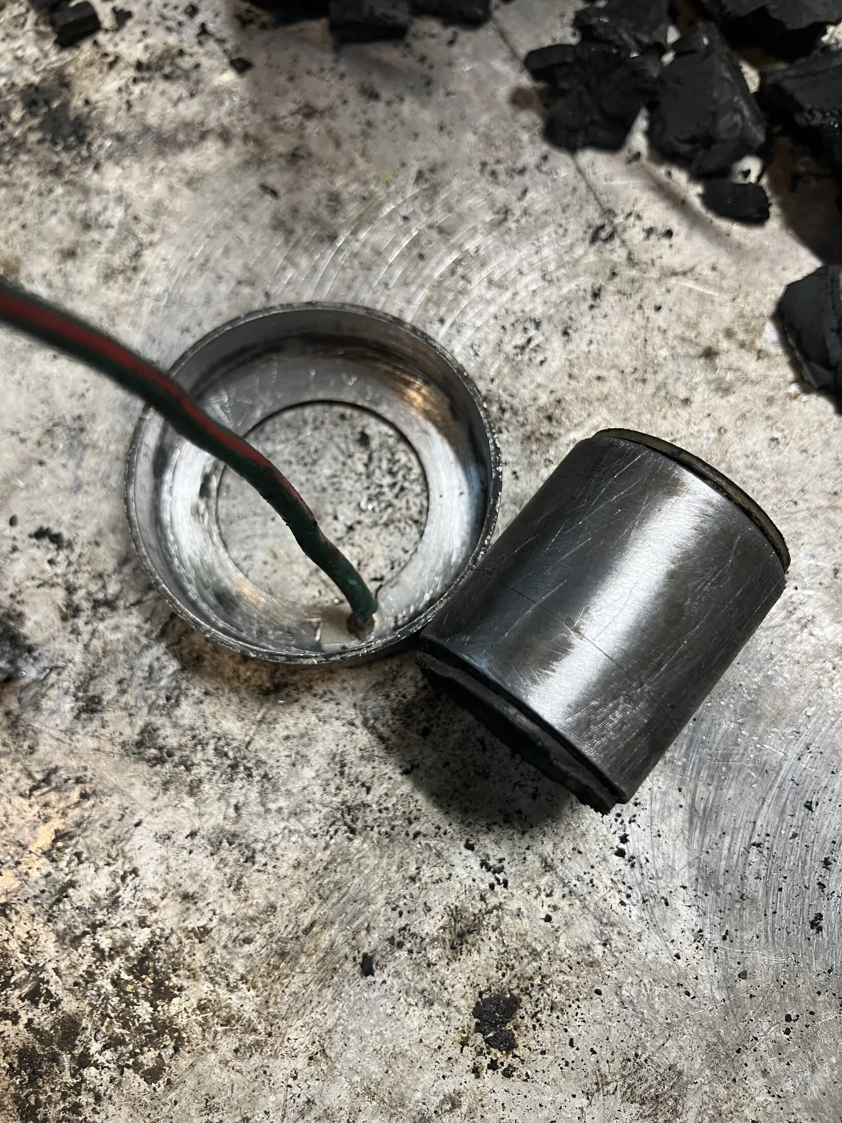

@red66toy I think Chase has something (maybe).
I think this is what I need. For $10, I'm giving it a go!
That is just the plastic bushing that goes inside the rubber bushing.
I think Cruiser Cult is trying to make the rubber bushing/horn contact available.
Yeah, I was wondering if that was the case. Oh well, new plastic bushing goes on the shelf. I ordered the other horn bits while I was at it so not all is lost!

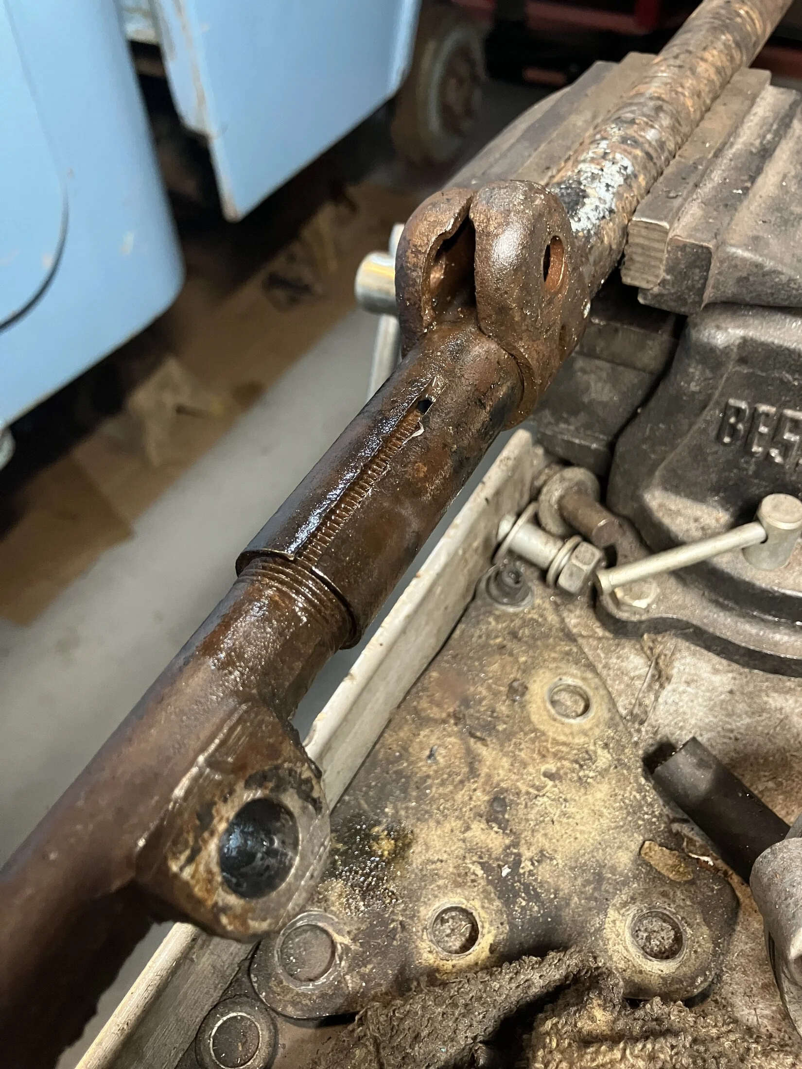

Was able to make some progress on the 45 over the weekend. I would’ve had it on all fours but I messed up and didn't order the correct rear spring hanger bushings, shackles or pins. @cruiseroutfit to the rescue and parts are inbound. Got all of the front suspension complete and all but one TRE…it’s being very stubborn. I’ll keep a steady PB and heat soak process going.

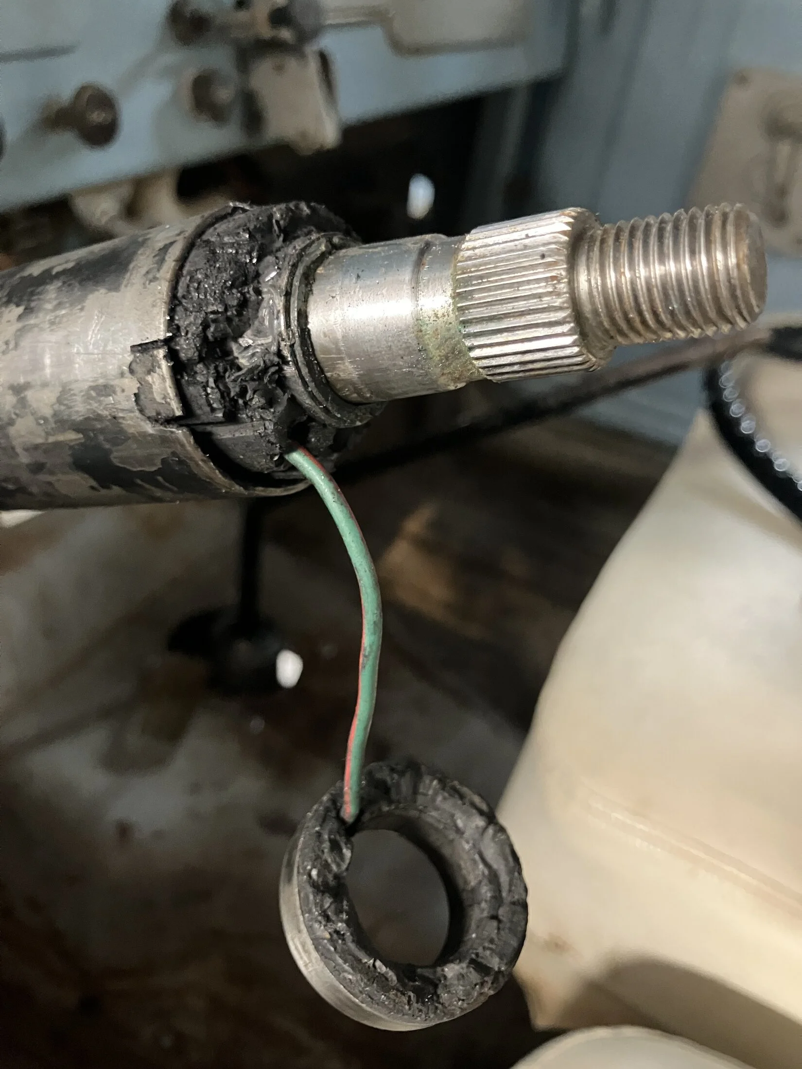

In the meantime, I was finally able to remove the last column shift bits from the steering column which also allowed for prep of @Cruiser Cult new rubber isolator bushing prototype. All parts are inbound so now just need to get this pesky TRE separated from the rod

Finished @Cruiser Cult steering column bushing for early 40 series. Perfect fit, high quality goods!
