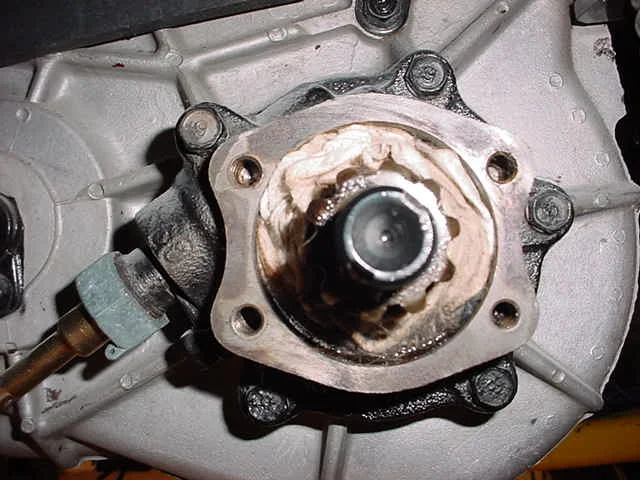

Intalled the remaining stainless steel brake lines I had on the calipers and rear drums. Pulled the driveshafts and started replacing seals. I had filled the T-case with gear oil before I started it weeks ago and it has had a small leak in the rear seal.
I figured since I was going to be taking the rear driveshaft out I thought I would just replace the front and rear T-case seals and the front and rear diff seals. Went pretty good except I got the wrong seal at the auto parts store.
If anyone knows a part # for a 79 FJ40 rear T-case seal, please post it. I need a # to x-reference tomorrow since I told them what I needed and they gave me the wrong one? If anyone knows, please try to post it up within the next 8 hours if possible.....lot to ask I know ;p

The rear transfercase output seal is 90311-45001.
