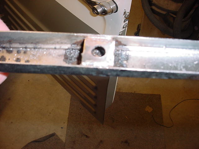

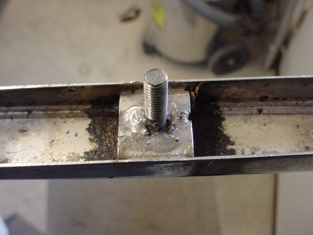

Started working on the chrome center hood piece. When I was removing it the center stud broke off. I drilled out the old remaining stud and then drilled a new hole about 5/16" of an inch. I ground down the head of a 6mm bolt and recessed it slightly into the hole and welded around the edge, should work perfect again.

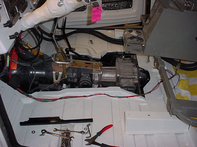

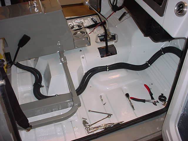

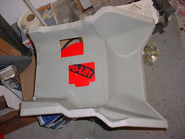

Installed the 2 piece tranny hump I had painted up last week. I put some 1/4" x 1" closed cell sef adhesive foam around the peremter of both pieces. Figured I would try to seal out as much moisture and dust as I can. I had to move my seat frame back for the hump install, but it's only 4 bolts so no big deal. Also fastened down my heater hoses running to the rear heater...When I had the powersteering hoses made I picked up some clamps that I knew would work well for that.

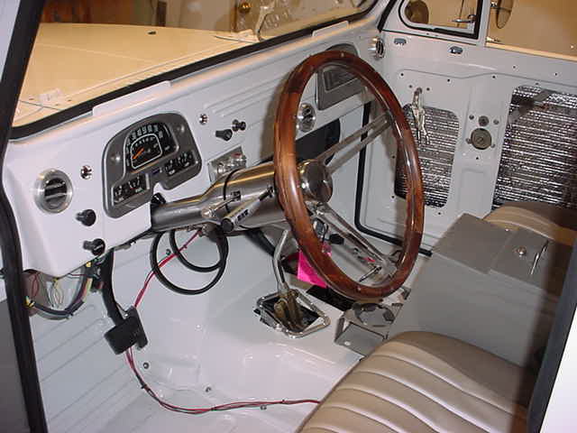

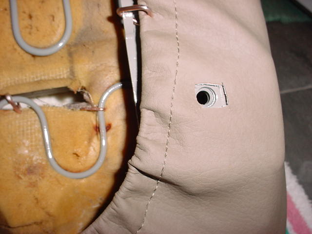

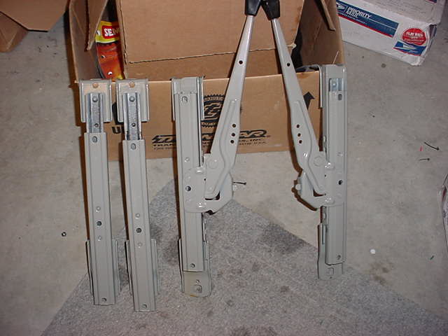

Dug the front seats out, I know some of you will remember those from an episode a while ago :) I hadn't installed the tracks yet so I did that and wanted to toss the front seats in....I might have to pop them out for making my carpet but for some reason I just wanted to bolt them in and see how it looks. I also might get a couple brake lines finished up this week and if that happens I might take it for a drive ;p
Installed my steering wheel, I might have to re-position it again, but at least all the parts are on and it works.

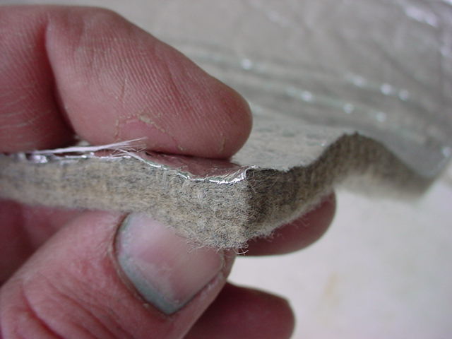

Had the sound deadening mat/heat shield stuff I had ordered a while back with the fabric for the seats. Also the carpet I had ordered then to. Got both of those out rolled out.....just kinda wanted to roll it out and look at it and get a feel for it. Start planting seeds in my head of how I'm going to sew up my carpet set.
