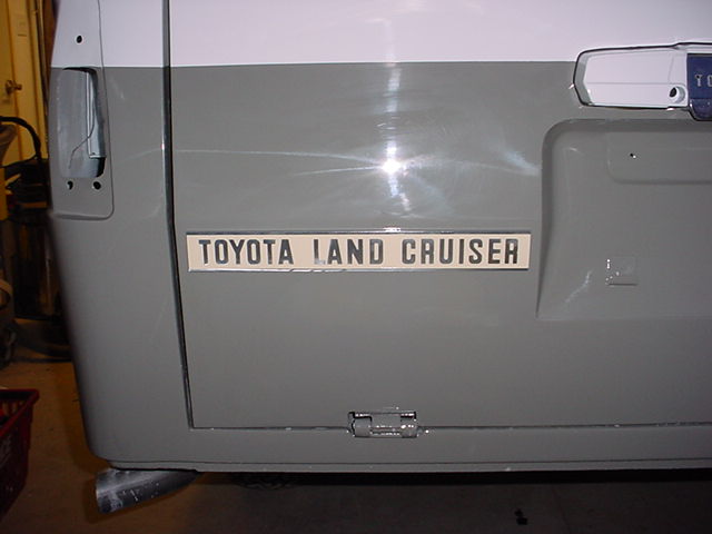

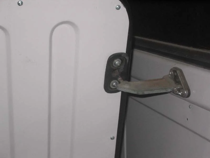

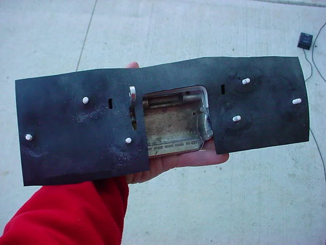

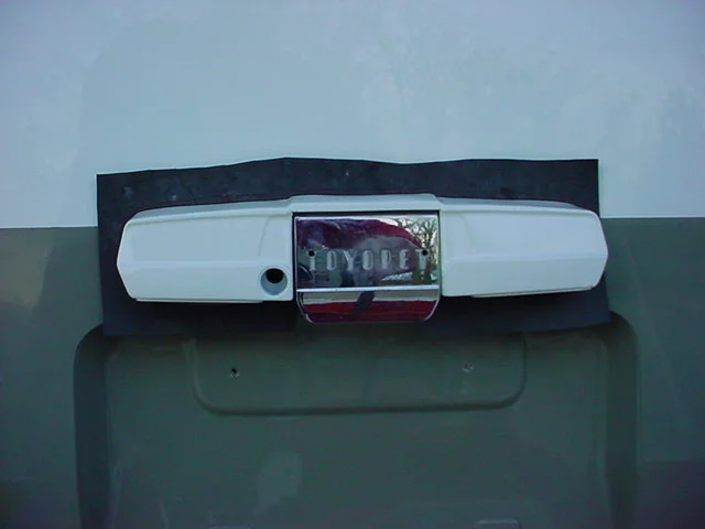

As far as what I did on the lv tonight, I made a new gasket for the rear tailgate handle and got that installed. I had the old gasket, but it was pretty shot. I used it to mark all the holes first while leaving a lot of excess material. Installed that rubber on the handle and then on the tailgate. After everything was tightened down I used a pen and traced the outline of the handle on the rubber. Removed the handle again, cut it out on the line I made and re-installed......actually worked really good and looks factory I think.
Installed my 4wheel drive emblem and then taped on my landcruiser emblem I made just to get a look. Going to get some auto emblem adhesive tomorrow and get that glued on for good.

Where did you source the rubber material for making the gaskets? Also I noticed you were cutting them maybe 1/16" oversize?

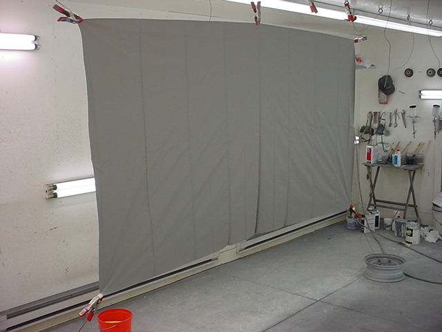

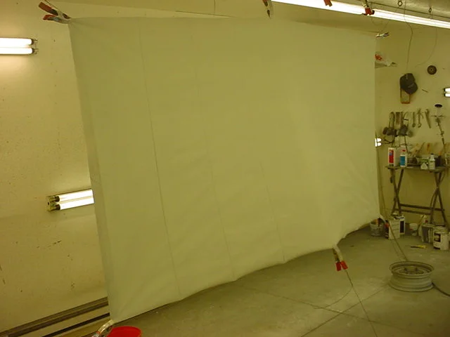

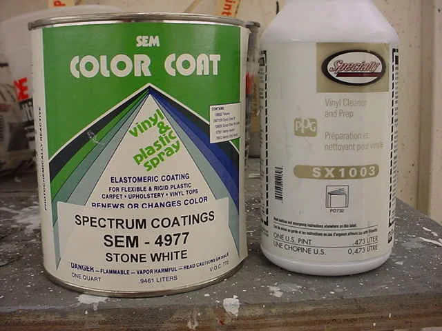

Headliner showed up around 11:30 a.m., when I went home for lunch I scrubbed it down with the vinyl prep sauce, washed it off and hung it up to dry...per the instructions.
When I got home tonight I loaded up the gun with the vinyl dye stuff and sprayed it per the instructions....1 light coat, flash dry 5 minutes and 1 wet coat.
It worked amazingly well??? The stuff is as thin as water so you can tell right away it's not a paint and I think that vinyl prep sauce softens up the vinyl. It just kinda soaks right into the fabric right away, in fact it seemed dry to the touch within 5 minutes and I could fold the fabric back and forth with no problem. I guess that's what it is supposed to do and it's designed purpose, should outlast me.
Took a pic of the stuff I used and then I realized the can wasn't dented, 2nd pic is for you Mike :D

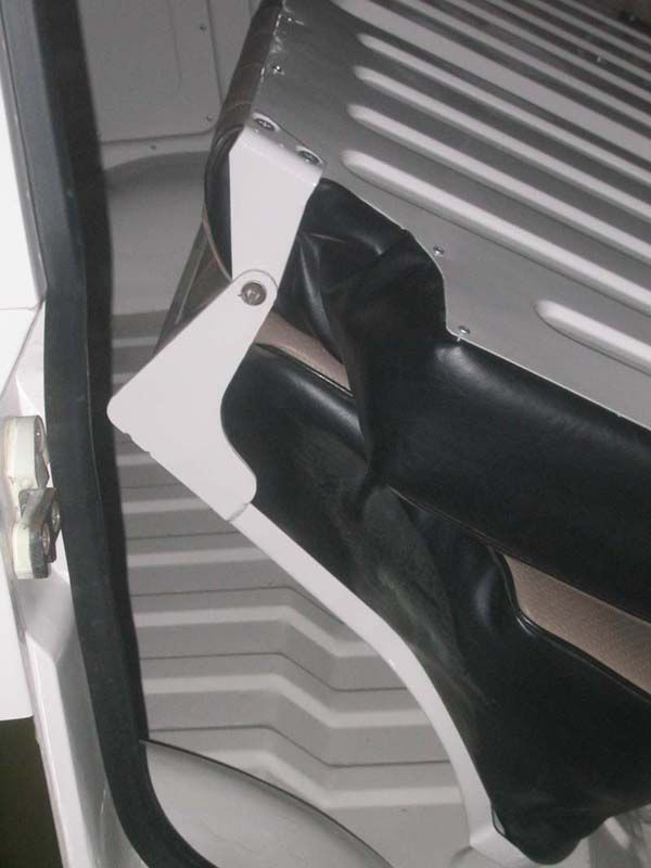

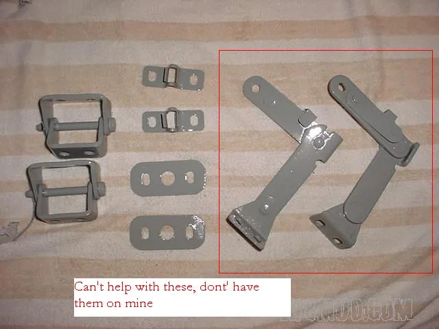

Edit: The last 2 pics are the rear seat brackets that Semlin sent me, blasted and painted up.....Can any lv owners post up some detailed pics of where these brackets go??? Mine didn't have any so I can only speculate?

Got the rubber from MSC, Burma nitrate rubber in a 50A durometer. Yep, approx. 1/16" oversized just like the OEM one.

Here is what I have. I edited one of you pics. #1 goes against the pannel first, then#2 and after that a piece of rubber that is not pictured. You should have threads that can be screwed directly into. If you don't know the correct size I can find out, but it will take a day or two.
Hope these help. I was in the same boat as you are in, so my stuff may not be 100% correct, but it all fits well and works great.
HTH
Dave
Absolutely perfect pics Dave!! I understand everything you got there, makes sense now, Thanks!
Any idea on those other 2?
