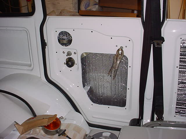

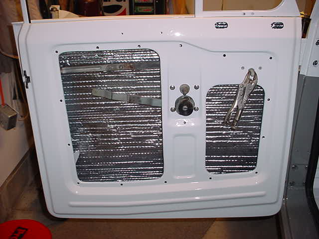

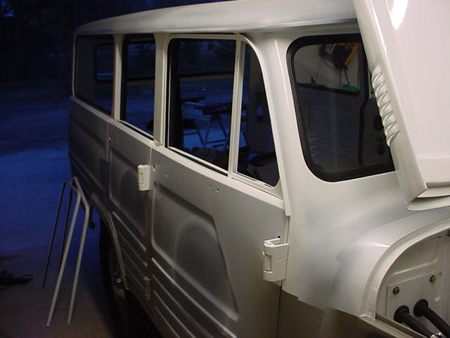

Sorry about the delay in posts again. Spring has just came so quick, work is taking it's toll right now. Haven't had a chance to do anything until today. Pretty good day, several interuptions with various things, but overall a fairly productive day.
Started off by intalling my bear jaw latches and the stock door and window hardware. I didn't blast and paint any of that hardware because it wasn't to bad. I cleaned them all up in the parts washer and they all look ok. I guess I could have, but nobody's going to see that stuff anyway. Got the pics installed on the jams also and got all 4 doors closing nicely. With the weatherstripping on and those latches, it closes like a brandnew Toyota!! I can't believe how well they work, also with the interior door latch/spring hooked up they return and open nicely from the inside.....very, very, very happy how well the doors work! :)

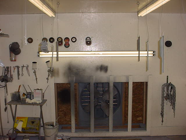

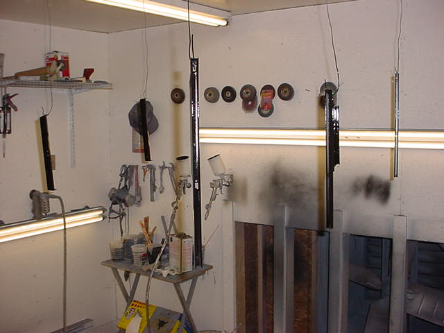

Sandblasted my hinges and some interior door hardware for bump stops and the glass. I am missing one of the glass pieces for the tracks......Treeroot, see posts below for urgent parts request if possible. I need this one bad. :frown: I got the other stuff all blasted, epoxy primed and painted, might try throwing in some door glass tomorrow.

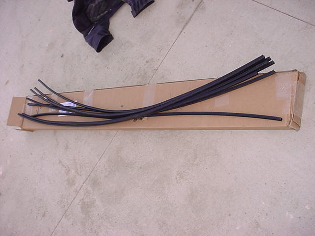

Also, about a month or so ago I ordered some samples from JC whitney for the window felt/track weatherstripping. I chose the one you see in the pics, seems to work very well. I did have the neighbor take a break from welding sheet metal in his 40 Ford pick up he's working on and give me a hand. He had to pull the weatherstripping as I pushed it in from the end. Pain in the ass, but we got it done and it looks perfect.
