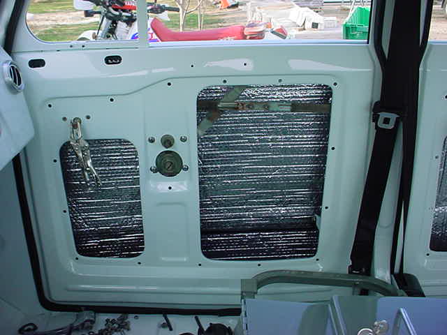

The dynamat or whatever you are using in the doors is a great idea. What is your plan for carpet? SOR? Are you going to run the firewall insulation?
By the way, we ended up getting a sewing machine called the camper's tentmaker (yeah, funny name). It's a walking foot machine that is a good mix between heavy and lighter use that can do straight or zig-zag. You were definitely right about needing the welting foot, makes a big difference.
I bought the carpet and sound deadening material when I bought the rest of the fabric for the seats. So I will be sewing up my own carpet for the lv. SOR's stuff doesn't match and they wouldn't do any other color than grey.
As far as the firewall insulation I may run the matting and carpet up the firewall, so it will be all in one. Not like the orginal or SOR's stuff, we'll see, not that far yet.

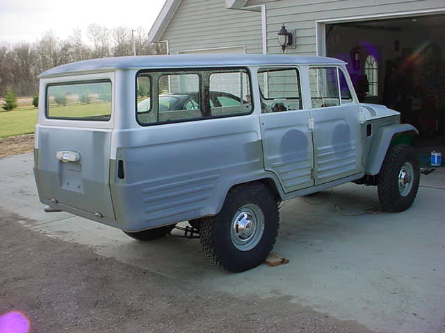

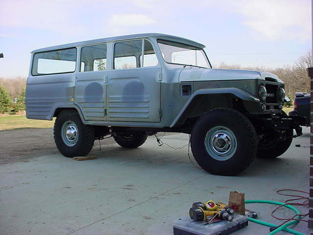

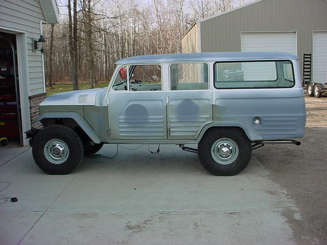

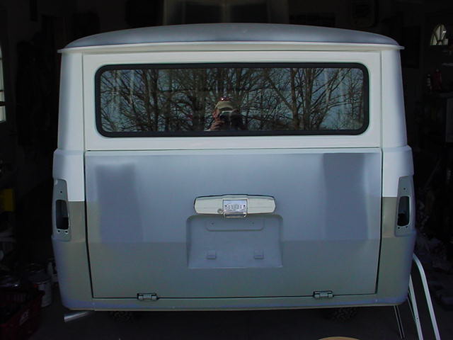

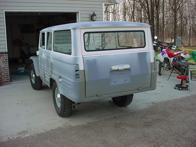

Pretty good day on the lv today, had a few Easter things to take care off in the morning, but got going on it in the afternoon.

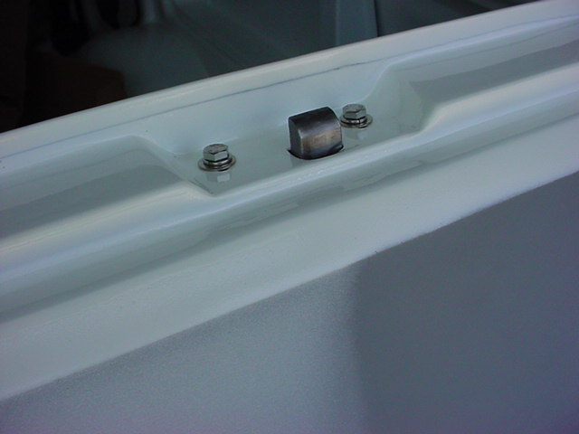

Got my tailgate back on and closing nicely. I will say I got my ass kicked getting the linkages adjusted and everything where it closed nicely. After a good couple hours it all works absolutely perfect. Also got the upper hatch adjusted and closing nice. I installed my rear tailgate handle for fun. It will have to come off again for paint, but I wanted to see it on there and how nice it worked. I'm hoping the one Semlin sent is nice, mine is cracked up.
Then I started on the door glass. All the window glass has been sitting in my shed for over a year. All the glass had overspray on them from previous PO's and paint. Took a few minutes and scrapped all the over spray off, wiped them down with reducer and then glass cleaner. I have all the door glass installed except for the front drivers side door............You got that part in the mail yet Mike ;) If I would have had that track, I would have all glass in.
In any event the glass that's in there goes up and down pretty good. It's farily tight, but I imagine it will take a while for that weatherstripping to break in.
Few pics from different angles for fun, everything pretty much fit up and working nicely. I'm hoping to work on the drip edge this week if that goes well, might start wet sanding next weekend??
Matt

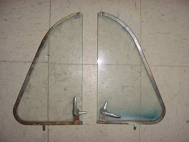

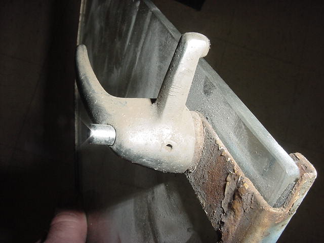

Question,
How do you get these apart? I think that lever and shaft go through the glass?
Thanks, Matt
Matt,
Looks like a roll pin holds the lever on..is there a hole in the other side as shown in your picture? if so there is a small roll pin holding the assy together.

I do not believe shaft goes through the glass. It should be easy to tell and area is clean and a flash light against the glass.
I have had simular pieces taken apart at a glass shop. They beat the chrome rails off. They had a vise that help glass and tapped the out edge off.....made me cringe looking at then doing it. But it worked.
You having new glass cut?
Re-chrome those pieces???
T
I have ZERO experience on Toyotas', but there usually is a roll pin a spreviously mentioned. There should be a shaft, spring, and some kind os washer in there. Good luck!

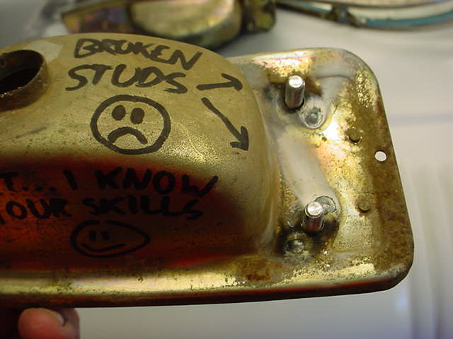

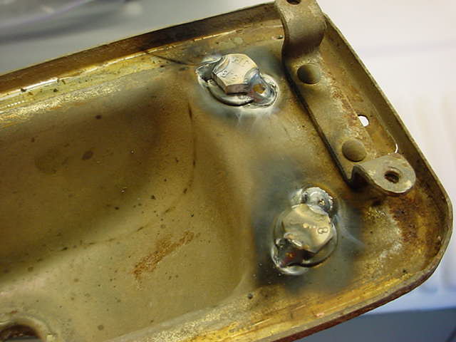

Welded new studs into the headlamp buckets that Treeroot sent me, should work good.
Went to work on those vent windows, the roll pin did punch out and there is a shaft going through the window. Actually came apart rather easily? The rubber in the window frame was toast, have to talk to the glass guy about a replacement.
