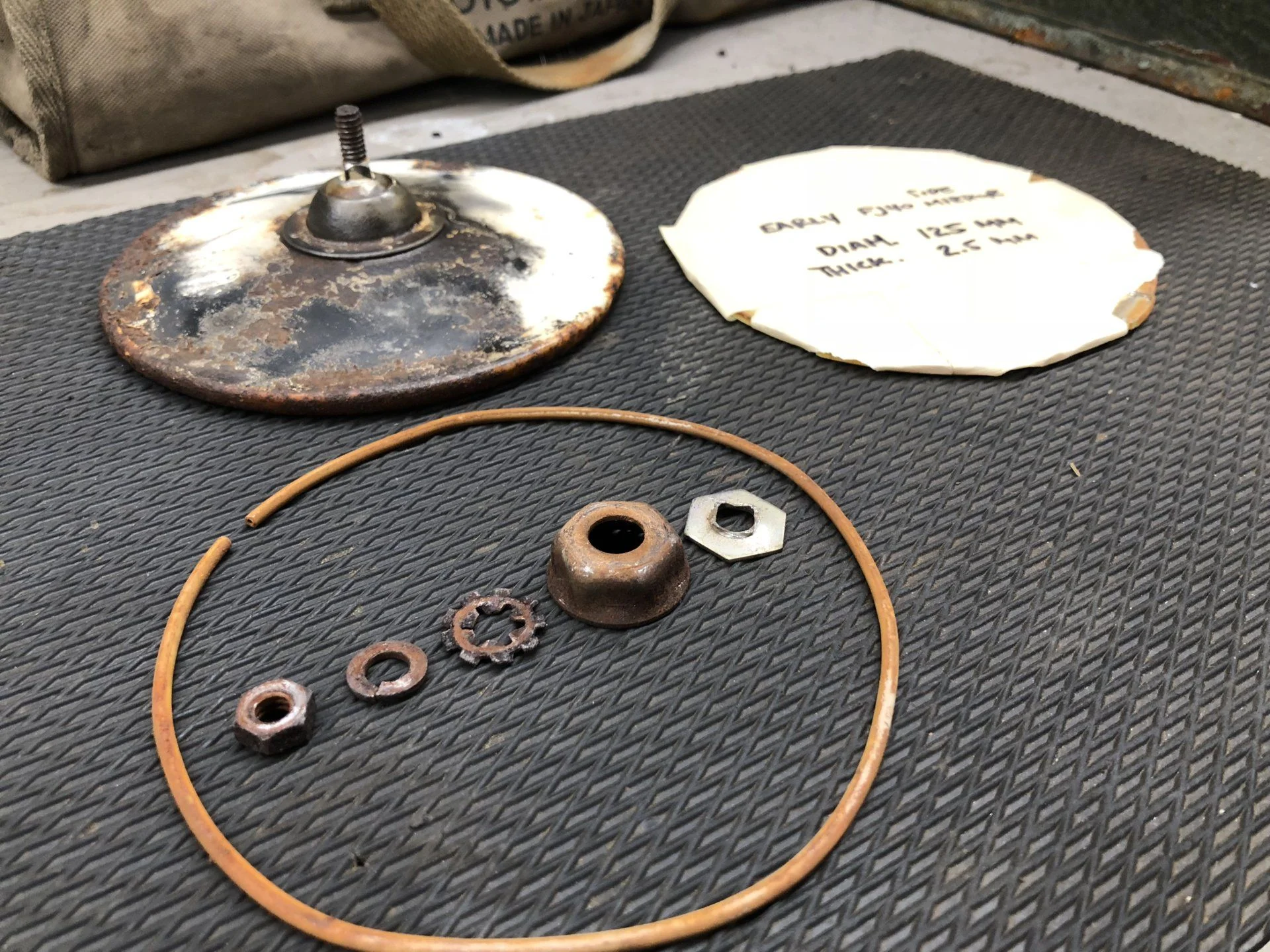

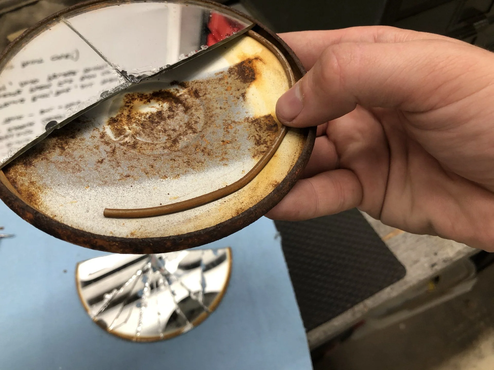

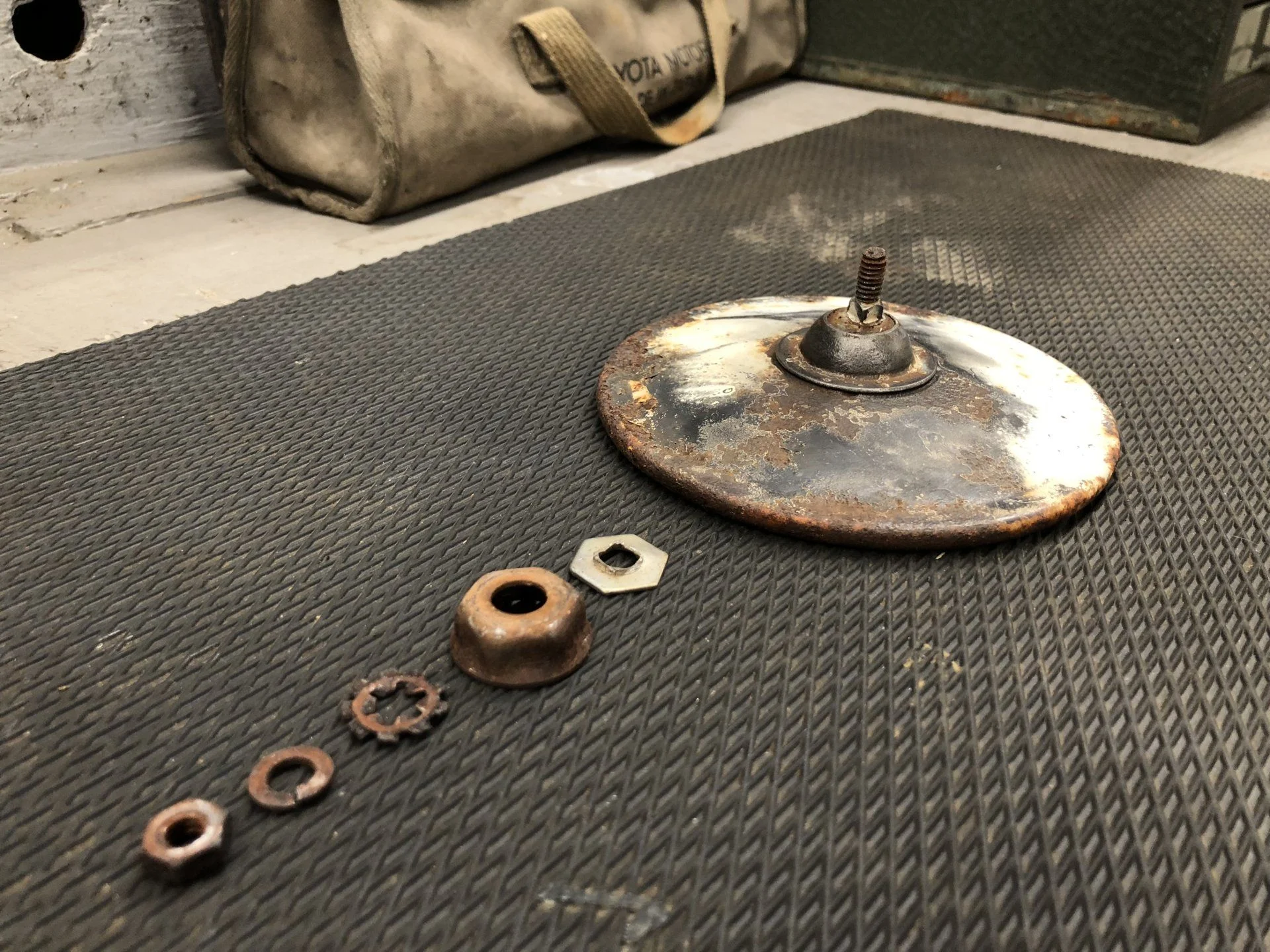

I dug into my broken early side mirror tonight. (While keeping the shape totally intact.) Attaching a few pictures below, but I’ll talk about it a little more tomorrow.
Considering talking to a local metal stamping place to see what it might take to make these...

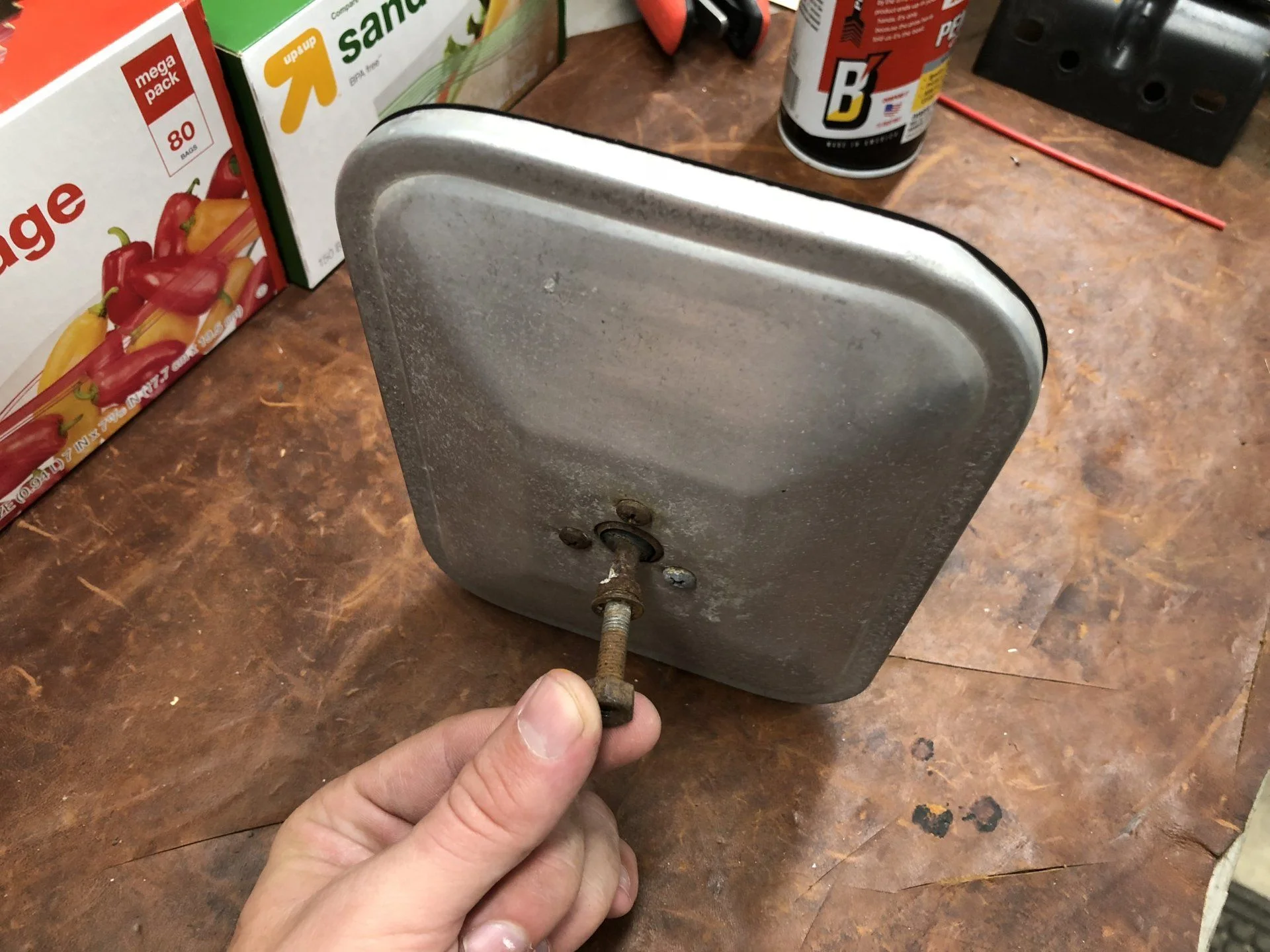

Can anyone tell me if this is a factory side mirror? It was on this FJ40 when I got it, but my other (early-64) has the simple round mirror. Could this have been during a changeover?
And just for reference, here’s the back of the rear-view mirror. Factory, and definitely different from my early-64. They have a very similar look to them.
Hang on to that inside mirror. However,... lol.
There are later ‘65s that have a different one, iirc.
I think the outside one is original.

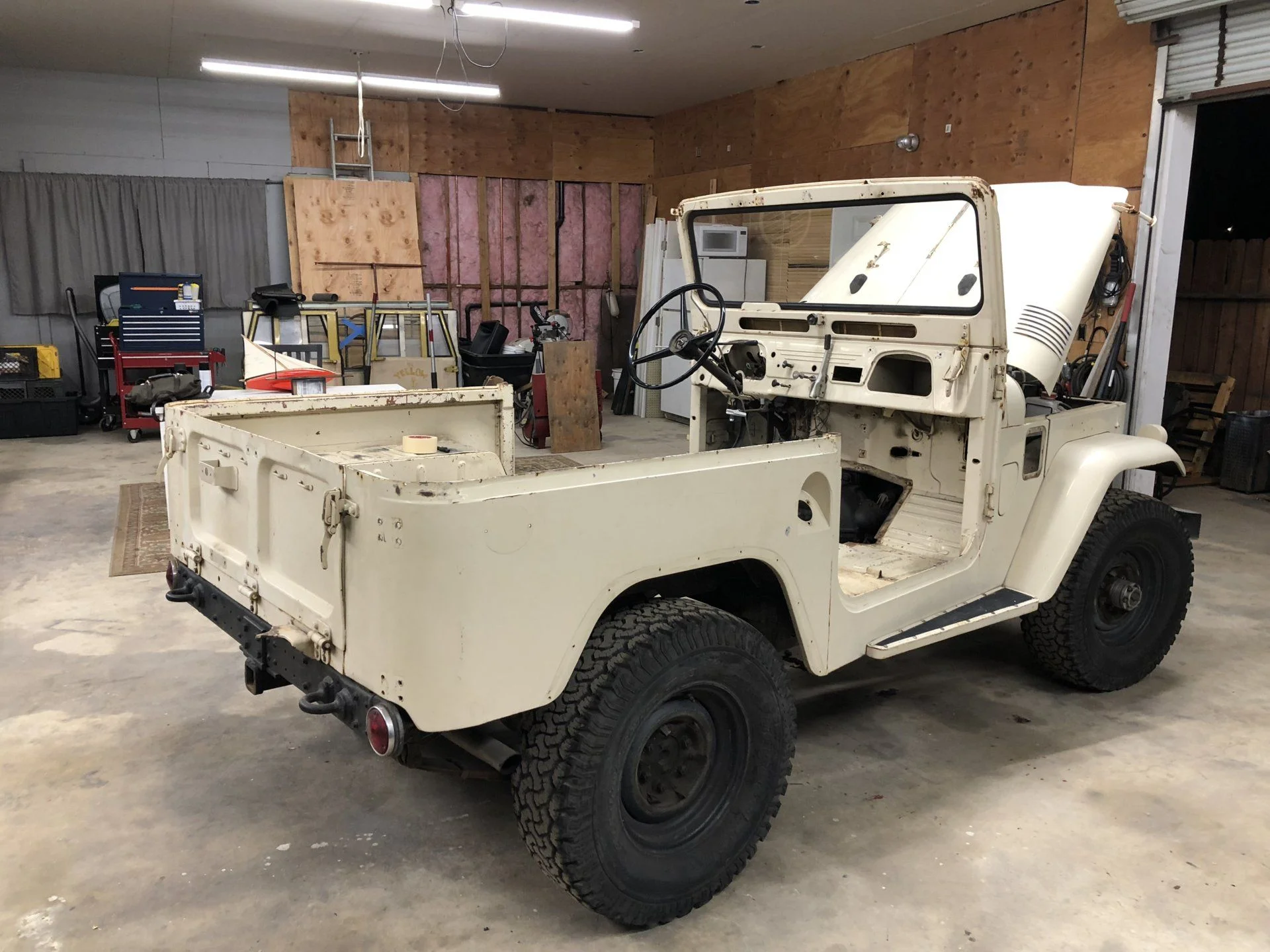

Hey guys! I've made some great progress on disassembling the truck, and I'm being a little particular about bagging up and organizing hardware as I go. Obviously, I've been bad about posting photos–but I've taken a lot of them.
Not sure if it's going to be helpful to anyone else, but maybe I'll add updates to this thread in groups of components, as things are disassembled.
Here's how it looks as of last night. Let me know if you'd like to see photos of anything specific as I go.
