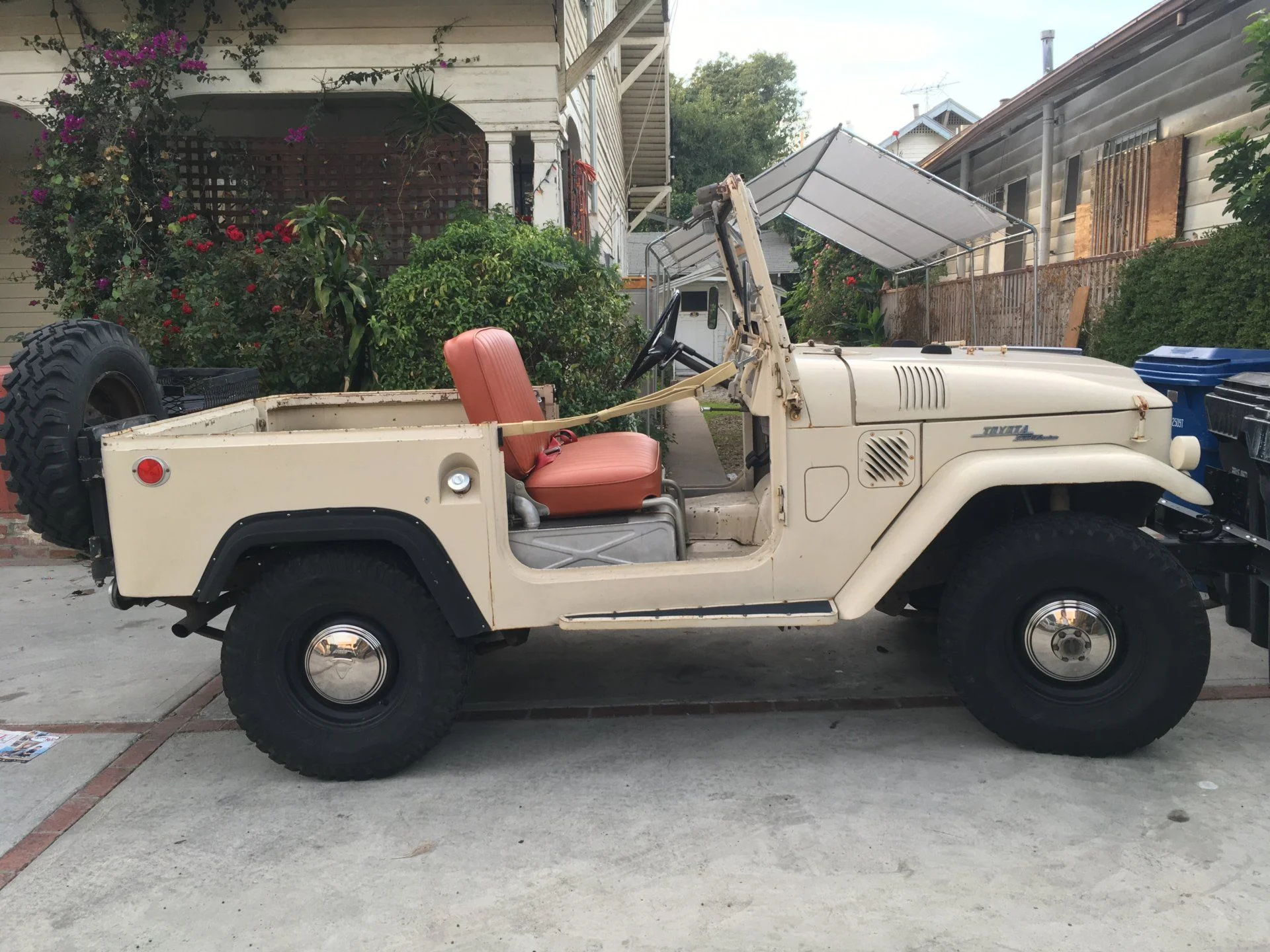

Hey everyone! I hope you are ready for another teardown/build thread, because I don't doubt that this project is going to be an adventure...
This is the second FJ40 I've owned – I also have a third I call Dirtbag – but Old Yeller is by far the most original. Over the last 6 years I have gradually gathered missing original parts, and it's time to tear it all down, sandblast, prime, paint, clean, rebuild, and whatever else I have to do to get it as close to factory original as possible.
I'll make every effort to photograph the entire process, and invite all of you in the Land Cruiser community to chime in.
A little bit about the truck's history, as far as I know:
I've had this 1965 FJ40 for 6 years, and it was my daily driver here in Los Angeles for almost that entire time. Based on the vin, I would pin it as a late-1964 build, so there are a few parts from 64 and a few from 65. Additionally, it may be one of the earliest trucks I've seen with the factory heater and fresh air inlet. (My other early-64 YOM FJ40 has the alternate dealer option heater.)
Previous owner said it was a central California truck and he acquired it from the original owner's son-in-law. It was a hunting vehicle (evidenced by the gun rack mounted next to the driver's seat) and was likely pulled behind an RV since it came with a tow bumper.
It doesn't look like it dealt with salted roads, but there are still a few small spots of rust showing here and there which is one of the primary reasons I've decided to take the body off.
The color has been much-discussed on Mud, but it is the Yosemite Yellow (or Sunny Yellow) and shows really differently depending on the light. (Yes, it appears to have been re-sprayed at some point in its life, but I've seen some spots with the original color.)
Original F motor and big-window carb. Oil bath air filter. Factory soft top bows. Factory rear seats.
That's about all I have for tonight, but I'll post some more pics very soon.

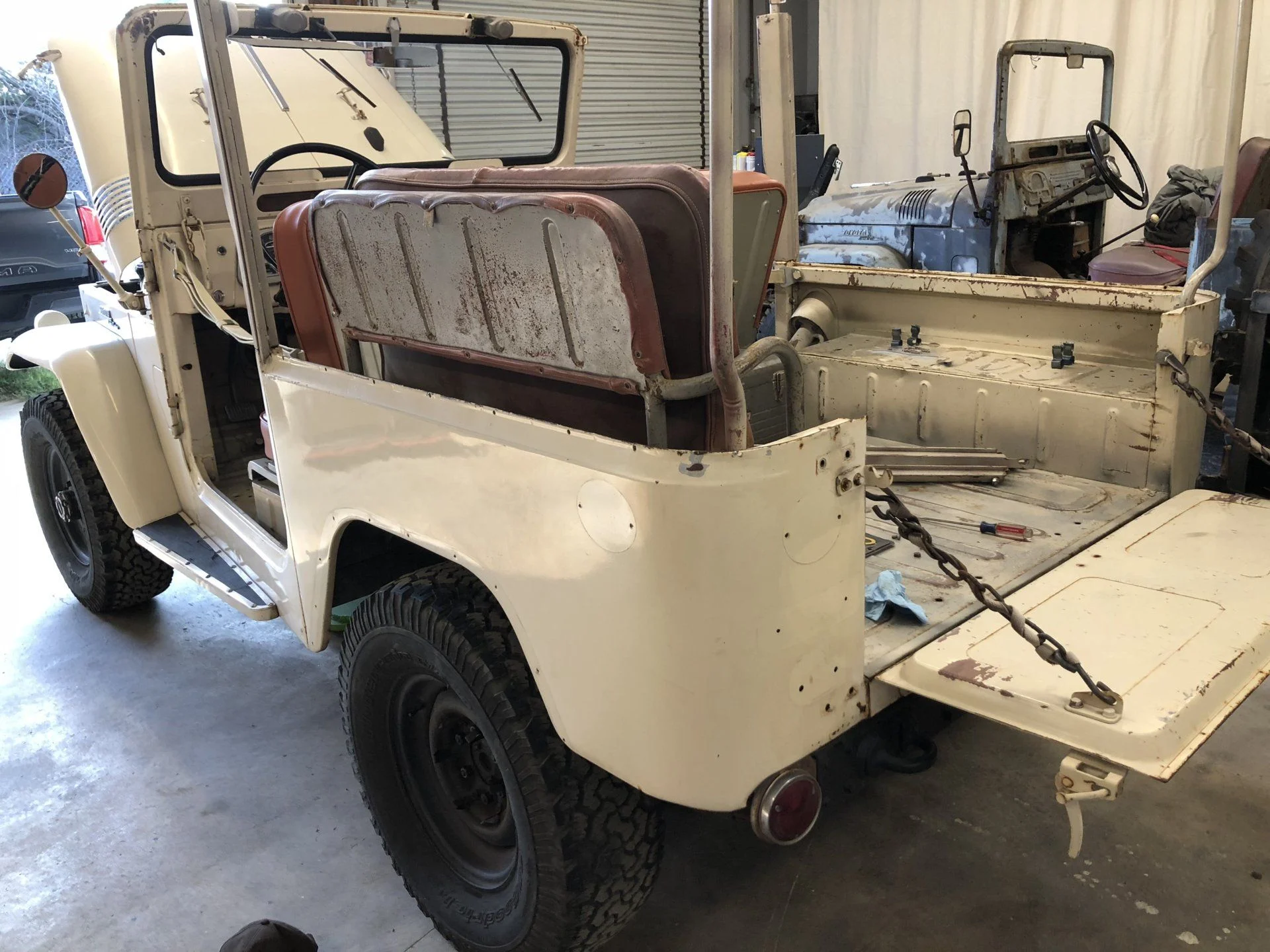

Luckily they didn’t cut the wheel wells out...only added the flares on top. Photo coming soon to show them removed!
Rear wheel wells with rubber flares removed. Luckily they didn’t cut out or modify the original lip. Looks like a little bit of metal work and they’ll be perfect.

I wholeheartedly agree! It’s a really solid starting point, and I have wrestled with leaving it as-is for a long time. My philosophy at this point is I’m just being a steward of the truck and need to make sure it survives for at least another 50+ years. Doing so requires dealing with the metal, mostly, and of course to do that correctly means I should probably take it all down bare.
You’ll see in some photos more of the blemishes and holes that I’m talking about, but how great to be able to work from something so solid?!
