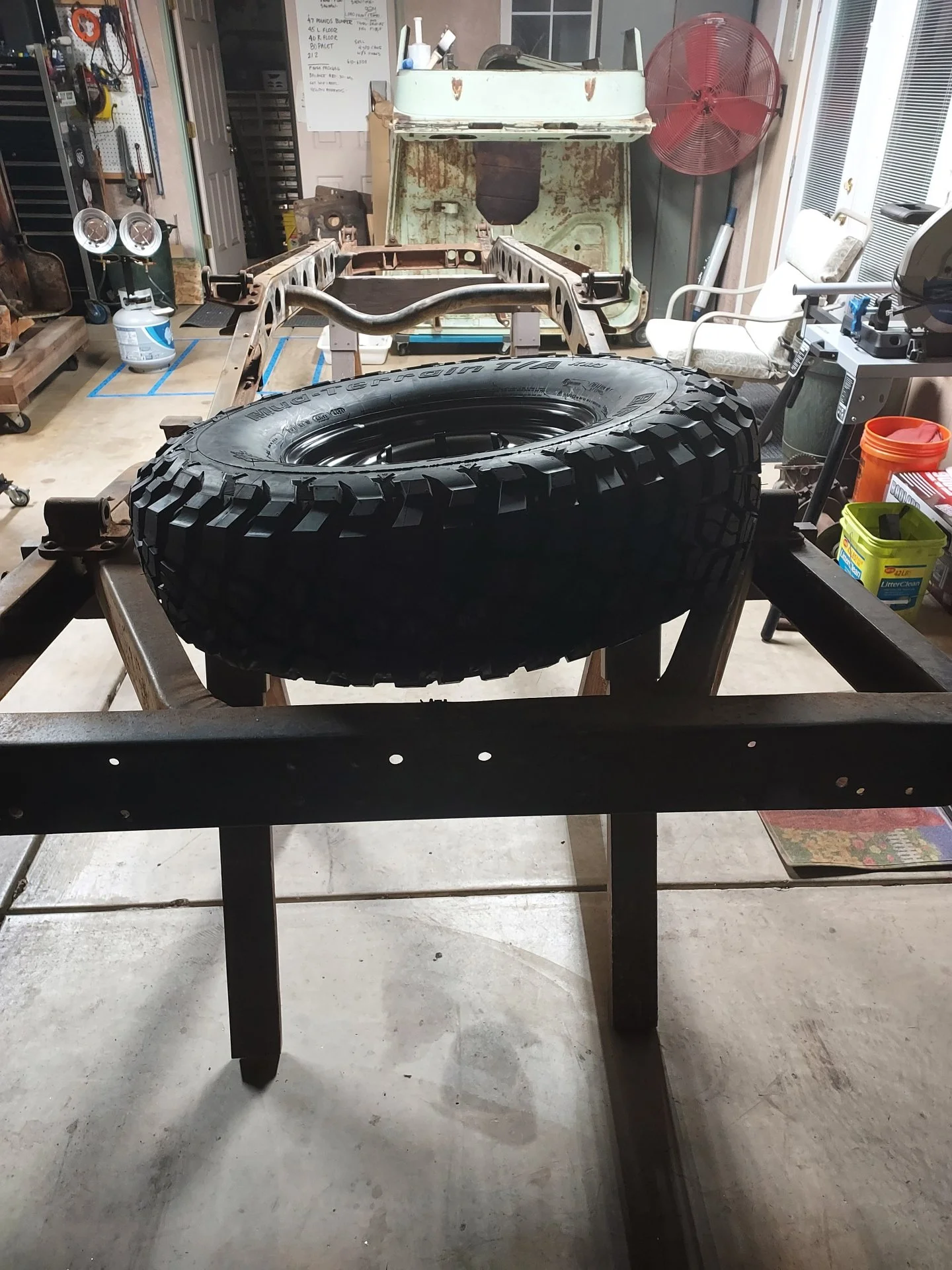

I had to get a tall tire....
Does it even fit between the shackle hangers?
Not really... trying to fit 5 lbs of sugar in a 3 lb bag. Could accommodate a larger tire but it would have to hang down further.
Had the garage door open a little while ago AND remembered to snap a pic. Stock RK3 on the carrier, which is something like 28.5”. Looks to be about one inch left on each diagonal for a tire that would still fit between the rails.
Another angle in case you find it useful
Downsized the file, and of course Woody’s algorithms HAD to rotate the pic! :rolleyes:
