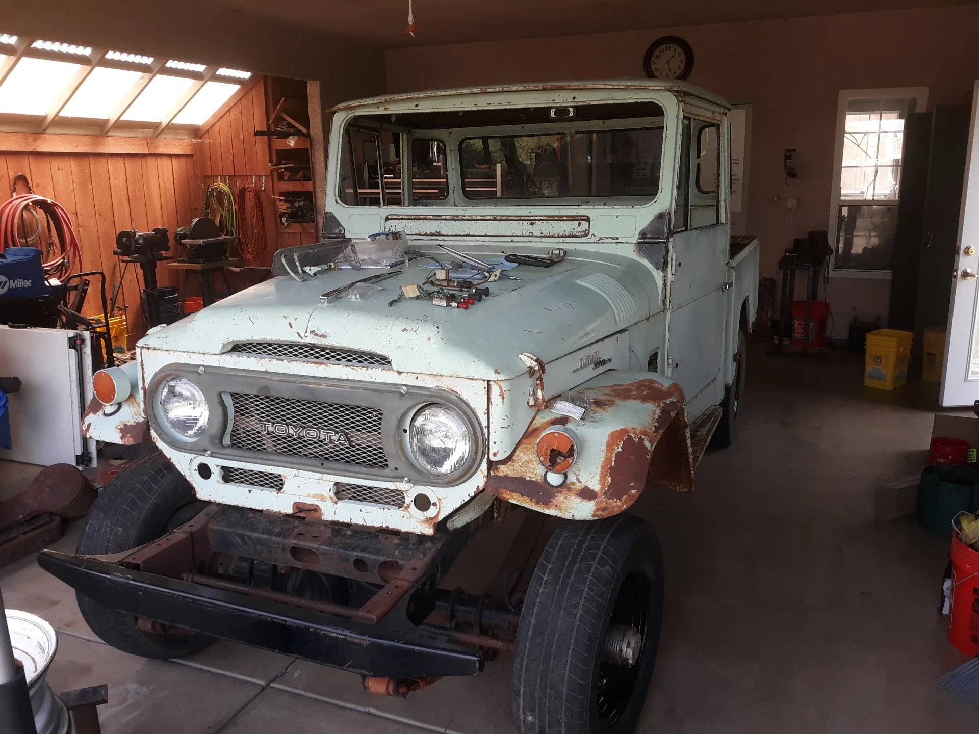

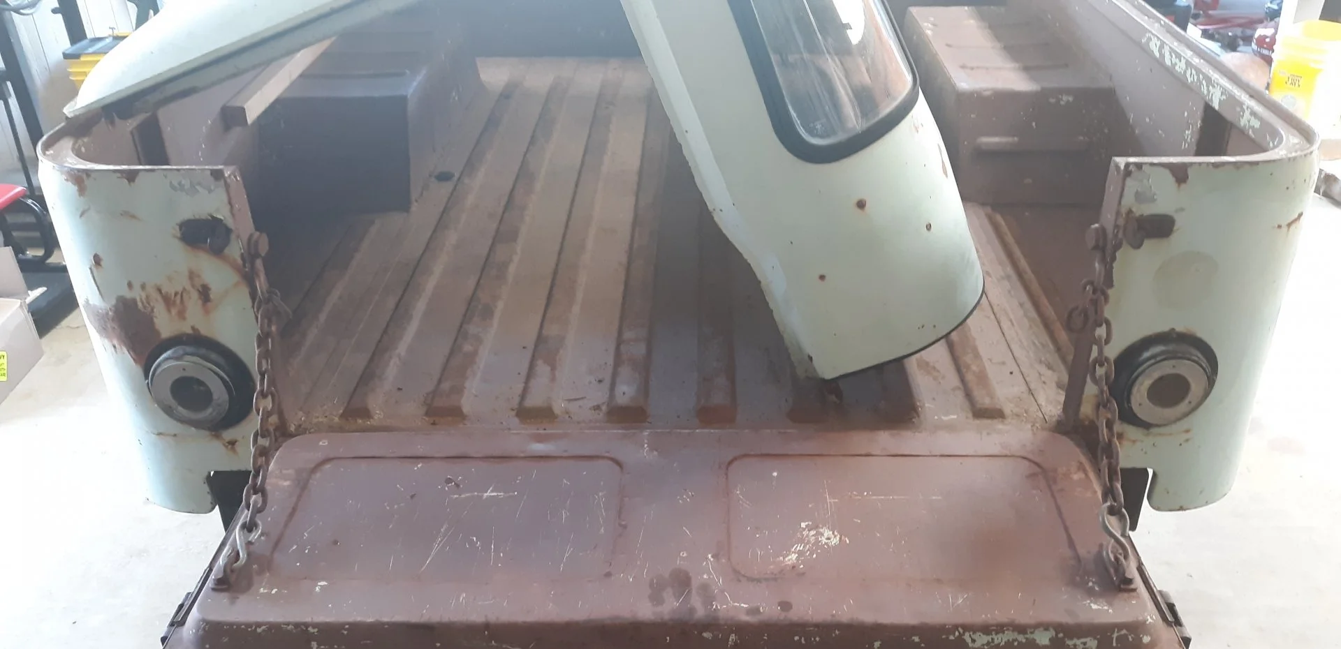

Wanted to start a build thread today. I find them to be helpful when working on a cruiser. My plans are to keep it all Toyota. Since it did not come with a drivetrain I plan to install a 2f out of a 78 fj40, Axles from a 79 fj40, with plans to change to fj60 differentials. Also 16 in rims to get that tall and skinny look. I have a PTO winch for it. I would like to keep it as original looking as possible. I am a dune beige guy, but that Spring Green is growing on me. LOL.
Cheers
KevO

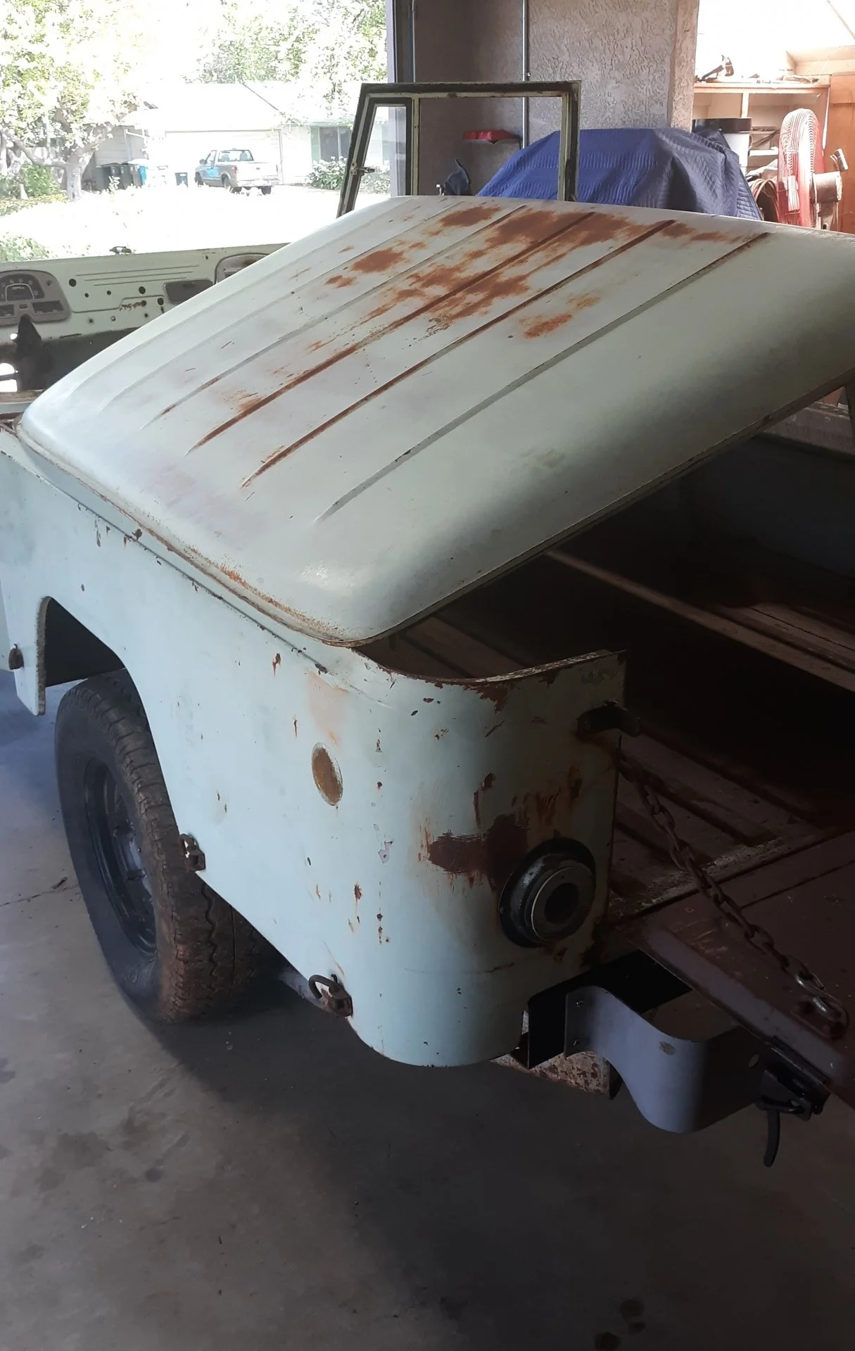

Well it would be nice to find a couple nice Spring Green fenders. Those on there are pretty mangled.
the 79 diffs are the same as 60 diffs.
that is a nice starting point.
spare tire under the bed?
some 45lp's had the lights at the end of the crossmember and others were in the bed.

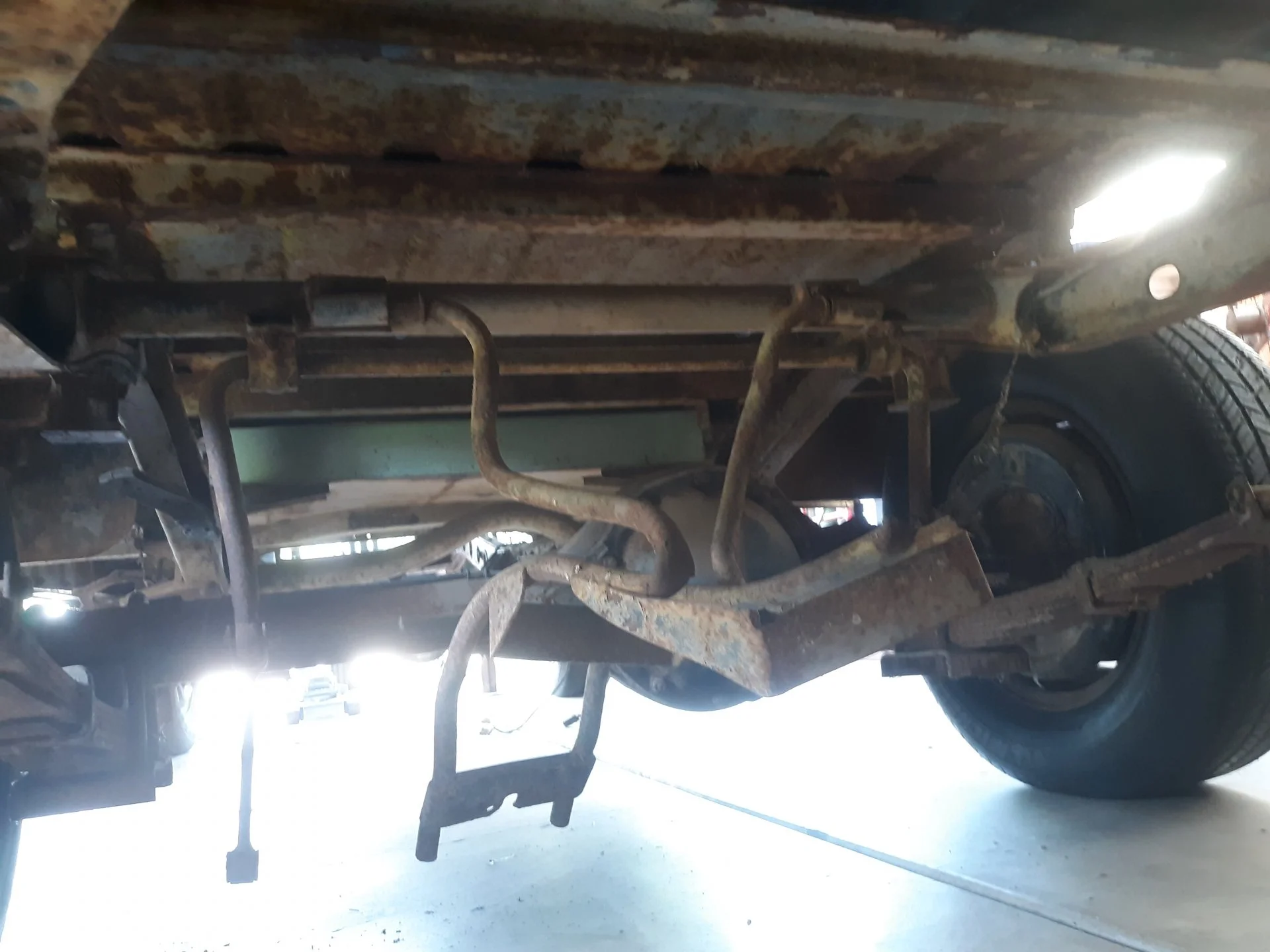

It has the tire carrier under the rear. If you can called that jibbed up mess a tire carrier!
And while I'm under there where do these go to? I don't seem to see any attachment points

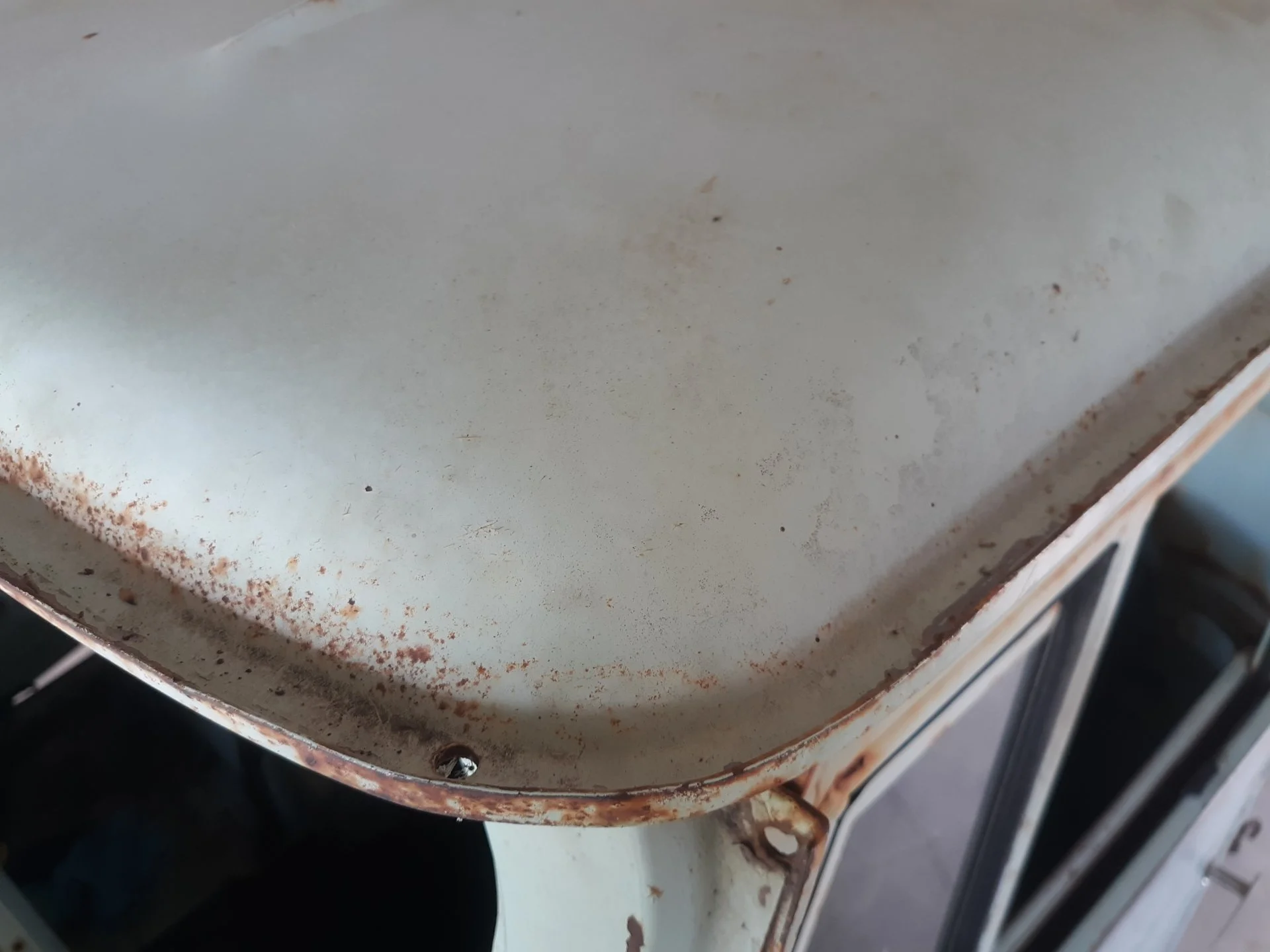

Kevo, that roof is in amazing shape, front corners are usually very rusty, definitely a dry climate California survivor!
From what I gather it has been in storage for the last 30 years. Always like a project with good bones.

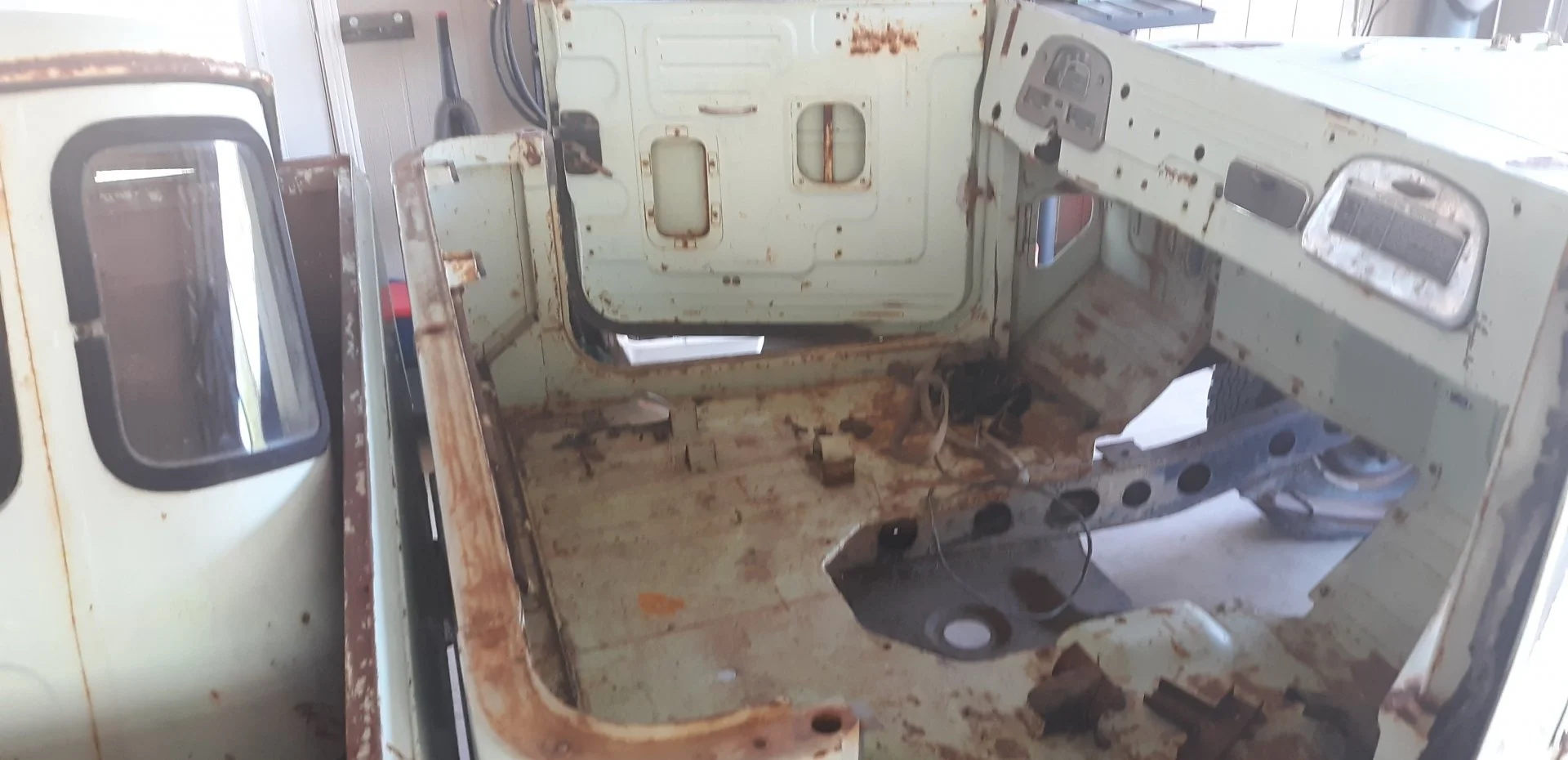

would 64 have had a centered rear diff?
the spare tire carrier looks like it was hanging down and they backed into something crunching it into a mess,
the plate between the 2 tubes by the sway bar link would have been near the rear crossmember, there would have been a threaded rod to secure in the up position
the 2 handles that flared out at the end are both broken off.

Yes they are tiedown hooks.
