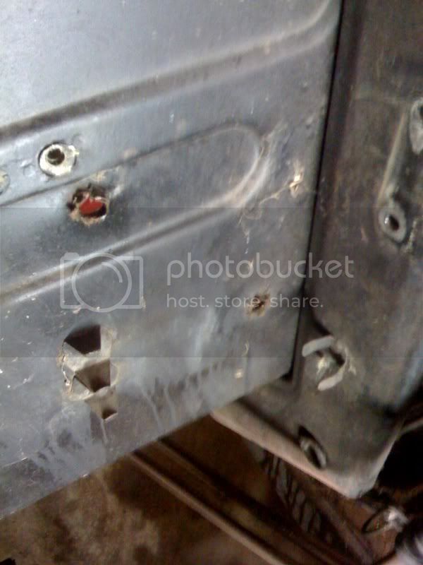

First off, I know that the "Eaton" heaters were a common dealership addition. Dom - I see you have the identical heater in your 45. I am going ot restore mine to a satin black I believe - but will do some research on the OEM colors of those heaters. I think yours was unpainted - I'll have to check.
Nonetheless - what on earth did they use to install these things????
I am not joking when it looks like they used a Colt 45 to shoot a hole for the mounting points.
Take a look:
Were drills not available to Toyota shop mechanics?

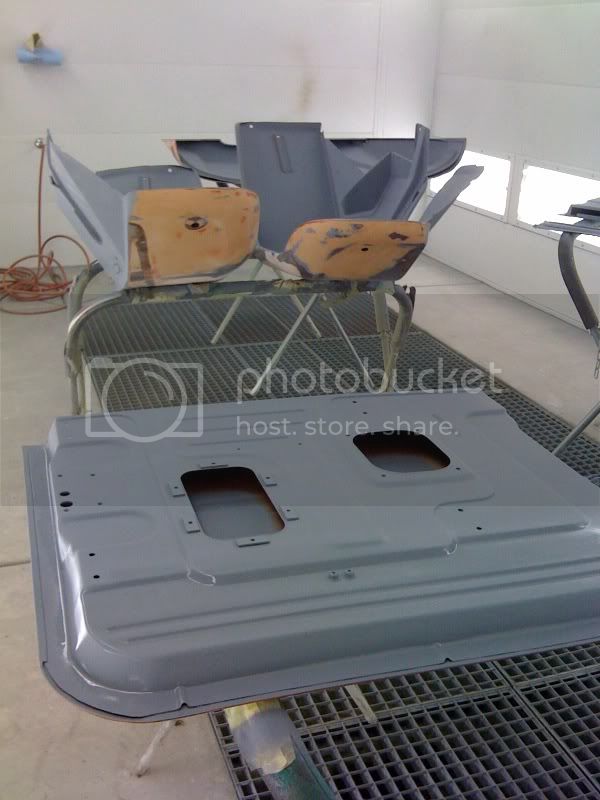

Well, It was a warm day to day and I wanted to get the underside of the:
1. Hood.
2. Fenders.
3. Toolbox cover.
4. Running board brackets.
I also wanted to shoot the inside of the doors - as they were prepped and ready to go at this time.

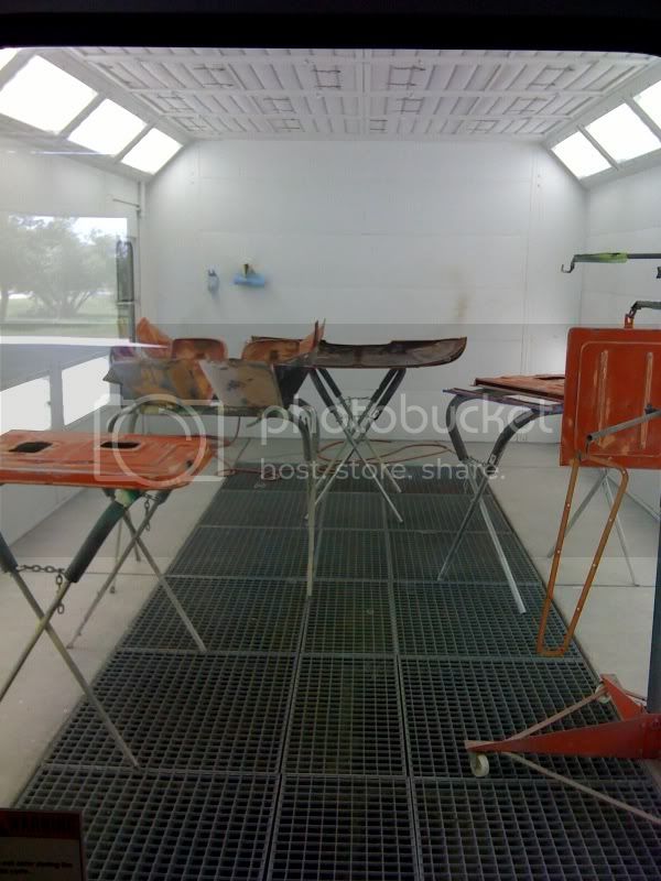

I primed with a UTEC Surfacer primer. Similar to a 2k, or etching primer. (pictures of all products I am using will come as this unfolds).
Loaded up the M416, and off to the shop I went:
Here is a shot of the parts on stands in the paintbooth:
3 coats of primer later:

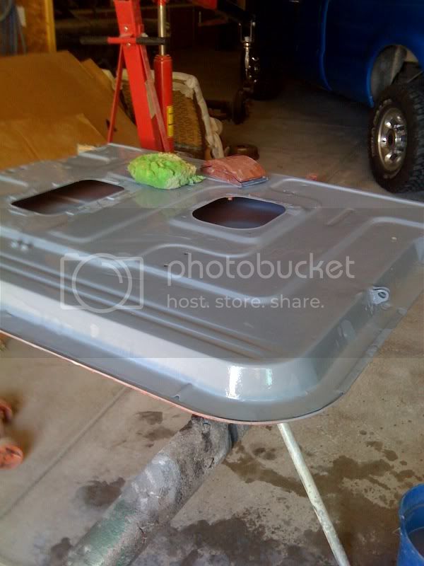

Now, call me crazy - but I am wetsanding all of the primer. If a fella is going through all the trouble and we are here anyway - why not? This way the sealer will lay down nice and smooth.
I wet sanded each piece and then set them back on the racks to dry.
I returned home and continued to D/A the interior. It has been a good day - hope you all had a fun Saturday!

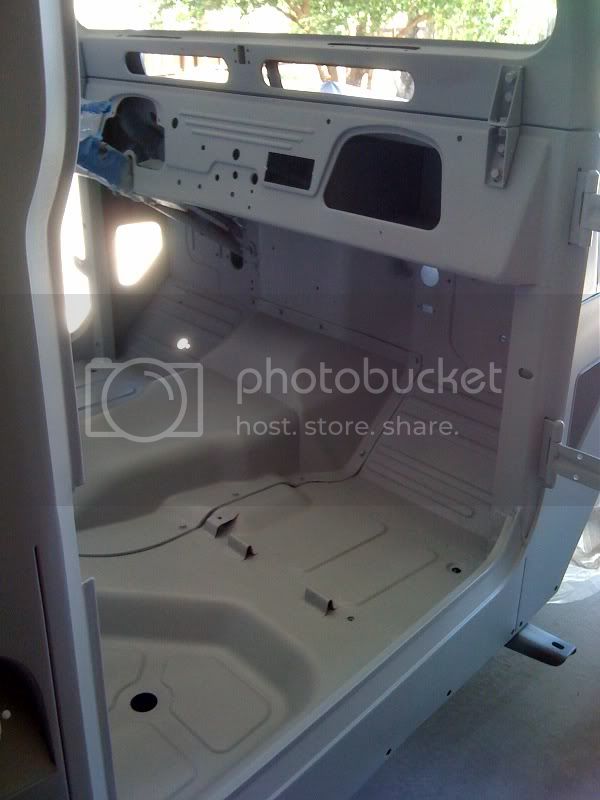

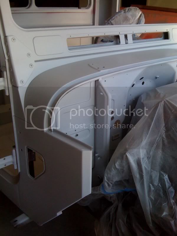

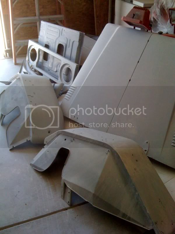

Hello,

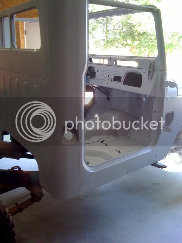

I have been spending major hours working on the body. I have never put this much prep work into a cruiser before, but the wet sanding is killing me. I have wet sanded about every visible area with 400 grit so it is liquid smooth. Then I'll hit it with a light coat of sealer and off to the color factory. Cab, then bed, then parts. I used 2 gallons of primer on this thing. Yes.....that is nearly 3 gallons sprayable 2k Primer.
I put on a light coat, then two really heavy. I used a 1.8 tip and blocked it down smooth with 400 grit.
Here are some pictures to keep the post alive. Not too many people follow this I don't think but that's ok, it give me a place to document all this.
Cheers - Dallas
