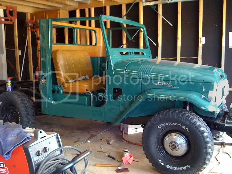

assembly is hard under way!
Hey man.....on the seats, you know I am not sure. When I called SOR to inquire about seat upholstery they only carry gray, and they said mine were gray. Upon investigation it appears that my seats were re-covered some time ago by an upholstery shop. They did do a good job however.
At this point I am not too worried about it, but I thought gray is what they were supposed to be.
However....in the "old 45 photo's" thread, remember this 40 series when it was new? So yeah, not sure what color my seats should be.
Thank you for the wonderful comments everyone. Today is hood mounting, running boards, and other knick-knacks.

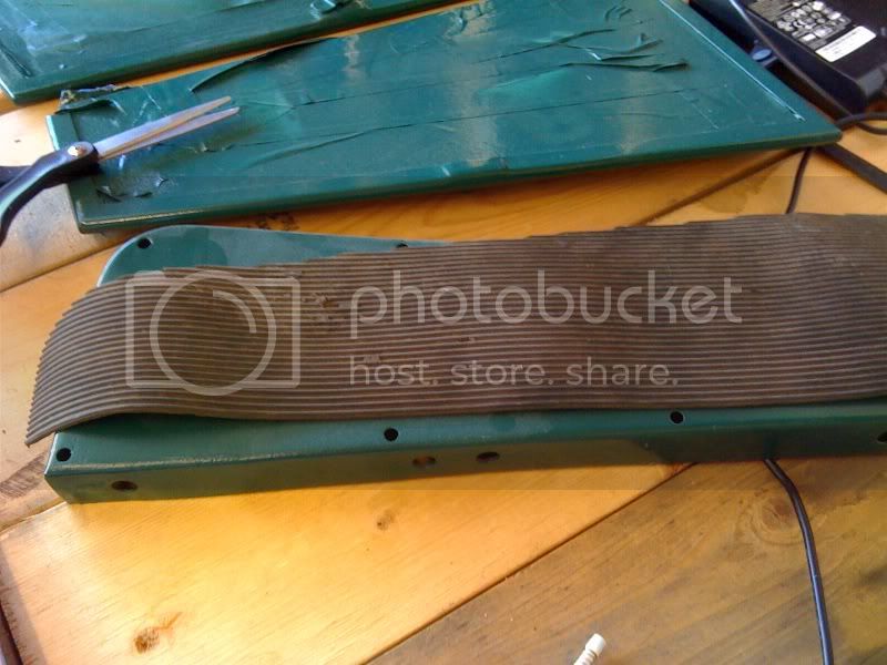

Running boards

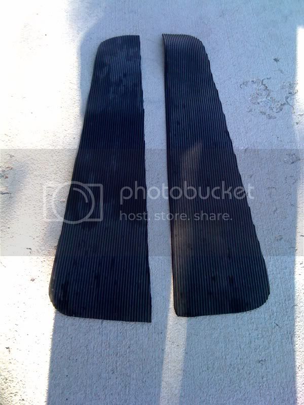

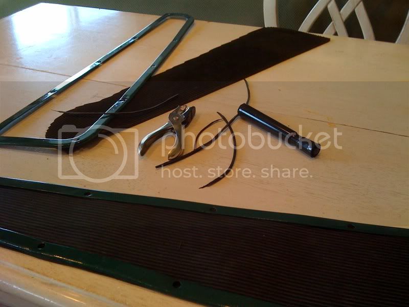

First, I took the running board base and traced it on some old ribbed matting:
I cut them out:
Then, I scrubbed them good with an SOS pad:
trimmed to fit:

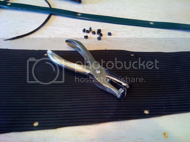

paper punch the bolt holes:
Then, I snagged some 6mmx1.0 stainless hardware (i know, not original) and assembled them.
I know these are not perfect, but I think they are snazzy enough?! :-)

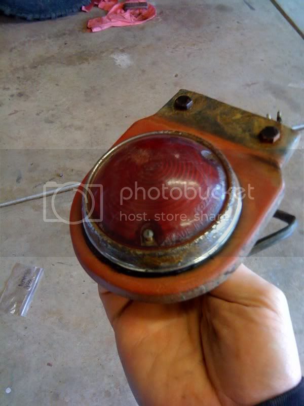

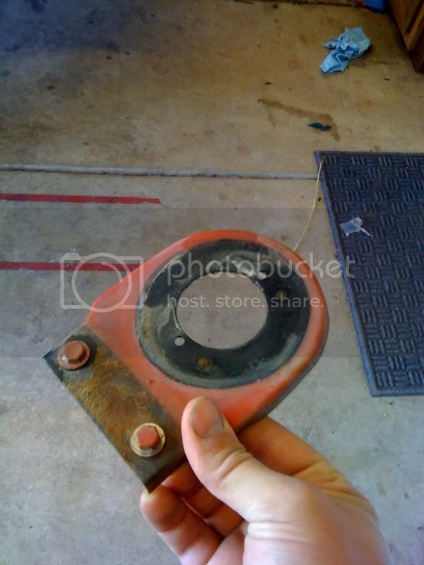

Well, this morning was tail-lights. I got one complete and am going to work on the other tonight. I didn't think my tail-lights were in that bad of shape....
Here is one:
Now, it looks like it just needs a new gasket and a cleaning up, right?

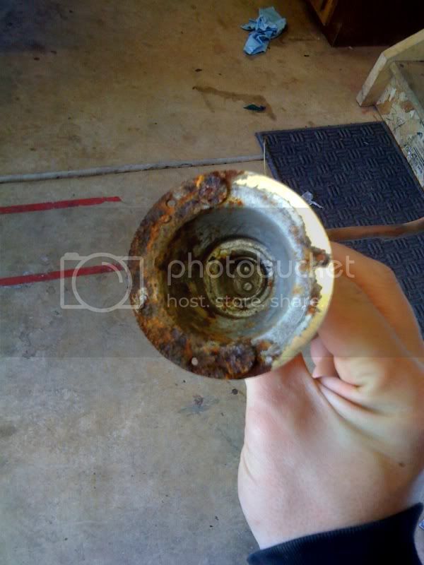

Well.....
Total disaster in there. So I had to replace the lamp.
Some of you pro's are probably already a step ahead thinking....Yes, those are the same housings as the bib lights, but have two wires going to the bulb base vs. one on the bib lights.
Well, I just bought bib lights....and then swapped the one wire bulb base with a two-wire bulb base and then reassembled them.
Here is the bracket for reference:

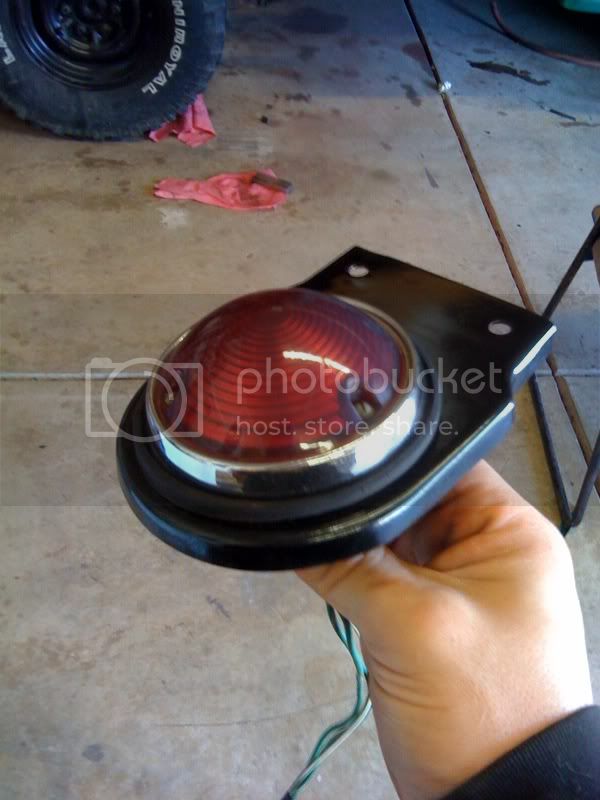

I sand blasted the bracket and painted gloss black.
I then reassembled the lamp assemblies and went to my "red lenses" stash and again, polished the best two. Again, these are not PERFECT, but they are pretty close in my opinion:

Dallas, The 45 is comming out great, love the build pic's. Just an FYi both the clear light and tail light lenses are avalible from SOR. thay are repo lenses copied from an original.
