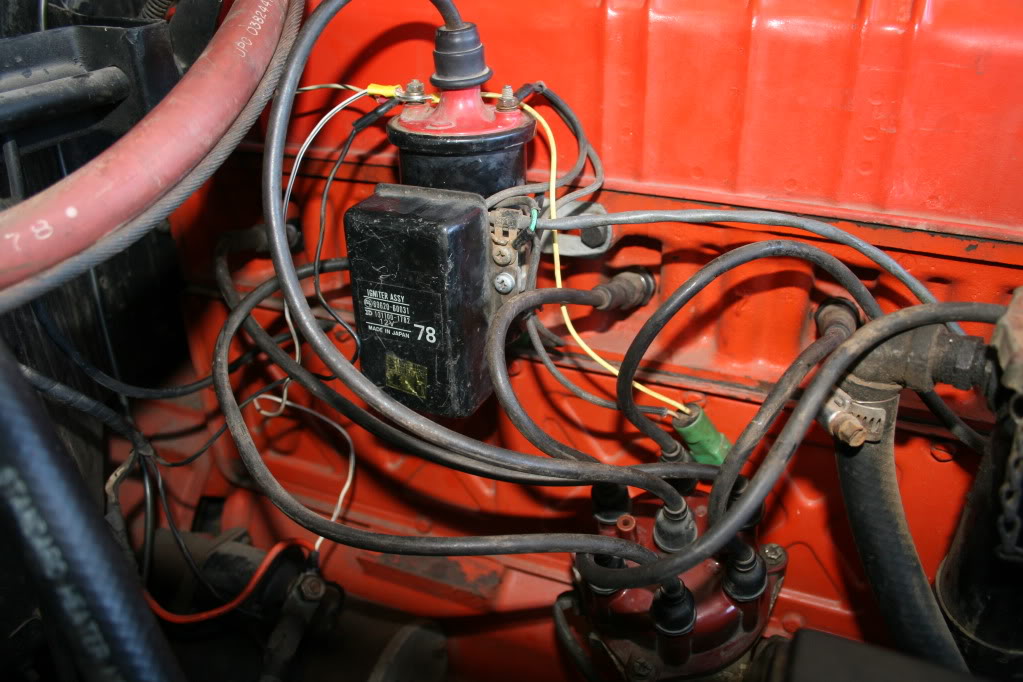

Just an update - am working on ignition and brakes.
I have just finished installing 1978 full electronic ignition.
I am now (as you probably can see in the 40 section) dealing (still) with braking demons.
I am trying to get these ironed out so that I can attend the Rising Sun Ghost Town Run.
I hope you are all doing well.
all the best - Dallas
Wiring is not finished here - but shows the components I used:

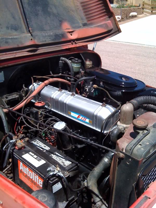

Another update to the thread.
1. Electronic Ignition dialed in and set (16 degress BTDC)
2. Engine painted and original decals set.
3. Correct "Big Window" Blue Aisin carb rebuilt and installed.
4. Air cleaner fixed and painted.
5. Holley "Red" fuel pump installed, mechanical removed. (Help with vapor locking).
6. Brakes FINALLY fixed.
Shot from this morning:
Take care all and best wishes,
Dallas
