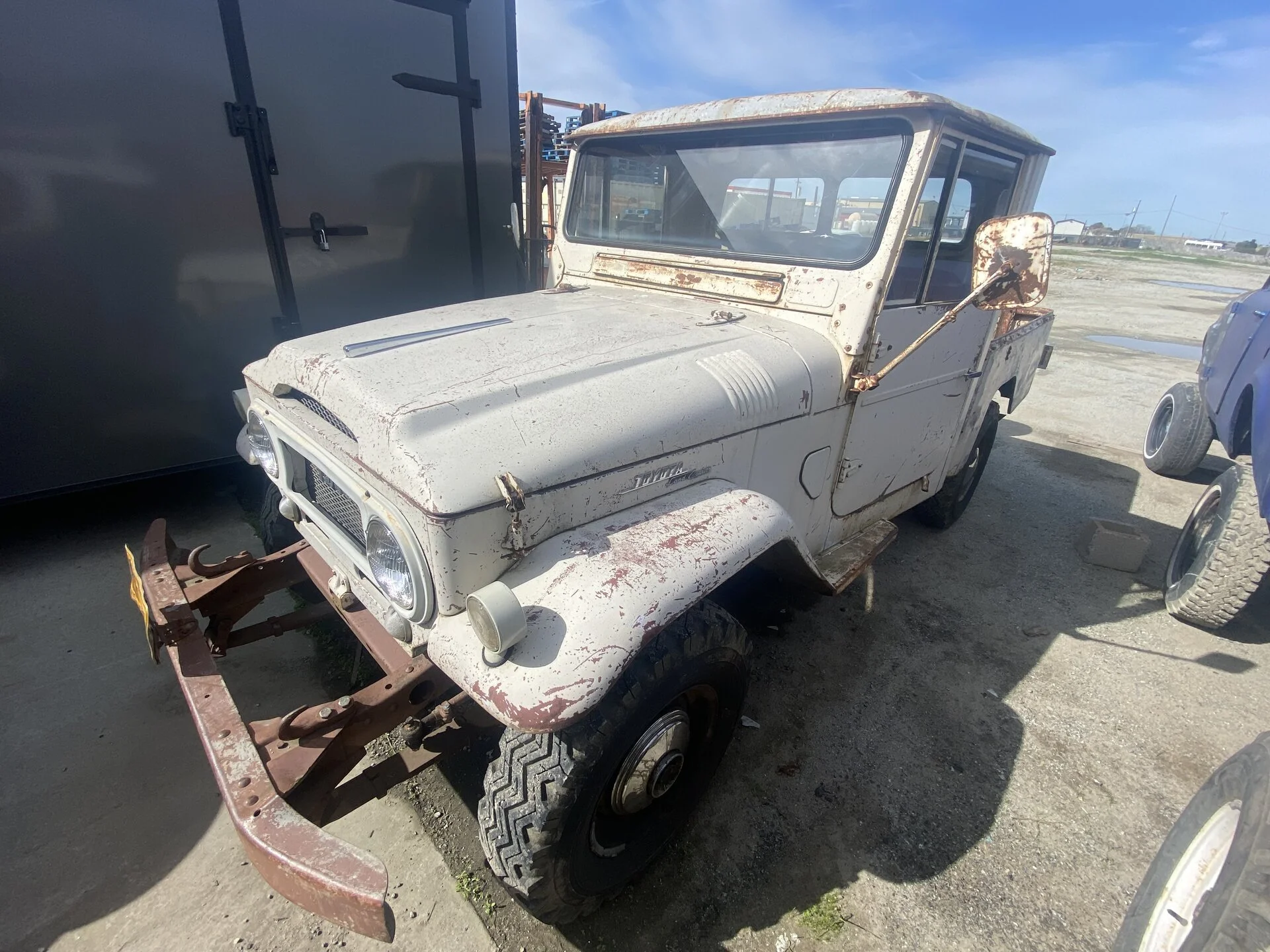

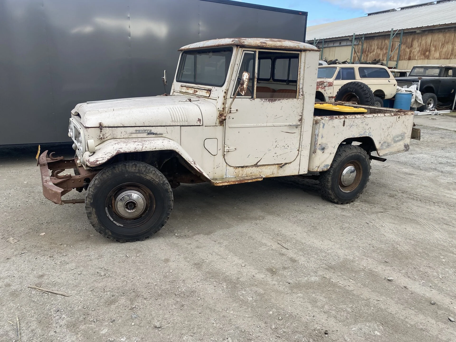

Hello

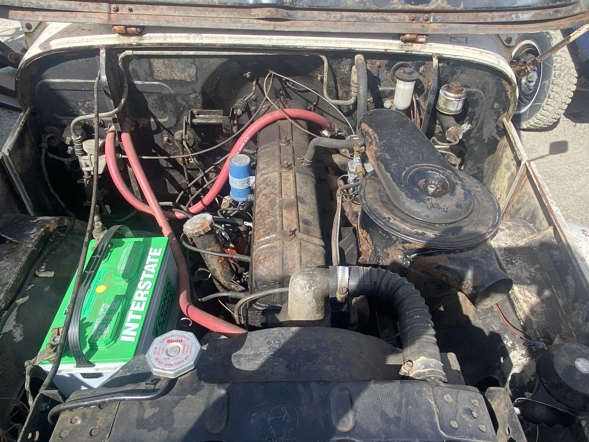

Newer to this site but wanted to share my new rig just added to collection.
Great original patina rig. Runs and drive great, need to put new tires on and start cruising it.
Looking for help to see how original this FJ45 really is. Any help would be greatly appreciated.
I added a few pictures.
Thoughts should this be restored or left original?
Thanks in advance..
Jon
having spent the time "restoring" aka "restomodding" two FJ45's no way would i paint one again.. Do the Nolen clean up on the body.. I would however make it driveable and safe.. i hate OEM early 60's technology, brakes, steering, etc.. spend the $ making it safe and easier to drive.. I hope your short.. cause they are little inside.. even tighter when they are fixed tops.. you can go "Up" with the seat and gain a little room but with the big ol school bus steering wheel you will be into your knees soon.. There is a cool 4 on the tree thing that is coming along if you "restomod" it to a 4speed. Personally i think a true "restoration" is a waste of time.. Spend a ton of money making something period correct only to never drive it again? What's the point.. You will get tons of opinions on what to do with your truck.. in the end it is your truck and do with it what ever you want..
^. Drive it. Add your patina knicks to it. It’s a story book. Finnish reading it.
Nice patina! I hope you keep it!
Read through this thread on tips and tricks to preserve it.
There’s a ton of information in this section of the forum. Some of the threads have links to parts that are still available.
I'll echo what others are saying - keep the patina. Adding front disc brakes and power steering are very nice modifications to an original rig. Replacing the suspension bushings, body mounts and cab weatherstripping will likely need to be done on an original truck too. Take your time and enjoy the ride. You've got a gem there for sure!

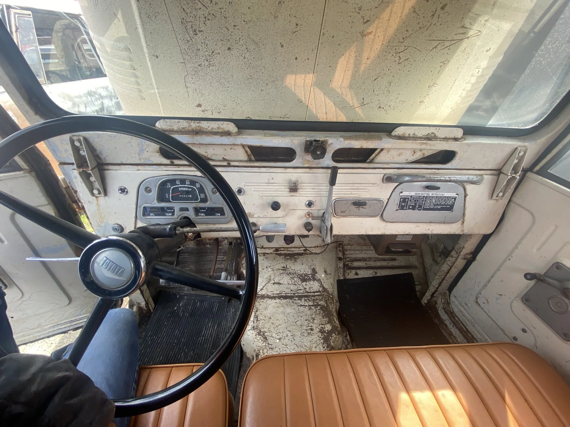

Adding to what the others have said, aside from the trivial smalls like the shift knob, ignition switch and license plate the clutch master and radiator cap are incorrect also. These are however trivial items to say the least.
I see both OE brass terminals on the battery which are stupidly hard to find, a smooth top air cleaner and cleaned up big window SD40 carb. If it stops and starts, why mess with adding disc brakes, power steering, EFI, etc. It has worked for 60 years. The trials and tribulations of those who did so are well documented and keep popping up regularly
Needs an FD knob 😝
KIAI
(keep it as is)
Looked at the pictures again…this is only for reference incase you want to make it factory “correct”(?). I’m not nitpicking. Any of us would be stoked to have this truck!
You might want to replace the weatherstripping in and around the doors, between the hard top and cab and the front vent(?). Also the pads on the brake and clutch. They’re available from the LC vendors.
-TNK wiper arms (appears the motors are there?). If not then 2 x TNK motors.
-wing nut for top of smooth top air filter housing

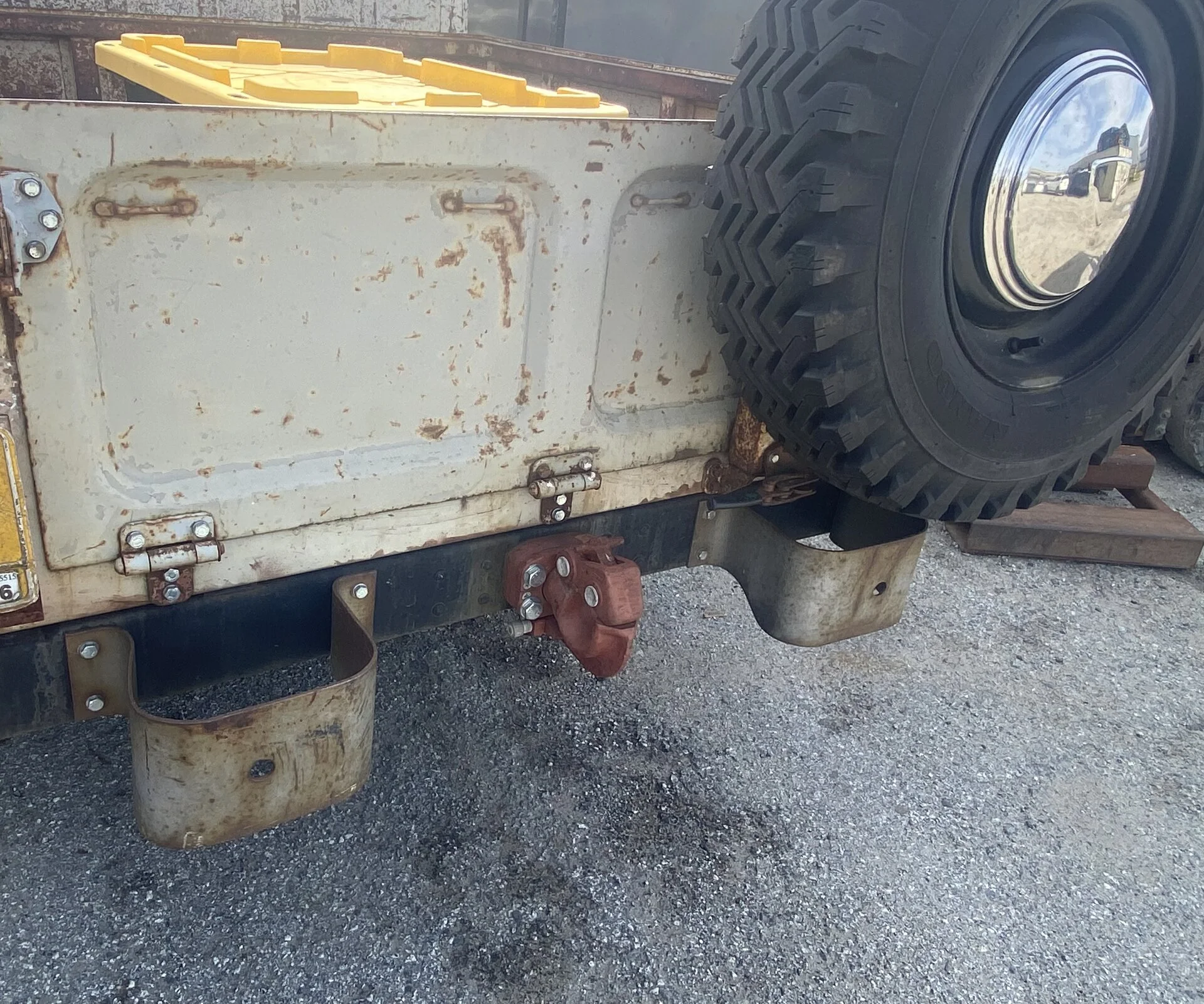

-tailgate looks like it’s from a 40 FST(?) due to the footman loops which would also explain the new shiny bolts. However it appears to be a great match on the paint! I’d leave it. OE SWB tailgates are rare. Hopefully you got the OE tailgate chains for the FST tailgate?
-white material for the top of the side steps which can be found here:
Do you have the jack and rods?
clutch master is correct the brake is the incorrect master.
You are correct. I'm thinking RHD orientation whereas this is a LHD. Ultimately, the tin cup master is correct and easy enough to get a new OEM brake master with plastic reservoir and then the hunt to find a tin cup to screw on which only has the square nut without the shield for the breather.
