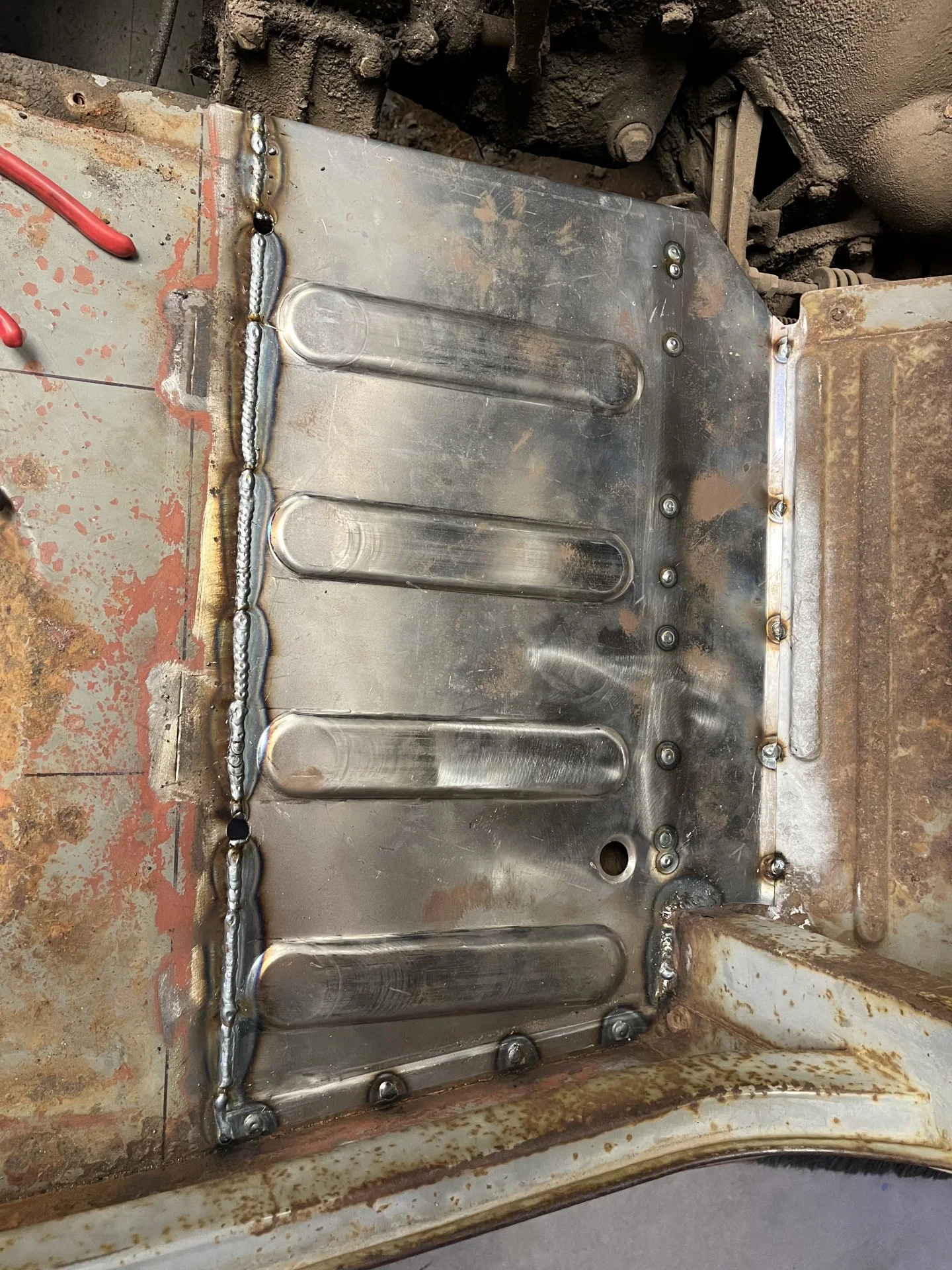

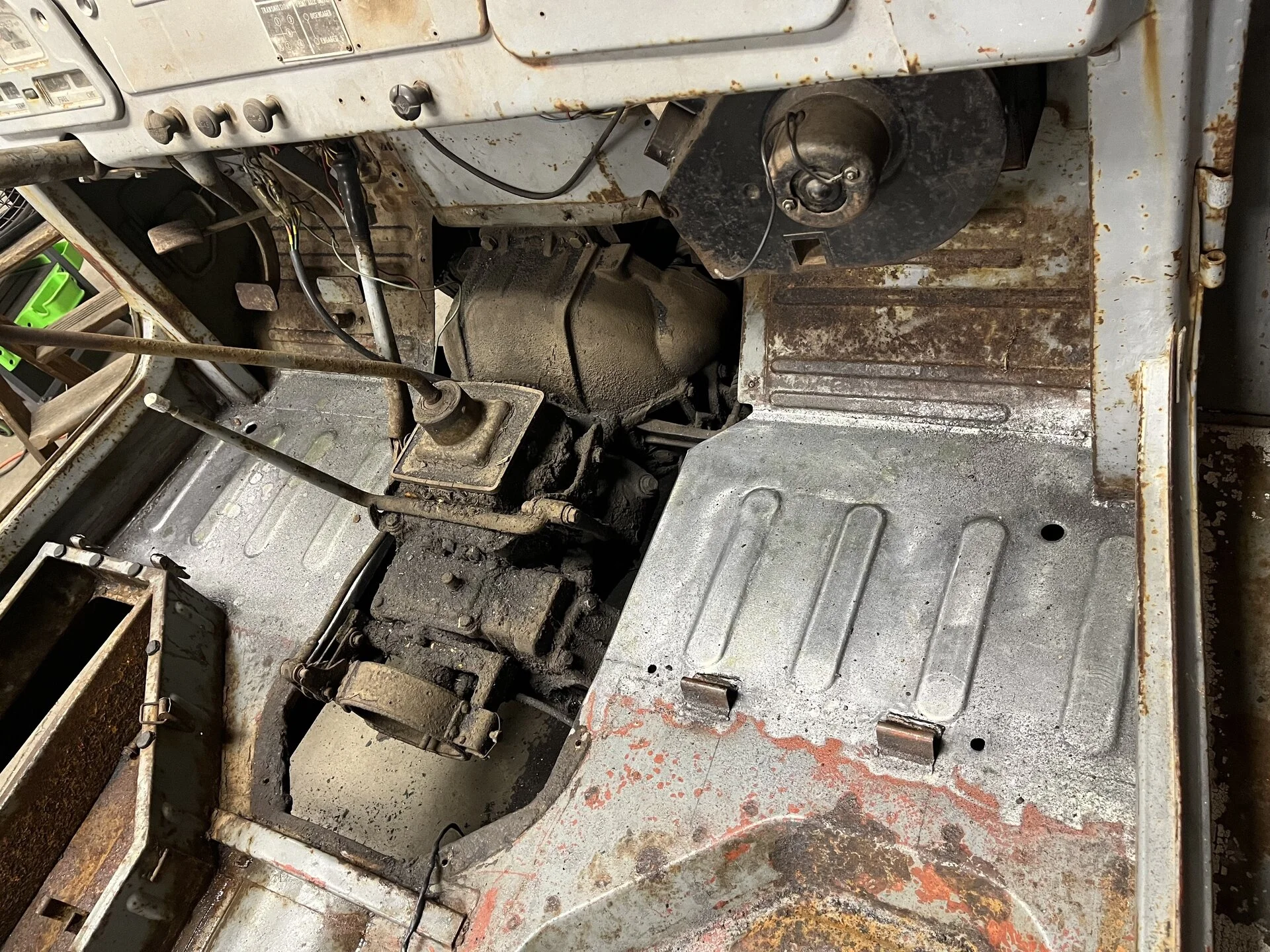

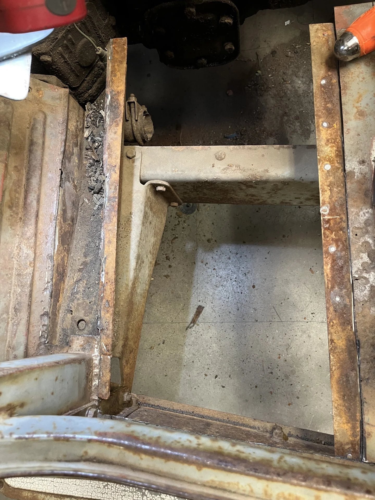

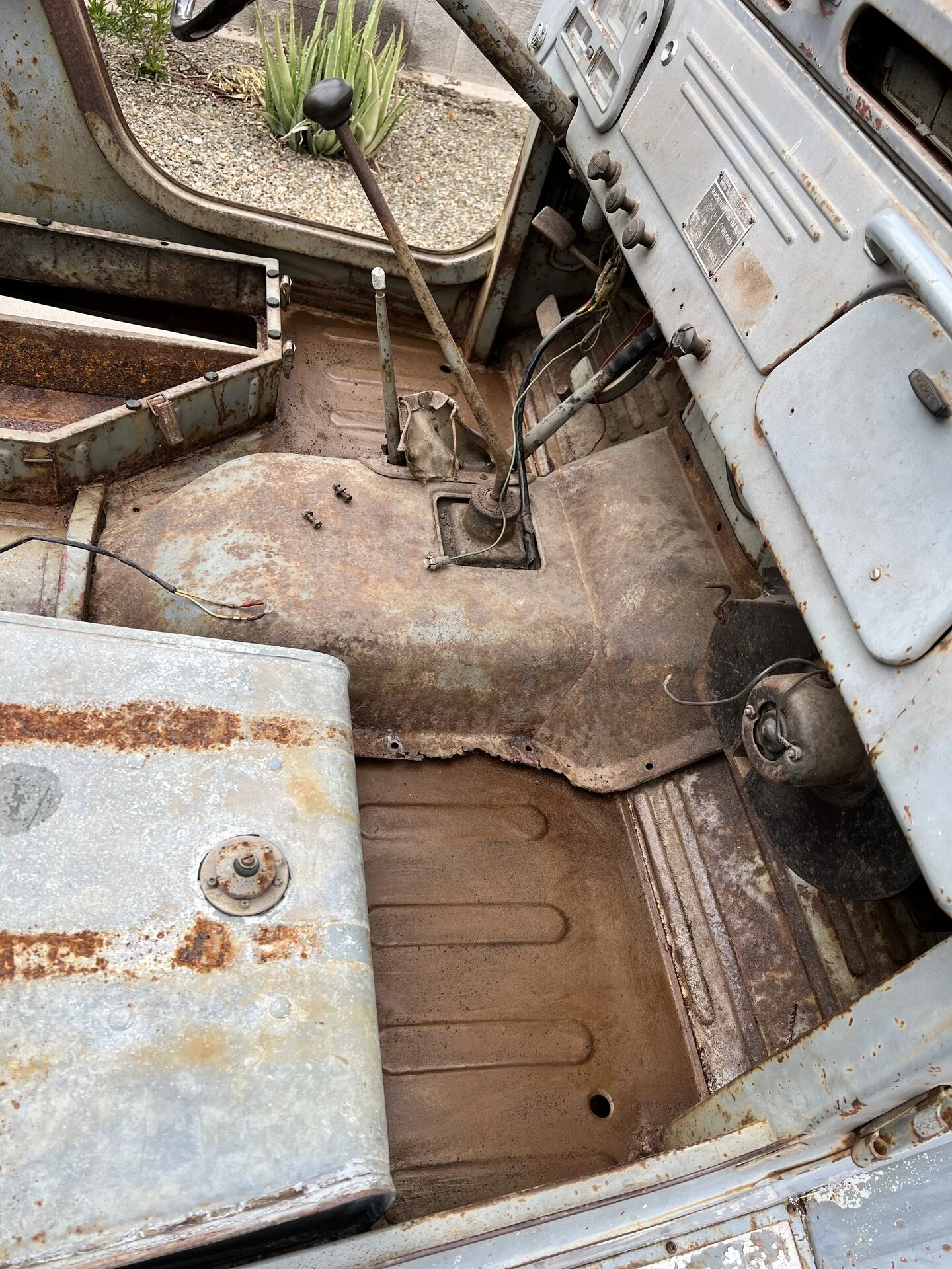

Removed Ebony's floors and the patch panels have been fabricated and should all be installed this month. Fabricator said he's willing to make more for others if they need, if there's an interest I can get pricing and post something up later. I'm going to attempt to replicate some of the patina on those floors, but I know that's going to be tough - have watched dozens of YouTube videos so far and I'm very skeptical in my ability to make that look matching. Fortunately a lot of the interior paint on the floors and wheel wells is gone and its just a lot of surface rust. So the surface rust should be pretty easy to replicate. Fingers crossed!

where did you get the new florpanel?
Fabrilatas Venezuela made the floor panel. Very expensive to ship though FYI I don't think I'd do it again.

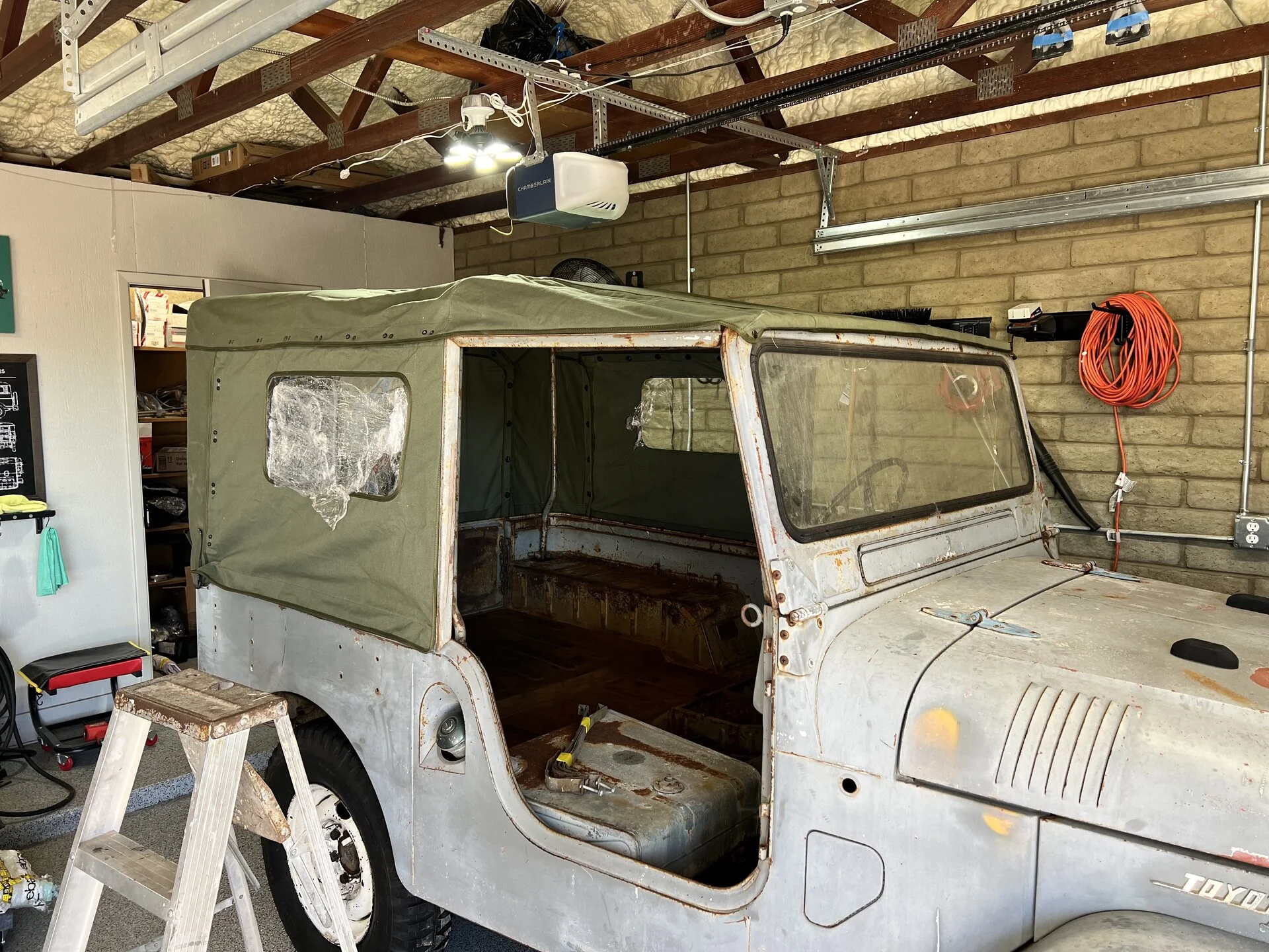

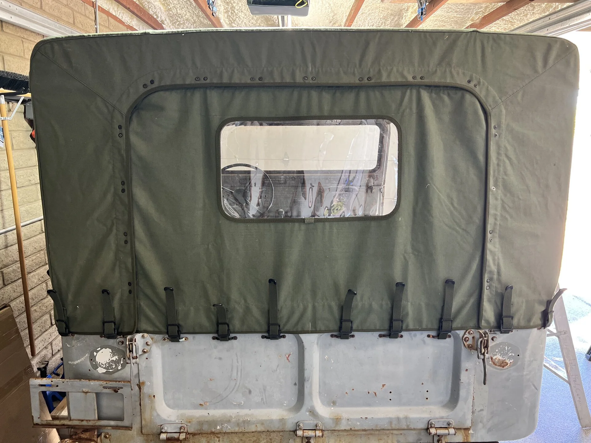

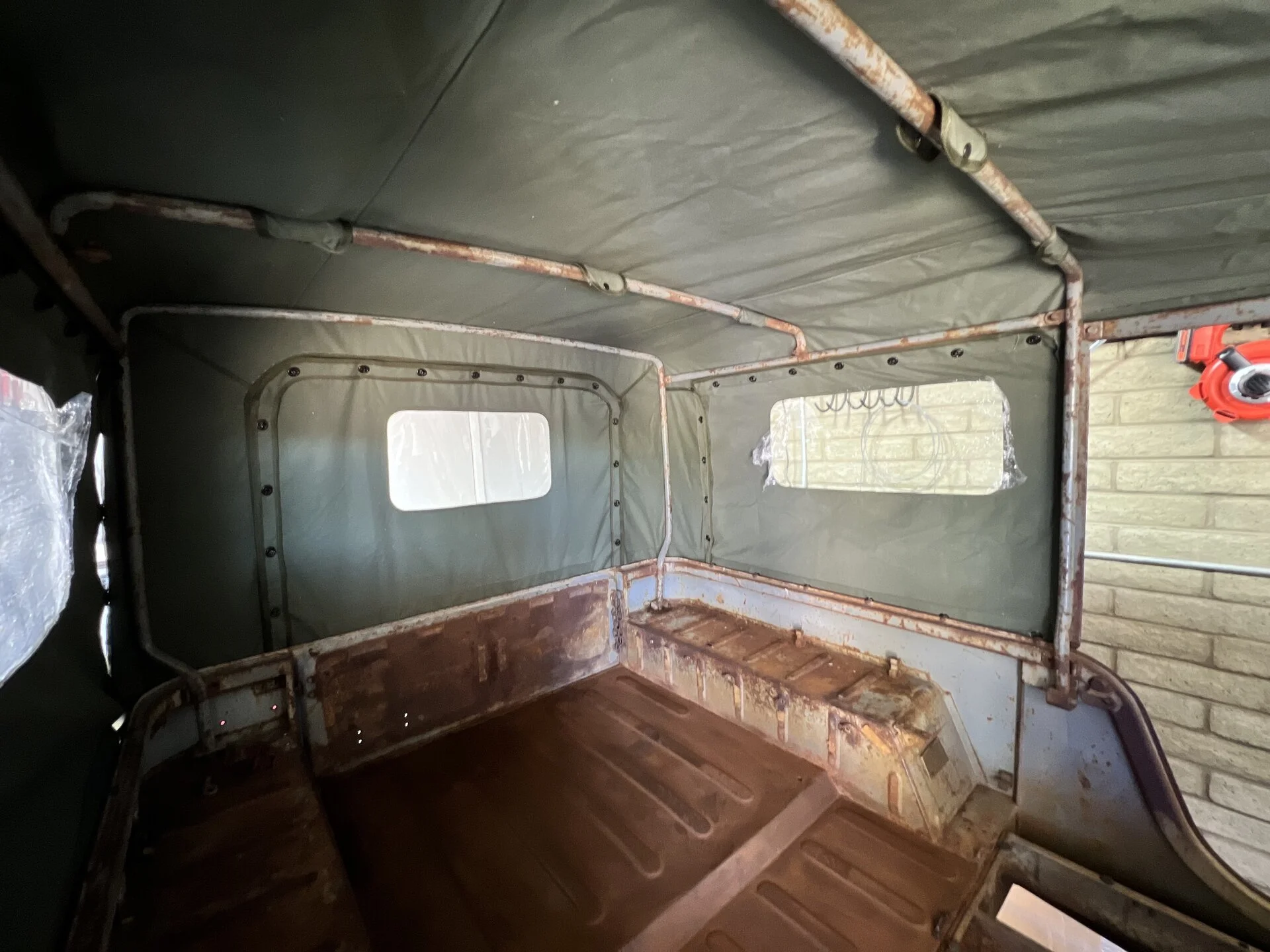

Work is moving along on both of these trucks, but I've gotten really bad at posting updates - my apologies. I got the seats upholstered for all 3 25s at the same time (including FHT Warden) with a nice marine grade red vinyl at a local shop. Put together the full bow set for the ivory truck and installed. Had some soft tops made through a contact down in Colombia, and I'm now working on prepping to repaint Ivory. I debated back and forth on doing a full repaint but its really pretty patchy here and there and several areas just don't match. Paint should be done within the next week I hope (waiting for it to warm up here a little bit), then just reassembly. Really have not run into any issues on that truck surprisingly, been very fortunate its really in great shape. I was going to put in a new fully reworked @Coolerman harness on this one but the harness is actually in pretty good shape so I'll likely keep that one for Ebony or Warden.

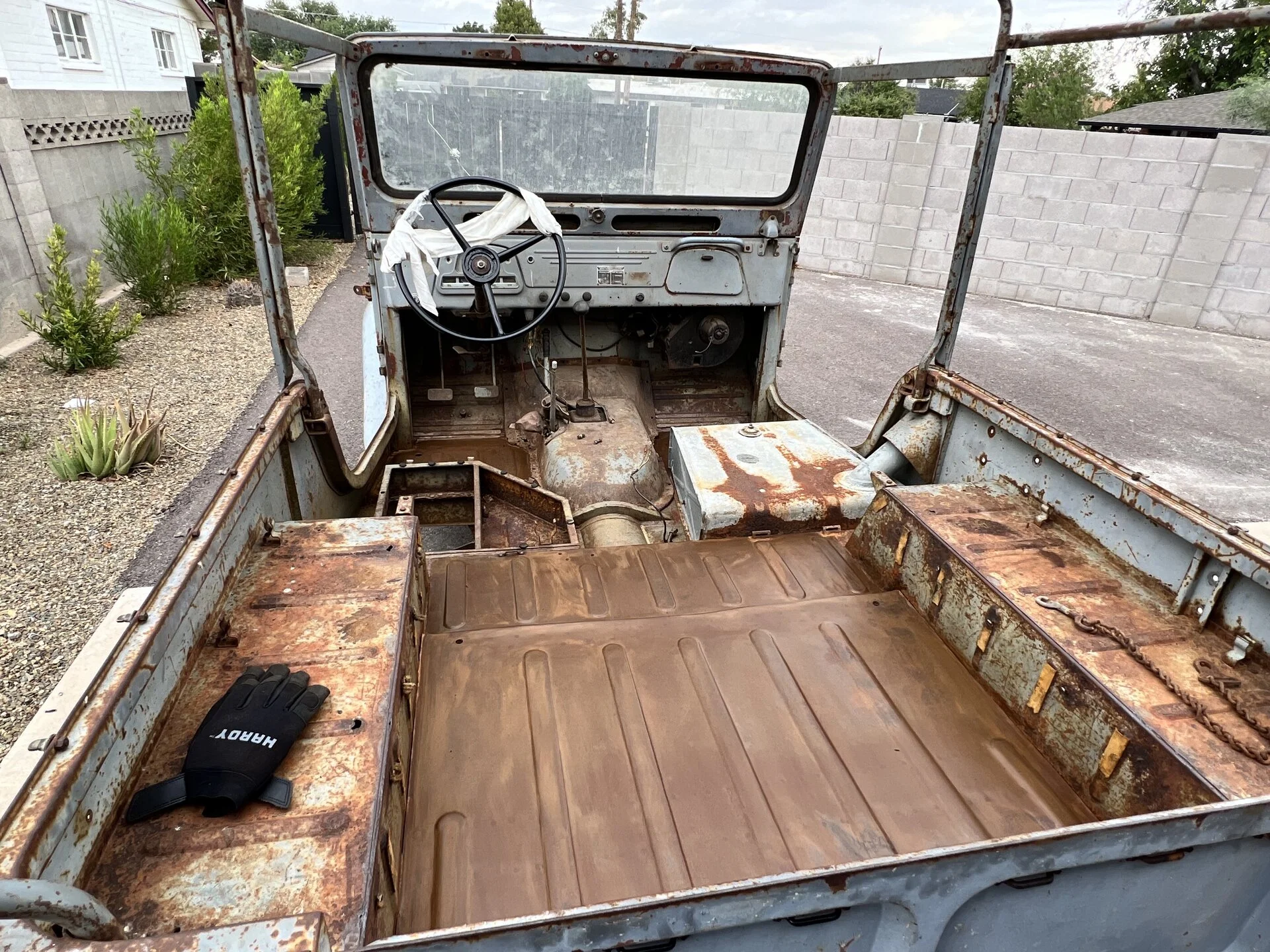

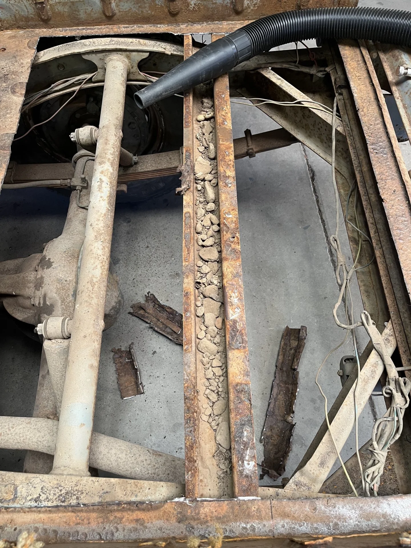

Ebony will be next on the docket, those floors are all done and I gave them a little bit of a surface rust patina treatment that I think helps them not stand out too much. Since there won't be any paint I hope that truck will go together quicker. I just posted an update on the 28 a few moments ago, but we are moving out of state to Tahoe area end of May so I'm trying to get Ivory together and sold (or maybe up to a consignment place) before I leave. We don't have a garage up in Tahoe as of yet so I'll probably have to store these trucks at a property we have in Phoenix for the near term until that situation changes. Probably won't really have a chance to do much with the FHT before that time, but hoping the future will provide an opportunity to move at least a couple of the trucks up there with me.
I'll try to post some more photos within the next couple of weeks. Here are a few of the floors and one of the new soft tops.

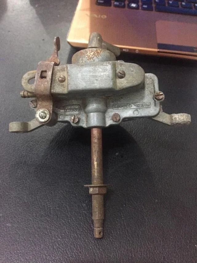

I did have one question for the FJ25 experts out there - I have the Asahi vacuum wipers for both of these trucks but I know I’ll never find the wiper rams. Has anyone found a suitable compatible replacement that fits these motors?
What do the posts look like? I have used generic hot rod/ boat arms and wipers just fine. They look the part on my 65.
Photo stolen from another thread. I’m not sure what the diameter is, I can try to look that up next week. Got any photos of what you’ve used @red66toy ?
Yeah let me snag some photos. The generic ones I use have a little screw adapter on the post to fit the aftermarket arms. Not as cool as originals for sure…. But easy to find replacements. :p
Thanks! Sometimes you gotta be realistic and know you’ll never find a part, and look for a suitable replacement. I’ll have to see what kind of generic I can find that has an adjustment for post size sounds like. If you have a specific one with a link let me know. Thank you!
