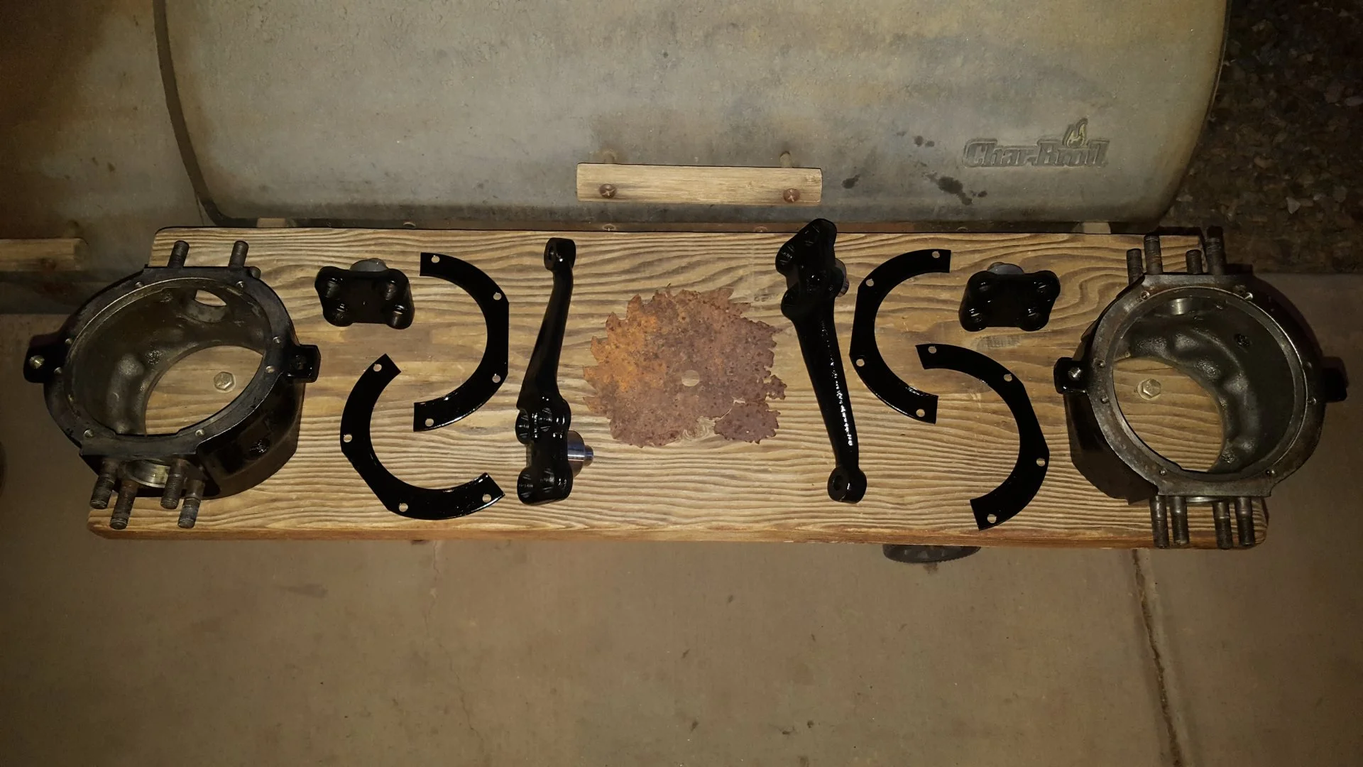

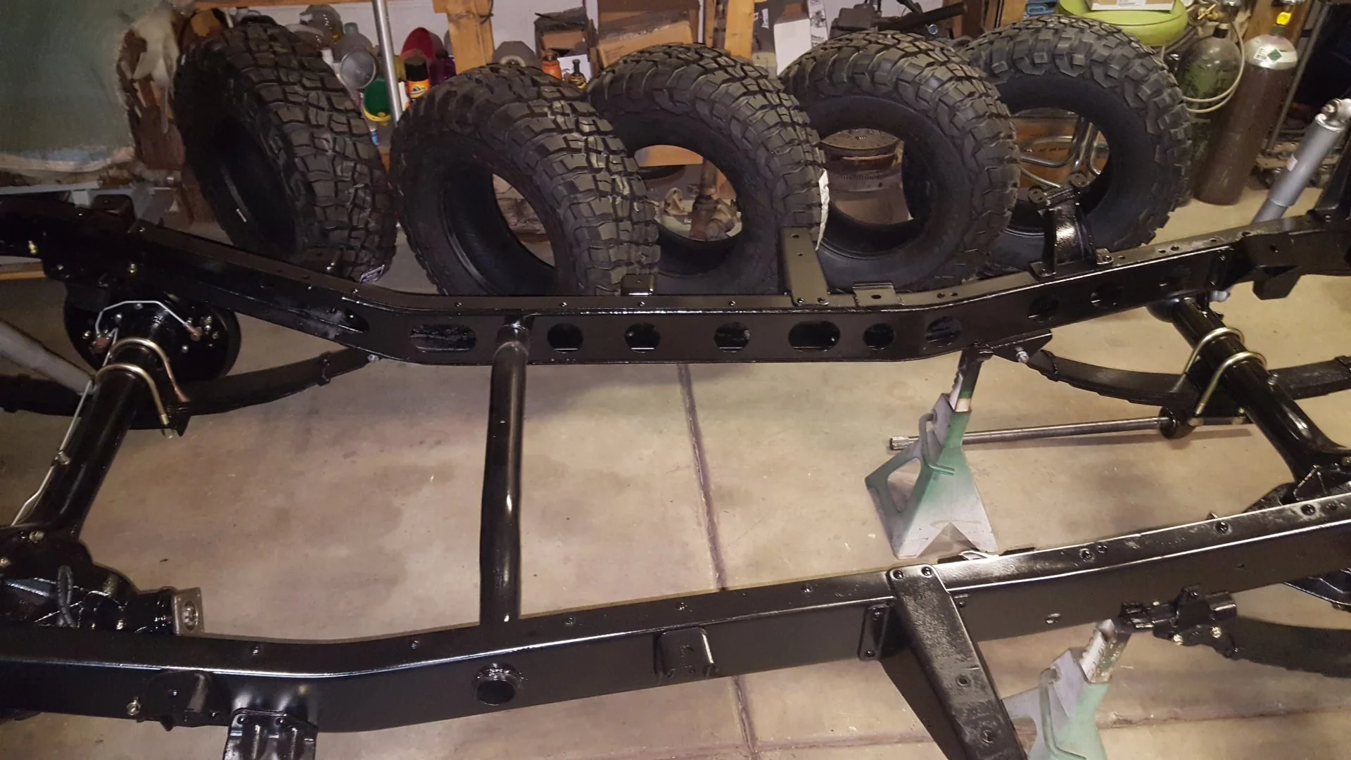

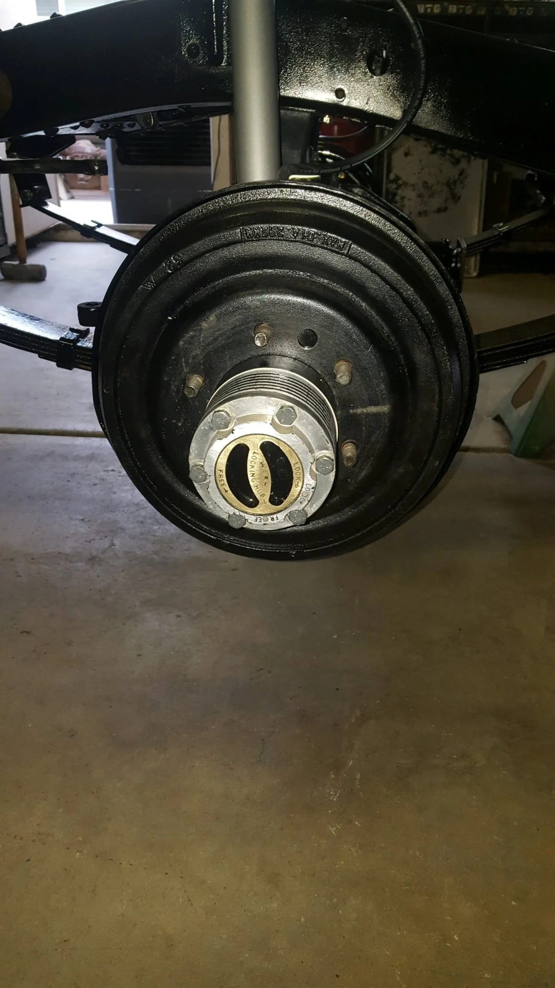

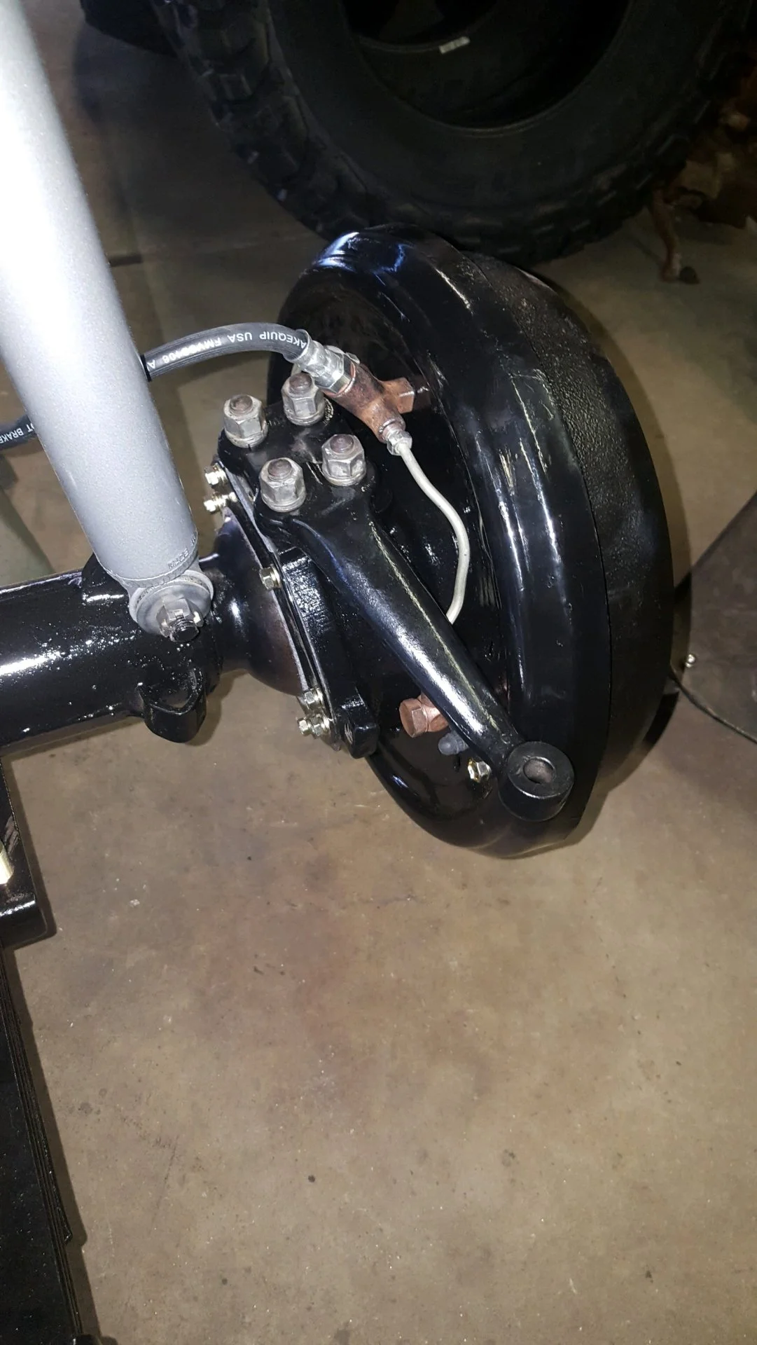

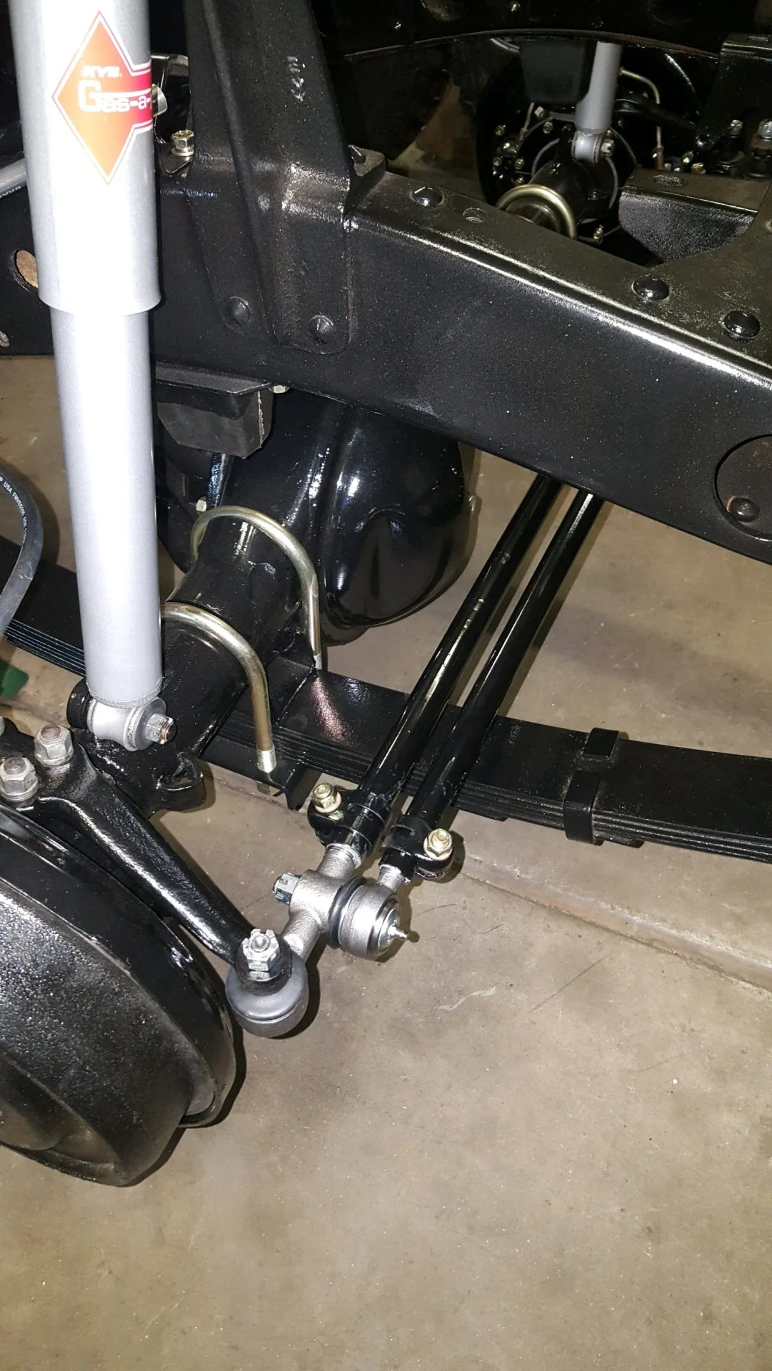

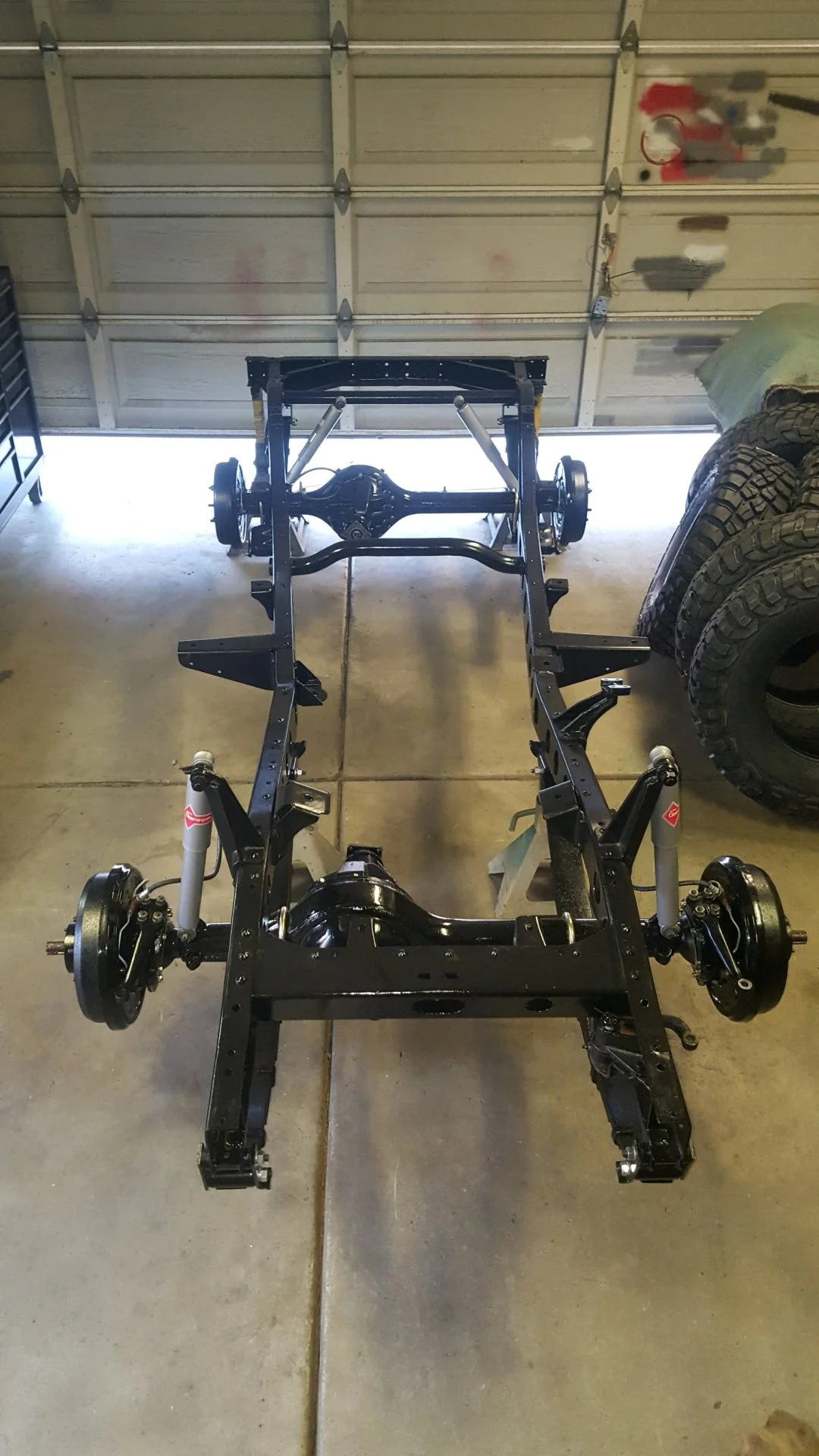

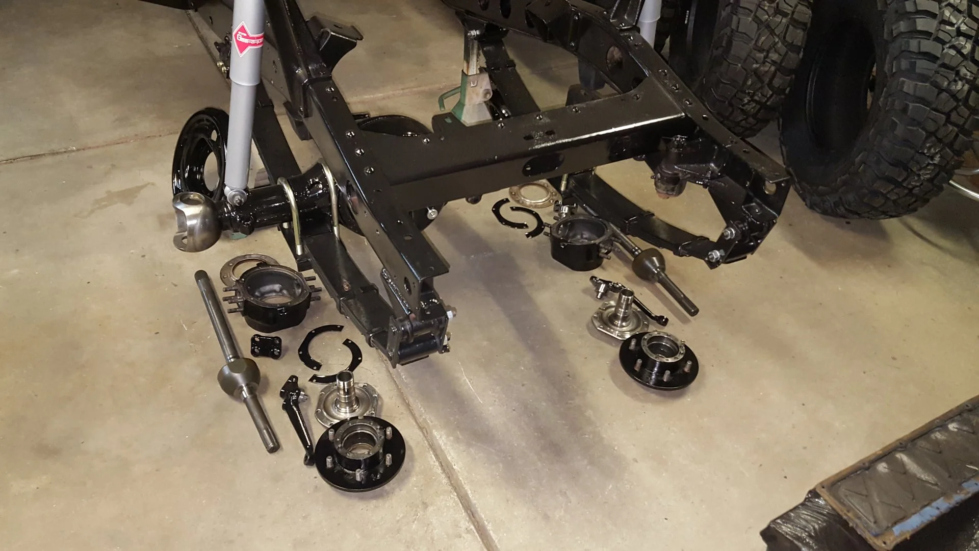

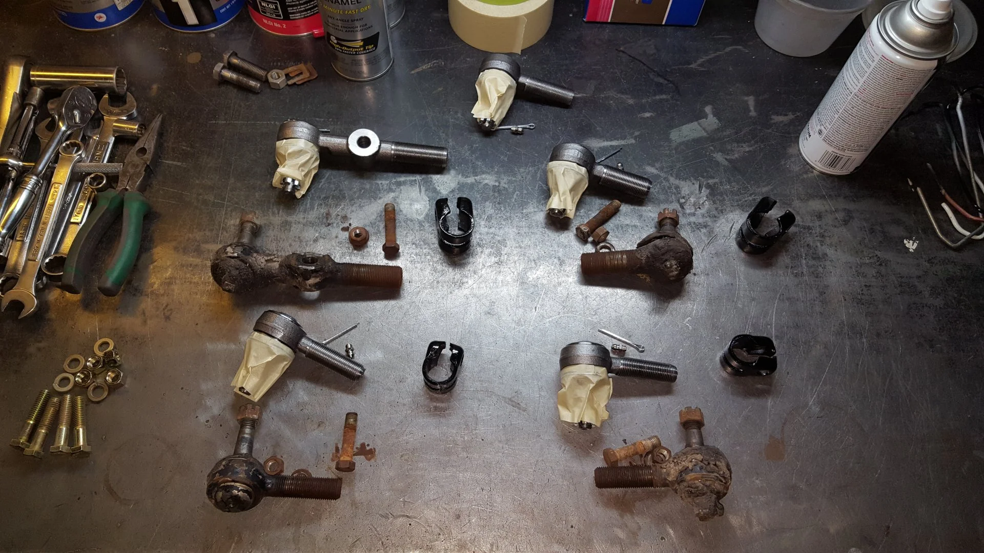

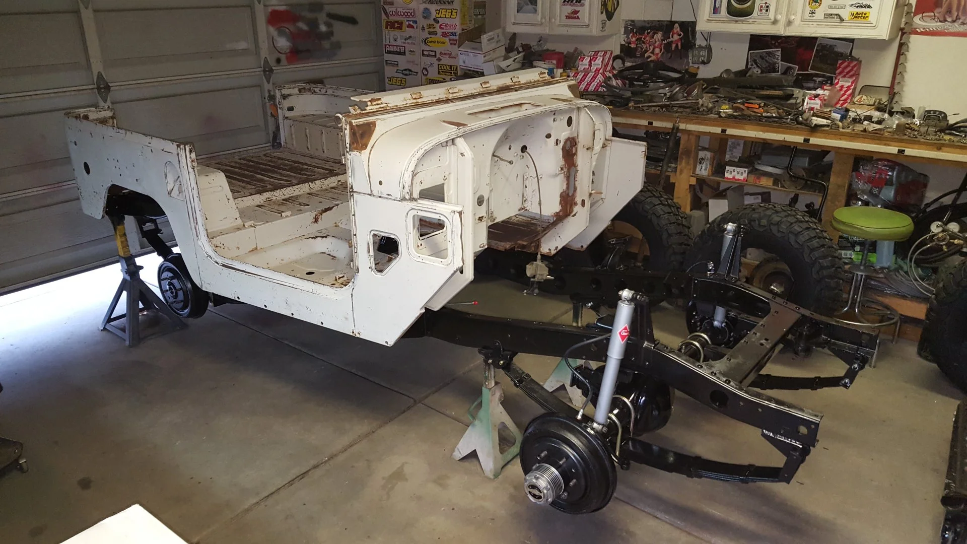

Got a few items cleaned and painted.
I continue to be amazed at what you can get accomplished in your garage.
