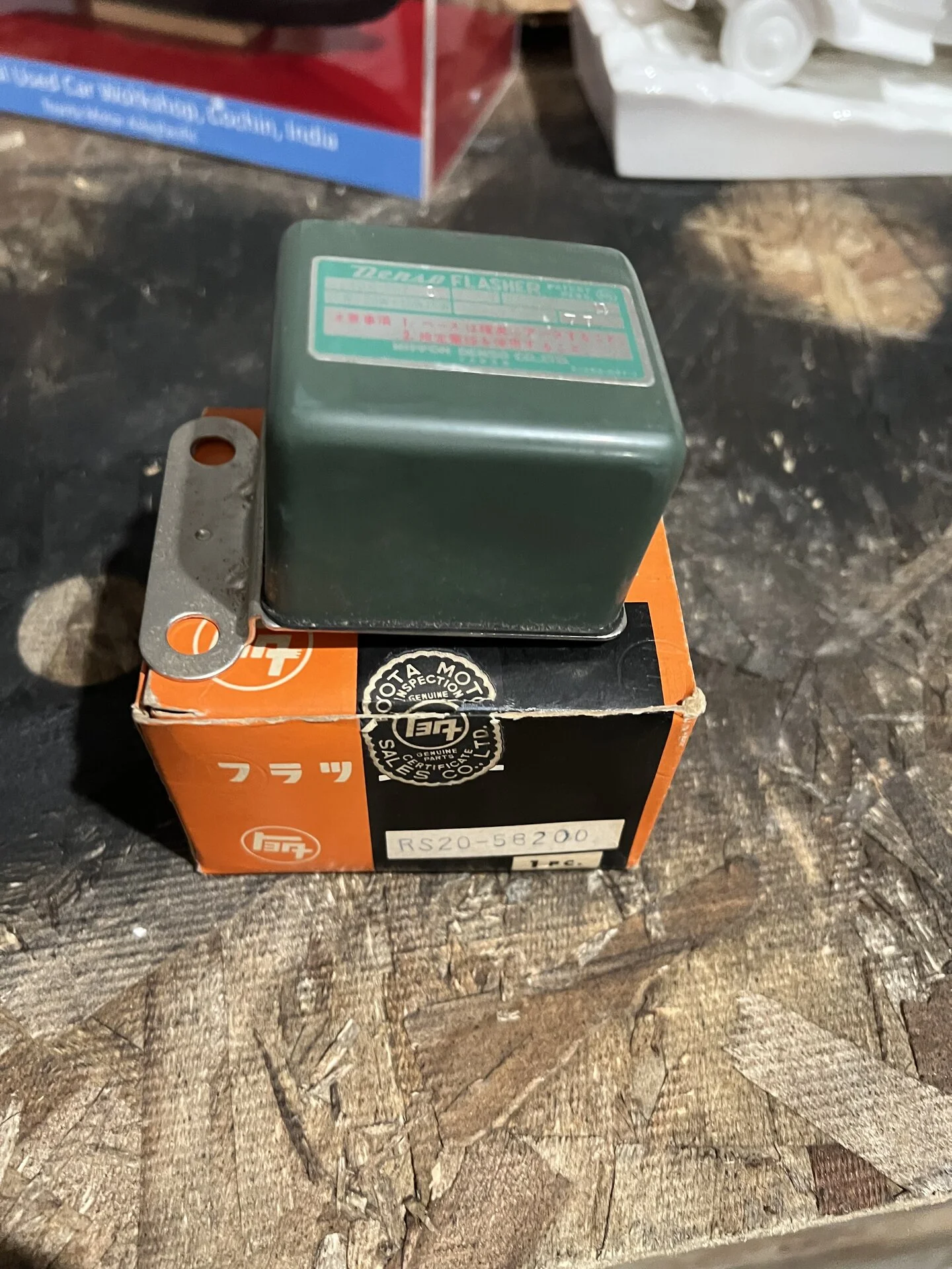

I finally found an original flasher relay. That was one of the few pieces I needed. Now the only thing left to find is an original steering wheel.
The FA90 ones seem easy enough to find - Nippon Denso Flasher 12V NOS 61300-037-0 FA90 58200 | eBay - https://www.ebay.com/itm/394347913973. I suspect with the correct wattage bulbs it could be made to work until the elusive one is found. At least it is the closest thing to correct beside the original RS20 type
Great option however it it would probably flash very slow or fast compared to what it should. Plus what fun would that be? You have to track down the correct parts. That’s one of the most enjoyable parts of restoring a vehicle.
Great option however it it would probably flash very slow or fast compared to what it should. Plus what fun would that be? You hand to track down the correct parts. That’s one of the most enjoyable parts of restoring a vehicle.
Curious does yours have the embossed RK number below that decal? I’ve never seen a new one, wonder if they all had a sticker at some point like that.
I agree fully that the fun lies in finding the correct part. However, no sense in not having anything work or using a generic part when the FA90 one is not very expensive in the greater scheme. 10 minutes to swop out to the correct one once found.
If you compare the watt ratings on both, only dash indicator bulbs need to be dropped from 15w to 6w and function should be normal.
I have not pulled the cover to check yet. My guess is that the embossed one was original in the late 50’s. Then they made a newer version with decal. I will let you know.

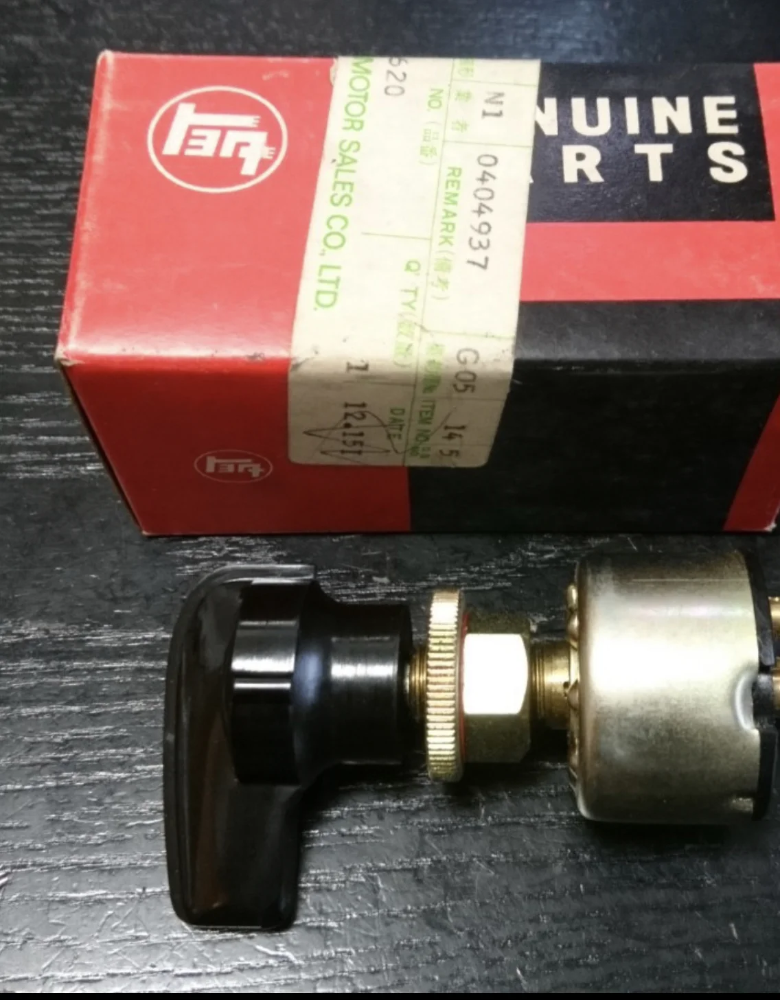

With that being said, I finally had a few hours today to work on Project Sundune. I still have a long way to go however it’s getting closer everyday. Luckily, Mark, @Coolerman build me a wiring harness so that will save me a ton of time. Planning on installing that next. (mark, I found the correct dash mounted blinker switch) I will try to update as the progress continues.
