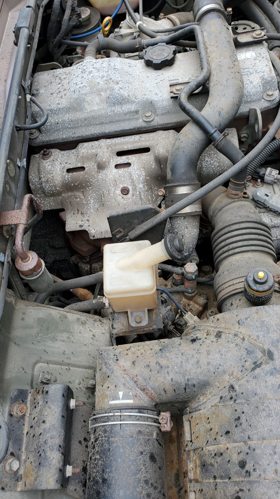

I got mine from Import Engine Supply, here in Boise. Brent sourced it from his overseas supplier, not sure where exactly though as I wasn't who it was originally sourced for, just who ended up with it.
