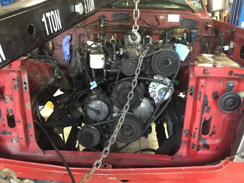

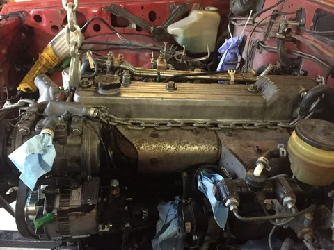

She's in! Got the motor stabbed last night but it was too dark for pictures. The mounts are tacked in, now I am just going to double check everything and burn them in permanently.

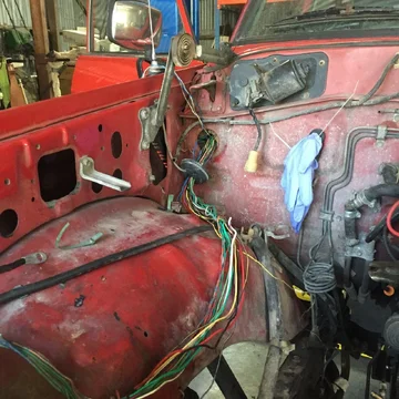

I've been taking care of the wiring situation the past couple of days and so far so good!

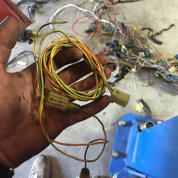

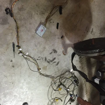

First step was separating the motor specific wiring out of the HJ-61 harness (glow screen, turbo tach lights, starter solenoid, etc.)
Then I went through and isolated the carb and emissions wiring out of the 2f harness which was pretty straight foreword.

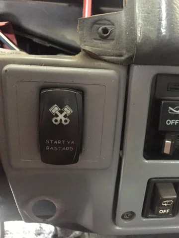

Also this is the rocker switch that I am going to use for the glow screen:
