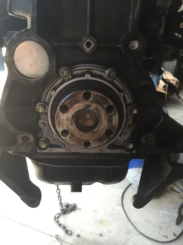

Been pretty busy the past couple of weeks and haven't had time to do an update. Most of my parts came in from Japan 4x4 and @beno (Thank you!!) so i've been busy getting the motor ready to drop in. Re-assymbled the head, changed the front crank seal, and basically have it to the point where I just have to drop the oil pan, change the rear main and then drop it in!

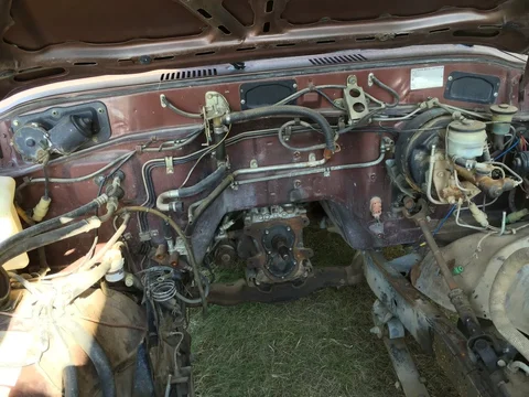

Today I pulled the 2f out! It was fairly easy! Marked all of the important wires with tape so that whenever I am splicing in the Diesel harness it will be a little bit easier.
I still need to order a starter and alternator, and I need to do so soon so that they don't hold up the operation! Anyways that's really all I have so far, here are some pictures:

I replaced the rear main seal, re-sealed the oil pan, and started looking at the throttle cable/ pedal setup. I am hoping that the stock RHD HJ61 cable will work. Has anyone integrated the hand throttle system that came with the HJ? It fits in the empty hole on the right side of the steering wheel... I am wondering if that could be used as a manual "cruise control". I know it will just keep the RPMs at a certain level but it could work.

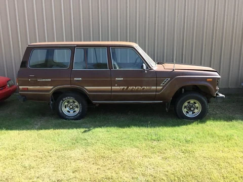

Oh also my dad (@CenTXFJ60) decided that he couldn't go without a diesel in his rig... I present to you guys a 0-mileage 12h-t that was imported here into the states back in 1988. It's a package deal: 83 fj60 with 83k original miles, h55f and split case with only 5k on them, and the 0 mileage 12h-t aka the unicorn. Looks like I will be doing another swap in the near future but it should be a breeze since I am learning everything with my rig.
