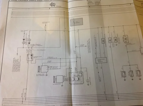

Here is a snap from FSM supplement 87 onwards, just for your reference
That is perfect, I have the fold out wiring diagram like that for the 2f but the one you sent is gold.

Also I cannot seem to find the neutral start switch. As you can see in the u.s spec wiring diagram below it is no where to be found, I am guessing this is because automatic transmissions were not an option pre- '88 over here. Will the starter not engage fully if the neutral switch isn't either connected or looped into the circuit? I am honestly running out of ideas. Maybe a roll start will work? I should also note that I am getting 12.79 volts at the positive battery post, the white wire on the relay, and on the positive cable post on the starter itself.
