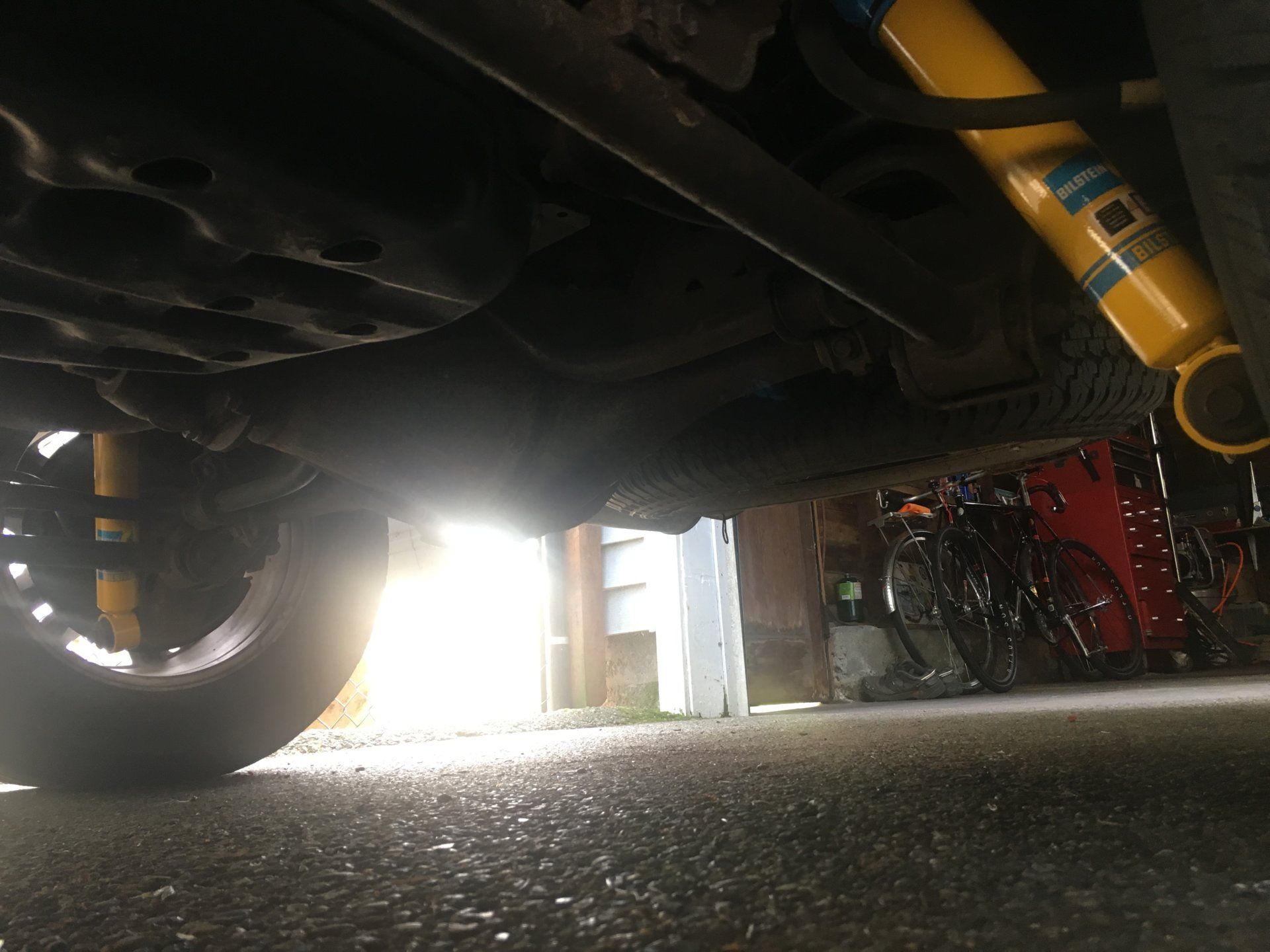

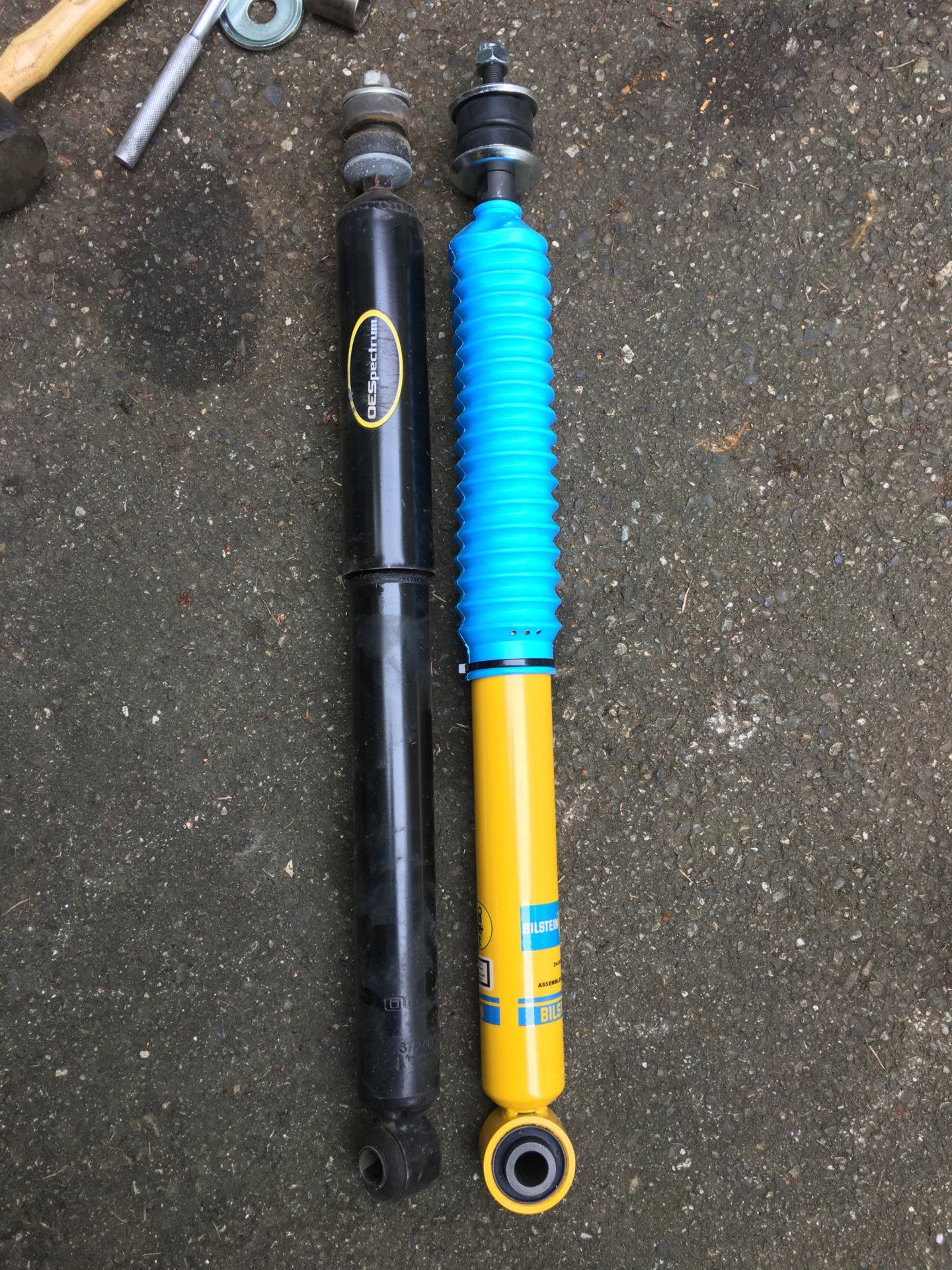

The weather finally feels like it’s turning the corner here so I decided to tackle my rear shocks today. Luckily they looked to have been replaced within the last couple years so rust wasn’t an issue and they came out without too much fuss. Getting the Bilstein 4600’s in was a little more of a hassle, a 22mm or 7/8” ratcheting wrench for the top nyloc nuts would have made the job LOADS easier but I couldn’t find one locally, so was forced to struggle through with just my standard wrenches. Even though the old shocks didn’t look bad I did a quick driveway compression test and noticed that the left side shock was pretty well blown out already. Glad I made the change, the truck is really starting to feel a lot tighter now.
View attachment 1928935View attachment 1928936

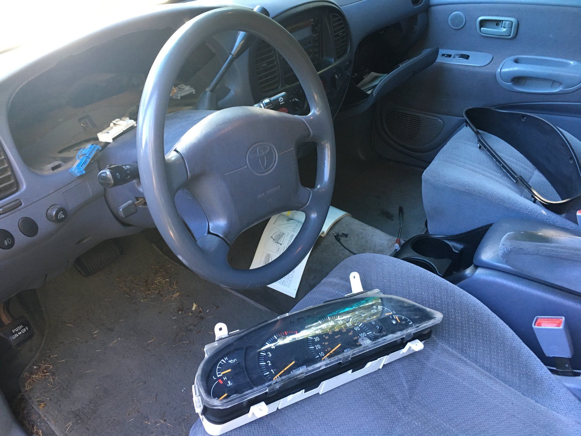

I really need switch gears and focus on dialing in the old Tundra so I can send it down the road. You know, fixing all the nagging little things that my lazy ass has put off for years. First up, instrument lights. The O/D light has never worked under my ownership, the D light and fuel gauge lights went out years ago. I’ve found the part number for the D and O/D (83120-60020) but not the fuel warning light. It’s quite a bit larger than the others. The fan switch light is also out on the Tundra, the Sequoia also has dead bulbs for the temperature and the fan knobs. If anyone has part numbers I’d love to hear them... So I’m nipping it in the bud and taking care of all of them at once.
