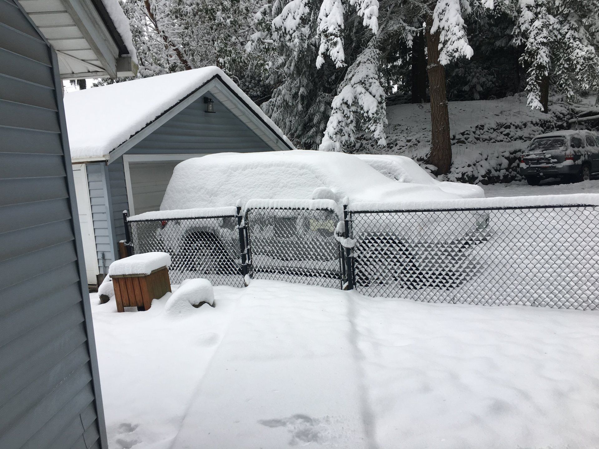

Currently starting to get snowed in...

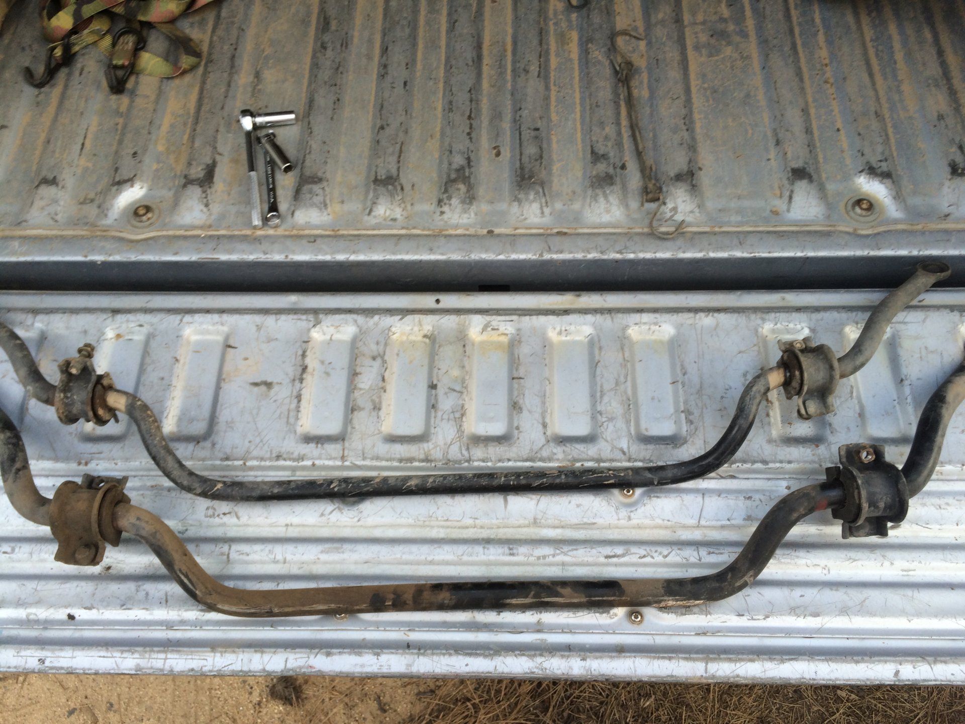

When I leveled my [2WD] Tundra a few years ago I also swapped out the Tundra 23mm bar for a 28mm Sequoia sway bar (2.1x stiffer) as well as a rear stabilizer. The truck went around corners so well that I felt the need to beef up the side bolsters in my drivers seat (which I did, and it works wonderfully). It goes around corners better than a 2 ton pickup has the right to. I then quickly learned that the stock end links were at a terrible angle when they both snapped, leaving me with a "disconnected" sway bar. I did not like the increased body roll at all, absolutely hated it. So I found the Wab Fab links and all was well again.

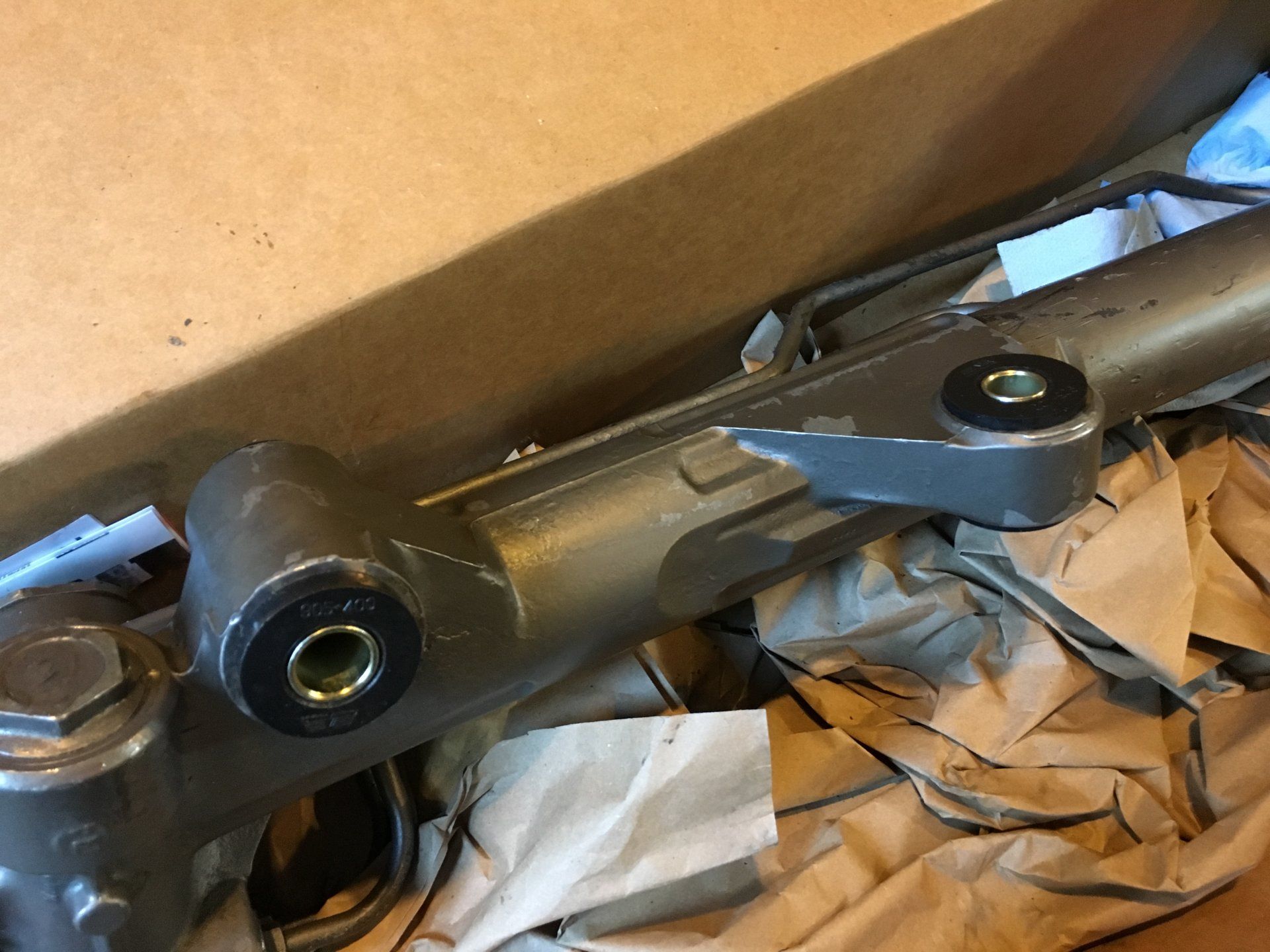

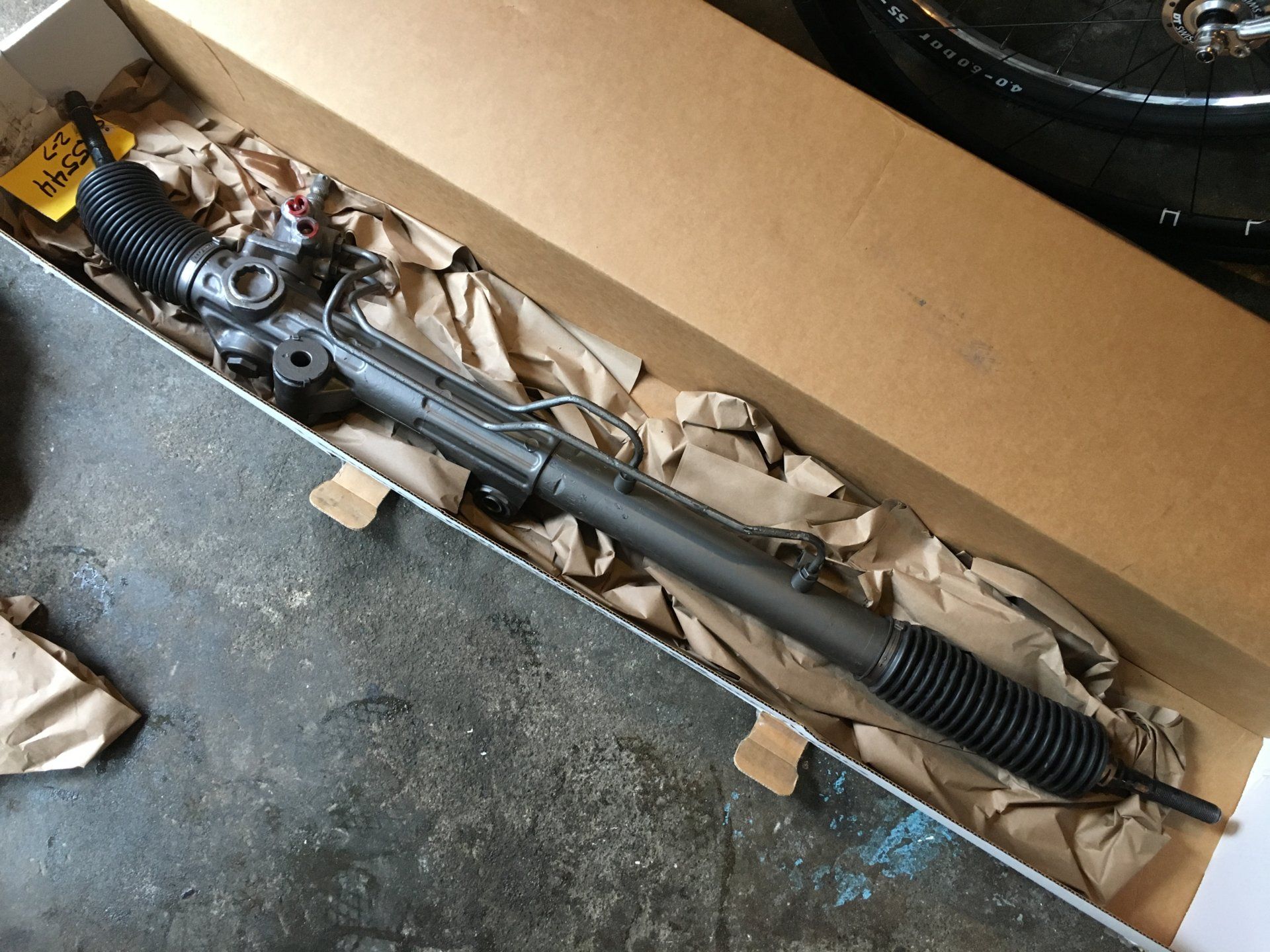

Rebuilt rack arrived today.

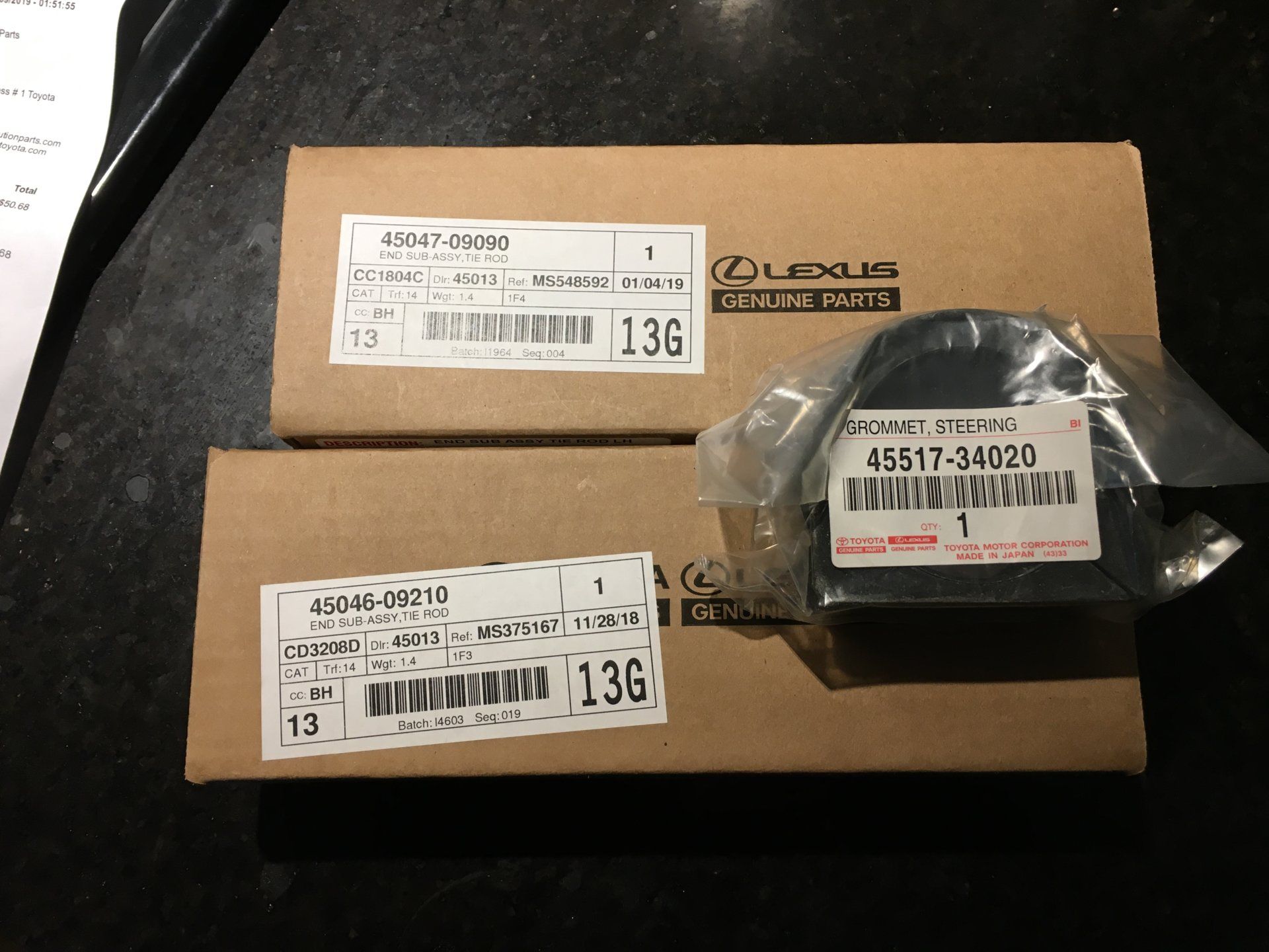

Tie rod ends and the large steering rack bushing from Toyota should land tomorrow. I need to grab another lower shock bolt, drivers side one did not survive reinstallation. Things are going smoothly though, I’m glad I decided to do the shocks right now as the old ones and their bushings were pretty well shot. It should drive a lot better!

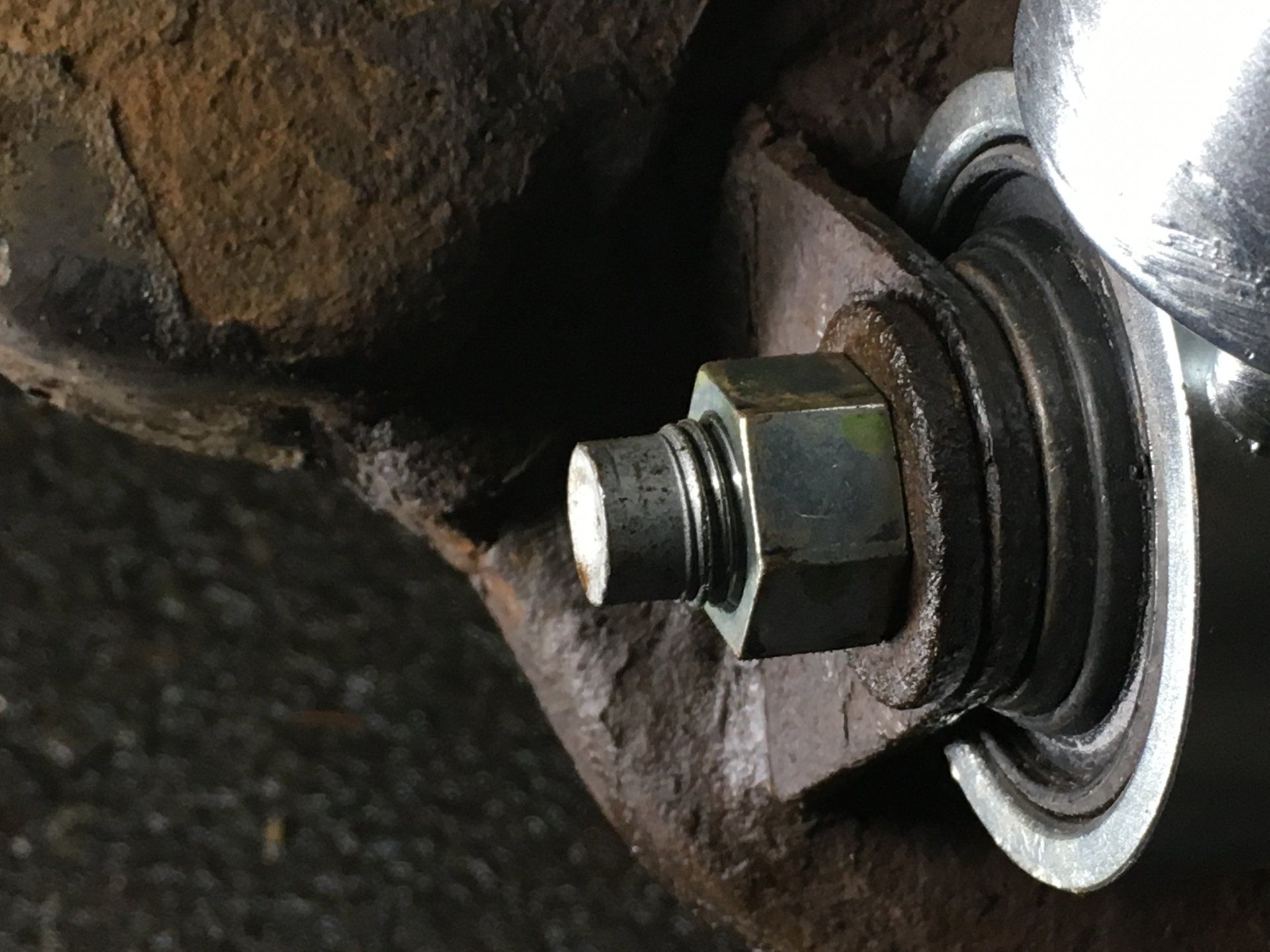

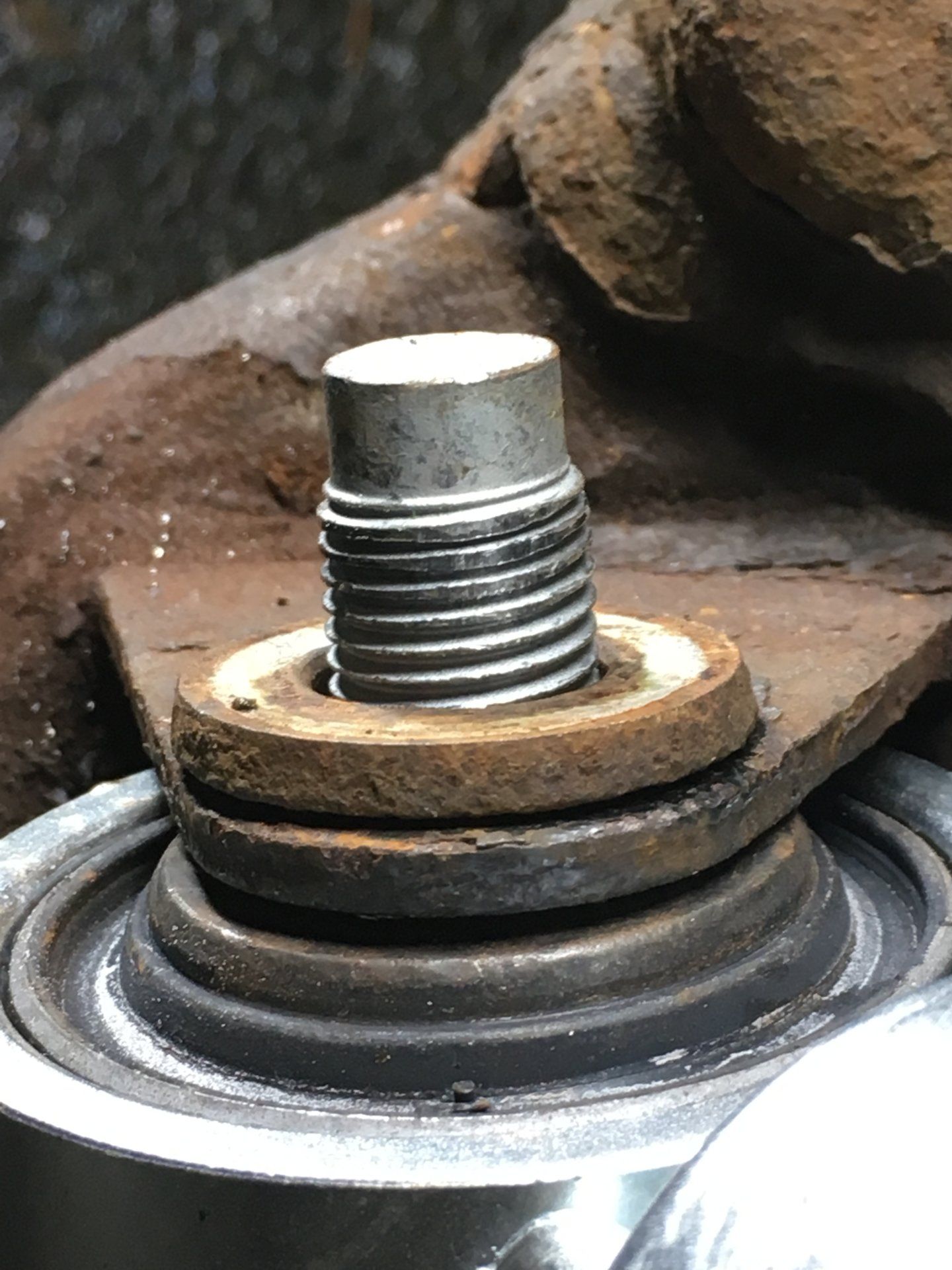

So I’m still impatiently waiting for my tie rod ends and rack bushing to arrive but there’s always something to do. The drivers lower shock bolt gave me a really hard time. The passenger side went in fairly easy, the drivers side didn’t have quite enough clearance for the bolt flange to slip by the axle. An extra mm and it would have slid right in but it didn’t, and it wasted the threads. So I stopped by the dealership for replacements. This is what $8 and change gets you.
1909414
So let’s try this again. I still have the same damn issue, and yet again **** the threads up.
1909415
Motherfucker.
Of course my tap & die set only goes up to 12mm so I’m off to the hardware store. They didn’t have thread files so I’m out $15 and some more change for a 14x1.5 die.
1909422
Cleaned up
1909425
Nut installed and I can finally call the front shocks done.
1909427
This couldn’t be normal, could it? What was I doing wrong?If this is what I have to look forward to next time I replace a strut component then I’ll just R&R the axles at the same time... Unless that opens up a whole different can of worms(?). Any reason why I couldn’t just run the bolt the other direction next time? This was absolutely ridiculous.

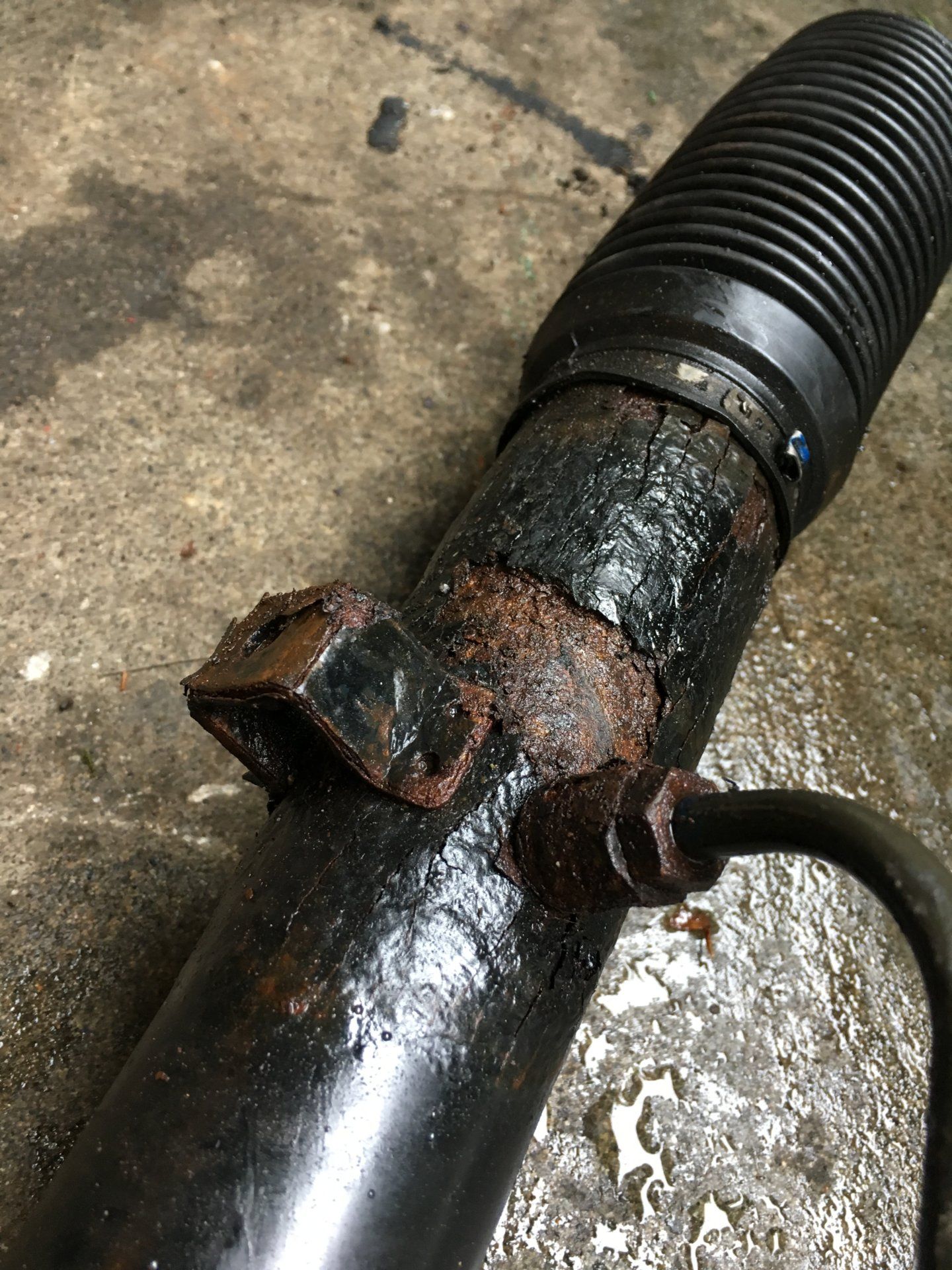

Today was my day off and I planned to get a lot done but I wasn’t planning on a rain delay. Anyway, after a bit of a soaking wet struggle I managed to finish getting the rack out. I’m shocked that I haven’t broken off any hardware during this job as the surface rust is extensive.
I think the thing rusted out behind the rack clamp and couldn’t keep pressure. That really sucks because I doubt that I’m going to get my $175 core charge back on this pile. I could have spent an extra $50 and got a new one from Toyota. Dammit. Hopefully they’ll at least give me partial credit.

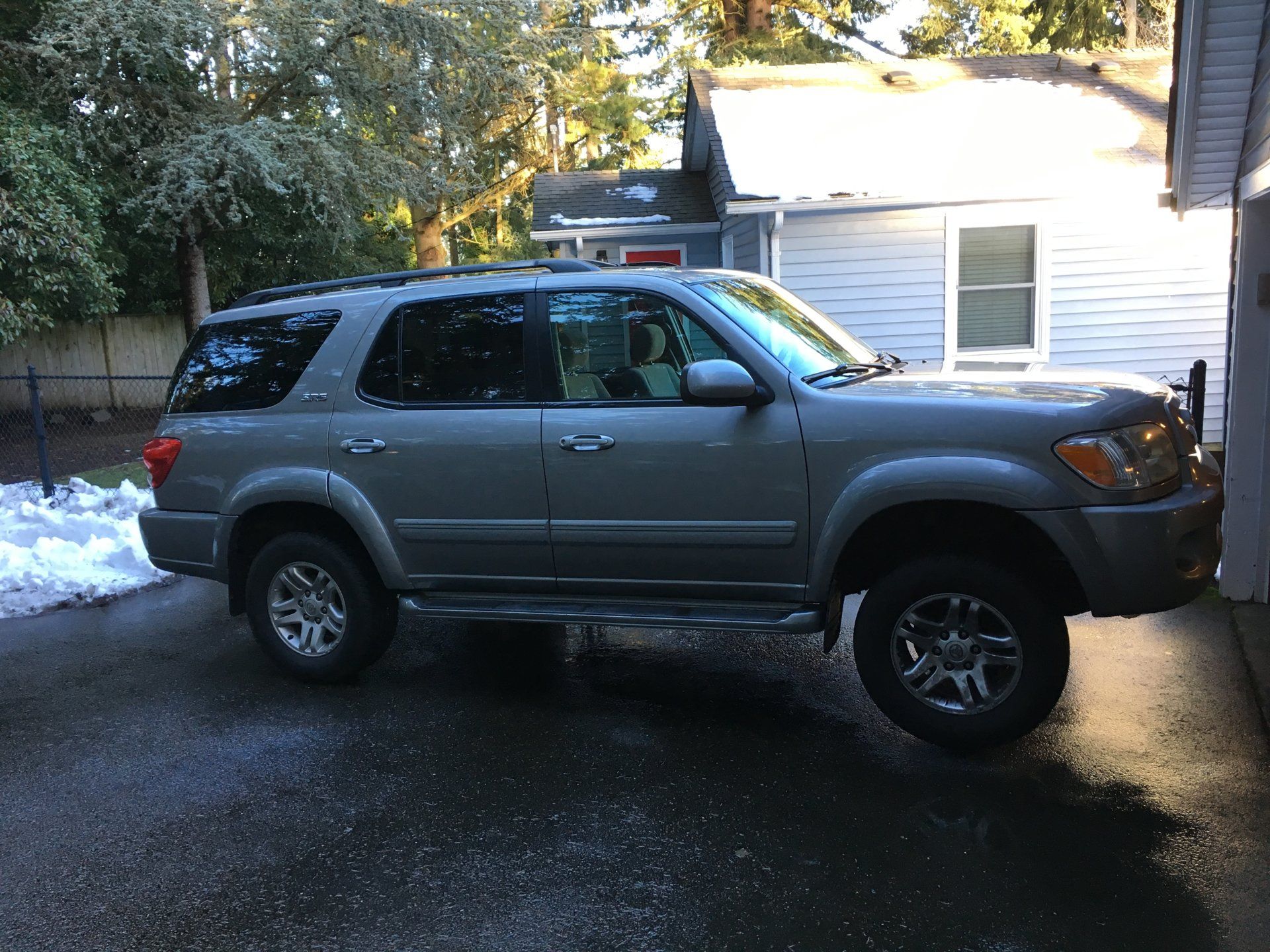

All back together, waiting for an alignment.
1912436
I have very little confidence that I centered the rack correctly, we’ll see how that goes 😕
I’m very happy with how it sits though. Instead of looking like a station wagon that happens to have 4WD, now it looks like a 4WD that happens to be a station wagon.
