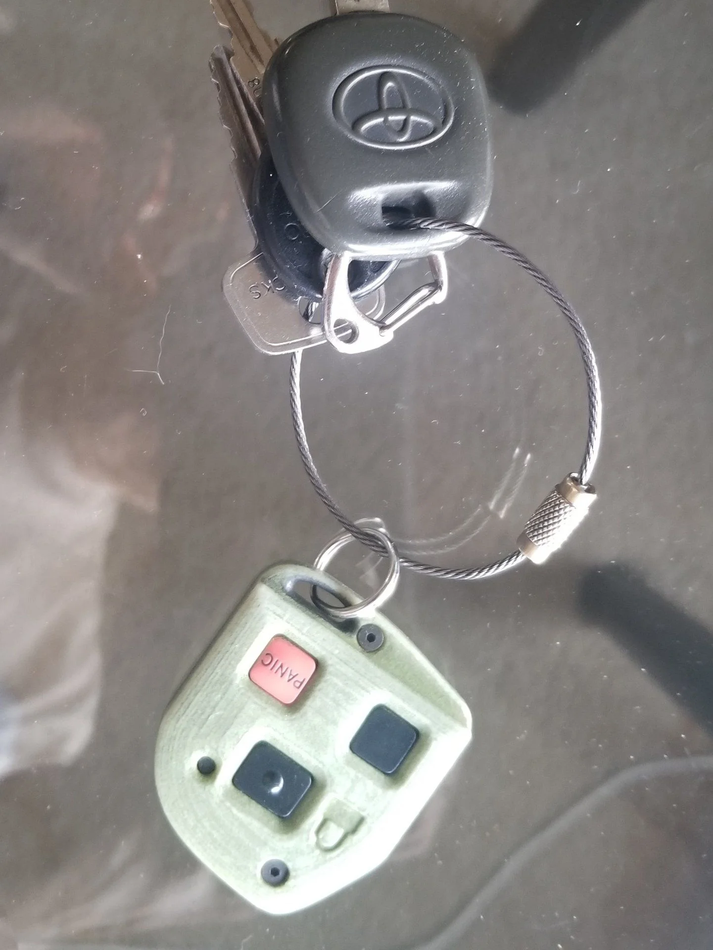

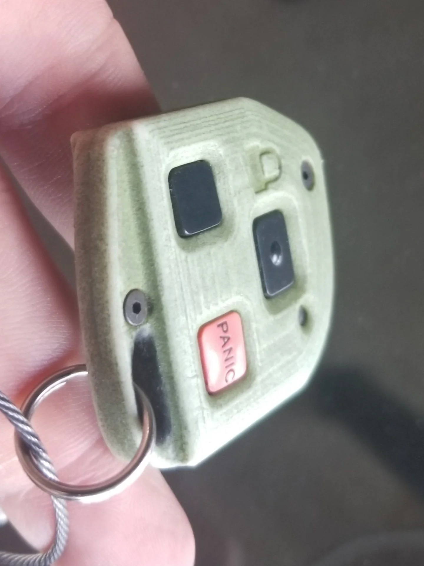

Ryan, if you don't mind posting a pic, that we be appreciated. Also, if i have a fob for the doors and valet key to start the truck. Does the fob need to stay with key, or can I start the truck, get out and lock the doors, and just use the door fob to get back in? Or if does the fob need to stay within a certain distance of the truck at all times?
Here is a few pics of the YodaMD fob holder. This one has some miles on it, but it is holding up well.

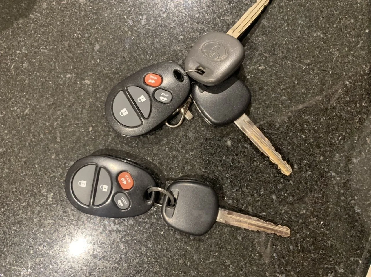

Just to wrap this up in case anyone searches for 2006 LX470 key replacement:
I bought two T29 chips from Lockpicks.com ($10 each)
I bought two FJ Cruiser replacement keys from RemotesRemotes.com with a 12BBT remote ($26 each). They came with G chips which I’ll probably throw out, and the wrong key blade.
I stuffed both of these inside the eBay blanks I got ($16 for two). The blanks were supposed to be for 2006 LX but wrong chip (T30) and wrong remote (1512V).
Anyway, it all works! Pain in the butt, cost me about $62 for parts, another $60 to have them laser cut at the dealership. Still lot less than new Lexus keys.
Then I broke apart the shells and packed it all into YotaMD case. Still cheaper than factory keys. In future, if anyone is looking for this blade/chip/remote combo it might be worth getting in touch with RemotesRemotes or someone similar and see if they’ll send one already built. I know they have all the parts.

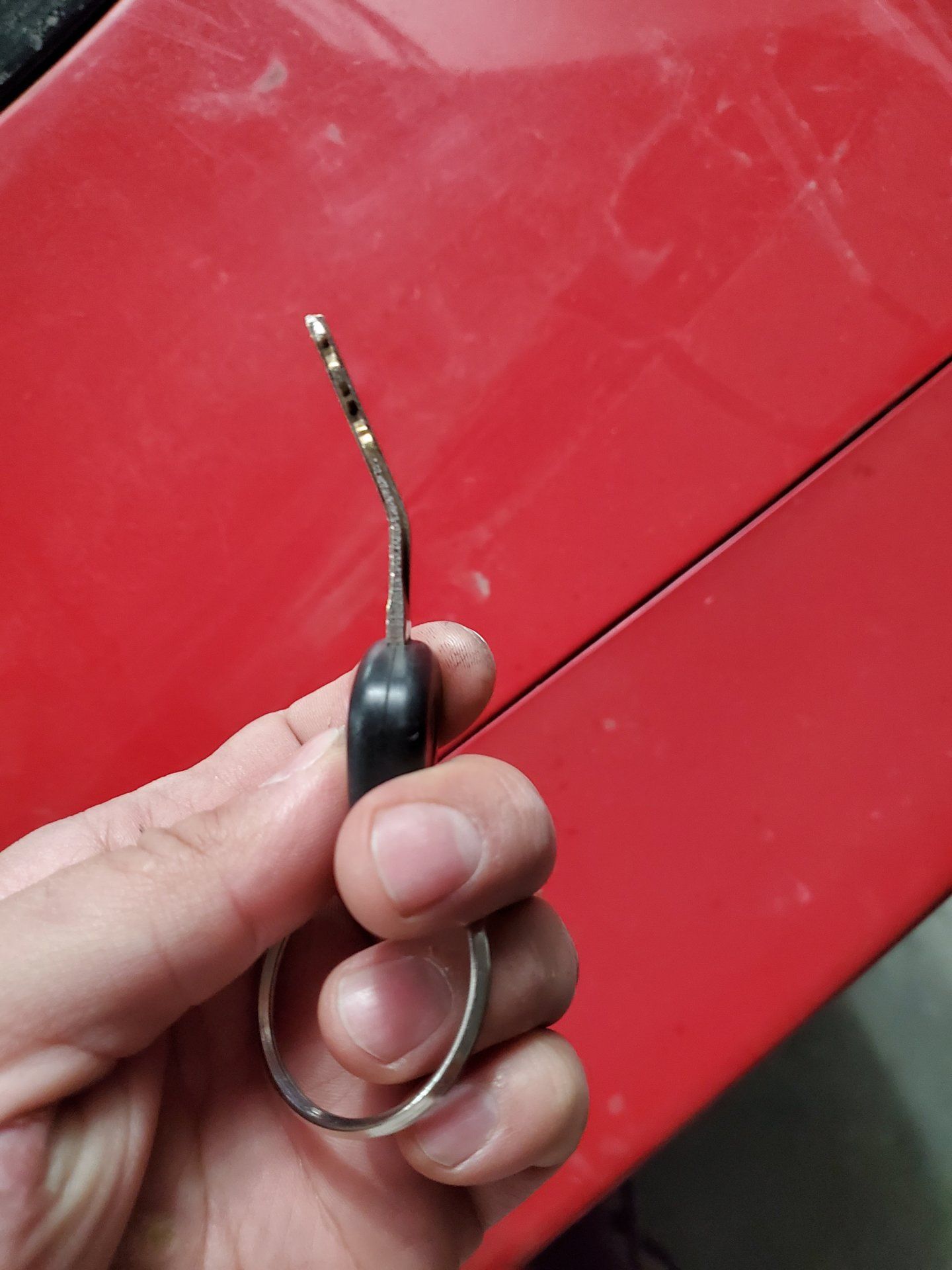

I'm down to my last working key (valet key). I bent my second valet key while closing my tailgate with the key in it, and the lanyard hooked into my bumper...
Any help would be appreciated!
