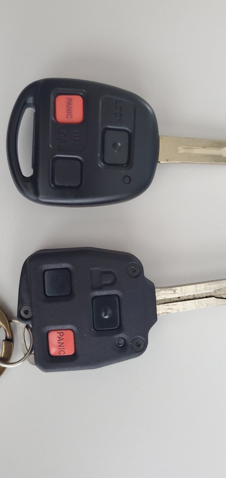

I had my blonde moment this month...
I received my keys from 1010keys and ebay and had no issue programming the immobilizer chips.
I attempted to program the fobs a dozen times and continuously failed. I kept coming back here to look for a process that would work.
It came down to the erasing of all fobs and programming. My orginal key programmed no problem. New keys failed. Then I noticed that the unlock button was also labeled panic. Once I pressed the unlock/panic and lock then the lock fobs all programmed.
I was able to disassemble the remote before installing in other YotaMD shell to swap the panic/unlock buttons.

Over the past two days I've tried many times to get the key FOBs to communicate with the vehicle once I've activated the FOB program mode. I can get the vehicle in program mode, but nothing happens when I hold down the buttons.
I ran this problem by @Mauser and he referred me to post #135 on this thread. My buttons appear to oriented properly. The keys light up. Not sure if it's batteries in the keys or if the FOBs are duds?
