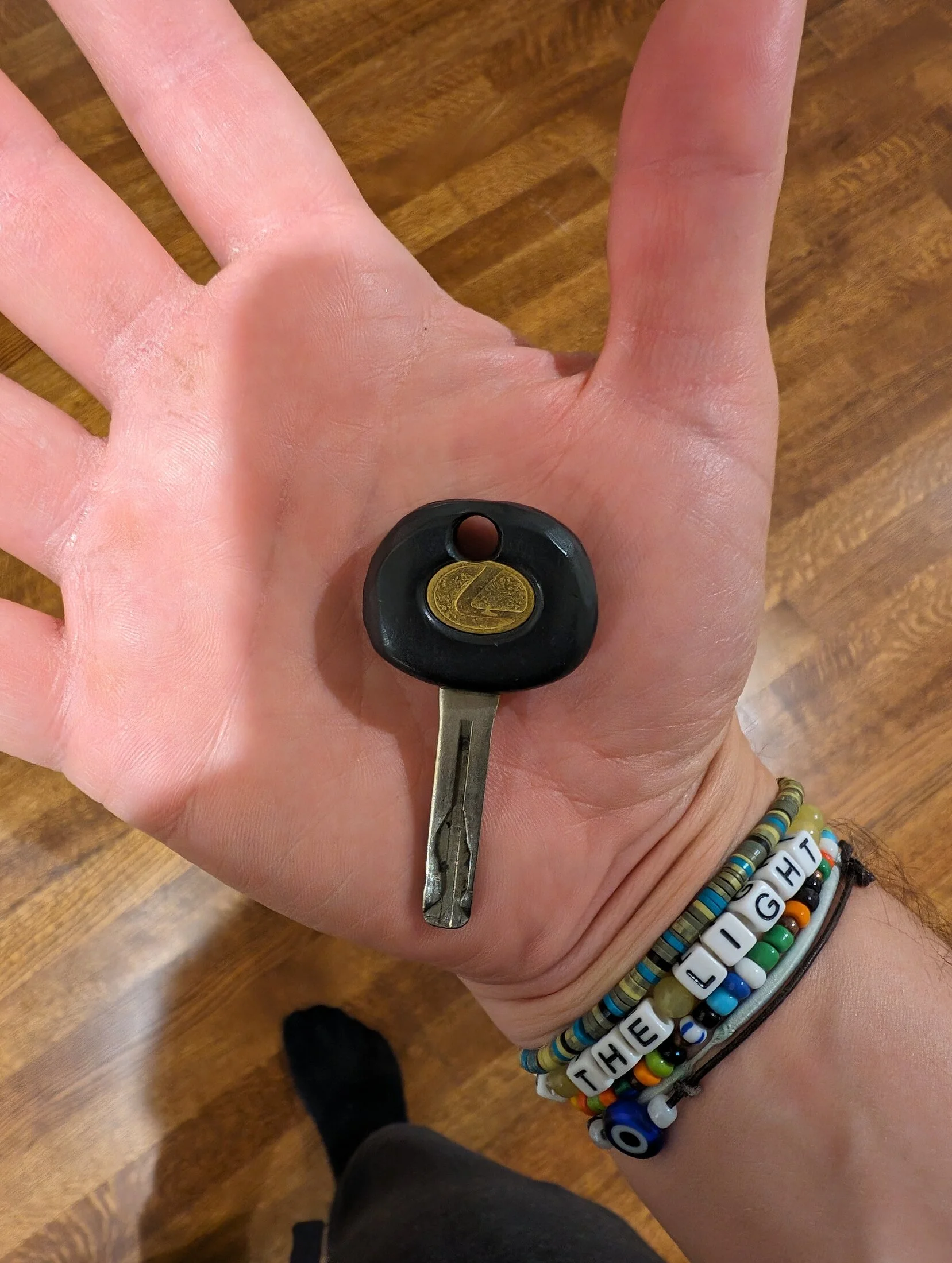

hello all! I’ve read through this entire thread and just have a few questions pertaining to my key situation with my 03LC. When I purchased the vehicle it came with a transponder key ( no buttons ) and what I believe to be the valet key as it does not start the vehicle only unlocks doors. When checking the security light with the key that turns over the vehicle, it stays on for about 2-3 seconds. which leads me to believe this would be not the master key.
Stealership wants $280 for new key with fob plus $210 for program. I’m not really trying to go this route.
Local old school locksmith said they could cut A key and remove and program new keys to vehicle.
My goal is to obtain two new key fobs that remotely lock and unlock the vehicle and also keep the transponder key as a spare . Is this possible? Given I’m not sure that the key in my possession is a master key. I understand that I can flash the ecu with the techstream but I don’t have access to that.
I’m considering buying this oem fob new online and just getting it cut and programmed by the locksmith just trying to figure out the most viable solution here. I appreciate the help or feedback !

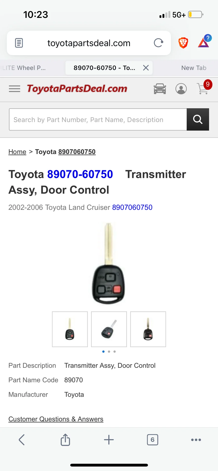

Does anyone have part number for the two-button, international master keys? Also, is there a part number for the two, button transmitter only?

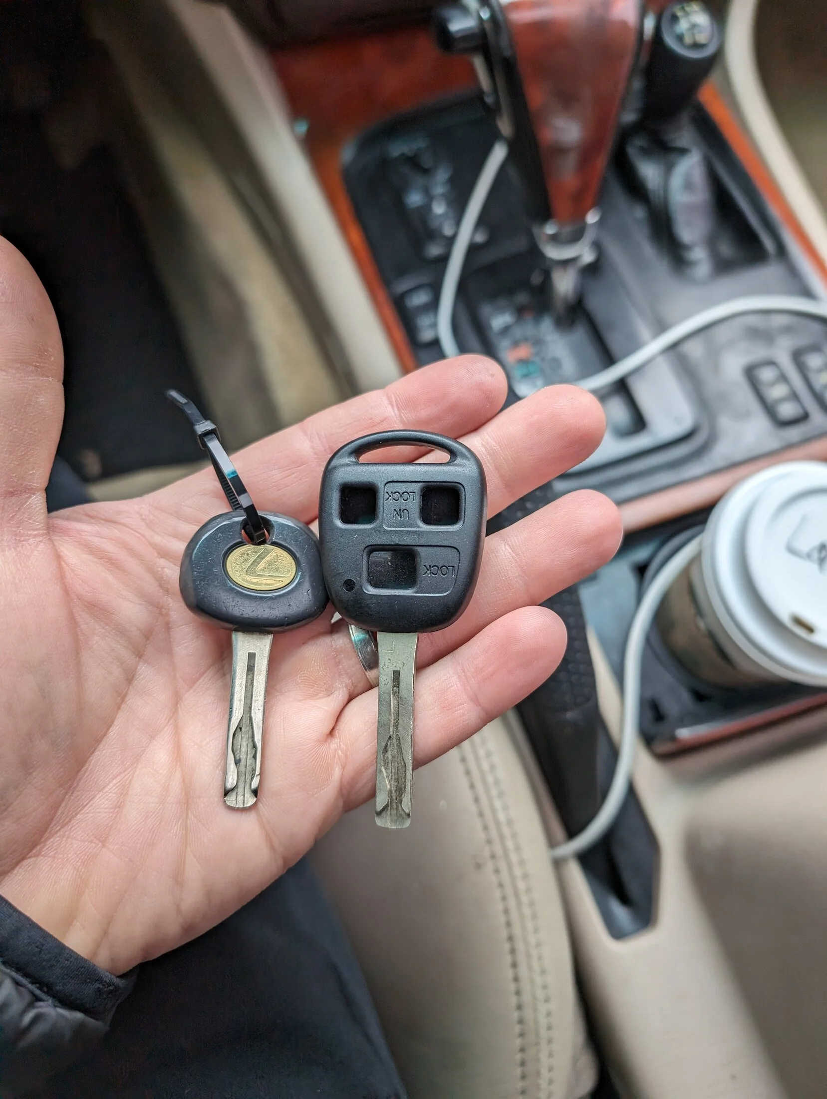

Hi all, just picked up an 01' LX.
Came with one and a half keys 🤣 one valet style key that starts the car and is the "main key", and the other key is the fob style...but it's just the blade, and empty shell. No fob internals. This just cranks the car, but no start.
Where do I start? It seems I'm going to need my ECU "virginized", but then, how do I add a new master and start from scratch?
So if security light goes off, without any blinking, one key increted into IG switch. Then that working key, is likely registered as master. If light blinks, it a slave. With master you can program more keys. Without, you'll need CPU flashed.
The blade with empty shell missing the door FOB, can't be used to start. The chip is in the FOB. So you'll need a FOB, to program and use that key in IG switch.
2001, first of all, I want to thank you for your help in the community. Instead of watching Netflix before bed, since I've brought this LX, I I spend evenings reading through your thoroughly detailed threads. My rig, at 250k miles, will likely need everything you've done how -to's on.
As far as the key pictured -- it's not a master. After inserting into ignition the security light remains in for about a second and a half before disappearing.
So I get that I need a virginized ecu, and a new fob setup...but then how do I program a new fob to the fresh ECU? Is it just to normal in car steps outlined in here?
FOB has 2 parts.
One part, is door FOB, which is a battery powered wireless (IIRC bluetooth) transmitter. I think you'll find how to program, in this thread. One way is through tech stream. The other is by a procedure of open and closing, switches, doors, ect. If not in this threads, search you find the how to. Also check my master thread.
The 2nd part of FOB, is imbedded immobilizer chip. It does not use or need FOBs battery.
Trick is, finding the proper FOB for your year. IIRC, there is 2 (possible 3) different frequency for both wireless door and immobilizer chip from 98-07 LX & LC.
I've only dealt with 03-07 LX. So you'll need to search for 01LC FOB info. Likely 98-02LC or LX the same. Possible 03-05 also.

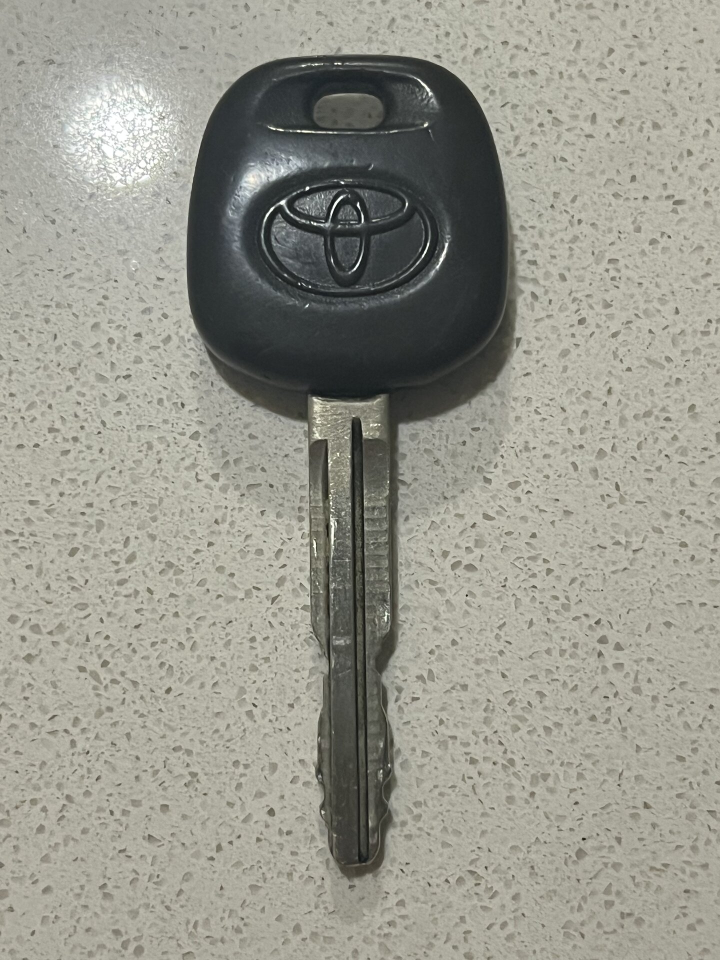

Looked thought the thread and have not found a solution for my issue yet. I have an LX470 2002.
I think I only have a valet key (only have 1 no fob key, but it does unlock everything including the glove box and starts the car). However, I have yet to see the security light at any point when in the car, outside the car, or putting the key in.
All I want to do is program another key in case I lose it. I do not even want a fob. Anyone know what might be up?
