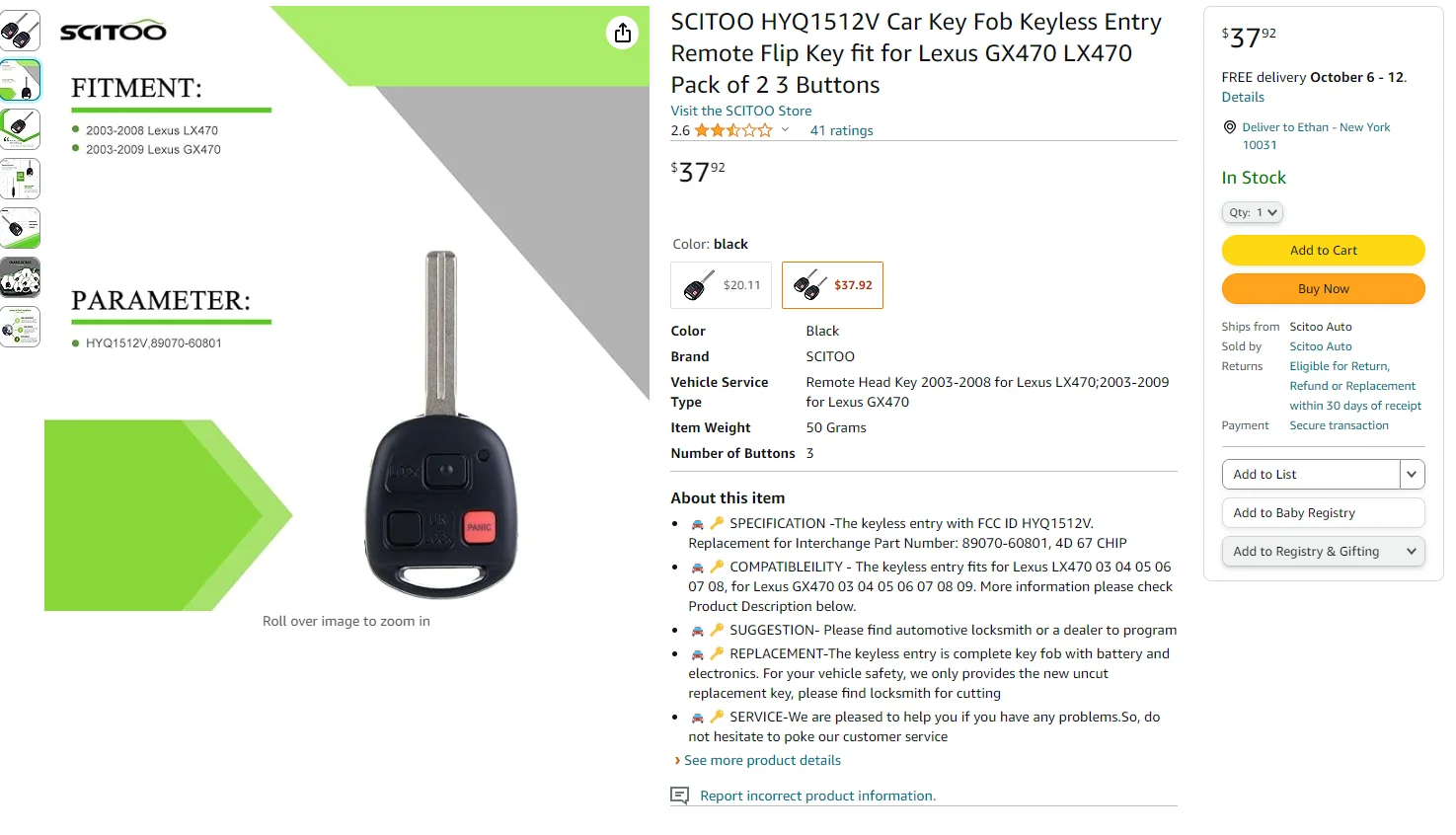

Hi All
@Mauser thanks for all the info you shared in this thread, very very informative.
I have a 98 LX470 in the Middle east region. I got a master key with the car (no buttons / FOB) its a plain single master key
from what i have read in this thread, i need a
HYQ1512V Long Blade with 4c chip to program​
i do have techstream which i will use for programming the transponder. i cant find the transponder code and hoping HYQ1512V will be the correct one. Fingers crossed on the Freq.
if anyone has done the 98 model please advise on the freq and FCCID
Thanks
Hi All
Thanks
That key should work. The 4C chip os for the immobilizer and the HYW1512V is the frequency for the wirless door locks.

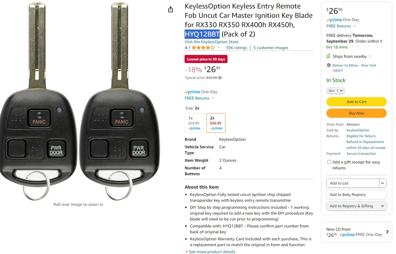

Thanks to @Mauser for this great thread. Using what I learned here, plus Techstream, I was finally able to program another Master Key for my 2007 LX.
The 2006 and 2007 model years use the code HYQ12BBT transmitter instead of the HYQ1512V transmitter. Being a Lexus it also needs the code 68 chip and not the 67 for Toyota, Getting this combination together proved challenging.
Being bullheaded, I first simply ordered a set of keys that Amazon said would work and had them cut. Those keys might be fine for a 98-05 LX, but will not work for the 06-07.
Amazon product ASIN B07D5S3FC9
Having already cut them, I tried to program the ECU and the Wireless Remote using both the instructions in this thread and Techstream, with only failure as my result.
Not wanting to pay $150 for a new key from Lexus, I decided to try another key listed on Amazon as having the correct parts, but being listed as for the RX350.
What I failed to notice what the different button placement for this key, with "PANIC" in the same position as "LOCK" and an additional button for "PWR DOOR". Checking Amazon and eBay again, there does not appear to be a perfect match for the key that I need.
Given that the key likely had the Lexus chip for the transponder, I decided to swap over the parts to my previously cut keys and see if I could get anywhere.
Initial results in Techstream were positive, I was able to quickly register the key to work and start the car. Success! I decided having a spare "dummy" key was better than nothing.
Moving on to the Body ECU and trying to register the wireless remote was less successful. After two attempts that resulted in FAILURE messages, I decided to quit. However, after starting the car and testing the key, I instinctively used the fob to try to lock the car after I had wrapped up. To my surprise, the wireless remote works mostly as expected. The "PWR DOOR" button causes a beep, but appears to have no other effect.
So for anyone looking for keys for a 2006 or 2007 LX470 that does not care about the "PANIC" button, I'd suggest trying out the second set of keys above.

Dude, I have an 06 LX and the link I pasted earlier in this thread the key works for me (for everything).

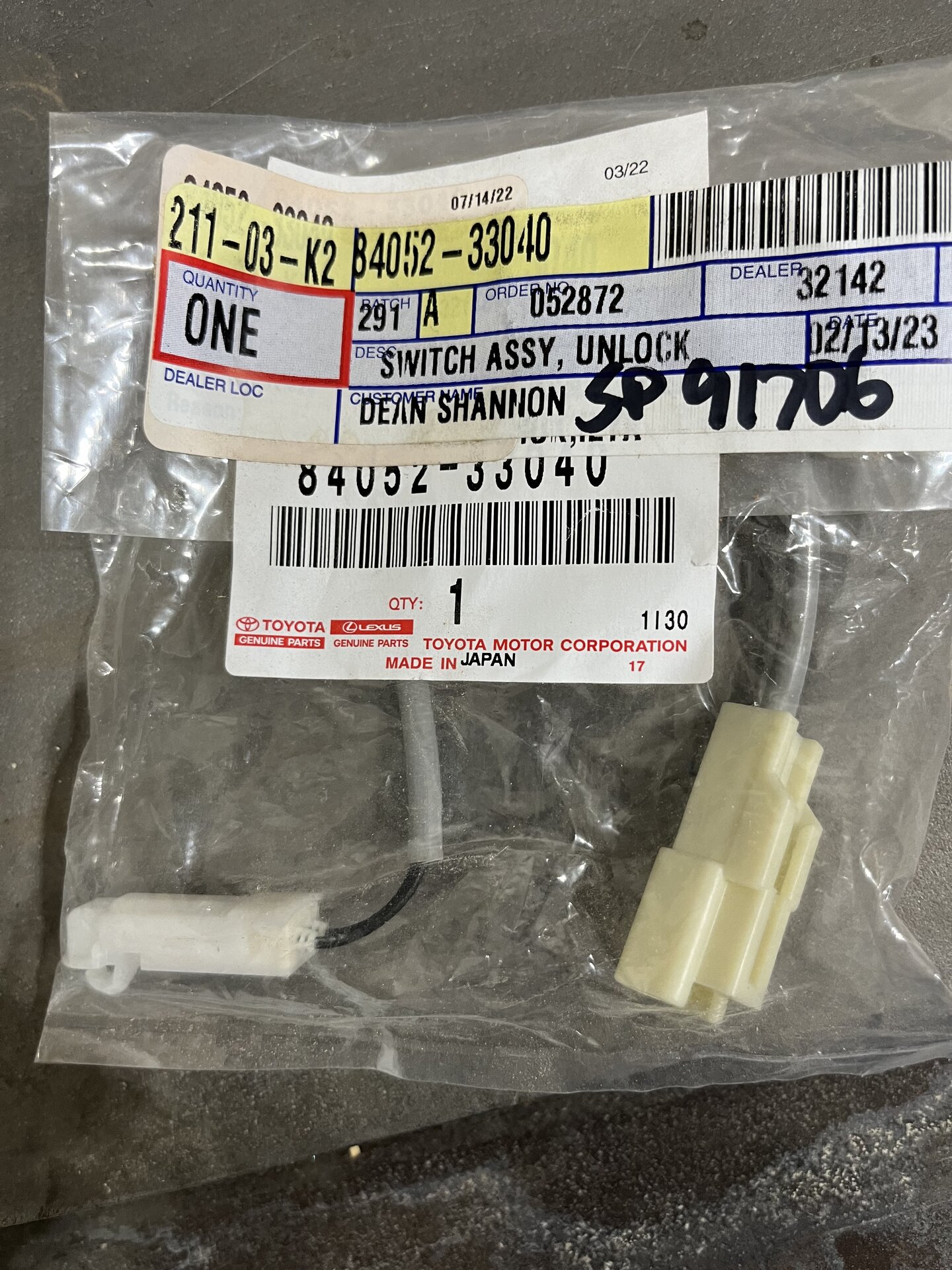

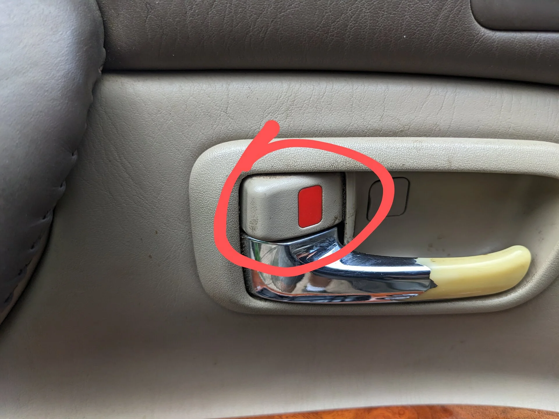

I was unable to program the fob on my ‘98 LC for close to 20 years. It ended up being a bad unlock warning switch assembly on the ignition. I was able to jump the harness and finally program my fobs. I ordered the part for $20 or so, but haven‘t installed it yet. 84052-33040
Have you by any chance measured the voltage of the (ksw) key unlock warning switch circuit?
I have been diagnosing an issue with my immobilizer circuit which ties into the KSW circuit. The workshop manual shows both 10-14 volts as well as 3-5 volts, I am measuring 3.6 volts. Clearly there is a misprint but which is right has yet to be determined since I haven't resolved the issue.
Cheers
