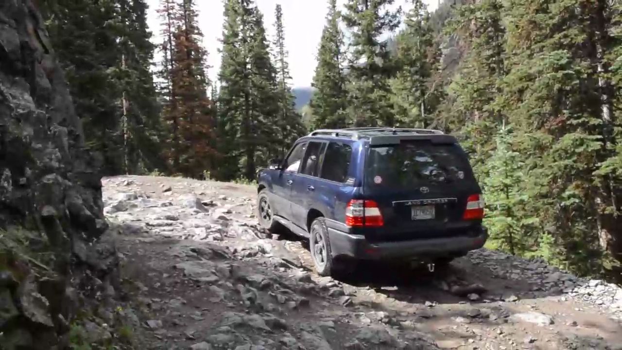

Exactly. Trying to figure out how to prevent that from happening again. Leo was able to walk right up the same trails I slipped on and his 80 was fairly stock triple locked.

Yeah, I know there are people that love to ride their wagons on the rocks but I'd save that $2000 and not go on trails like that.
I've managed to log a thousand or so miles off road in my 100 and have only a rear locker.
I know this isn't an option but for those looking at getting a 100 series I'd choose ATRAC over one locker though. It's pretty awesome.
Somebody said it earlier... apples and oranges. I have been genuinely shocked at what a triple locked 80 with a little lift and some tires can do in the hands of a capable driver but they don't hold a candle to what the 100 can boast as its strengths. If you want to cruise at 80mph, not fret over hills, tow a trailer, etc the 100 is a better bet. Not much you can do to an 80 to make it behave like a 100 or vice versa.
