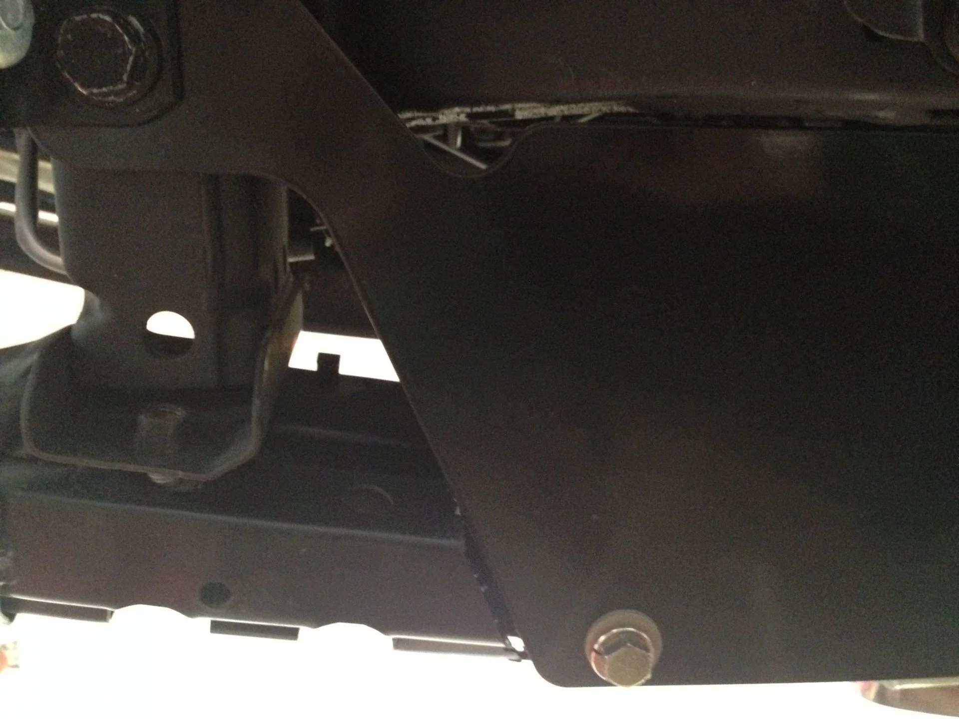

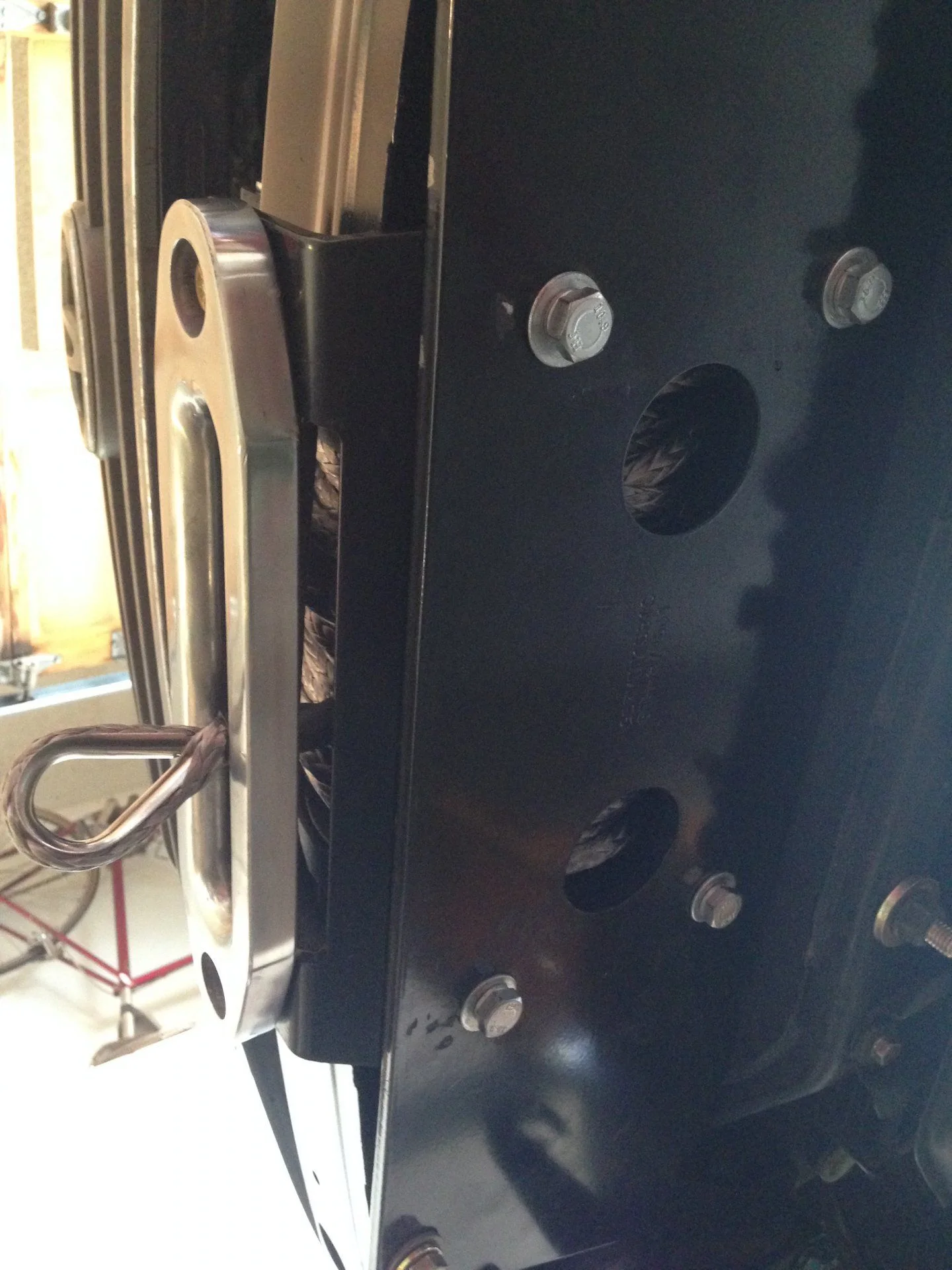

I bought this TJM winch plate from Summit Racing: https://www.summitracing.com/parts/tjm-957mtt1581c then modified the bumper support to fit around the mounted plate and winch. The winch plate is sturdy as hell, very thick steel, and bolts right up to the existing frame rails.
This was totally a DIY effort. The front bolts on the bottom of the plate go up through the bumper support to tie everything together. I may weld the winch plate and bumper support together at some point. It took some custom fabrication and a lot of trial and error to get the bumper support to fit correctly. If you're not willing to hack away at your bumper support, having someone custom fabricate something would probably be a better way to go.

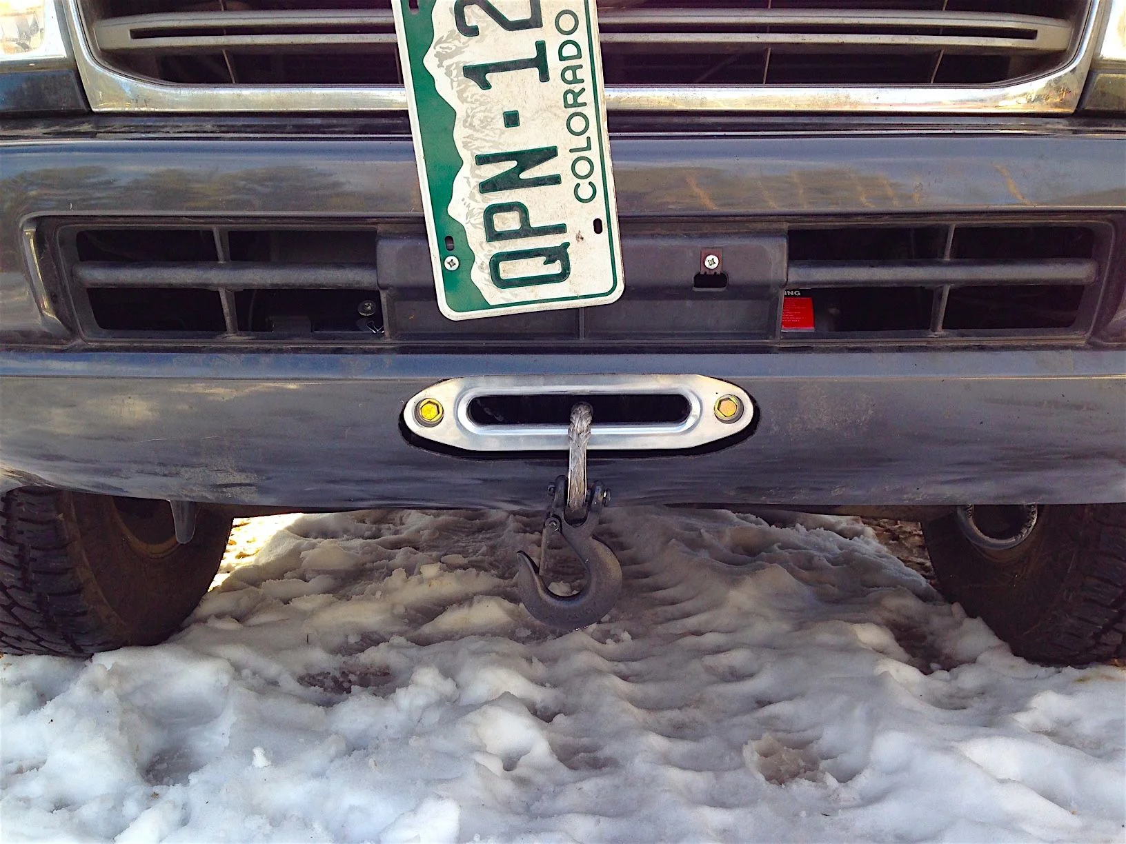

A flip up license plate holder covers the fairlead.

How much cutting did you have to do? Can you elaborate on where the bumper support is? I'll need to take measurements and pictures to get an idea of where I'm going with this.
The bumper support is the black steel piece that spans the width of the truck under the plastic bumper "cover". You can see it in the first pic. I basically had to cut out the width of the winch plate to a depth that would accommodate the winch. I wanted to leave as much as I could to structurally fasten the support to the winch plate using the supplied bolts. It's best to remove the plastic bumper first to get your measurements and wrap your head around what you're dealing with. It's about a 10 min job to pull it off.

I'll take some measurements of the cuts tomorrow. I'd love to hear some opinions on the structural integrity of what I've done. I know I've weakened the bumper support but I think I've more than made up for it with the winch plate and winch. I've bashed into some pretty serious stuff and it hasn't even flinched.

@bamabrock If the 12k winch has standard mounting holes it should mount up to the TJM winch plate just fine. The limiting factor will be the width between the frame rails and the depth out to the bumper support. I would measure that space and compare to the dimensions of the winch before cutting.

Hey Steve, I can't tell what model smitty you got in there. It also looks like you just had to do a little bit of trimming on top of the bumper support. I don't see trimming anywhere else and it appears that the rest is bolt on using factory holes and bolts.
