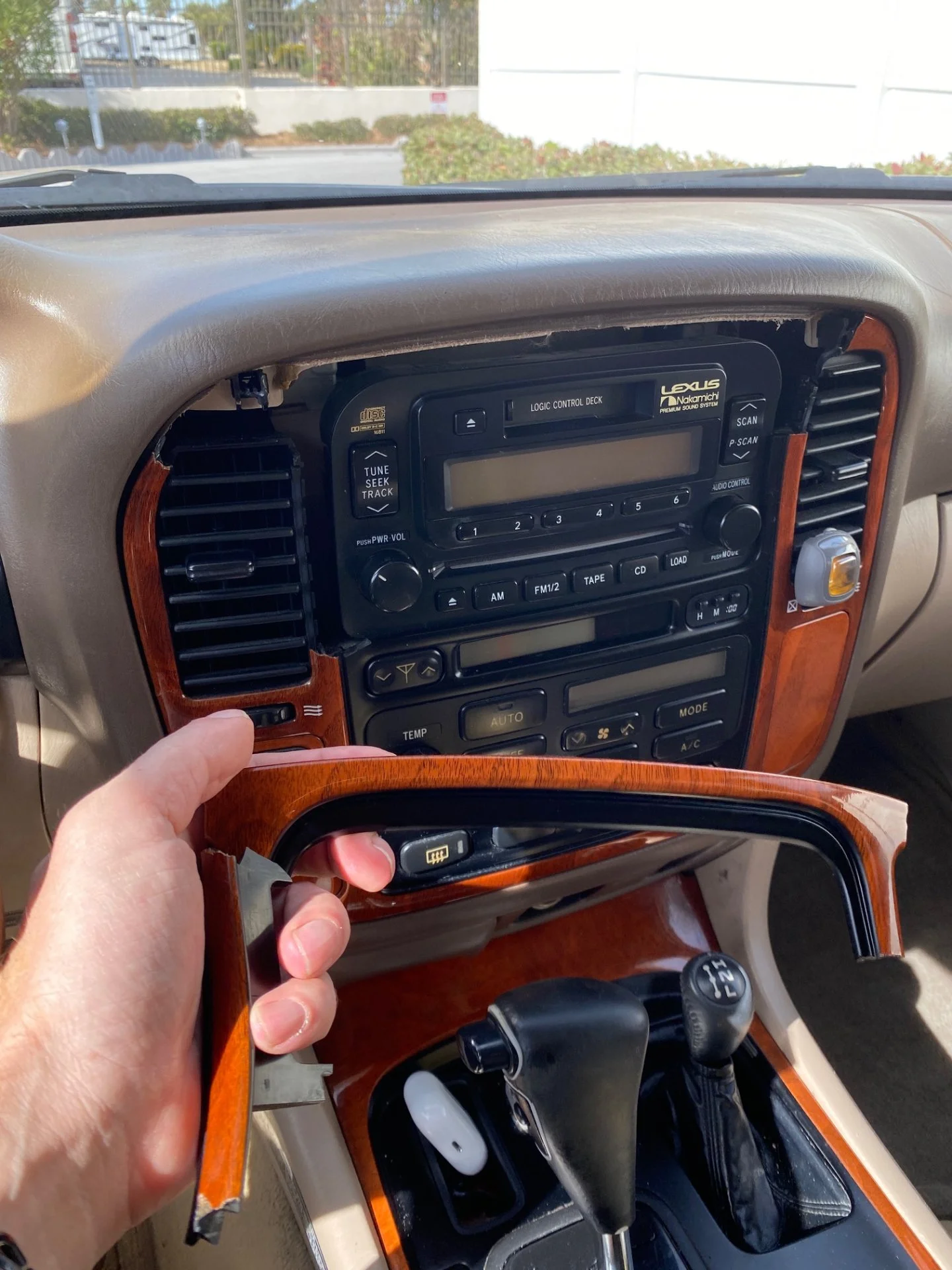

Any way you would consider printing an entire radio trim bezel that would include your double din gap modification? I have a small dry rot issue with some plastic parts on my neglected LX as well when I attempted a radio and amp bypass installation. Haha
Little Krazy glue and some patience could mend that up
I love your optimism, Mike. 🤣 Patience. I have a new dash coming since the entire thing is sun-damaged and dry rotted. I am certainly going to invent some new curse words during the installation process. I was going to leave it stock but I have this nagging little feeling this is when the iPad and Ham and fiberglass nightmare might begin. Not sure the route at this moment but given that along with that above awesome event the off button and fan speed buttons have decided to give up the ghost as well. Might be time to rethink the entire game plan. Maybe Will @CruiserDM would like to 3D print me all kinds of craziness and we have a weird Hunter S. Thompson type time in Vegas for SEMA making him a rich man when they see his awesome work and my ridiculous dash.

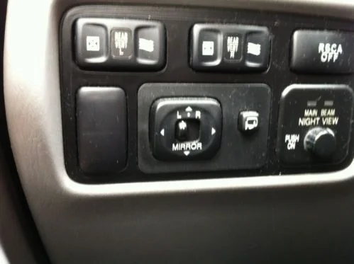

Also, any way to do a 12v outlet for the emp spot left of the steering wheel/right of the motor controls, where the night vision would go? (Not my photo, found it on the internet)
I’m not sure if there are 12V barrel ports available on the market, but I will say there are definitely 12V USB ports available to fit that standard toyota switch size. Check this out for example
Amazon product ASIN B07QH653SQ
Be aware there is a “tall” and a “short” toyota switch size that is common to most of their models though. I have old “tall” switches from a 2020 Tacoma I had that fit my 98 LX470
If you mean the square night vision controls then I’m sure I could fab something up.
I have a blank plate there, but I just don’t trust it to hold up to the stresses of 12v chargers/cords being plugged in and pulled out. I’d like a beefier one with moldings to fit a specific 12 socket( maybe included). I’d pay the price for one that was well done.

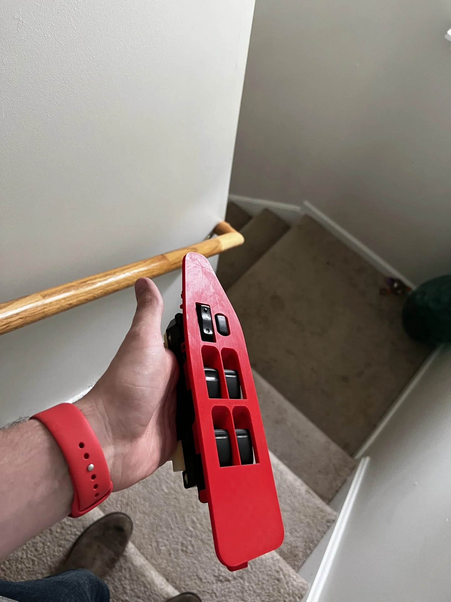

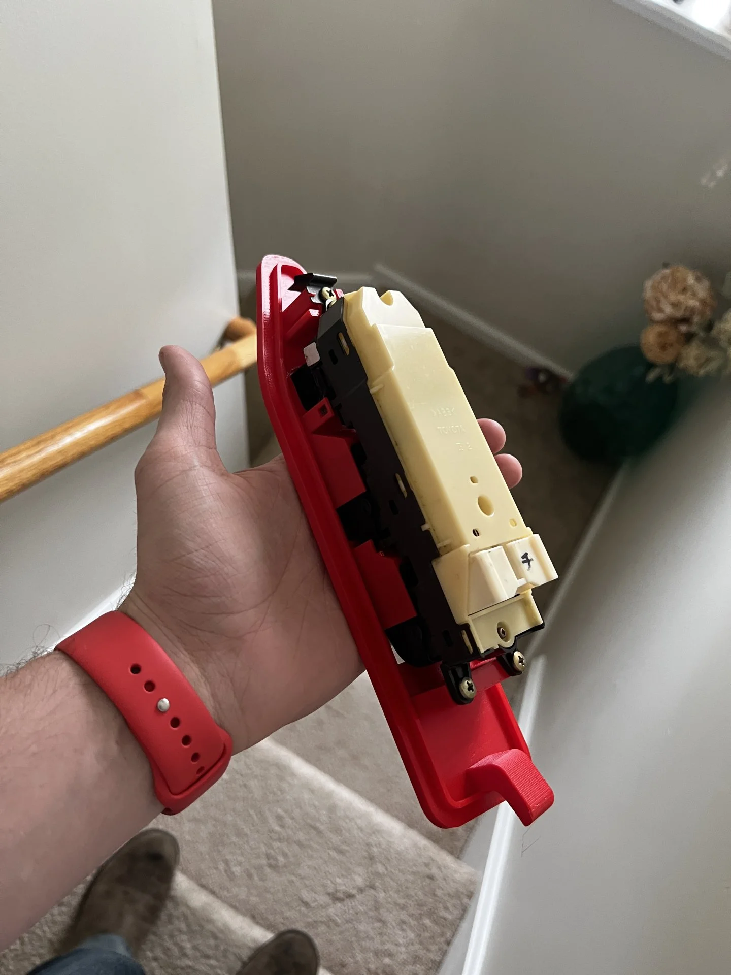

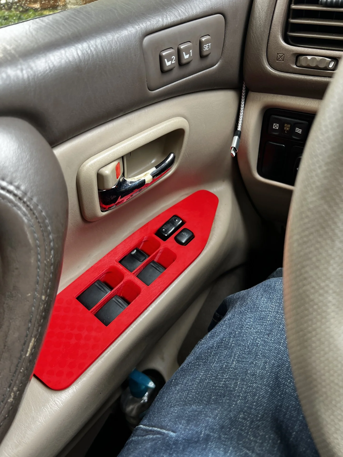

I believe I’m on the next-to-last revision of the driver side switch panel for the 1998-2002 LX/LC’s (replaces 84820-60010). Just a few issues that I’m still sorting out, check out the latest pics below
  • Snap-Fit Tabs are a bit too flimsy, need to beef them up a little as you can see one broken on the first pic
  • Need to add beauty fillet's/curves to the edges to match OEM
  • Window-lock button not centered in it's slot
  • Could be just a tad tighter in the door
  • Changing texture from smooth to slightly textured (think smooth powder coat texture)
Otherwise I'm hoping to re-print tonight to finalize and have (pre-)orders live tomorrow evening. I have a backlog currently of just under 2 weeks so these would start shipping out then.
03-07 Master Door Switch (replaces 74232-60321) will go live tomorrow evening too and I'll just iron out the slight fitment change between the two over the weekend (Bought a later model master switch off of amazon to take measurements)
Passenger side panels for both appear to be identical.
Cannot. Freaking. Wait! Nice work!
