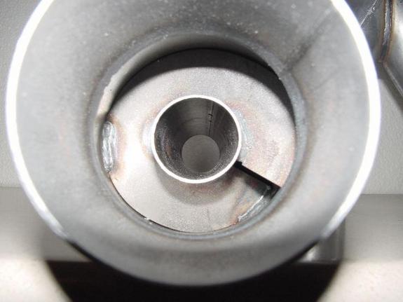

That is a mechanical baffle type glass pack. It should in theory be pretty beneficial.
nother inside pic of it.

Hey Bak,
I'm guessing you guys tried a handful of resonators before deciding to go with the one you include.. which one is it?
Would you recommend I get the same one?
I'm hoping I can source it in town!
Ohh, that means I will start looking :)
I wonder if it's the same as the 80 series EMS Resonator?
https://forum.ih8mud.com/80-series-...iral-flow-muffler-installation-resonator.html
It would be real nice if someone with an EMS System + EMS Resonator chimed in!
Meanwhile... I'll go measure the room in the final tailpipe section and go call around.
Thanks Les!
The way it is tacked on looks the same both systems. I'm betting it's the same. The Moroso will fit in the last section, at least by the measurements it will.
