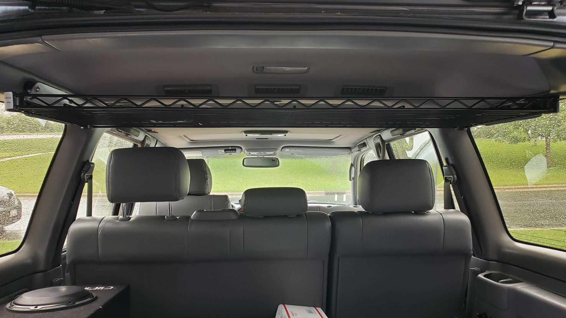

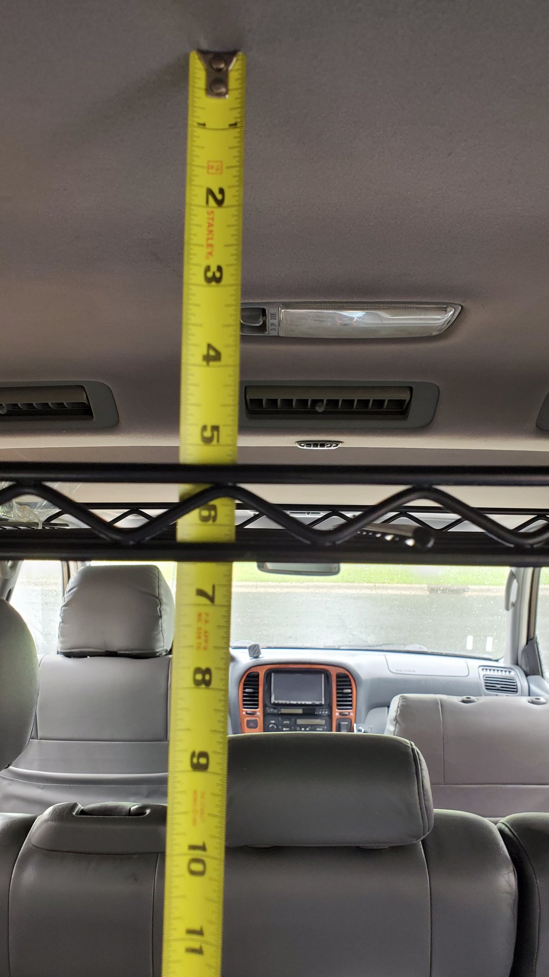

Ok I’m ready for T&E!!!! The top of the rack shelf is 5” from from the headliner as measured from the bottom of the rear cargo light. The rack is 17mm from perfectly centered due to the shape of the rear headliner with the rear AC unit. The top corner sits 3mm from contacting the headliner so it’s as high and tight I think it can be.

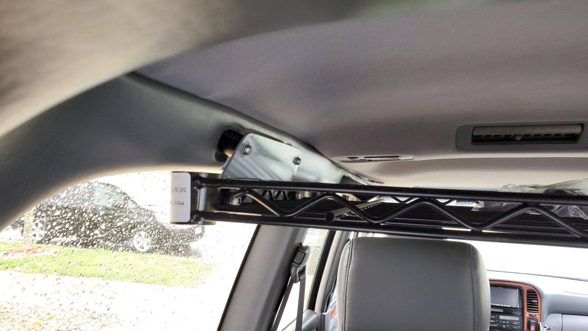

Im pretty excited about the rack also being easily removable with only 2 sets of screws and nuts due to custom machined hardware. Once the brackets are bolted into the handle locations that is. This also has custom machined standoffs just as a nice touch.
If this sounds good please PM me with an address and I’ll send out two preproduction T&E prototypes for free for feed back. First two ppl in lower 48.
