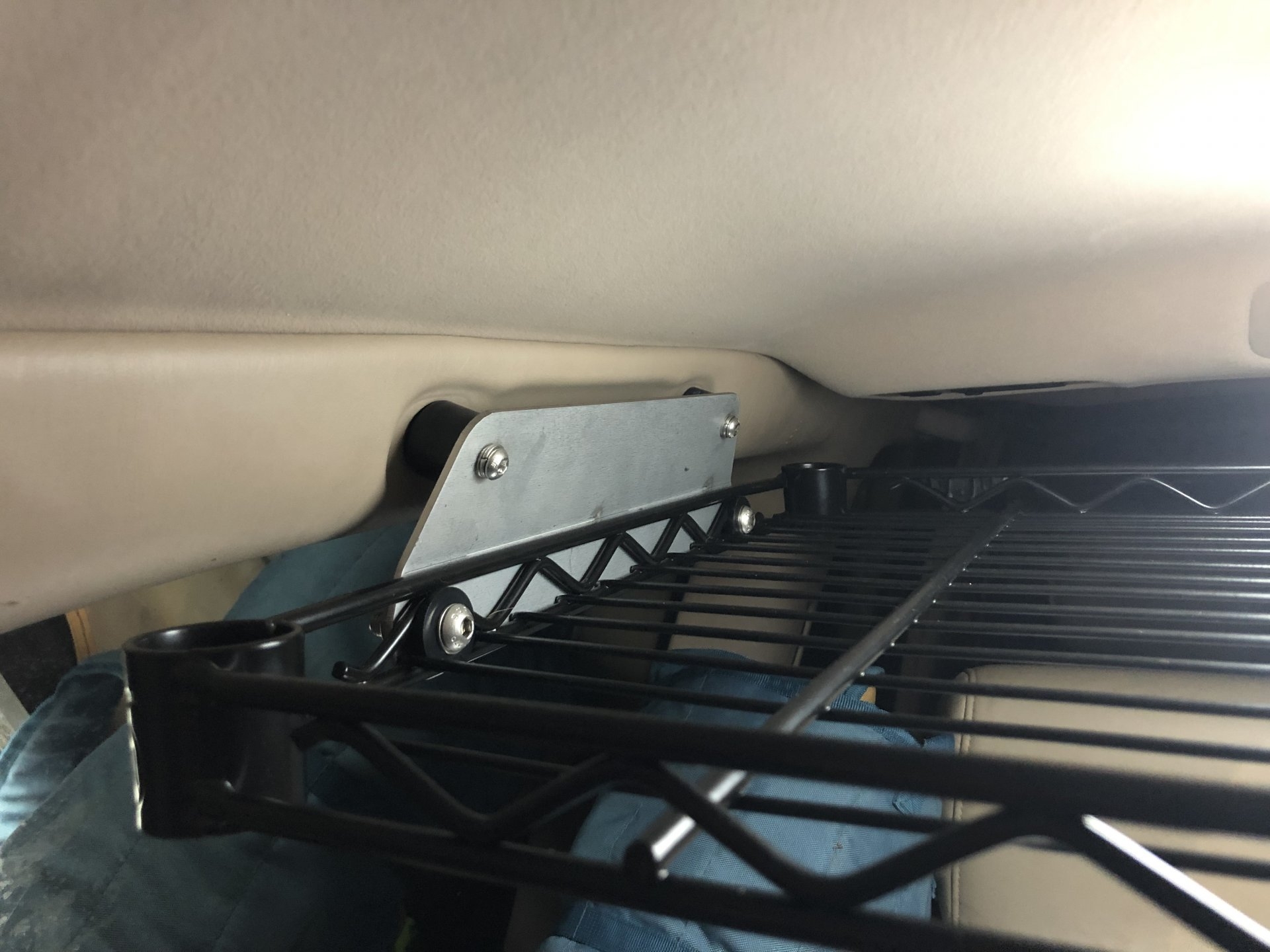

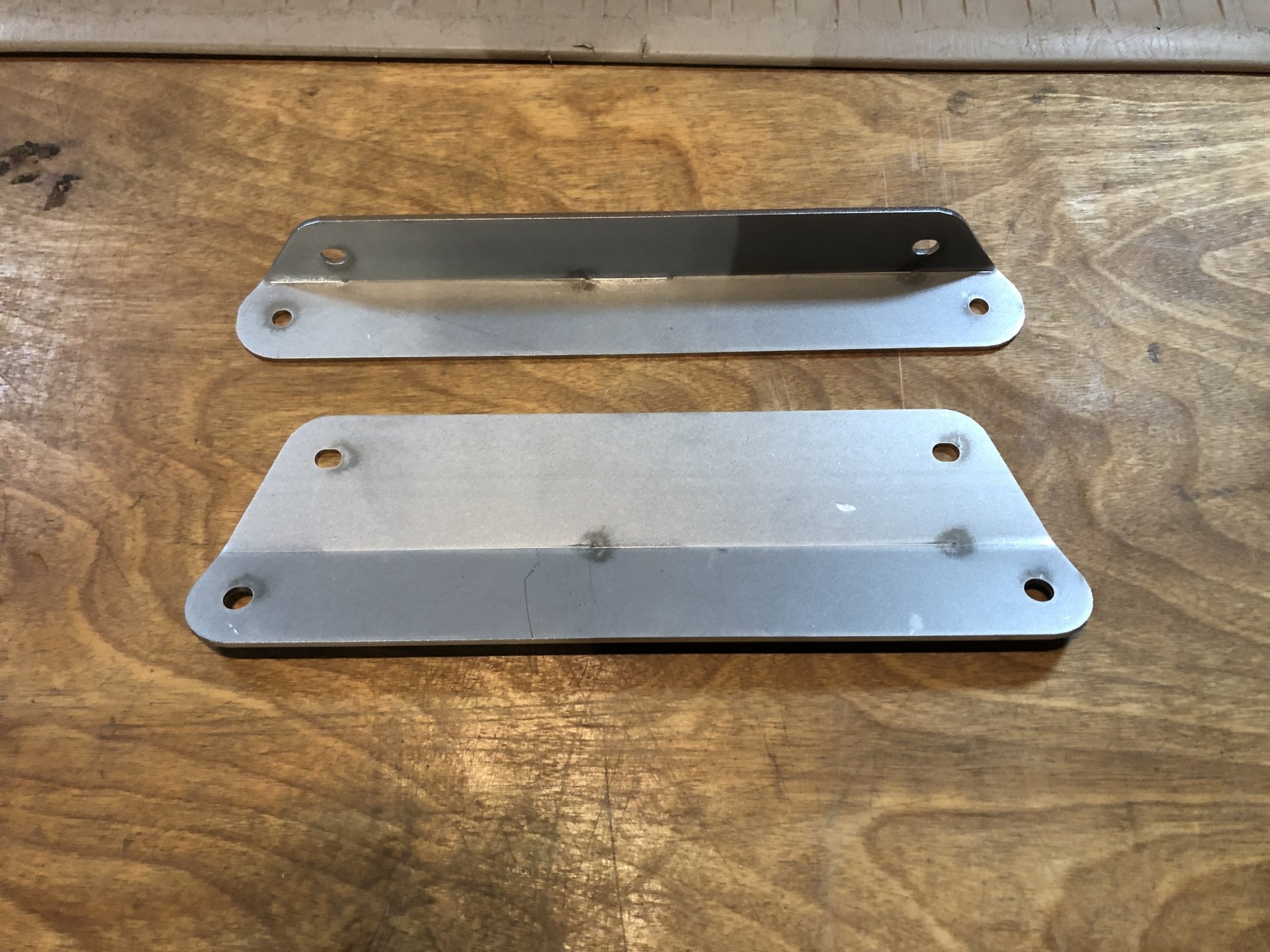

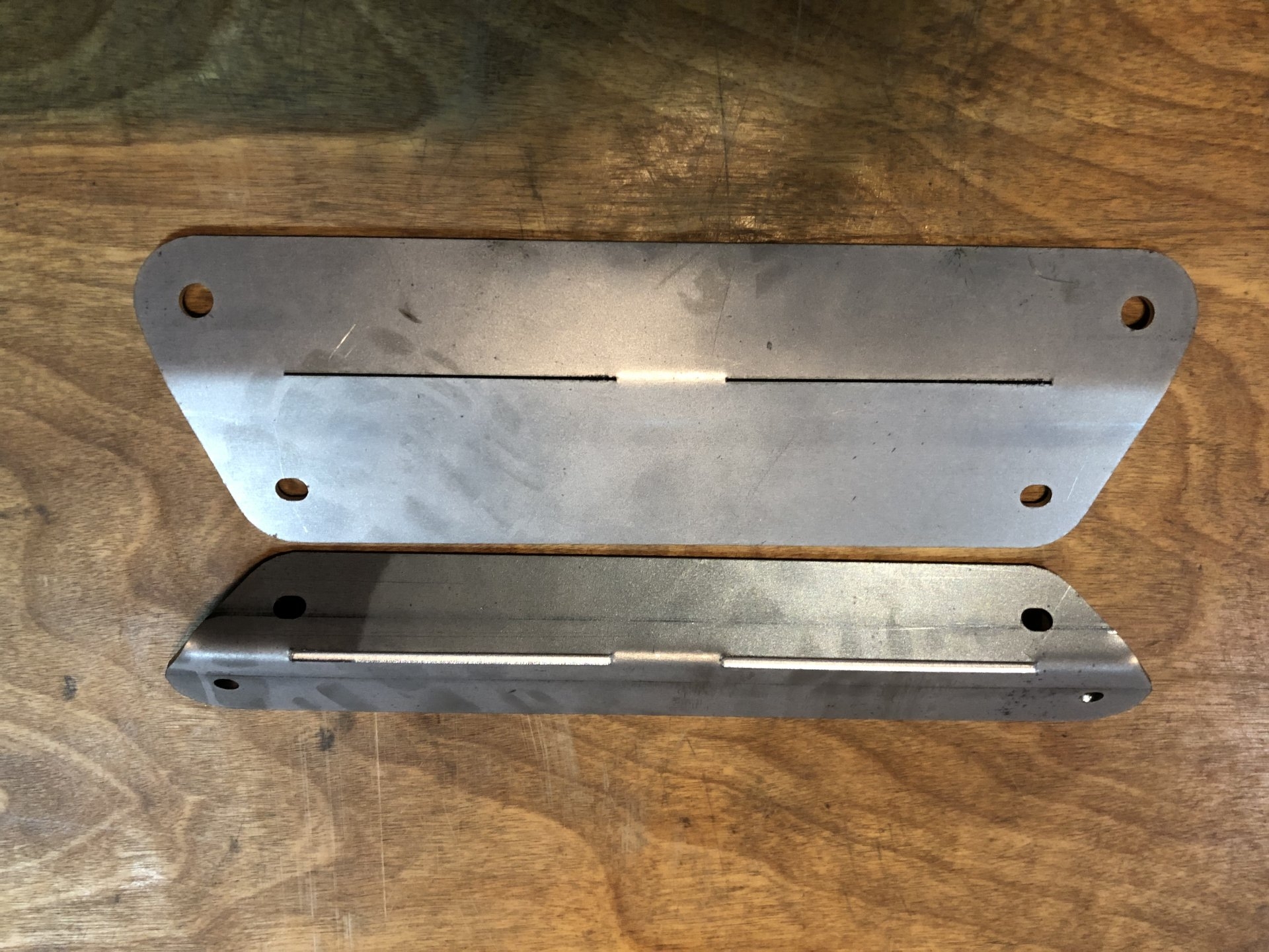

Friggin lasers!!!! I picked up the sample today and test fit it as soon as I could. This sample has a few reference lines that production models won’t have. This laser was half the size of my house and I was geeking out watching it work. Just incredible! Minor issues were noticed with the way sketch up interrupts circles resulting in a faceted cut rather than a true circle. It’s interesting that the software can’t make a true circle but hey, that’s part of the learning curve!

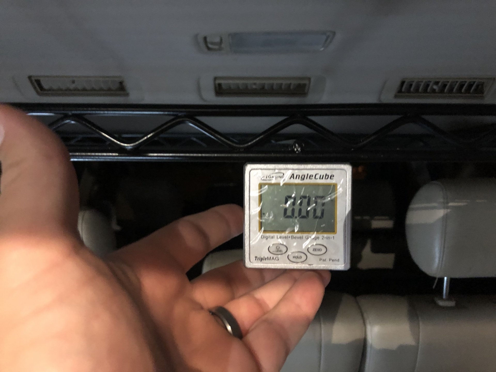

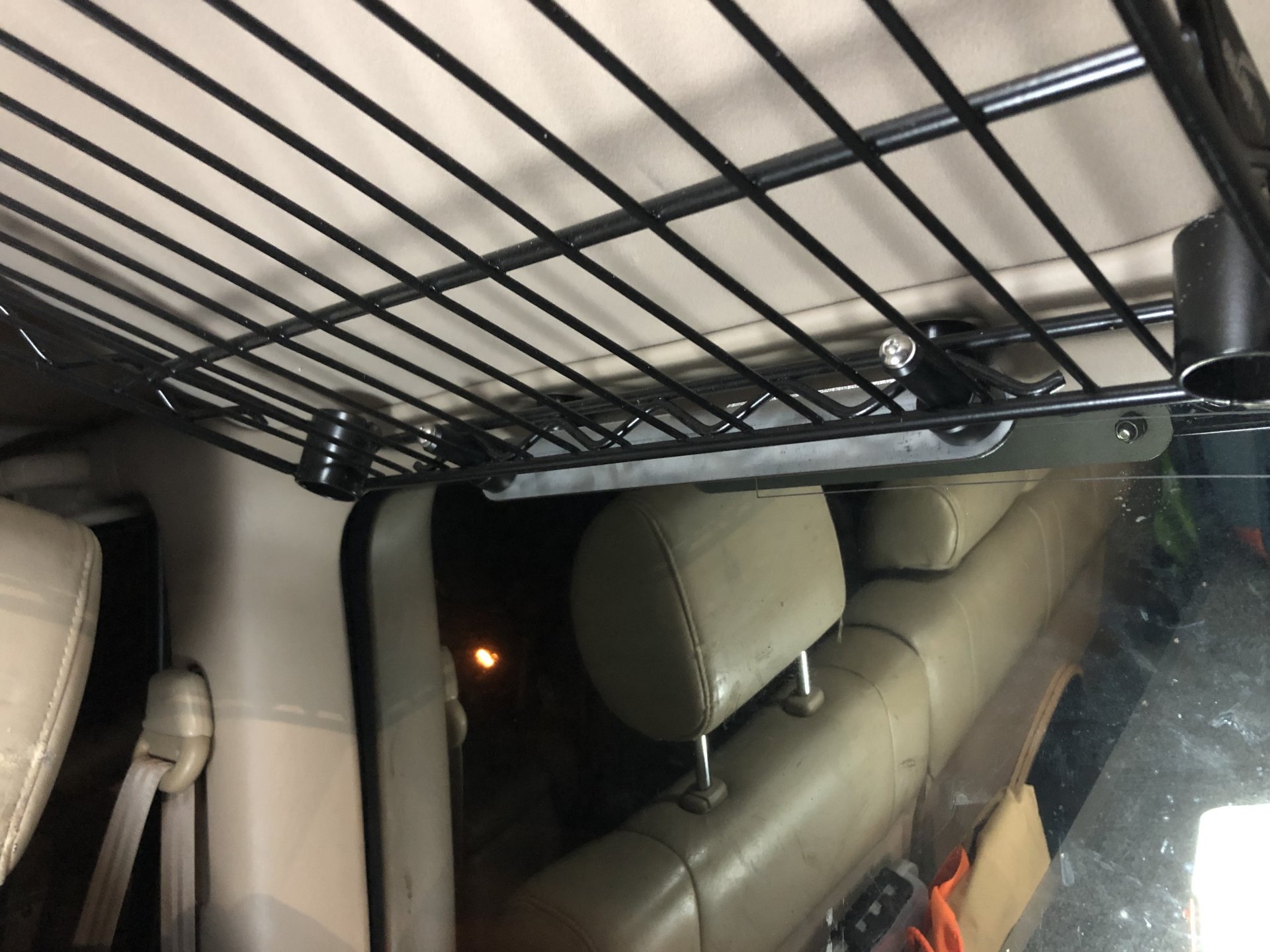

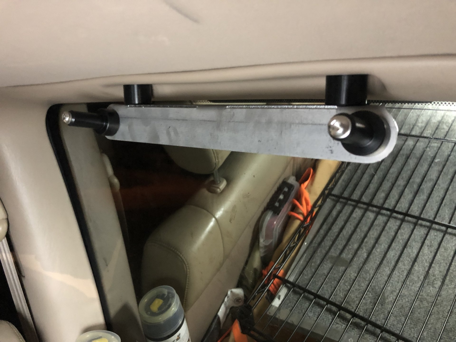

Yeah my tailgate is actually that dirty. Its wiped with Lysol wipes I promise. From cooking to chainsaw repairs my girl gets used! Install went perfectly smooth. The slightly oversized mounting pegs seem to work great! They are 1-2 thousandths larger than made previously and I think there are good to go! My last rack/bracket set has a bit over 3200 miles of testing (just me) and all fasteners were only hand tight and no rattles or issues. Rack also mounted up perfectly level without any adjustments.
So I need to rack up a few test miles but otherwise we are a go! A set was already scrapped for learning the CNC bending program and 16!!!!!! other sets are likely going to be scrapped due to the faceted cuts of the corner radius. We’ll see what can be done though.
