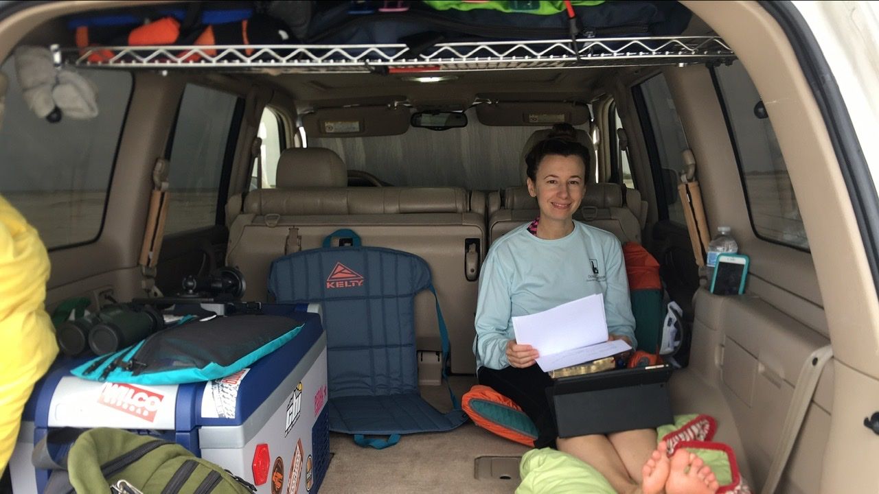

I wanted to possibly turn the threads around but there is a higher risk of cutting some of the stuff I store up there.
We put a long type zippered bag with all the bits I use to keep the ARB awning secure on the sands when we go to the beach. Our stand up changing room
which stays folded up and in a zippered bag. I have a nice battery/storage job pox thing that zips into a heavy duty case so it sits up there.

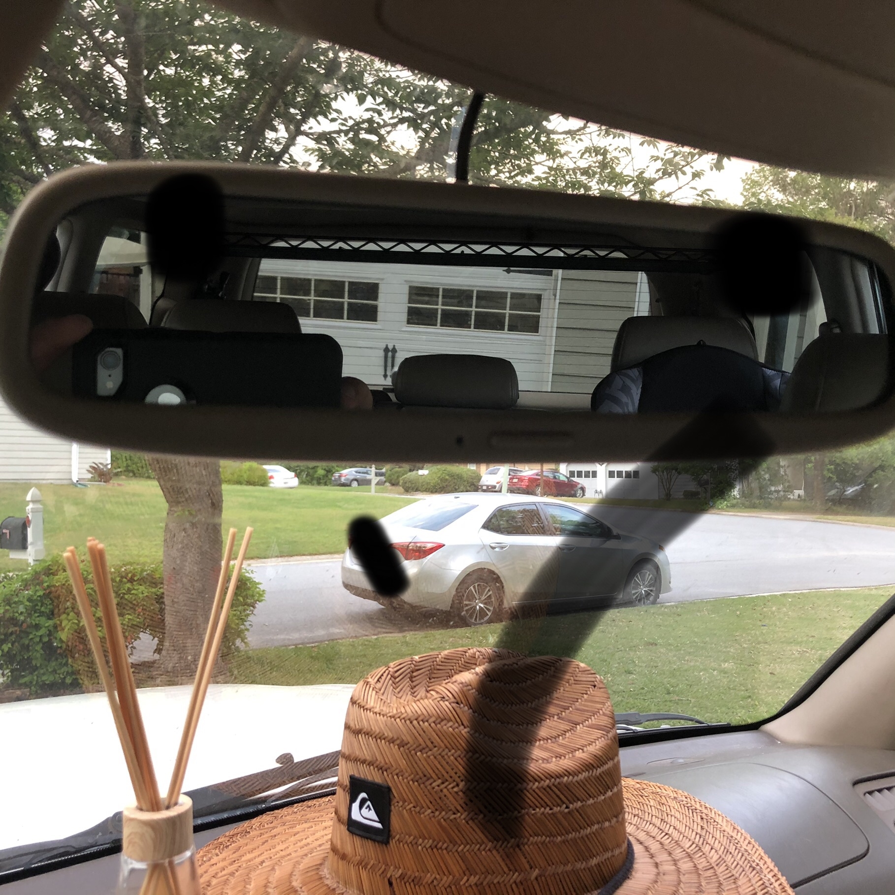

The shelf turned upside down creates a great shelf.
I am headed to ACE today to find some small spacers to bring the drivers side down just a bit to level it up. "OCD/ADHD"

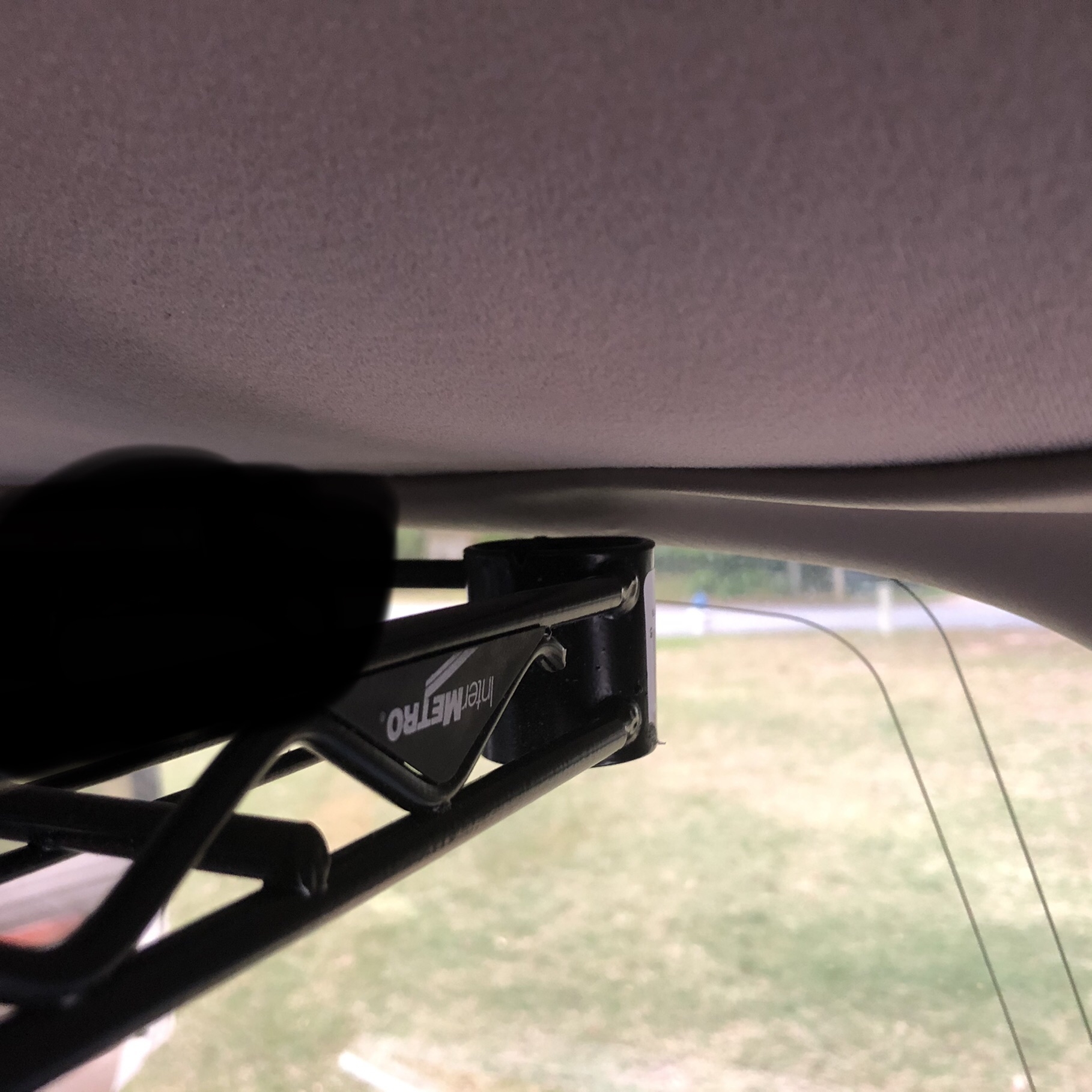

Can you put up a pic showing the close up of your u-bolts and such.
Sure, I'll try to snag some this evening. As you can see in the pic above I flipped the passenger ones outboard just to keep from tearing stuff up.

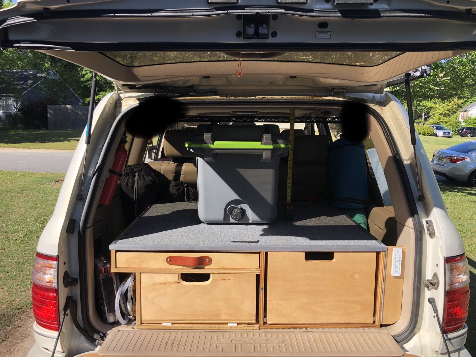

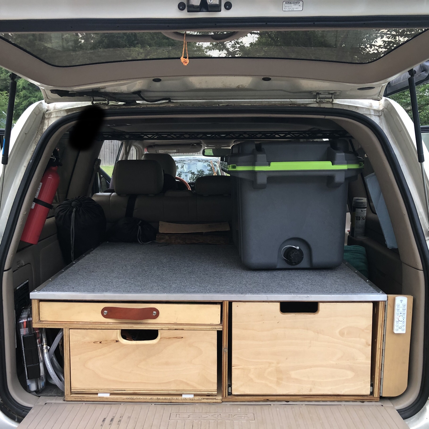

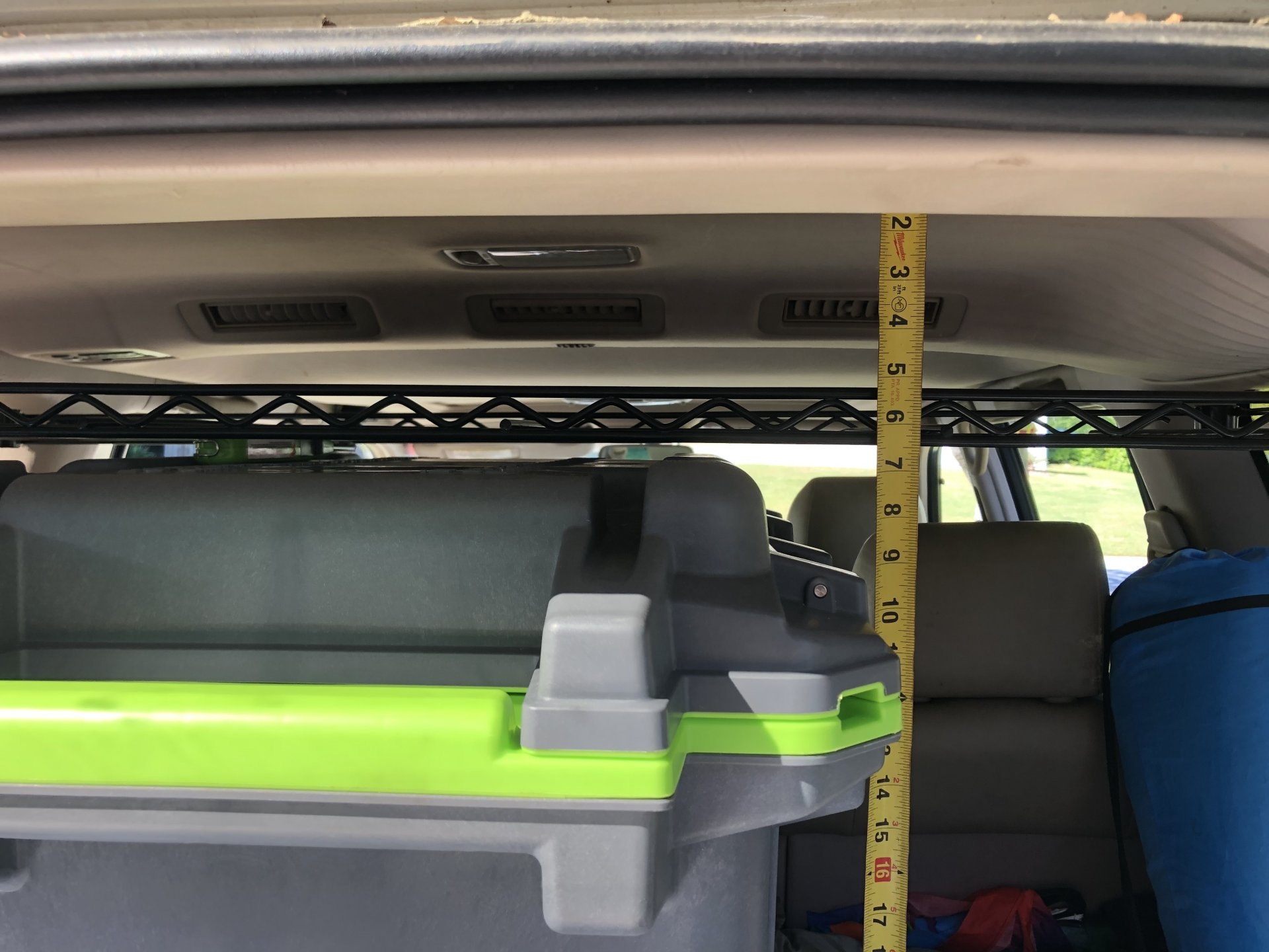

I’m working on a set of height adjustable brackets. What height do you guys/gals run these at? So far the prototype has a height of 5 3/4 - 7 3/4” from the headliner to the top of the bottom shelf. I’m leaning towards 5 1/2 - 6 1/2” as I think most ppl want to run these up pretty tight to the roof.
Set to 6 1/4” for reference with drawers 14 1/2” tall and a 20” tall cooler.
(Edit: drawers not finished. Lol)

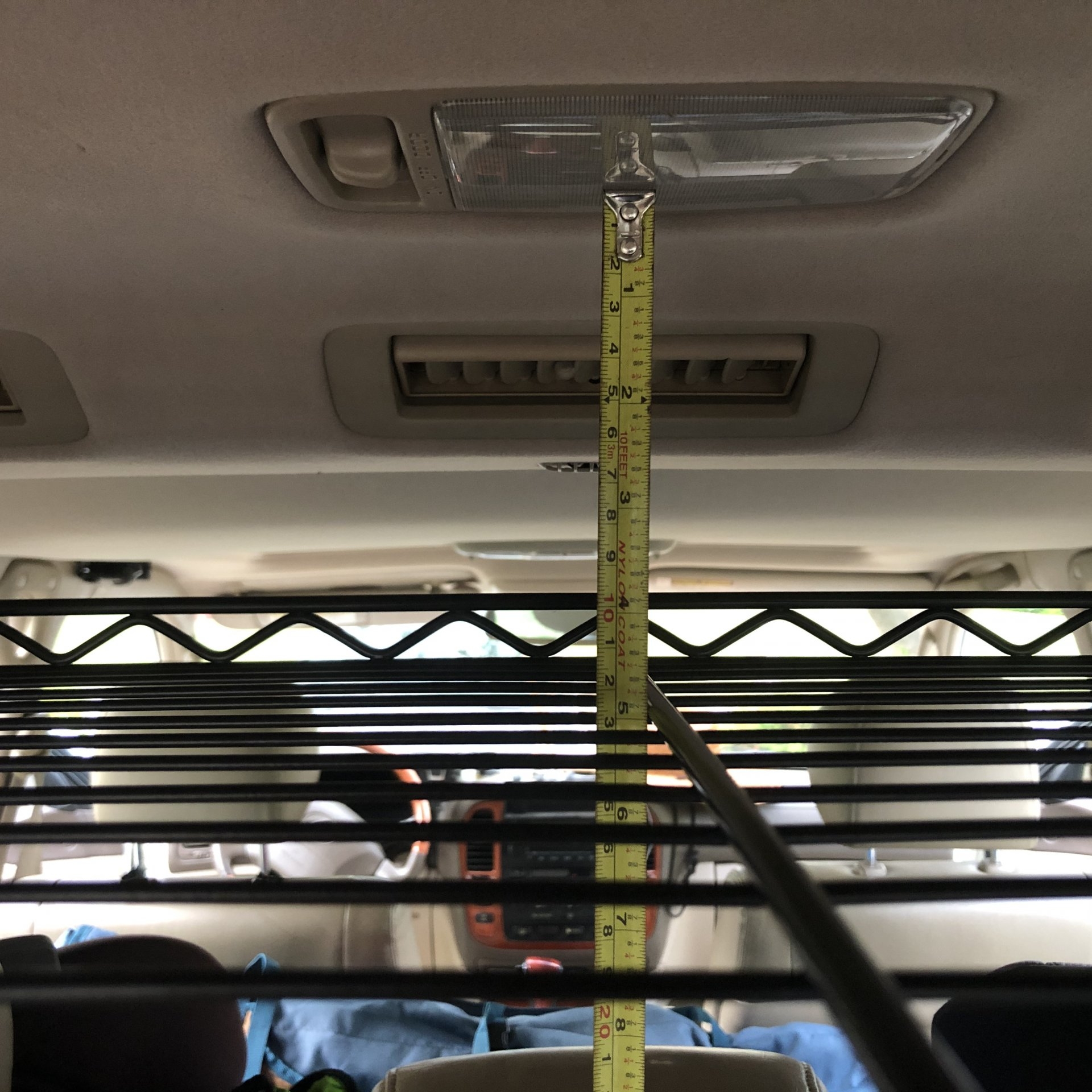

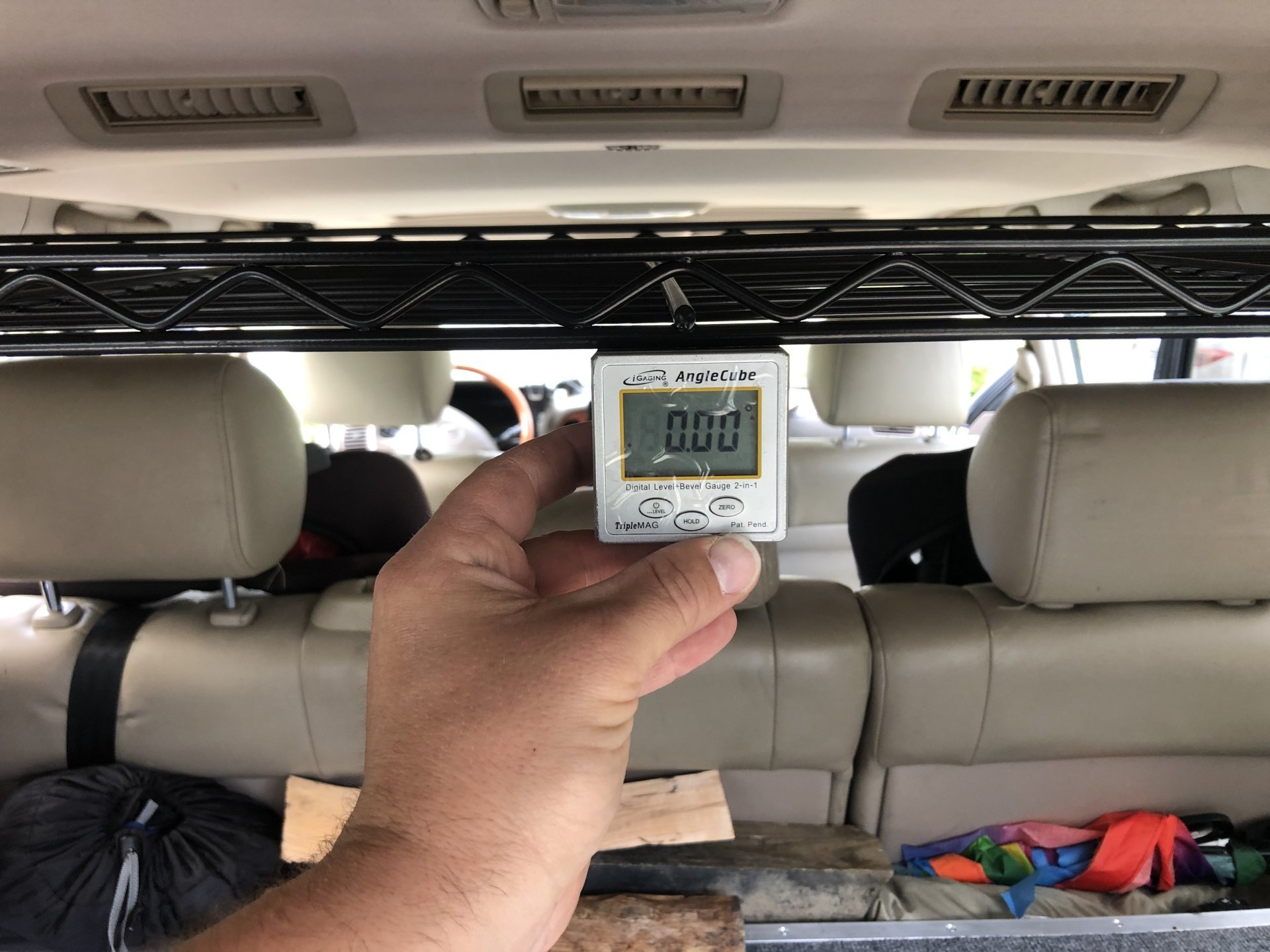

Ok I’m ready for T&E!!!! The top of the rack shelf is 5” from from the headliner as measured from the bottom of the rear cargo light. The rack is 17mm from perfectly centered due to the shape of the rear headliner with the rear AC unit. The top corner sits 3mm from contacting the headliner so it’s as high and tight I think it can be.
Im pretty excited about the rack also being easily removable with only 2 sets of screws and nuts due to custom machined hardware. Once the brackets are bolted into the handle locations that is. This also has custom machined standoffs just as a nice touch.
