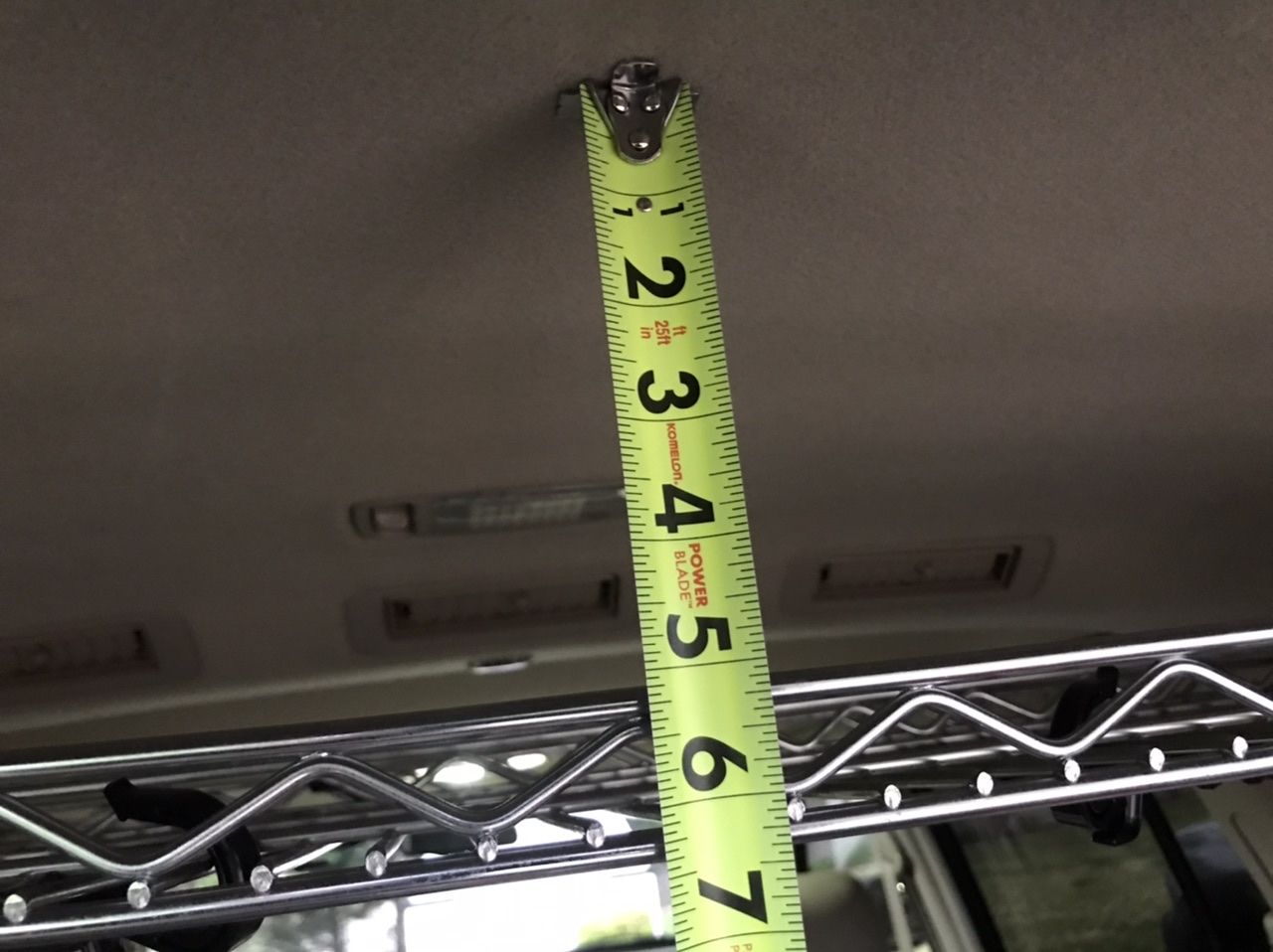

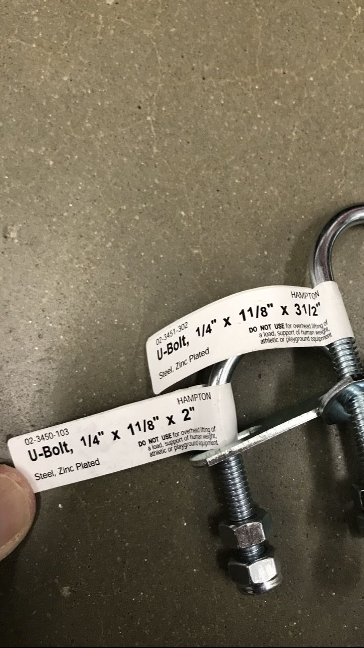

Well I actually put it in last weekend and ended up using some u-bolts from Ace...
Two per side. It's not exactly level but I can live with it for now. lol... I will probably add some spacer washers to bring the drivers side down a bit to level it out.
Also I want to get some of those little rubber covers to put over the exposed threads. I don't want to cut any of my softer things that will be crammed up there.

This may help someone also.
The only thing I would add is some type of washers or spacers to bring the driver side down maybe a quarter of an inch and that’s really it, oh don’t forget the little nipple cover things for the threads.

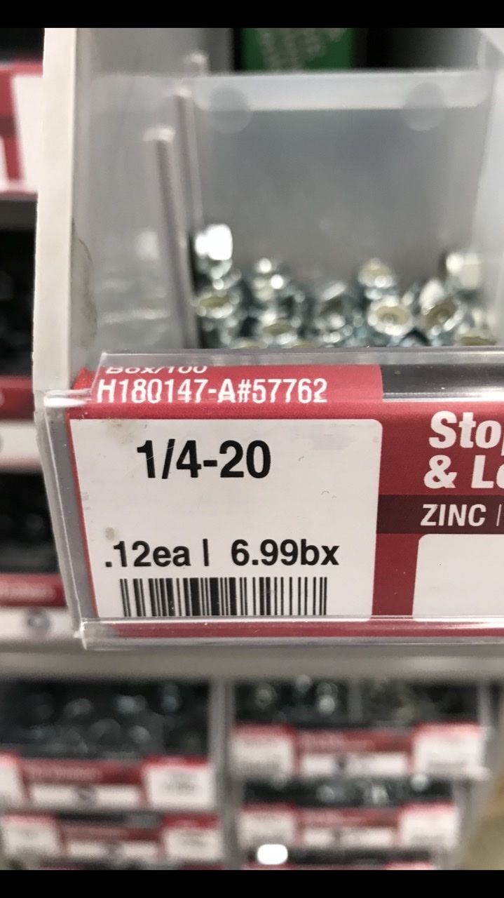

and I bought the nylon locknuts which are a pain in the butt to thread on that amount of distance but it was worth it.
