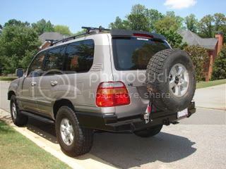

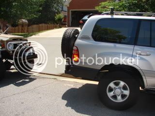

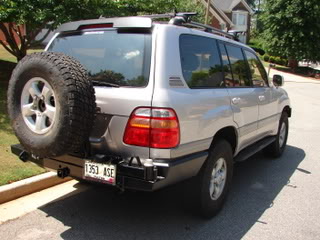

Done! For now at least.
Put the rear slee on today.
And the mini-stable
Only issue I have to work through is there are two of the captured bolts on the bottom front frame that are shot... one is stripped, and one the bolt broke off. :doh:
They are (or should be) attaching both the front bumper and the winch mount to the truck. Not sure how to deal with that, but until I have to use the winch it isn't a problem so I have some time to work through it.

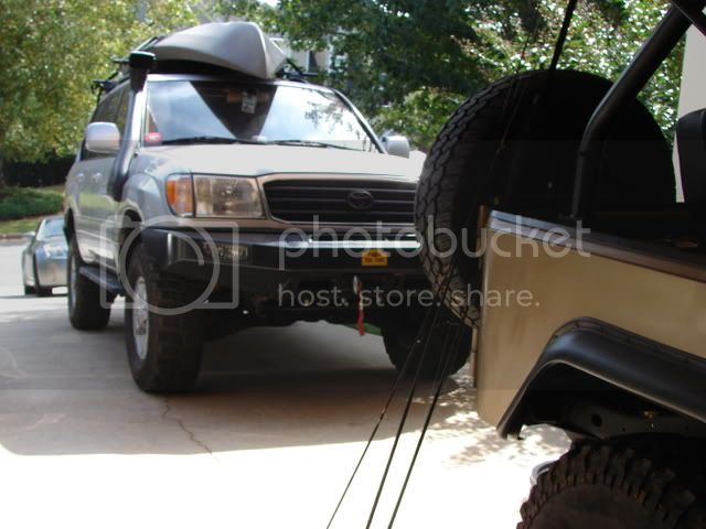

1. Paint match the sliders?
Here is a picture of the sliders/bumpers on my wife's 100 series that are color matched...same color as your truck, I believe.
Sorry, I guess I should have read ahead...hope the picture at least helps.
Thanks for the pic. I ended up going all black obviously but I was right that the all silver would be a good look ;)
Thanks for confirming! :grinpimp:

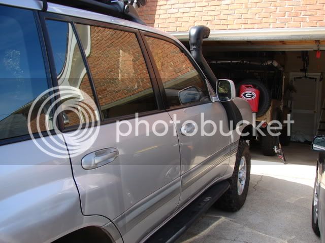

Finally got some more done on the hundy courtesy of ACC.
Heavy springs with a bit more lift.
ARB Diff
Snorkel

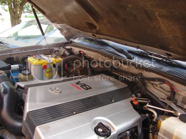

Dual Battery with outlets in the back

AC inverter big enough to run a Microwave.
