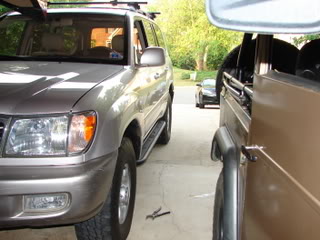

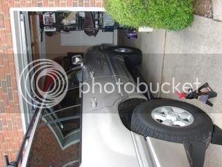

Sliders came in today along with the Diff drop. Since the diff drop is invisible, I started with the sliders.
And the best part? Linda liked em! "They aren't nearly as redneck as I thought they'd be"
Maybe not redneck enough for me then :rolleyes:
