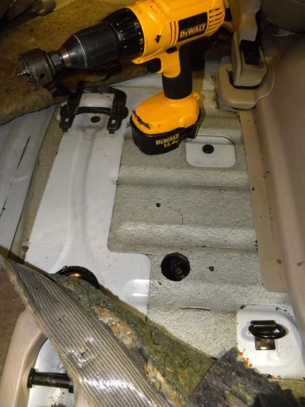

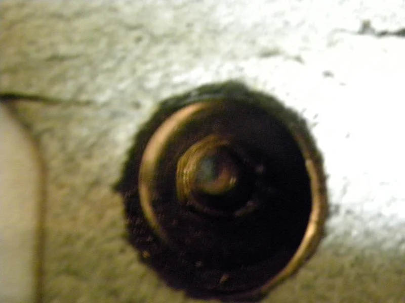

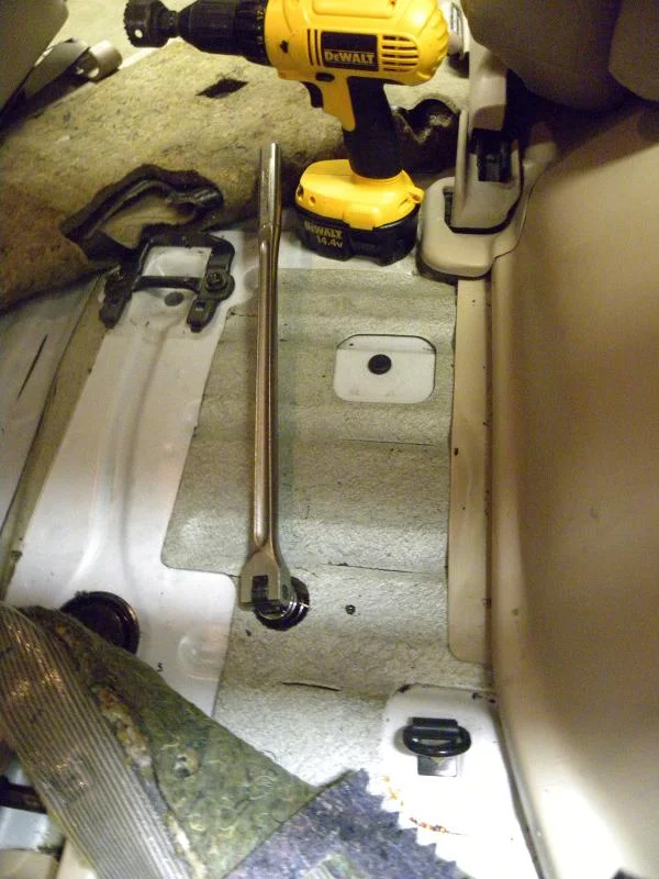

Pics
Here are the photos of access holes
