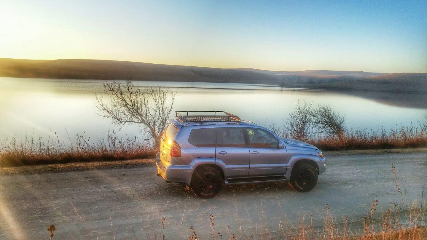

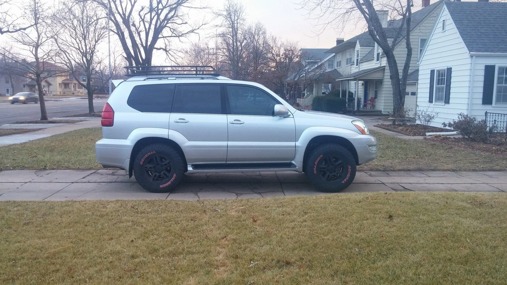

I know I'm a little late to the party, but I just read through this forum yesterday and I must say thank you to orion for being a lifesaver on some of these topics. The detailed processes help a ton. Here is my 07 470.

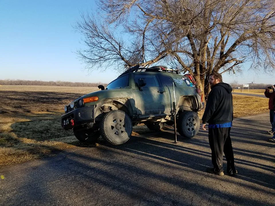

Also on the topic of rear shocks, when you were saying the shock is pretty much the limiter on your travel. Here is a picture of my buddies FJ with long travel shocks and only 3in Pro Comp lift springs (his long travel springs are on backorder)

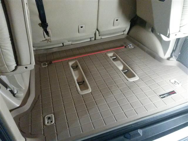

For a quick update post here at lunchtime...here's a shot of the rear WeatherTech cargo mat, cut out for the tie down points and 3rd row seat attachment points:
Can't take credit for the idea, someone else on here (I believe, maybe Club Lexus?) posted a similar picture...and I thought it was a great option.
I'll try to post about my front suspension install, and my custom trailer hitch receiver "install" tonight.
- Brian
whats the parts number for the weather tech mat you used?
Looks like it was #41240
Keep in mind the part number is different if you're RSES-equipped or not. The front passenger mat is different.
