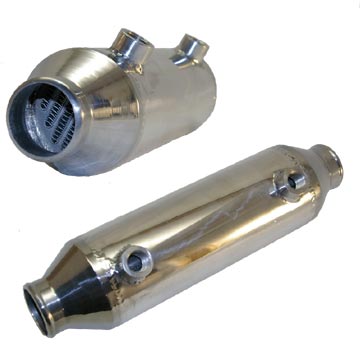

With the AZ temps and hot inducted air into the engine, we are working on getting one of our rigs over to his shop for a mock up. He suggests a water to air system using a barrel design cooler that would replace the finned TRD tube on the top of the engine where dogfishlake's intercooler is.
