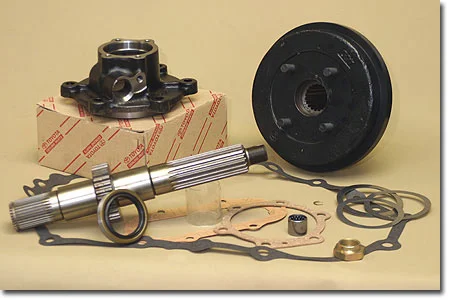

Why do you have to sacrifice the parking brake? I installed one on my H55F/Split case combo.

bigpopparock said:
One more item. You will loose your parking brake in the conversion.
Kurt and I talked about this issue;
One solution is to run a late model ('79 and up?) FJ40 rear axle housing which has e-brake out at the wheels (w/ 60 drum innards)
Or, convert rear to disc and get calipers w/ e-brake (Monte or Eldorado)
Yup, the late model FJ40 housing is the way to go IMHO, toss some brakes on it, swap your shafts and 3rd and your good to go with FAR superior brakes than the TC mounted IMHO. Of course there is a 3rd option. I can get a TC mounted park brake kit for a split-case, but it is spendy... more than a disc brake or late model housing.

- Parking brake is not an issue. There was a non-US issue 70 series that used the drum brake on the split case. There are several companies that sell the conversion parts. BTB sells the longer cable.
