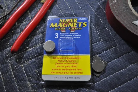

You will need to purchase a set of highly powerful magnets...see below. Small in size, these magnets are big on power...really big! I bought them at ACE Hardware for $9.00

Once this is removed, it will hang down from the visor and out of the way. You are going to take ONE of the magnets and apply a small piece of tape (shown to the right of the image showing the magnet packaging)...I used 3M VHB tape, you can get this at Staples, but I would imagine you could use just about any durable tape that is double sided (I didn't include the tape cost in the cost of the total repair as you will likely have some tape laying around).
I took the magnet with the tape and slid it in through the hole that is left after removing the mirror...I slid it toward the forward section of the visor away from the window and closest to your head if you were sitting in your seat with the visor in front of you, or in simpler terms...down toward the bottom of the visor as it is shown in the above image. It's best to position the magnet just to the right of the farthest opening to the right...a few inches or so is good. Make certain the tape side is facing the foam in the visor leaving the magnet against the interior of the cover facing the headliner when the visor is folded in the up position. You don't want the magnets power to have to travel through anymore material than necessary.
