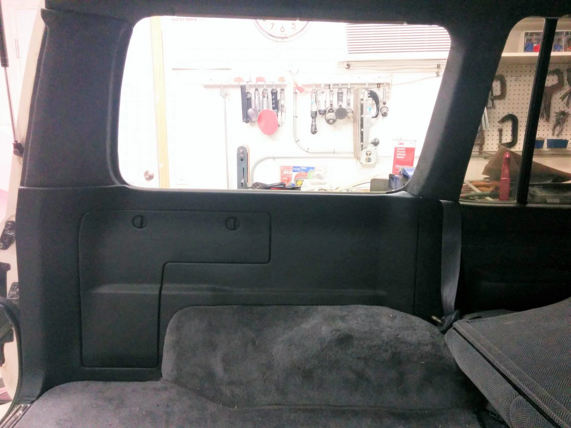

Good questionwere are you gonna sleep with all those seats?
Even less headroom than before....lolGood question
Obviously I'll sleep on my
"Mark III Sleeping Platform"
(Patent pending, all rights reserved)
(roomier & flatter than it looks!)

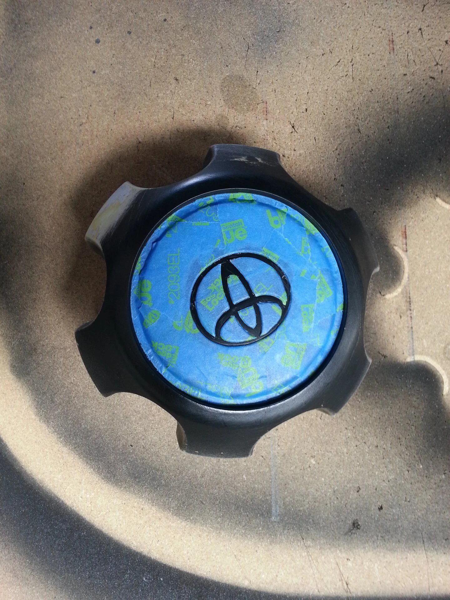

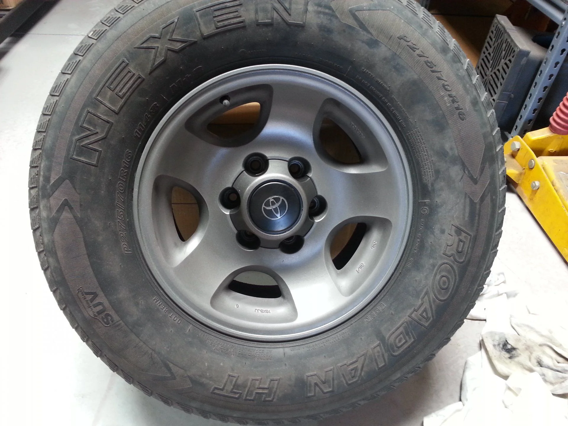

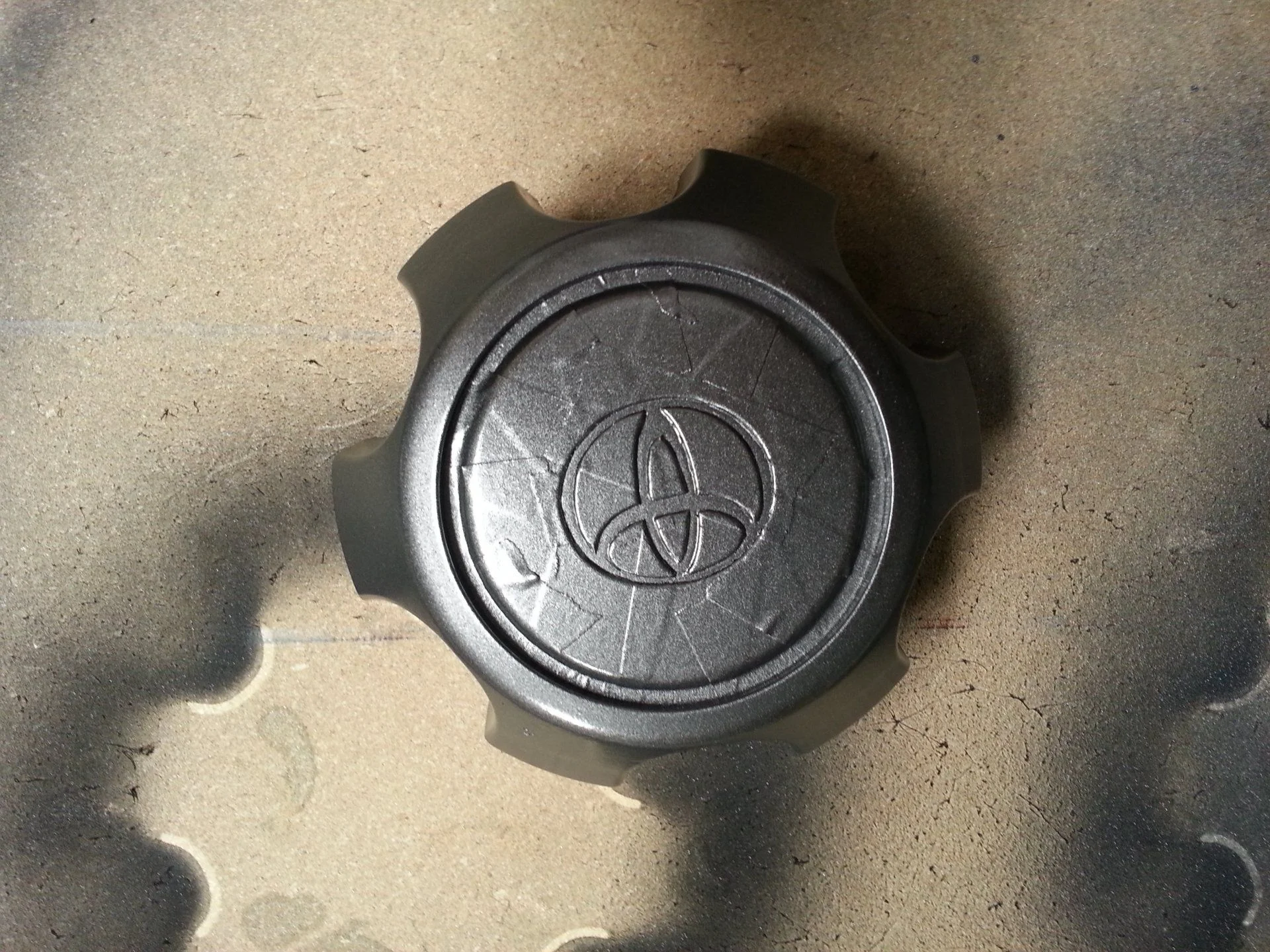

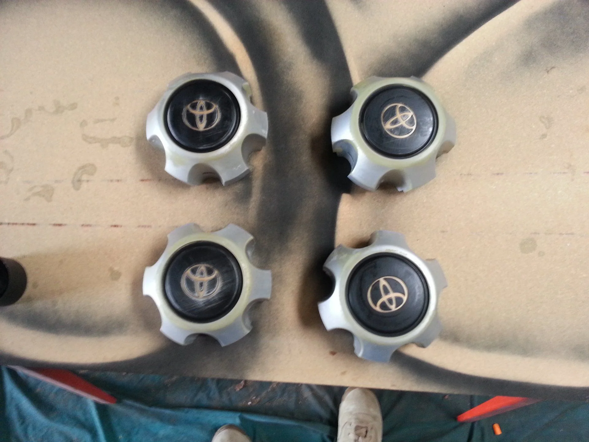

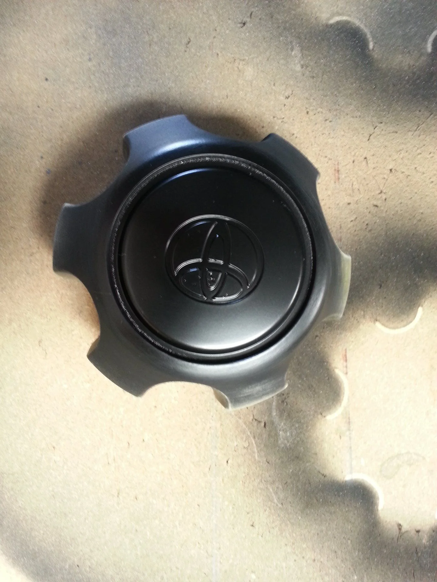

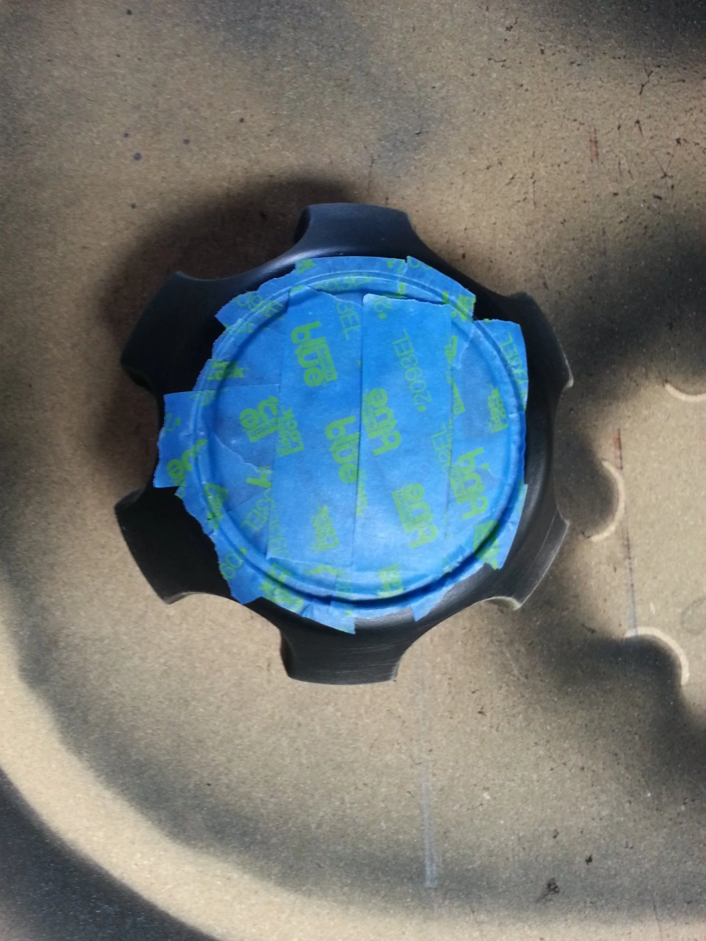

Caps/Hubs look good. What exact paint did you use? I have to redo mine and yours came out great.
What exact colors?Duplicolor High Performance Wheel Coating.
It has gone on very nicely but I will make one recommendation. Keep the cans indoors and don't paint when its over 100 degrees. The paint formulation would dry before contact when I tried to tough out some work when it was hot. The result is a dry/powdery finish instead of the desired sheen.
